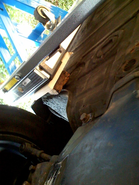

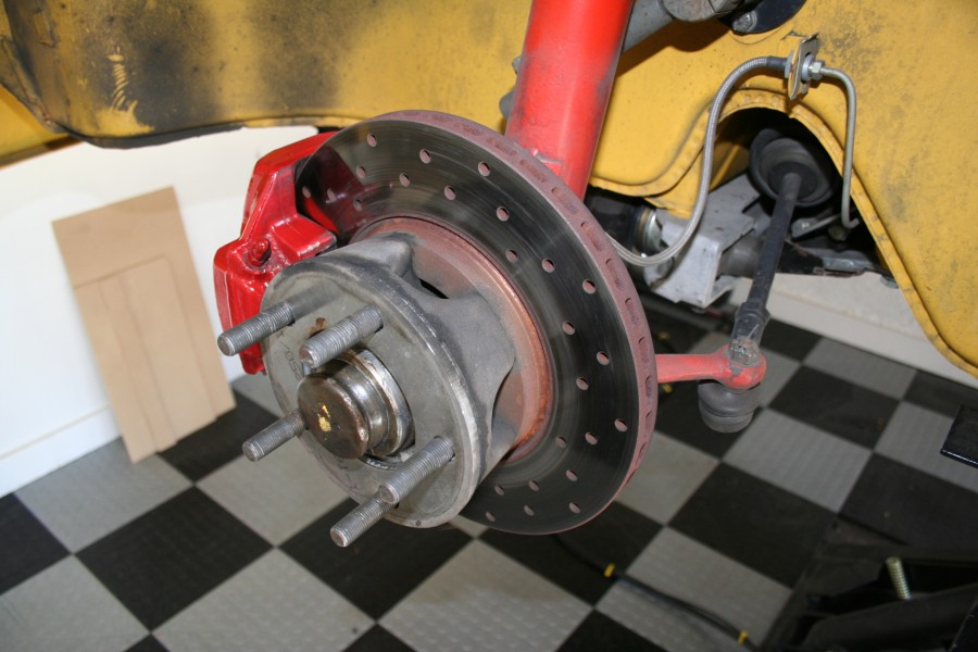

My scissor lift mod. Makes the underside and engine bay completely accessible and car is uber stable.

QUOTE(scotty b @ Dec 20 2010, 09:03 PM)
Damn. Those are some rusty ass brakes. Whoever owns that car should be ashamed...

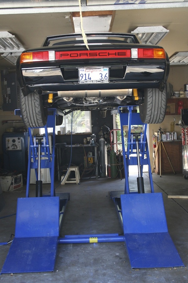

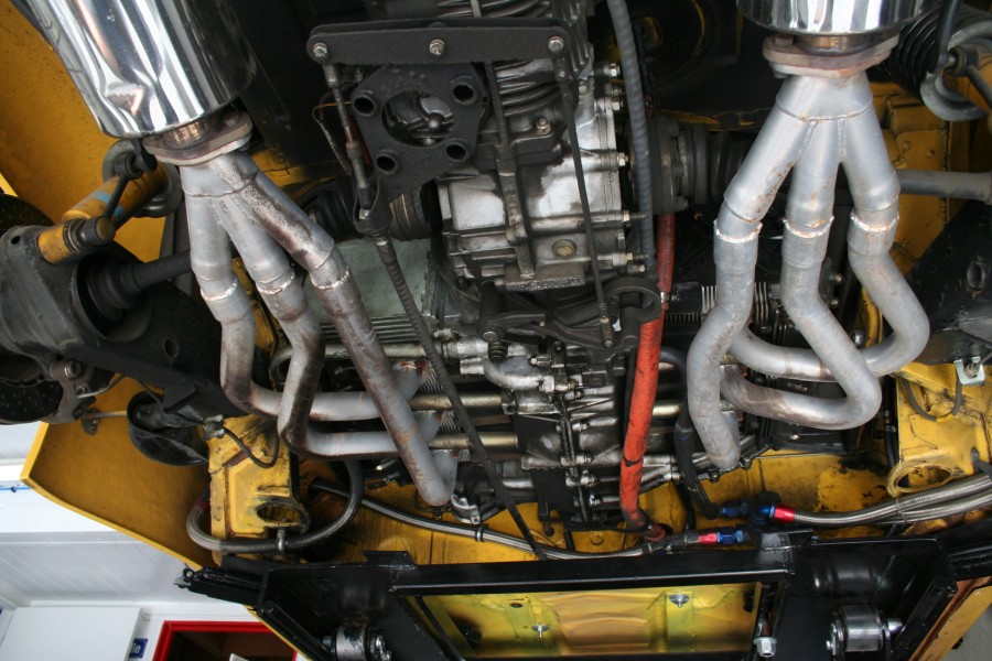

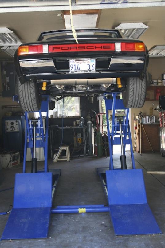

I decided on the EZcarlift (see photo below), I have limited space in my garage and only work on my own cars. I need the portability. I considered the BendPak but moving it around would be difficult and delivery would be a nightmare, (requires a forklift).
Plenty of room between the lift supports.
Only difficulty I see is the 4 cyl motor mount bar needs to be removed before dropping the engine, (see image below).

QUOTE(mgphoto @ Mar 14 2011, 12:37 PM)
i really like this - who makes it?

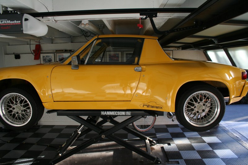

Here's my recently installed scissor. One of the best tools I've ever purchased.

QUOTE(mgphoto @ Mar 14 2011, 01:37 PM)
I have the same lift for my 914. I use it turned 90* and roll it in from the side. That's how Boytchu Manov (not quite how to spell his name) reccomended it. No problem with engine removal this way. Check ezcarlift.com to find the product.

QUOTE(Krieger @ Mar 14 2011, 04:11 PM)
Hi, I tried it turned the 90* but ran into problems with the lifting points. The front lift points are set into the floor pan about 2 inches, lifting there bends the pan. I place wooden blocks on the lower part of the inner fender, much stronger place to lift the car from.

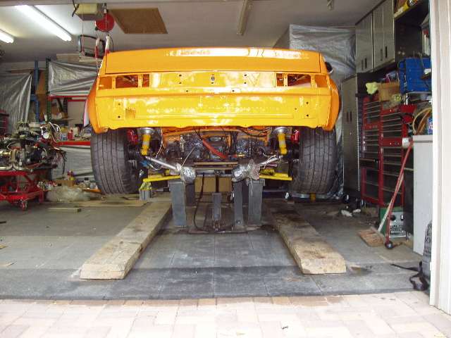

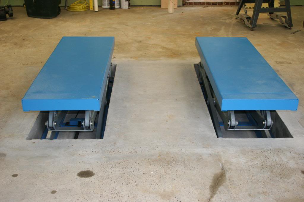

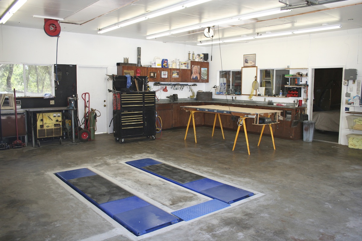

RE: scissor lift.....Don't be fooled by an advertised "lift" from any manufacturer. They run the lift to the top, add all the rubber blocks that are provided and measure from the floor to the top and call it "lift"....WRONG!!!!! They don't subtract how high it is sitting on the floor collapsed. Ask what the actual "hydraulic lift" is, not the advertised lift.
I did not want posts in my garage. I think it's just a matter of taste and amount of room available as well as ceiling height. You will NEVER regret getting the tallest lift that will work for your ceiling. I got a lift that will go 6 feet up and sunk it in the floor and I can stand underneath it. I lost no space in my shop, no risk of door dings and my shop is totally usable...I can drop engines, remove wheels etc.
Pic for you....Before and after sinking. The ramps are no longer needed of course

QUOTE(PRS914-6 @ Mar 22 2011, 04:51 PM)
Nice! Who makes this?

Posted by: PRS914-6 Mar 4 2012, 12:53 PM
QUOTE(6freak @ Mar 4 2012, 09:40 AM)
flat scissor lift ...pretty much flat bottom cars only
Not really.... they provide you with rubber blocks to put under a frame. For instance I lift my 2500HD GMC truck with no problem (6900 lbs). I set the blocks under the frame. You could lift any car. The worst scenario is you have to add some blocks to catch the frame without hitting something else. My Prius and Subaru can be lifted without anything. The 914 takes a small rubber block under the donuts
The lift is a Bend Pak SP-7
Any lift is a personal choice based on needs. For me I wanted height, no floor space usage, wheels free when lifted and drop an engine out the bottom. The Bend Pak was the best I found for those needs.
