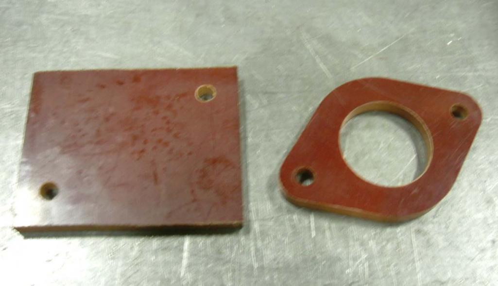

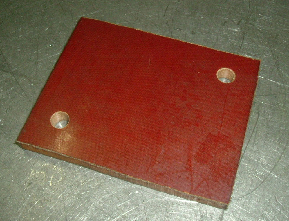

Ok, here are some pictures as promised. I finished one set this week.
Picture one shows the material I am using which may be bakelight...I actually got it for free from our spot welder operator as he no longer needed it. Thats how I got it with the holes in it already.
Another one but close up. Is this really bakelite or is it Phenolic? I believe they are the same material.

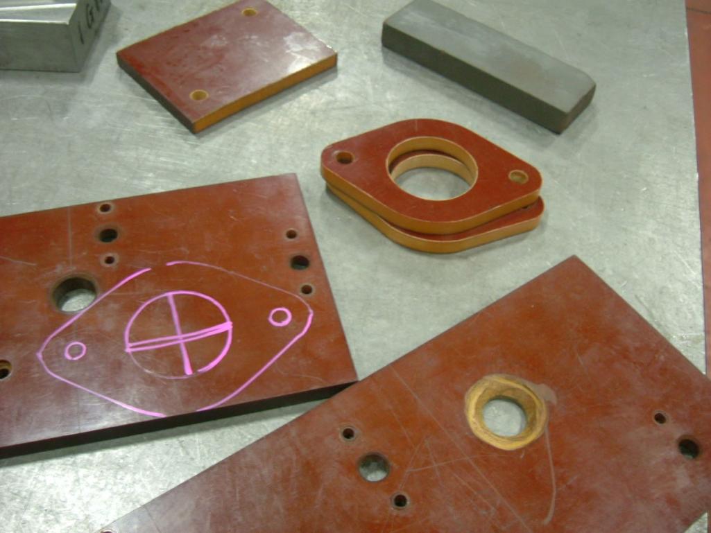

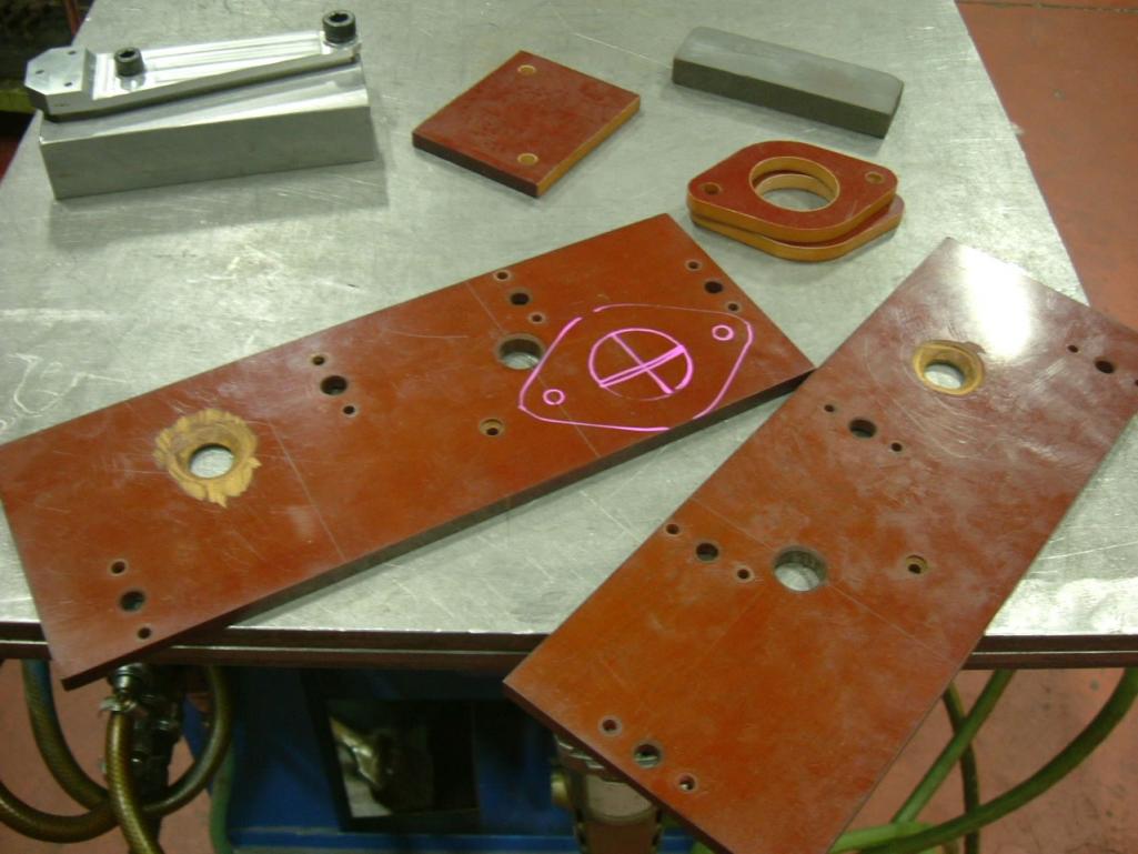

Here is the material after I roughly cut it out on the band saw. Than I made a small jig from some scrap metal to mill out the holes for the stud bolts so they are perfectly pitched to keep it positioned well.

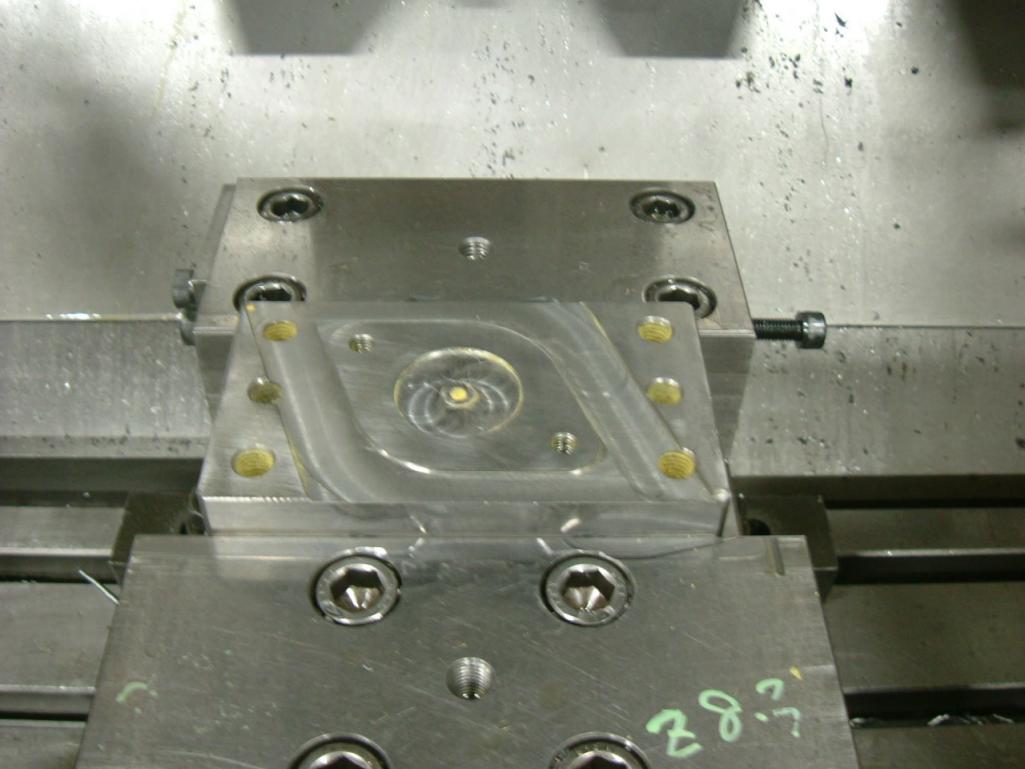

This is another jig I made for ones the holes are drilled and it fits into to give it the 2D profile. I did this on the CNC mill after work. Than I bolt it to the jig and mill away in the shape.

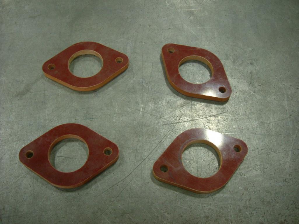

a picture of before and after, sorry picture turned out a bit fuzzy.

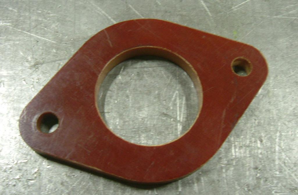

The final product all done and ready to go in the car. They turned out better than I thought. It was actually kind of fun making them.
Like I said they are the same, like kleenex and tissue, pretty much.

Complete!! Total cost = zero, machining time on the mill after work about 4 hours for the set plus a bit more to make the jig for them. It feels good making parts for your own car instead of having to pay out money for them.
