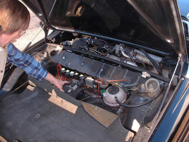

AirSix also has a Turbo with custom plumbing on his 1.7L

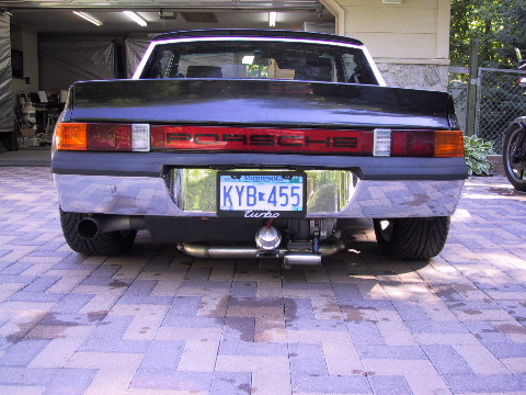

iamchappy,
what is your max angle for a driveway???
from that picture it looks like the turbo "stuff" would hit the pavement going up a steep incline....
Here is a 914-4 turbo...
It has been done...

I am refabricating the rear crossover pipe to raise it up another 2 inches to help the drain angle on the oil drain. It looks lower than it really is, look at the height of the exhaust pipes.

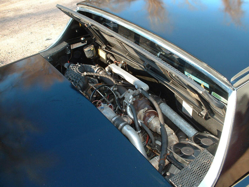

Here is how a turbo looks in my car.
airsix, did you modify your oil pump to help supply the turbo? can you still fit your targa top in there? the car looks great!

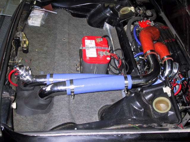

Intercoolers: True, 914 turbos should have intercoolers. And there should also be world peace, a free Tibet, and a restoration of the rain forests. What I'm trying to say is that I've converted my 914 to a hydraulic clutch, digital fuel injection, crank-fired ignition, and fabbed my own turbo installation.... but I still can't figure out a practical way to install an effective intercooler. I haven't given up, but I'm telling you it's been a challenge for me at least.

1) 914-6 engine cover, ducting to keep the hot engine air away from the intercooler. This seems the most practical for me... probably need an e-fan to cool it. Short plumbing runs. BTW Supra intercoolers are compact, efficient, and can be had CHEAP on ebay or from the salvage yard... and they don't look like the typical intercooler for you stealth guys.
2) Hack out the trunk and mount it between the taillights. (you could do this and keep some useable trunk space... but it's not very stealthy!)
3) On cars with body kits, mount it in the fenders. (rear quarter panels I should say)
And an intercooler on a draw through setup would allow more chance for the fuel to "settle out" so I would say forget it on that.
4) If you want to get more complex, an air-to-water setup allows you to have the plumbing short on the intake tract but you can put the "radiator" anywhere you want. One of my buds did that with his RX-7. He took the notoriously inefficient (due to size and location) stock 2nd gen RX-7 intercooler and built a water box around it... then plumbed it to a tiny radiator from a civic or geo or something, and plumbed it up with a tiny electric water pump in between. It worked great- he makes 425 hp at the rear wheels with that setup. (with a big honkin' T4 based turbo and some porting on the engine, and a Haltech to manage fuel and ignition.) So how about beside the tranny with a fan directing air? Lots of options folks. This one is a bit more weight, so moving the battery up front would be an idea to mantain balance.
