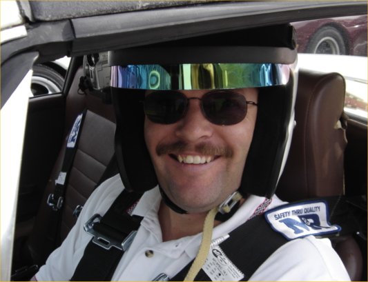

...I personally have a head that ain't worth that much. I have a <$100 open-face M-rated helmet. It is nice and lightweight, and I can wear my glasses with it very easily. I have found that I have real difficulty putting on my glasses when wearing a full-face helmet. (Damn round face of mine...) There is a pretty good chance that I will get a full-face helmet anyway if and when I get back on the Big Track for real, but for a while I will be quite happy to use my heap-a cheap-a helmet.

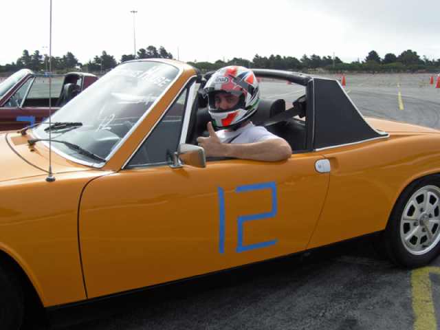

I like helmets from Arai. knocked my noggin a few times good enough.. Had a 5$ helmet once, then and had a big get-off on my motorcycle. I had a headache for a week.. Never again.. This is what I usually wear whenever I'm doing autocross or karts.
I use a HJC $60 helpmet when I ride my motorcycle and have been hit twice with it on. Worked like a charm. I do need to get e new one. You are supposed to replace them when they are "used" in their intended manner. Make sure not to use a plastic alloy helmet. They are cheapert, but what you want is polycarbonate (bullet proof).
HTH

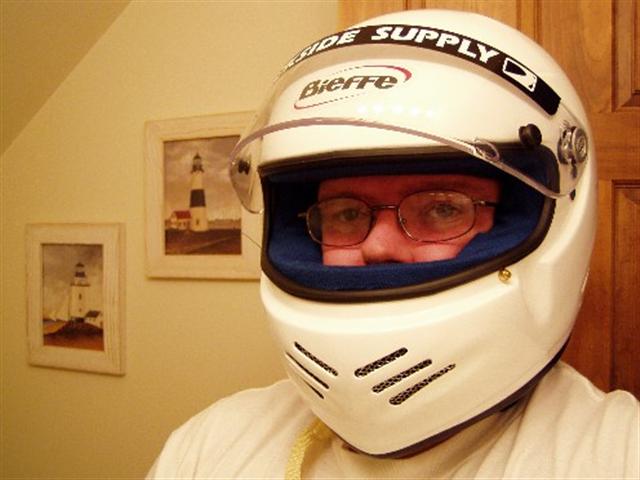

Just one more. I like my Bieffe, fits well for my melon plus the nice big opening makes it easy to get my glasses on.
Cost about $275, if I remember correctly.
