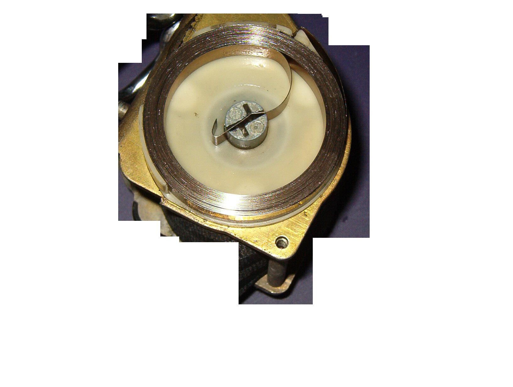

Any pics of how the spring should be installed?

I think I did it. The spring really isn't that bad to put back in. If the springs looks wrong, let me know.
