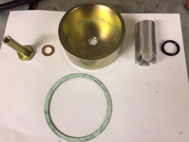

I attempted to install this new Weltmeister sump oil trap today, but concluded it cannot be installed with the existing stock oil screen. Is this correct? Otherwise I believe installation of this oil trap replaces both the screen and taco plate -- from the top down: O ring, pickup extension, taco plate size gasket, oil trap, copper squash washer, bolt, all shown in the pic, correct?
Correct. The instructions should mention omitting the oil screen.
I have heard that some people modify the screen to fit the new pickup.
And you seem to have the order of the bits correct; and it looks like the kit is complete.
