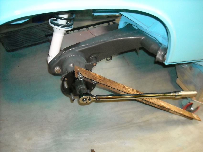

E brake might help a tiny bit? Maybe take the wheel off, install 2 lug studs, and use a bar between them (the bar is then driven into the floor by the breaker bar)? But ultimately you will probably need an impact wrench.

You will likely need to brace the hub against something. Thread in a couple of lug bolts, or other bolts with the same diameter and pitch, and use a really really big bar in between them to brace against the ground.
Impact is better--but you may need to brace the hub anyway!!

used this to tighten them, will probably work to loosen them also.
Just a big hunk of angle iron with a couple holes drilled for the wheel studs.
The big bar worked for me on one side, but I had to cut the nut off of the other side with a Dremmel tool as a last resort. Just be careful not to damage the threads.
