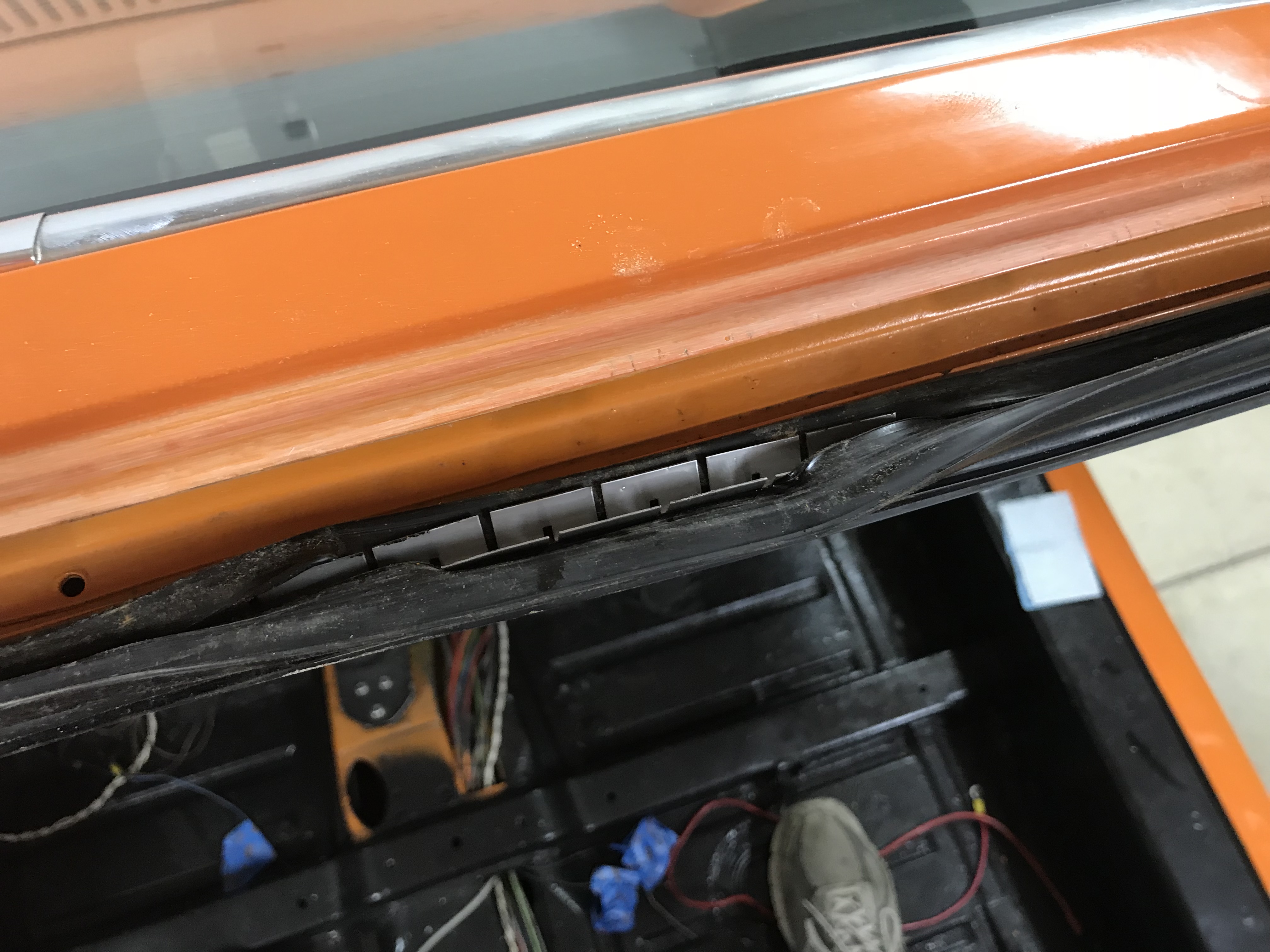

Normally when install these, I just lube up the sides and slide them on (done that and it was easy) and then push the horizontal piece onto the windshield and it's super easy. This new seal was not staying stuck at all, and when I peeled back the rubber (photo below) the metal "clip" is not compressed at all.
I don't recall ever having to compresses this metal part before. But, no problem, I tried compressing about 6" or so to test but I can't get it right. Either it is too compressed to fit on at all, or is too wide and doesn't stick on.
Any tips? What am I doing wrong here? I remember this piece being super easy to install...

that doesn't look OE to me based on the metal strip and the tabs look like their too long explaining why it wont stay in place.

Hmmm 2... Pelican says definitely OEM. Anyone have a photo of the inside metal clips of another seal to compare to?

The OEM was NEVER a 2 part seal. If they sold to you as OEM, it may be the manufacturer, but not factory.

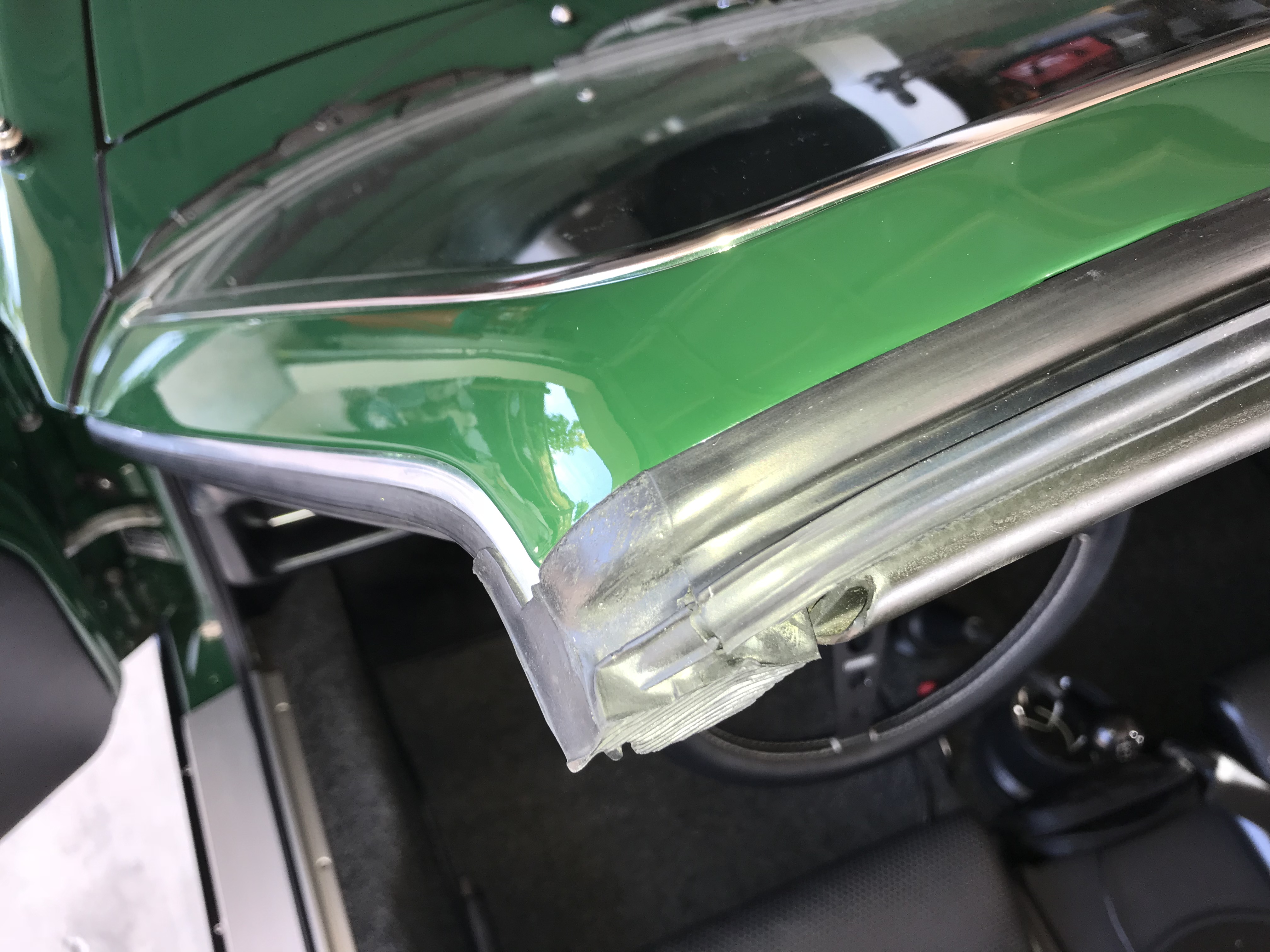

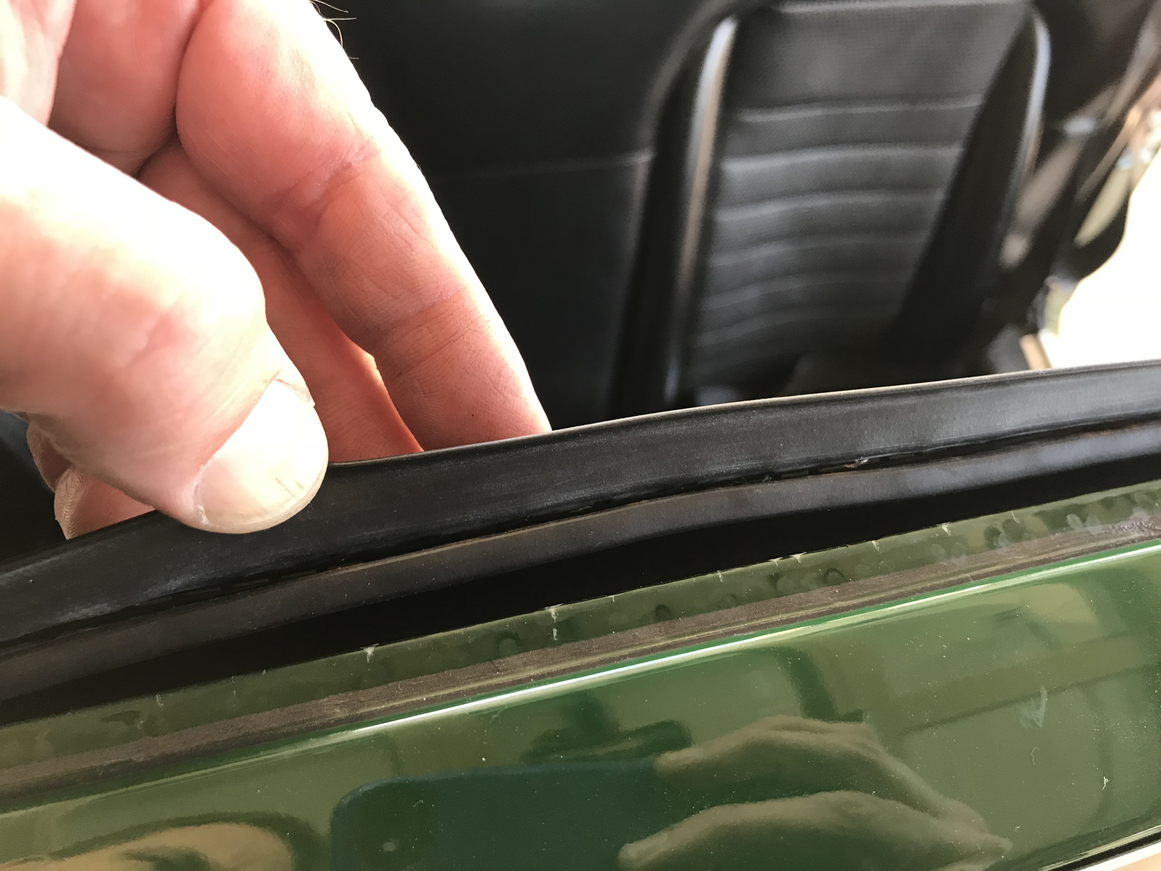

The one on my green car that did press on ok looks to have a similar seam.
-Steve
But the channel on the green car is tight and easy to take on an off.
-Steve

The factory part has the metal co molded into the channel. The no factory options have the metal folded in as it's cheaper to make that way. It also means that if it comes out of the fold it's dam near impossible to get back in.
I can say without a shadow of a doubt it is not factory.
