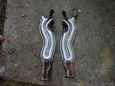

Wow--I appreciate all the world class advice. The car is actually a CA car and has been in CA, AZ, and CO primarily. I just moved to the Northeast last July, so it is still pretty much rust free. (Military life) I am shopping for used heat exchangers now. I can do all the work except for the new stud. I am clueless there. Would a machine shop handle it or a standard mechanic?? It broke right under the exhaust nut, so most of it is still there. I am considering just cuting the hole on the heat exchangers so I have enough left to put a new nut on. Any opinions? This is great.
Here is a set for sale on Ebay. The ad says he is sure they are for a 2.0 but they look like 1.7-1.8 to me.

Just bought used S/S heat exchangers on ebay. Also new nuts and copper seals. I am going to replace my old heat exchangers to try and eliminate the backfiring on decel. Does anyone have advice on what to do about the broken stud? Should I pay to have it replaced, or cut the exchanger mount down to allow enough of the stud to poke thru?? Not sure how complicated a task it is to replace a stud.

They are 1.7/1.8 HE's... NOT 2.0

The guy who sold the HE's must be fairly new to the 914 market.. he didnt know who made them..LOL
