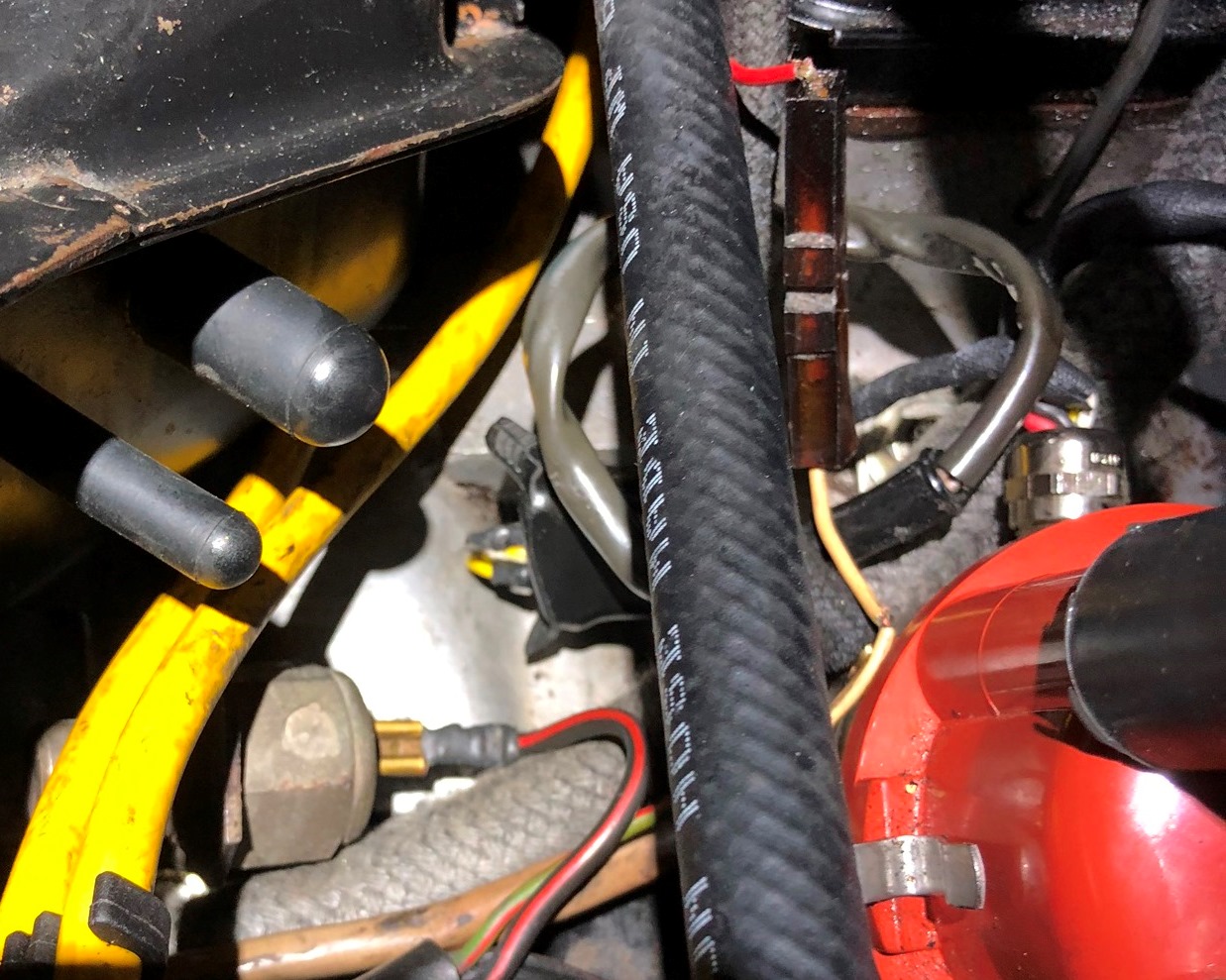

Posted by: Morrie Jul 25 2019, 09:18 PM
Hi Guys,
I had to go out of town for a week but while I am away I wanted to give a bit of an update.
Airbox Leak/ Smoke Test Failure: I disassembled the system and pulled the air box. after sealing it up and testing it independent of the system I now believe that the leak was not in the box itself but rather at the connection to the intake runner boots. The boots are soft and pliable and appeared to be snug. I decided to try using hose clamps for now as an experiment and smoke it again. If this solves the problem then I will install a new set of intake boots.
I do have a question on wiring I am hoping you guys can help me with. I want to mention that I did thoroughly inspect and clean all the EFI grounds and made sure they are properly attached. Chassis grounds are next. On the wiring that goes to the AAR and Thermotime switch. I see a small gauge white wire coming off the EFI harness and a larger gauge black wire with a red stripe coming off what I will call the engine harness. I don't trust anything from the previous owner so I am asking if someone can help me out with some direction. In looking at Jeff's diagrams it appears as if the TTS is the small white wire coming off of the D-Jet Harness and the AAR is the larger black wire that comes off the engine harness. Does that sound right?
Thanks guys....
Posted by: JeffBowlsby Jul 25 2019, 09:45 PM
QUOTE(Morrie @ Jul 25 2019, 08:18 PM)
the TTS is the small white wire coming off of the D-Jet Harness YES
the AAR is the larger black wire that comes off the engine harness. Does that sound right? NO
Thanks guys....
Black/Red on the IGNITION harness goes to the coil. As does the Black/Purple.
White wire with a box connector goes to the AAR. Wire on the AAR is red.

Posted by: Morrie Aug 17 2019, 11:43 AM
QUOTE(JeffBowlsby @ Jul 29 2019, 02:06 PM)
I responded to that above. Where does your beach/red wire originate?
Hi Jeff,
I had some time to trace wiring. The black wire with red stripe you see in the picture is part of the ignition harness. I printed out your 73-76 D-Jet Ignition Harness Diagram and used it for a reference. On my car, the black wire with red stripe originates at the relay board on pin 12, which maps to the AAR, so in this picture the wire is connected incorectly to the thermotime switch.
The white wire you see with the crack in the insulation originates in the FI harness.
I'm a little confused by the wiring diagram for the FI harness of a 75-76 GC engine code. It appears as if in the diagram the thermotime switch goes to both pins 32 and 33. Does this mean that the 18/33 connection on the 4 pin connector of the relay board, the Thermotime switch, and the cold start injector are all connected? It looks like there is a series connection from 31 on the relay board connector to 31 on the cold start valve, then out of the cold start valve on 32 to the thermotime switch which is connected in parallel with pin 33 on the relay board. Do I have that right?
Thanks again for the help!

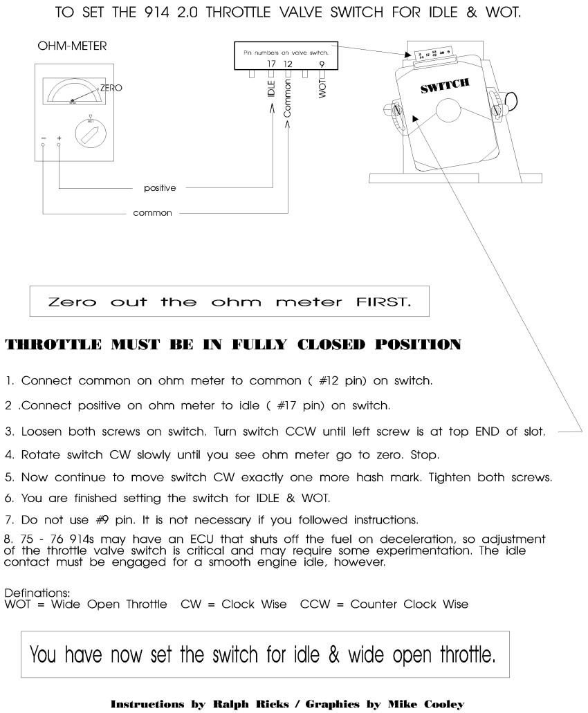

Posted by: sholman5 Aug 17 2019, 12:24 PM
Throttle position switch?
Posted by: Morrie Aug 17 2019, 12:58 PM
QUOTE(sholman5 @ Aug 17 2019, 01:24 PM)
adjusted and re-checked. Since my original post-
Adjusted throttle position sensor after disassembly, inspection, cleaning and testing.
