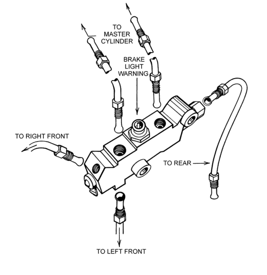

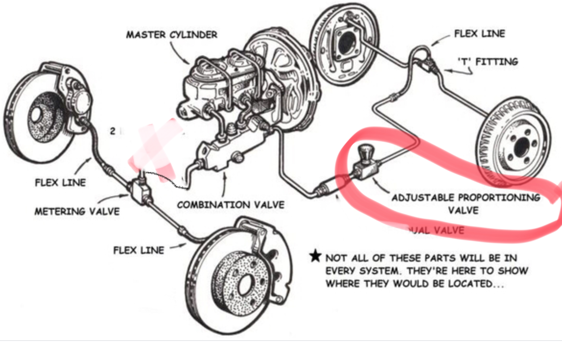

Figured our racers here have dealt with that so thought I’d ask. For those that have done this where did you put the valve? I’ve seen two types - one where both lines from fhe MC go to a combination valve and splitter (pictured below, just an example I haven’t ordered this yet or decided to go this way) OR a set up where only the rear line goes through the valve.

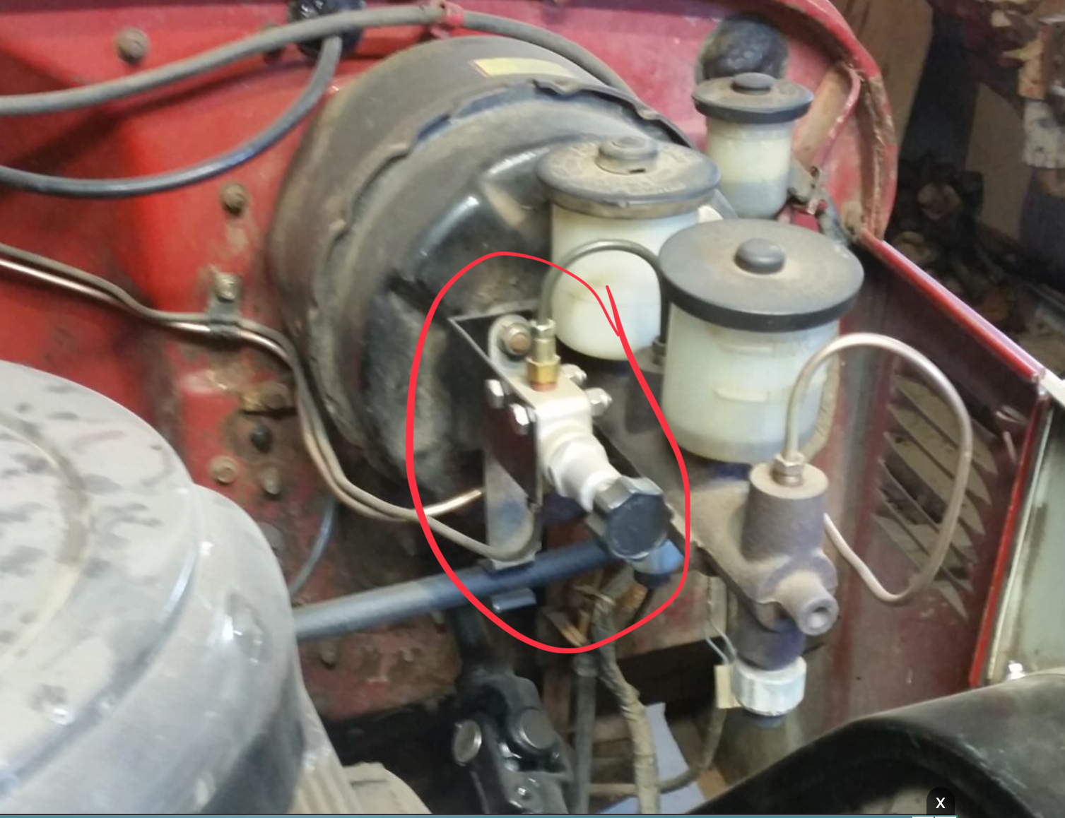

OK -to close this out and in case anyone was curious, OK to do rear only.

To add to the confusion, your combo valve diagram is the type with a proportioning valve inside already. (Hence the term "combo")
I'm not sure how well adding a second adjustable valve would work. You're only trying to prevent rear brake lock up under HARD braking.

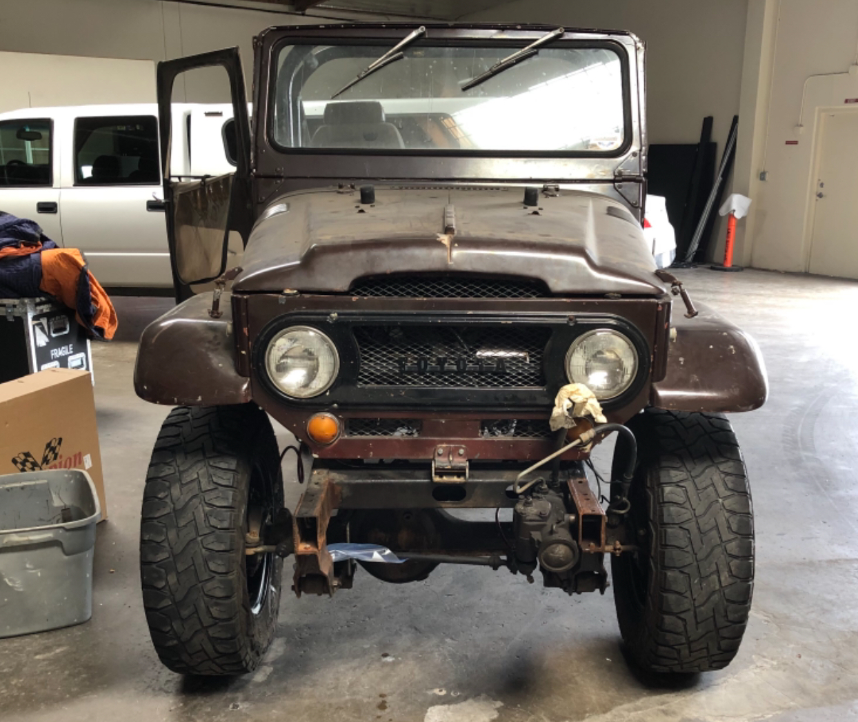

Sorry if that was confusing but I was asking about the FJ40 Cruiser (which is why the picture of the rig and I put OT in the title of the post)

The last picture if not my Cruiser, but an example of how they can be set up.
@http://www.914world.com/bbs2/index.php?showuser=17338 - this thing is lifted and had a short wheel base so I do need to sure the rear doesn’t come around on me.
