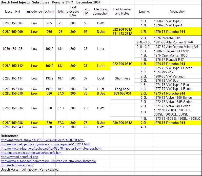

Posted by: JeffBowlsby Mar 2 2020, 10:06 AM
43.5 PSI is the conversion from 300kPA which is the test pressure for standard 914 injectors, not the service pressure.
You sure your injectors are rated that high for in service conditions?

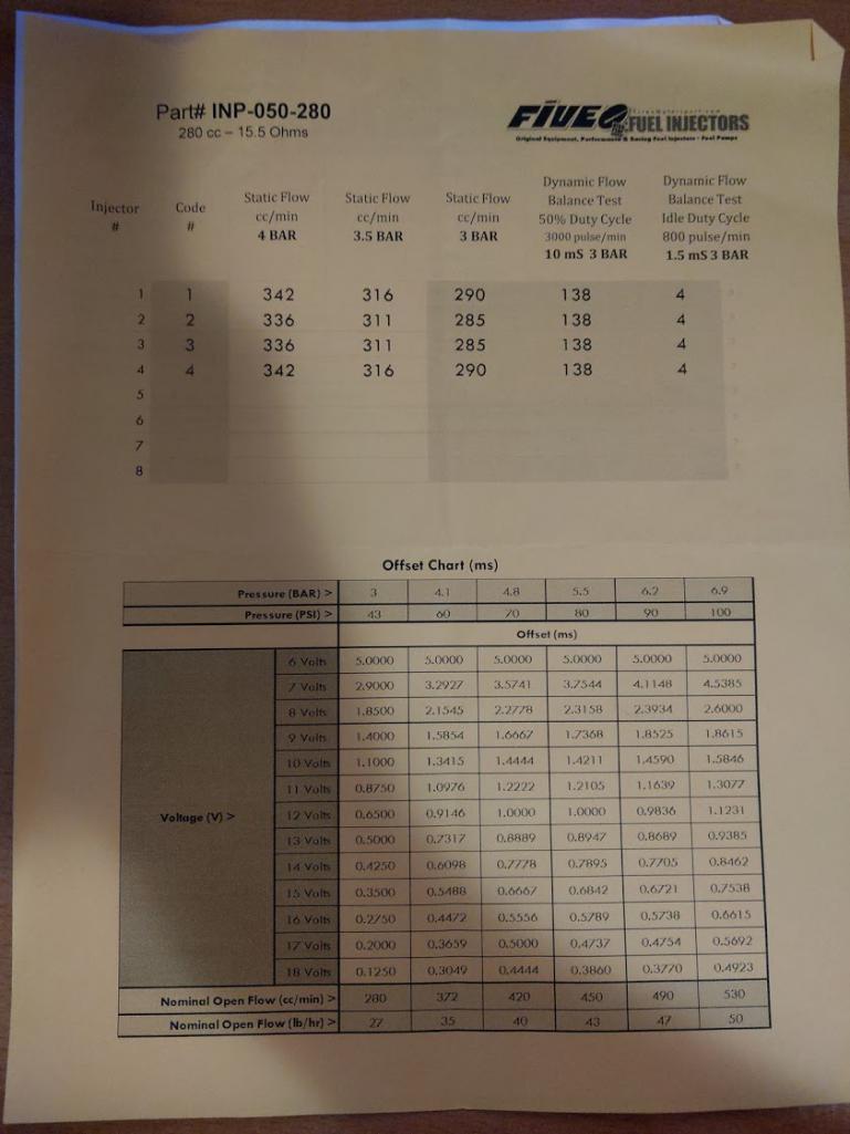

Posted by: GregAmy Mar 2 2020, 10:41 AM
QUOTE(JeffBowlsby @ Mar 2 2020, 11:06 AM) *
https://www.fiveomotorsport.com/a280-a380-high-impedance-hose-type-fuel-injector/
I could adjust the tables to accomodate it (just fired it up yesterday) but if I can easily get it to the rated pressure I'd know what to put in TunerStudio as my proper injector setting.
I'm trying to learn more about if I'm losing injector efficiency by running longer dwell times on the lower pressure.
Posted by: JeffBowlsby Mar 2 2020, 11:45 AM
As I thought...thats maximum flow, without a safety factor.

Posted by: GregAmy Mar 2 2020, 01:19 PM
QUOTE(914_teener @ Mar 2 2020, 01:58 PM) *
I'm confused. Flow and pressure are related however from Jeff's chart for the low impedance injectors yields 380 cc per minute @ the stock aprox. 2 Bar.
With much respect, Jeff's chart is not relevant to this discussion. I am not using 914 D-Jet injectors.
EDIT: Although, is Jeff trying to point out is that D-Jet injectors are all rated at 300kPA but are not actually used at that pressure...?
The link you provided for the high impedence injector flows 280 @ aprox 3 bar?
Correct, thus the point of my query. I'm looking for a factory fuel pressure regulator that will allow me to run 43.5psi. "Factory" because it would be an easy install; "43.5psi" because I want to start with a known 280cc flow rate capabilty in the tuning software (it's one of the required inputs).
I love to learn.
As do I, thus my self-flaggelation instead of staying with a perfectly-functioning D-Jet system (really, it was working fine...even had a newly-rebuilt unable MPS...)
The relationship between pressure and flow is not linear: https://help.summitracing.com/app/answers/detail/a_id/5223/~/how-do-i-fine-tune-my-fuel-injector-flow-rate%3F
Using that formula, my 280cc (rated) injectors are 26.67 lbs-hr. Using that formula, at 36psi it would be 26.26 lbs/hr or 254.75 (we'll call it 255 for short). That is confirmed by this calculator:
https://deatschwerks.com/fuel-calculators/flow-vs-pressure-calculator
That said...Jeff is implying that running injectors at their standard rating is not good, that there needs to be a "safety" margin. If I infer that correctly, then there actually may be no problem running these at 36psi and putting in "255" as the flow rate (the Microsquirt has no input of fuel pressure).
I'm just curious if running them at higher pressures is not advantageous in terms of spray pattern and efficiency. Most electronic fuel injector manufacturers are suggesting pressure of 40-80 psi. But for a 100hp (max) crank horsepower 4-cyl engine, 280cc injectors (@43.5psi) are way more than enough...they'll probably be running way low on duty cycle, so maybe lower starting pressure is better...
Regardless, I can tune it to any usable value. And I suspect 36psi is a usable value. Just looking to understand my options.

QUOTE(JeffBowlsby @ Mar 2 2020, 06:06 PM) *
- You Posted: Injector Table
Hi Jeff,
the table you posted isn't correct.
There are three different flow rates at D-Jetronic injectors:
yellow: 265 ccm/min
green: 318 ccm/min
blue: 380 ccm/min
(All types very early without color code, black plastic, very rare, to be identified by parts# only)
The D-Jet 914 (and other Volkswagen D-Jet) were equipped with yellow (1.7l) and green (2.0l) only.
Blue injectors were used on other car brands only.
You can use the page of Stan Weiss http://users.erols.com/srweiss/tableifc.htm for a reference, you find also a calculator for re-calculating the flow rate at different pressure there.
I will send you the historic Bosch table in German language.
Regards
Norbert
Posted by: JeffBowlsby Mar 2 2020, 05:48 PM
Hi Norbert, thank you for the Bosch list its very helpful. I can see that that my chart above needs updating, I did not have that Bosch list available back then. I had used other web sources listed in the references, many were injector rebuilder shops.
I developed my chart maybe 15 years(?) ago, based on the references available at the time, which are indicated on the chart. It took quit a bit of time as I recall. Looking those up now, I see many of those sites have gone away. A couple are interesting though. The Weiss chart was a reference for me back then, but it currently lists the 0 280 150 019 injector at 320.6 cc/min, and the Witchunter chart lists it as 406 cc/min at 3 BAR. I wonder why they changed it?
One would think rebuilders would use accurate info.
I did not see an indication of what the test pressure was for the Bosch chart values. Do you know?

Posted by: nordfisch Mar 3 2020, 02:00 PM
QUOTE(JeffBowlsby @ Mar 3 2020, 01:48 AM) *
... The Weiss chart was a reference for me back then, but it currently lists the 0 280 150 019 injector at 320.6 cc/min, and the Witchunter chart lists it as 406 cc/min at 3 BAR. I wonder why they changed it?
Hi Jeff,
I don't know the reason why some guys publish strange data...
maybe they measured 'blue' injectors instead of 'green' ones.
Late 0 280 150 036 injectors (type 'blue') do have a real strange color and look more light green than blue.y
406 cc/min would fit a blue injector at 3 Bar... or using another fluid or both.
This is only a suggestion.
But I can definitely say incorrect values are published in Germany, too.
Be aware Bosch produced only three types of D-Jetronic-injectors (265 ccm, 318 ccm, 380 ccm) (another type with higher flow rate was developed, but never produced).
The D-Jetronic-injectors are numbered from 0280150001 to 0280150045. All injectors outside of this range are no D-Jetronic-injectors.
So are the injectors of the 1.8 L-Jetronic not compatible with the D-Jetronic.
Sorry, I can't tell you which medium Bosch used to test the injectors now.
I'll try to get the information.
'ASNU' - rebuilders normally don't measure the flow rate but check the spray pattern and the difference between the injectors of the same type they test together only. Bosch testing procedure for injectors doesn't include flow rate measuring, too.
Regards
Norbert

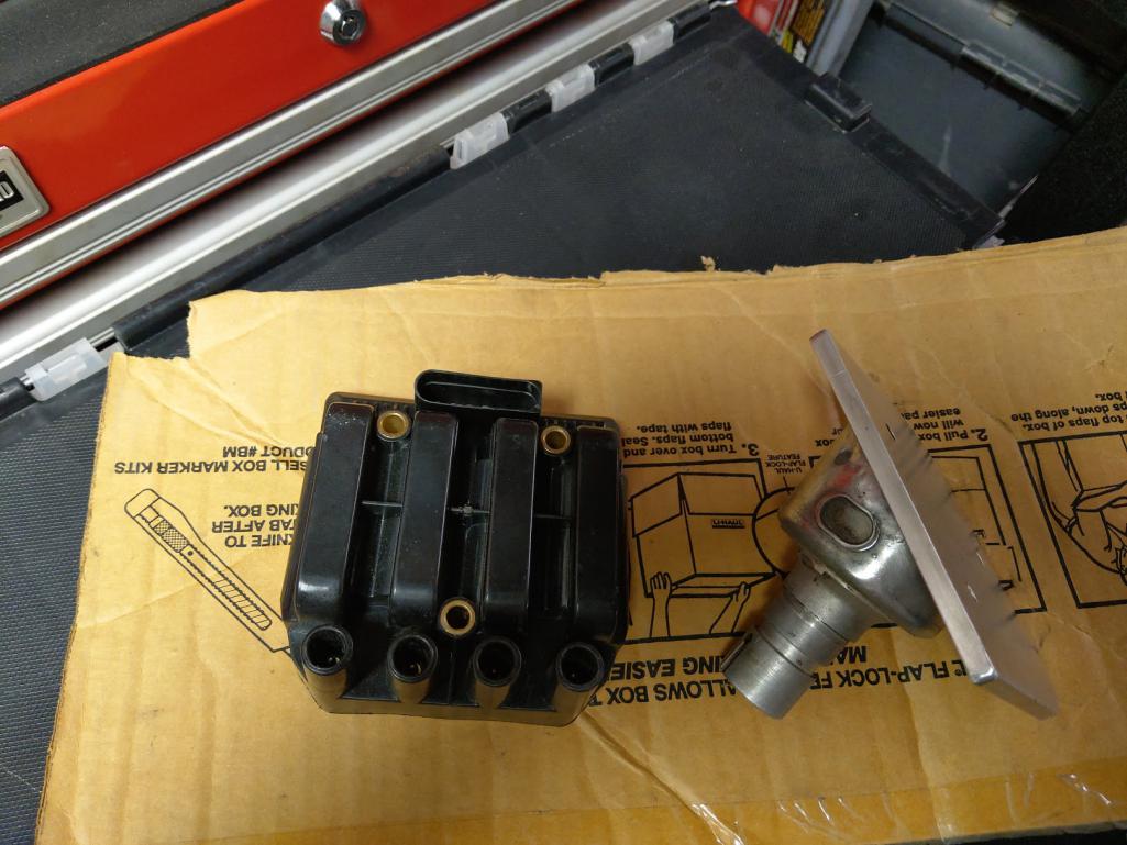

Thats a real clean install you have going so far, I dig it! I like your coil location choice. Working on something similar for my next refresh but using a newer VW 4 coil pack. Great minds....

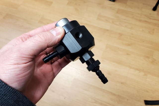

Hey, looky what I found....
https://www.injector.com/cart/pc/Adjustable-fuel-pressure-regulator-Part-No-0610-p48.htm
I would deal with/verify your pump situation first but if for some reason you still cant get your stock regulator to 43 psi this looks like it might be a fit providing the picture is an actual representation.
Edit:
Looks to be the same as an MSD 2222 (and if you look real close at the picture it says made in germany and had a bosch part number, not sure what that is about)
https://www.summitracing.com/parts/msd-2222
Also the MSD-2220 (same thing without the boost port)
https://www.summitracing.com/parts/msd-2220
Both are listed as 36-45 PSI
anyways, you have options. Thinking that should be enough info to take care of all the issues biggrin.gif
Posted by: JamesM Mar 4 2020, 02:48 AM
Found another picture of the MSD 2222 where you can see the full bosch part number...
you will never guess what it is...

Posted by: GregAmy Mar 6 2020, 07:58 AM
Thank you sir!We're already overdue for a beer visit. I may pass by tomorrow if you're in.
Here's some docs I found when I was going through paperwork. The injectors should be OK at higher pressures. Just not clear where I *should* run them. I clearly do not need the flow rate at higher pressure, but I wonder if reducing the duty cycle improved efficiency. I wonder if I'll even notice a difference at all by bothering to go over 35psi.
Attached File(s)
Posted by: JamesM Mar 7 2020, 02:48 AM
QUOTE(GregAmy @ Mar 6 2020, 06:58 AM) *
I would run them at 43 If possible as that is the lowest pressure you have all the datapoints for. Increasing the pressure may improve the atomization but if your pulsewidths get to small mixture control at idle can become a problem.
But... if those injectors can make a decent spray pattern at 35psi I doubt you would notice much if any difference by going to 43, the only question is how well do they fire at 35?

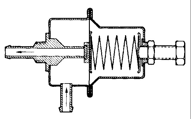

Didn't have time to tear into one this weekend but from the looks of the diagram im wondering if MSD didnt get to higher pressure via a longer adjustment screw. Would need to measure how much more could be added before the coils bind. From the drawing though I would think you should be able to dead head the pump with a long enough adjustment screw
Not sure when the last production run would have been, but guessing at 50 years old the OE springs may be getting a bit tired.
Posted by: JamesM Mar 10 2020, 12:09 AM
Just did a bit more searching... this is an interesting read on the pressure regulator
https://www.thesamba.com/vw/forum/viewtopic.php?t=656298&highlight=d-jet+fuel+pressure+regulator.+whats+inside++fails
Cant tell for sure but it looks like the adjustment screw may be a custom part, so swapping may be out of the question. Also looks like new ones from anywhere may have gone NLA sometime over the last couple years and if that post is to be believed these have a high potential for wear that will affect every used one out there.
May be time to look at other options

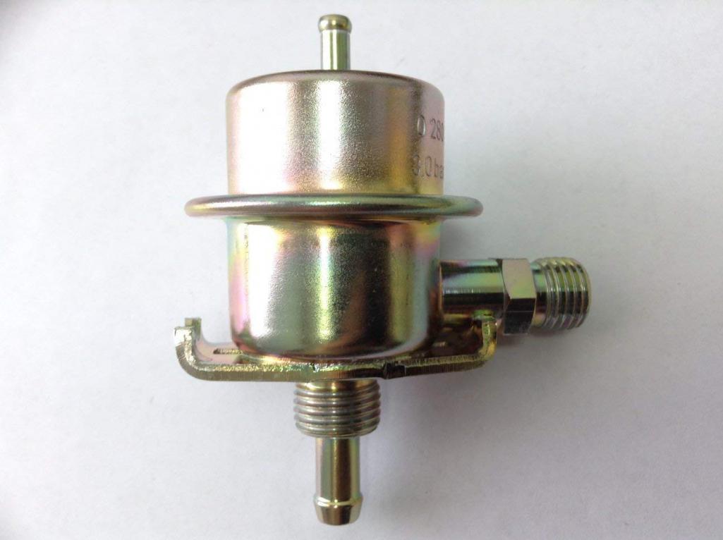

Knowing that 914 l-jet regulators are a direct swap (fitment wise) I started exploring what might be out there the the realm of cars that used similar systems.
914 L-jet regulators are non-adjustable, vacuum referenced and is supposed to give ~37-38 with zero vacuum. Those can still be had available new but isnt quite where we want to be...
Vanagon regulators are similar pressure wise
and then by some random luck i stumbled on this...
Bosch 0 280 160 256
vacuum referenced, 3 bar non adjustable. Would need an adapter on the inlet but other than that appears to be externally similar to a stock regulator.
https://www.amazon.com/gp/product/B00C818WG8?pf_rd_r=8EE932W9WKB4516YQBZM&pf_rd_p=ab873d20-a0ca-439b-ac45-cd78f07a84d8

https://shopbhp.com/products/kit-car-fuel-pressure-regulator-bosch-inner-wing-mount?variant=28302418369
Looks like adapters for the modern bosch regulators may be the way of the future for older cars. Perhaps one of our vendors could machine one thats a perfect fit for a 914
Edit:
I should have checked the dub shop first... Mario always has awesome stuff
http://thedubshop.com/universal-fuel-pressure-regulator/
that looks like it would fit in place of a stock regulator. Other vendors look to have a adjustable regulators that will fit that adapter that can be turned down to lower pressures, so may be a solution for d-jet as well

Posted by: GregAmy Mar 10 2020, 07:31 AM
Here's a 3-bar one. eBay ad claims (I think) it can be set higher:
https://www.ebay.com/itm/Fuel-Pressure-Regulator-Black-Porsche-912-914-916-924-944-968-928/401379447531
Can't really tell what the hose fitting size is.
Searching for "107001001303 regulator" results in other sources for the same part, implying it's used on AMG Mercedes (if I am translating properly).

Your goals are the same that I had when I did my first install, only back then it was only the start of OEM d-jet parts supply drying up. Fuel pressure regulators going NLA is a fairly recent development though, from what I can tell sometime in the last couple of years. Its a bit of a surprise.
Take a good look at that part from the dub shop, i really think that may be the best bet. Using that 6AN to 5/16 barb bulkhead fitting it looks like it would mount in exactly the same way as a stock regulator, and the actual pressure regulator component is replaceable with modern Bosch of any pressure rating (or fully adjustable)
I think i may order one today just to play around with it.

Posted by: ChrisFoley Mar 10 2020, 12:20 PM
That's probably what Mario was thinking you would use when he gave you an initial tune for the system.
Posted by: GregAmy Mar 10 2020, 12:59 PM
His stuff looks nice, but I sent an email him to find out my correct options; I can't tell what threads he's machining into the body of his piece (AN-6? NPT?) so I don't know which fittings to order from him.
Clearly I want 5/16" barb fittings both ends, but I want the bottom one to use a bulkhead fitting so I can mount it on the existing bracket (if it's not too heavy). Those are available from Summit (and others) depending on the body threads.

Looks like it can come with a 3-bar Bosch rail pressure regulator, however the actual pressure regulator component is removable/replaceable so any pressure, including adjustable, that fit that form factor could be used.
Posted by: GregAmy Mar 10 2020, 07:14 PM
Mario's response, paraphrased:
This:
Universal Fuel Pressure Regulator
Regulator Body Options: Singe Fuel Inlet
Regulator Options: 3 Bar - 43.5psi
Mounting Bracket: -6AN Bulkhead Fitting for Mounting
Fittings: (1) 5/16" Barb
Will get you this:
Posted by: Montreal914 Mar 10 2020, 09:50 PM
Seems like the way to go!
Posted by: GregAmy Mar 13 2020, 07:52 PM
Mario 3-bar FPR procured and installed. Shows 41.5 psi on my Harbor Freight fuel pressure gauge kit. That's what we're going with.
You need to zip open the hole size on the bracket "one more larger" (Spinal Tap reference) using https://www.harborfreight.com/3-piece-titanium-nitride-coated-high-speed-steel-step-drills-91616.html otherwise bolt in.
Tangentally related...so raise your hand if you knew that when you remove the flapper thermostat pulley to install an aftermarket cooler that the pulley step-stud is an open hole to the block (not a blind hole), and if you don't plug that hole it makes a freakin' aweful oily mess...?
