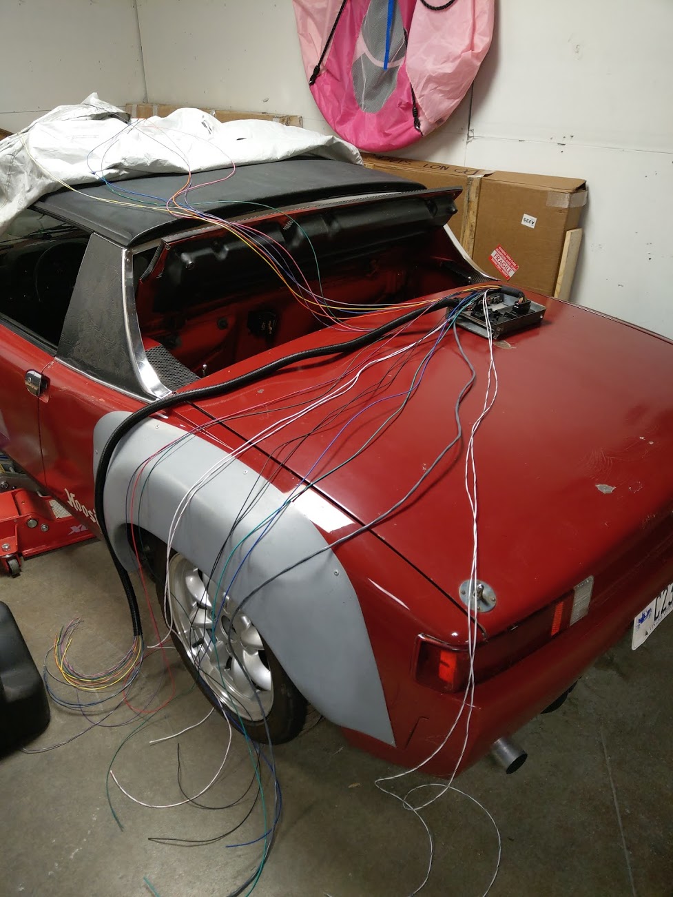

Posted by: JamesM Jan 20 2021, 02:08 AM
and in with.... well... MORE MEGASQUIRT!!!!
Little back story here and then a bunch of pictures.
I have several 914s but the one I refer to as my "autocross car" (which started as my daily driver in the late 90s) has AFAIK been running Megasquirt possibly longer than any other 914 on the planet. For the last 17 or so years it has been the platform I have experimented on and in that time has seen at least 5 different Megasquirt configurations across 2 different motors. This ongoing project is one of the reasons I am so intimately familiar with both Megasquirt and D-jet as to date all the configurations I have ran in this particular car have done so using an unmodified d-jet wiring harness which required a good deal of study/reverse engineering.
At one point my focus was on making a completely stealth setup (looks exactly like a d-jet system) which I did, however as the Megasquirt feature set improved over the last 17 years and my focus moved more towards the overall performance of the system I kept hastily hacking in additional features (mainly having to do with the addition of full ignition control and O2 feedback) and an ancillary rats nest started to grow around my once stock looking system. Remembering what all extra wires plugged in where started to become tedious, especially if I would go extended periods without doing anything to them. With the desire to change/add additional elements to the system I decided I needed to just bite the bullet and build a whole new system from the ground up. Technically i have been planning (sitting on the parts) to do this for years but as the current system ran just fine it was lower on my priority list. The whole COVID situation has allowed me lots of time to get pretty much every other project done on all my other cars, so it was time to move forward with this one.
Details on the system coming out:
ECU: Completely custom (see homemade) ECU board based on the MS1 2.2 circuit design however I modified the injector circuits to supply a switched current rather than a switched ground in order to work with the D-jet harness, and then later retrofitted an MS2 CPU to expand the feature set.
Injectors: Stock 914 2.0 off a stock pressure regulator
Ignition: Full timing control currently triggered via Pertronix pickup modified with a pullup resistor in a stock distributor with a locked out mechanical advance. Output is then from the MS system to a Mallory 6AL CD box (this was a really easy way to trigger a coil from Megasquirt back in the day as it can take a logic level input)
The Goals of this project
1. Cleaning up the engine bay wiring and simplifying the connections (single harness plug to the stock relay board and thats it!)
2. Move to a 36-1 crank trigger
3. Add a 2nd MAP sensor for real time barometric correction (we have some high mountains around these parts)
4. Eliminate the distributor and CD ignition box
5. Swap the LC1 wideband controller for the newer(and smaller) LC2
6. Use a modern Fuel Injector with known voltage offset values (will get more into this later)
6.Stop using the d-jet harness (Will elaborate on this as well)
WHY???!?!
Back at the end of the 90s I was a d-jet purist, carbs to me have always been a step back and never an option for me, so when my d-jet system started acting up one of the things I did at the time was to purchase a new wiring harness made by a company called R.E.S. Systems. This was the only NEW replacement harness available at the time and is still an absolute work of art as far as i am concerned, overbuilt like no other d-jet harness you have ever seen. Needless to say it was not a piece I wanted to take off the car and replace with whatever homemade harness my limited experience could coble together at the time, so i invested time in figuring out how I could retrofit an MS system (also very new at the time ~2003) into an otherwise stock d-jet setup. Now, while doing this does result in a system that works as well as a good d-jet system I am here to tell everyone once and for all that D-jet does have some inherent faults with its design and that those faults become very apparent when you can see them in data logs and also when you realize that a lot of the known d-jet operational "quirks" follow you when running a modern ECU on the d-jet harness. The nicest d-jet harness in the world does not eliminate these issues, they are inherent in the design.
So in the interest of having the best running car possible a new design harness is needed, which is fine by me as i want to integrate everything into a single harness anyways.
Other things to come with the new build, modern 43 PSI injectors should atomize the fuel better, in addition having known voltage offset tables is mandatory to achieve the most consistant tune across all operating conditions. The change to the 36-1 crank trigger is for increased accuracy but also to improve ease of cold starts over the 4 tooth cam trigger.
Getting rid of the distributor was not mandatory but I had an idea for a new setup I wanted to try out, so its getting worked in the changes as well.
Had a week of vacation time to burn after Christmas that seemed like the perfect time to get this all done so...

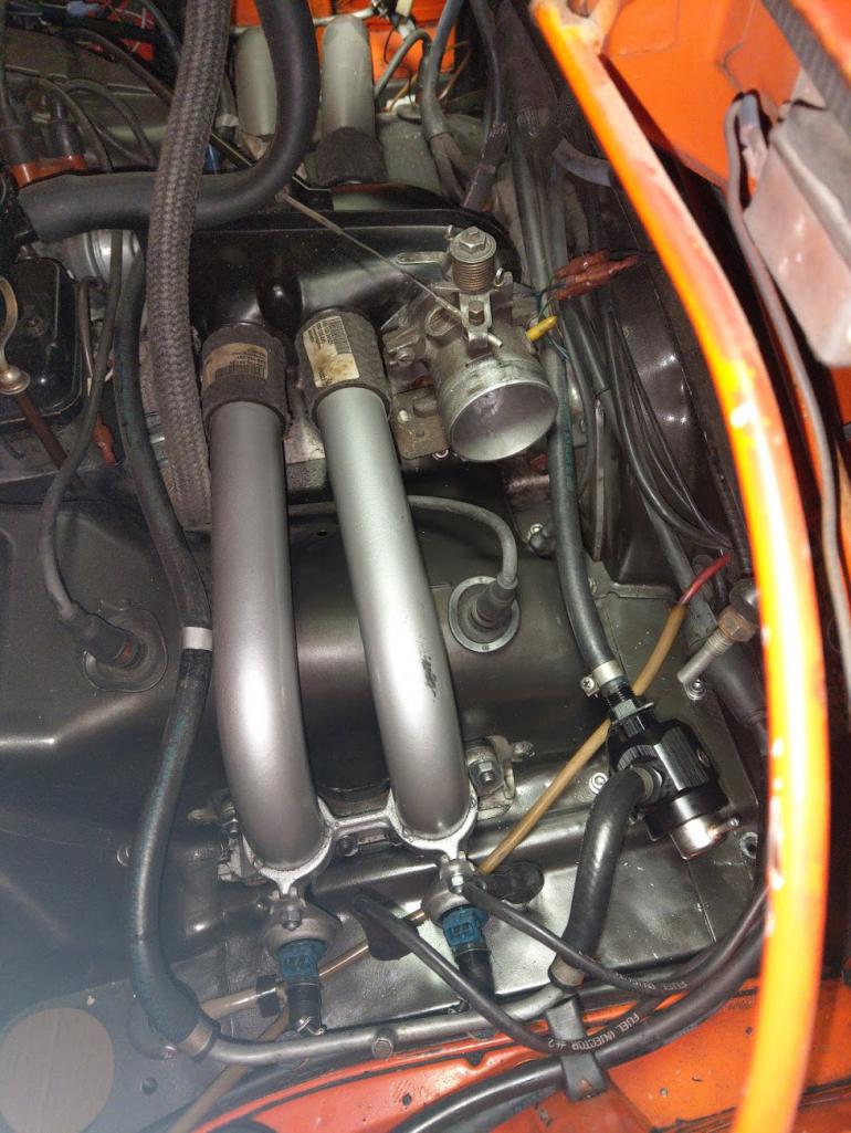

on with the show...

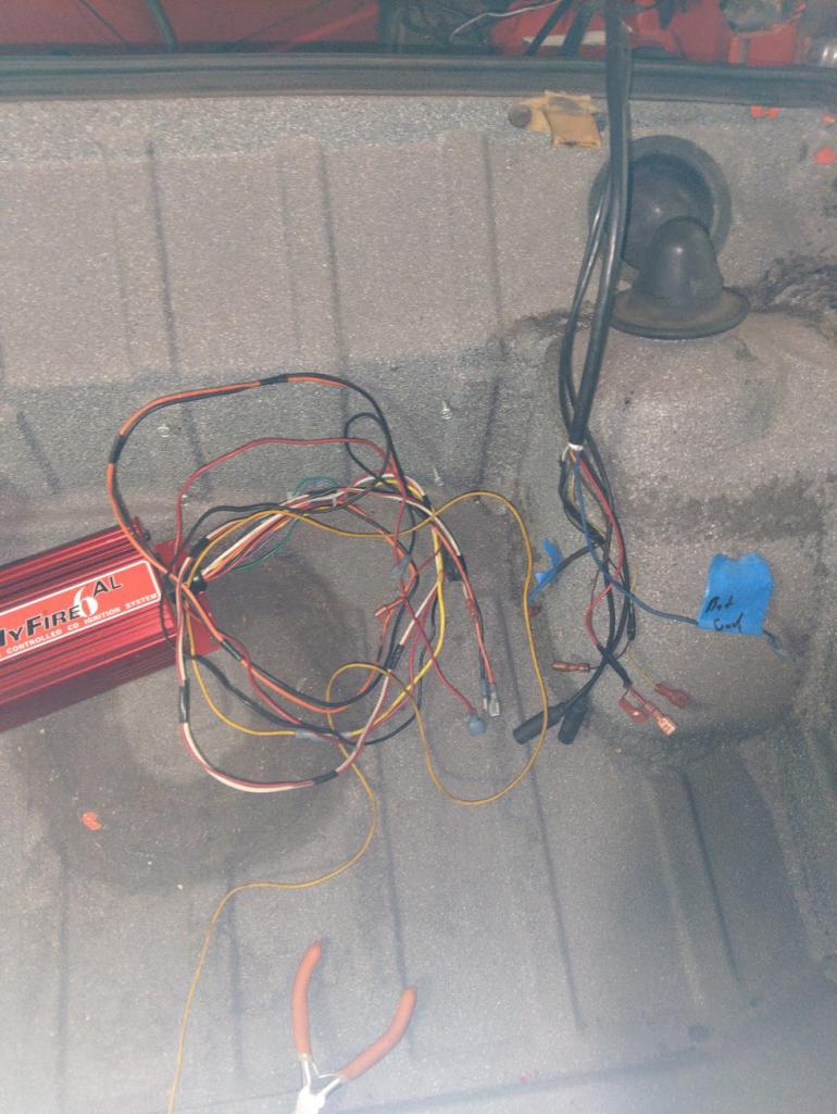

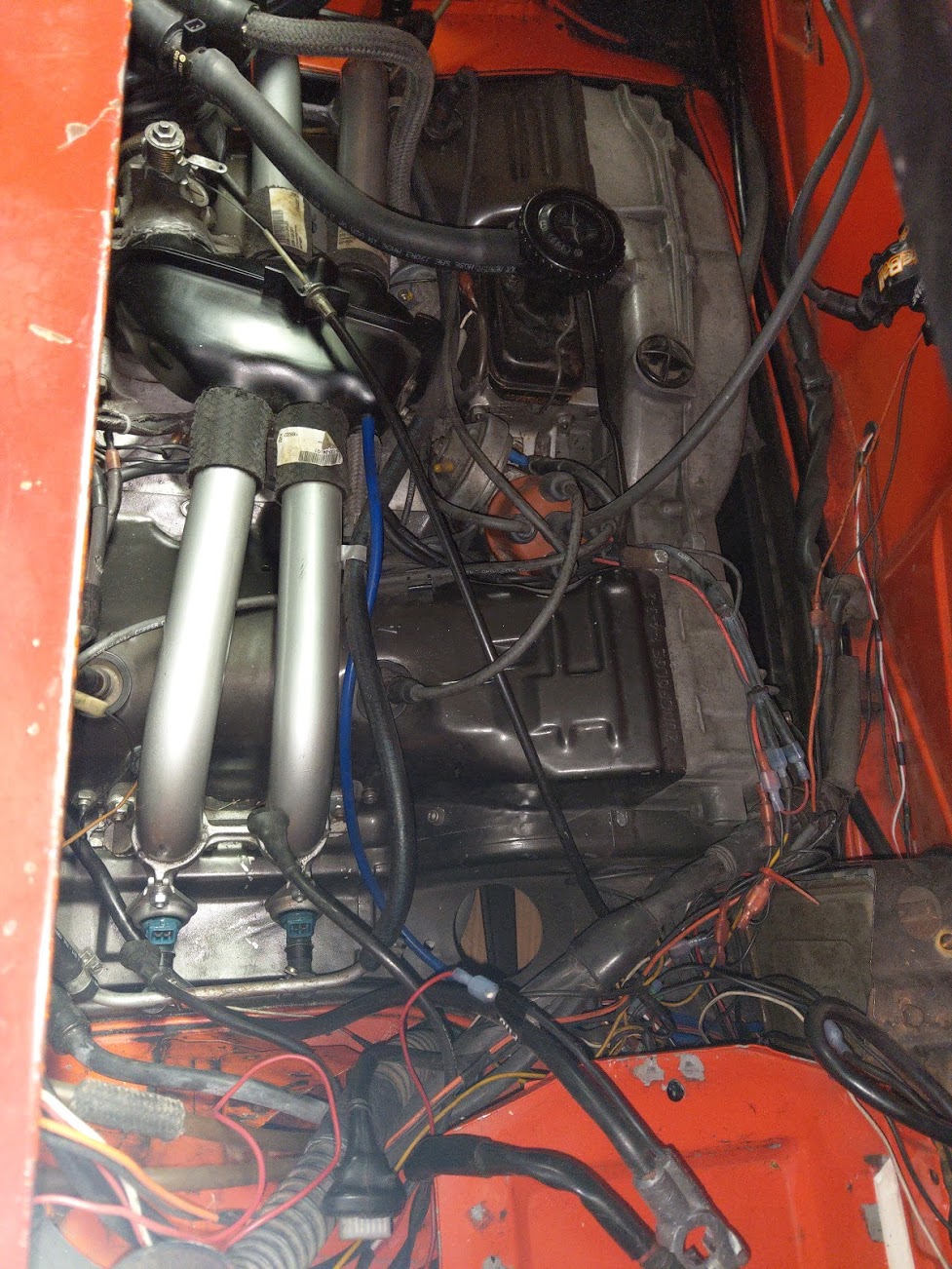

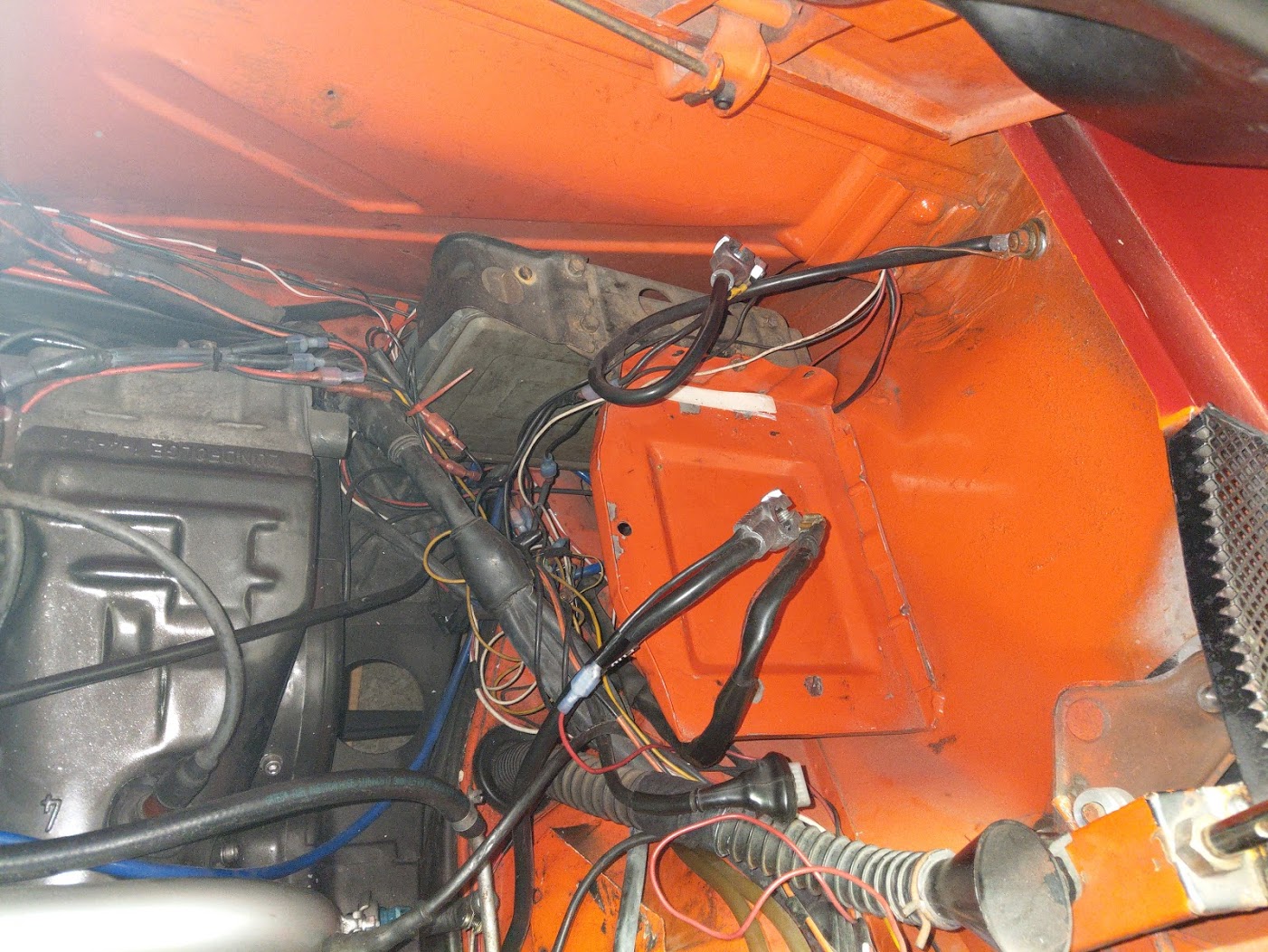

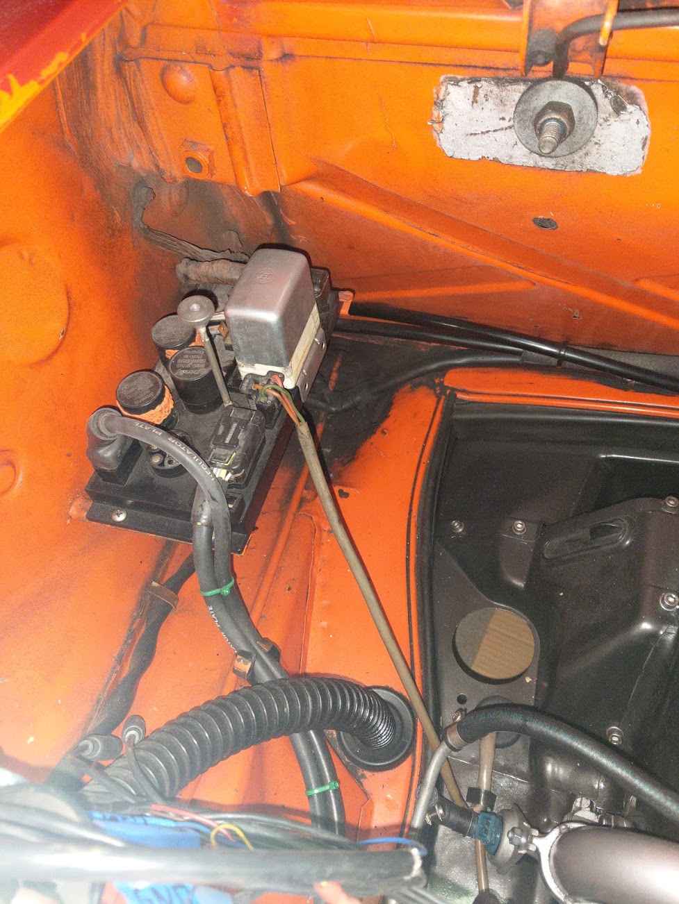

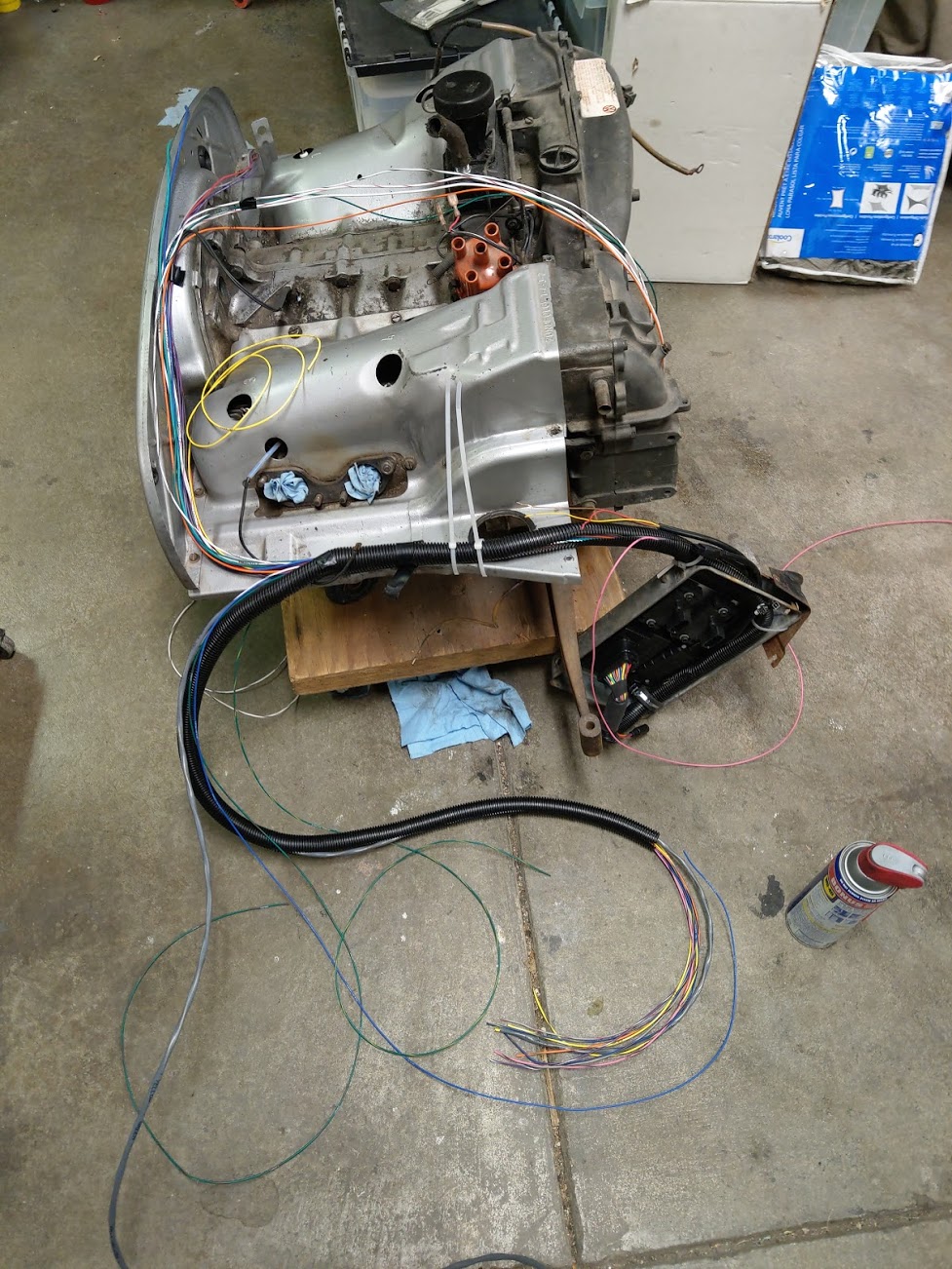

Posted by: JamesM Jan 20 2021, 02:36 AM

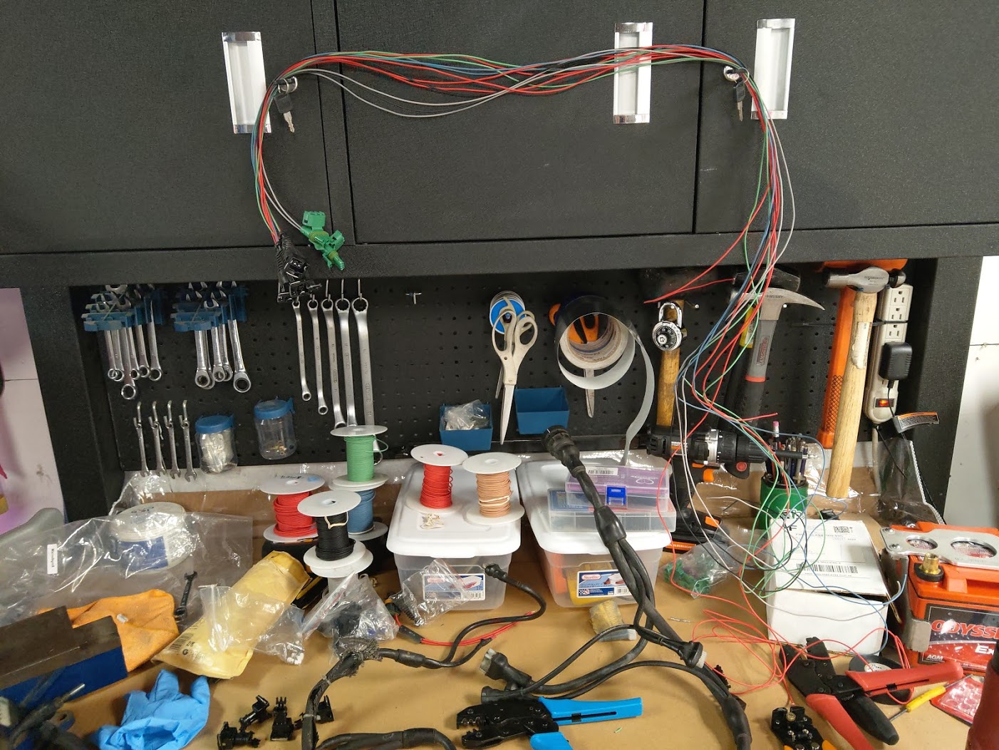

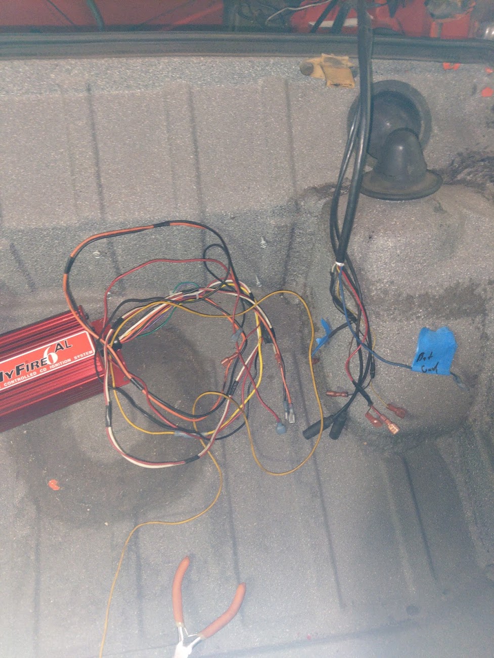

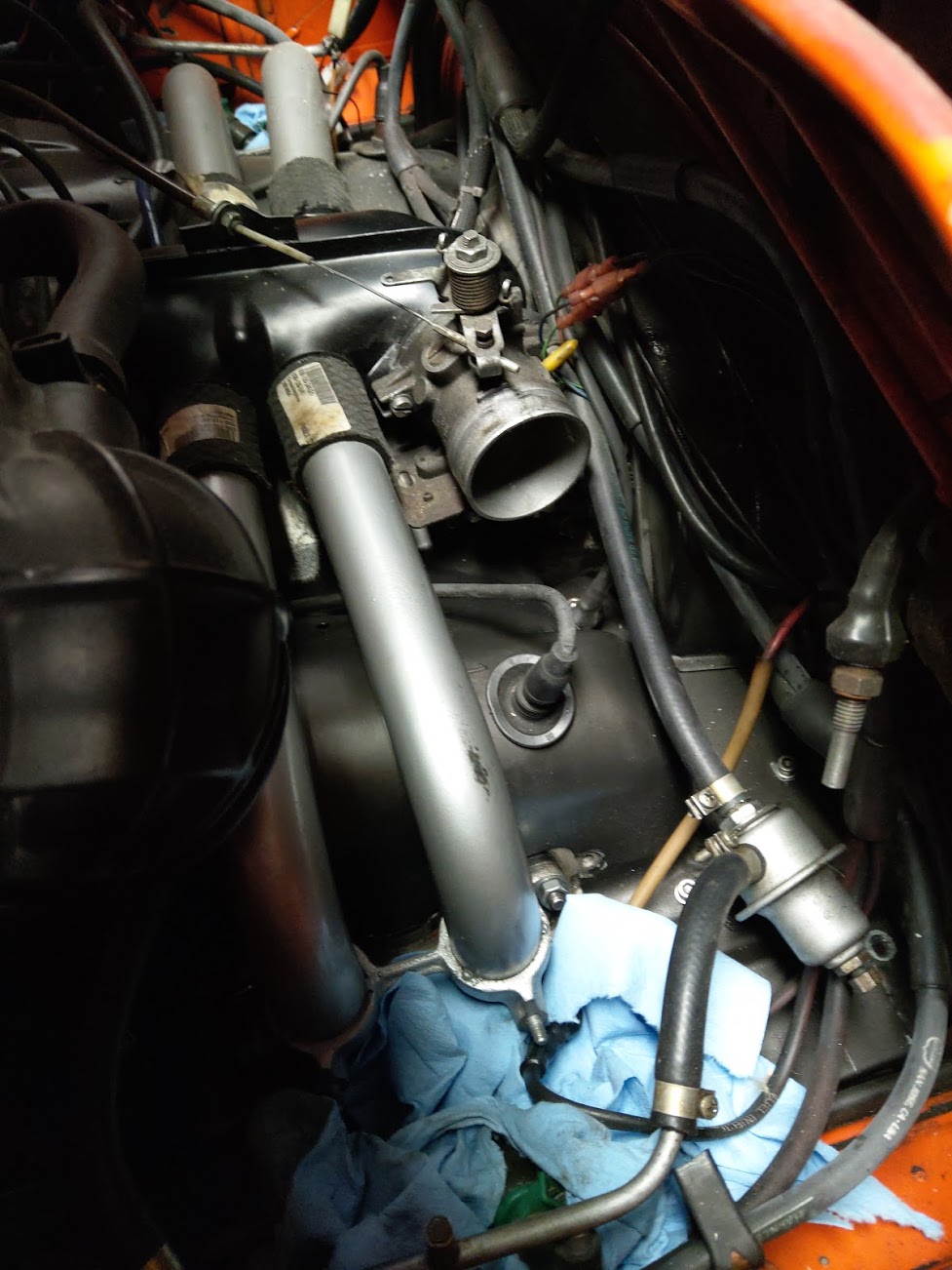

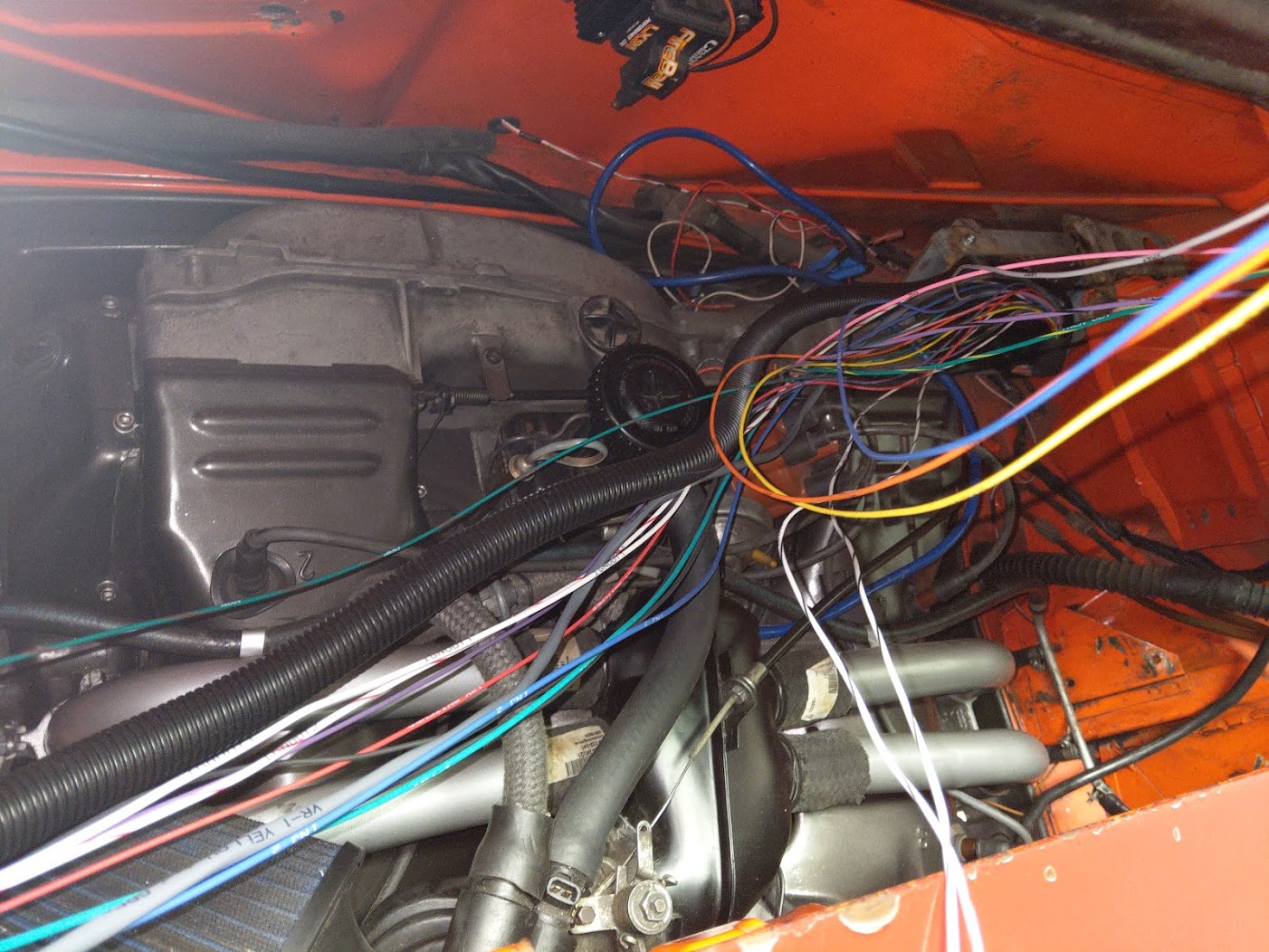

Factor contributing to the rats nest, coming out!
And the ridiculous amount of wiring connection the LC1 wideband needed

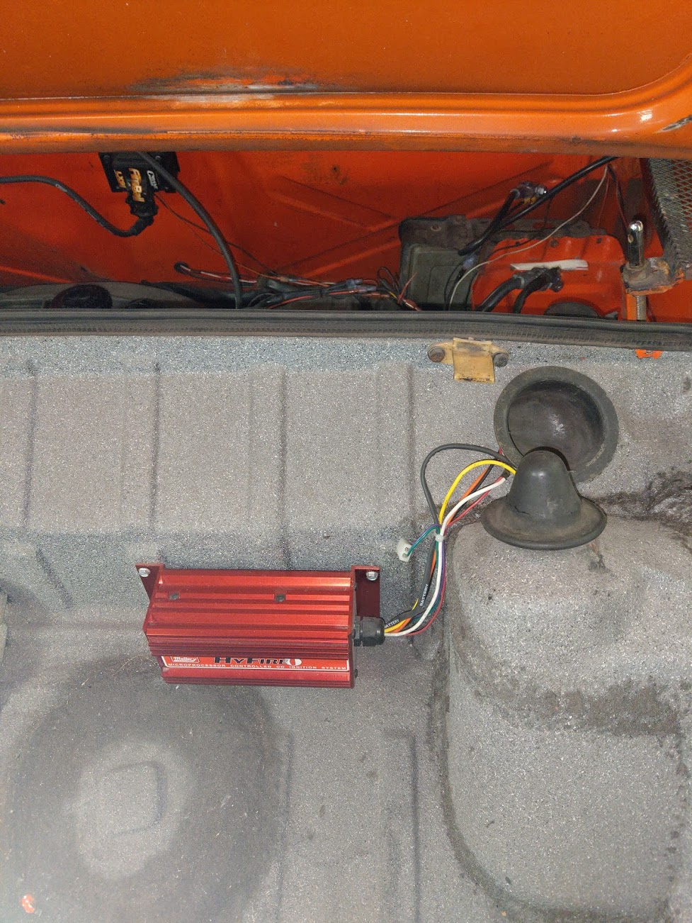

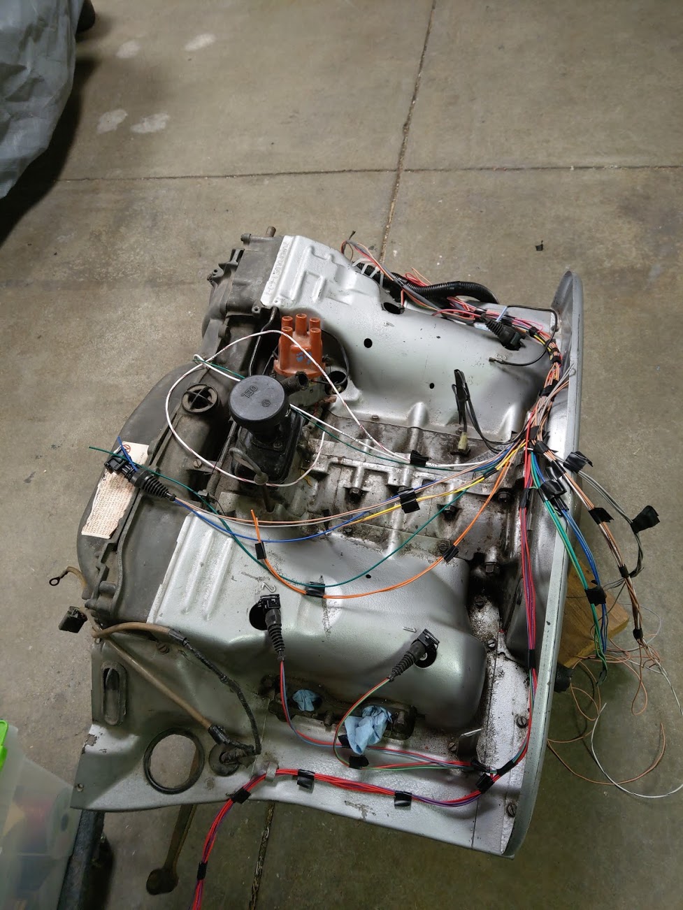

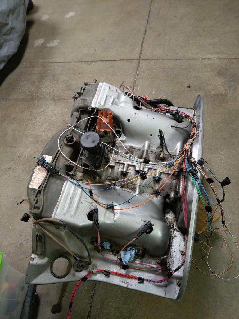

Posted by: JamesM Jan 20 2021, 02:41 AM

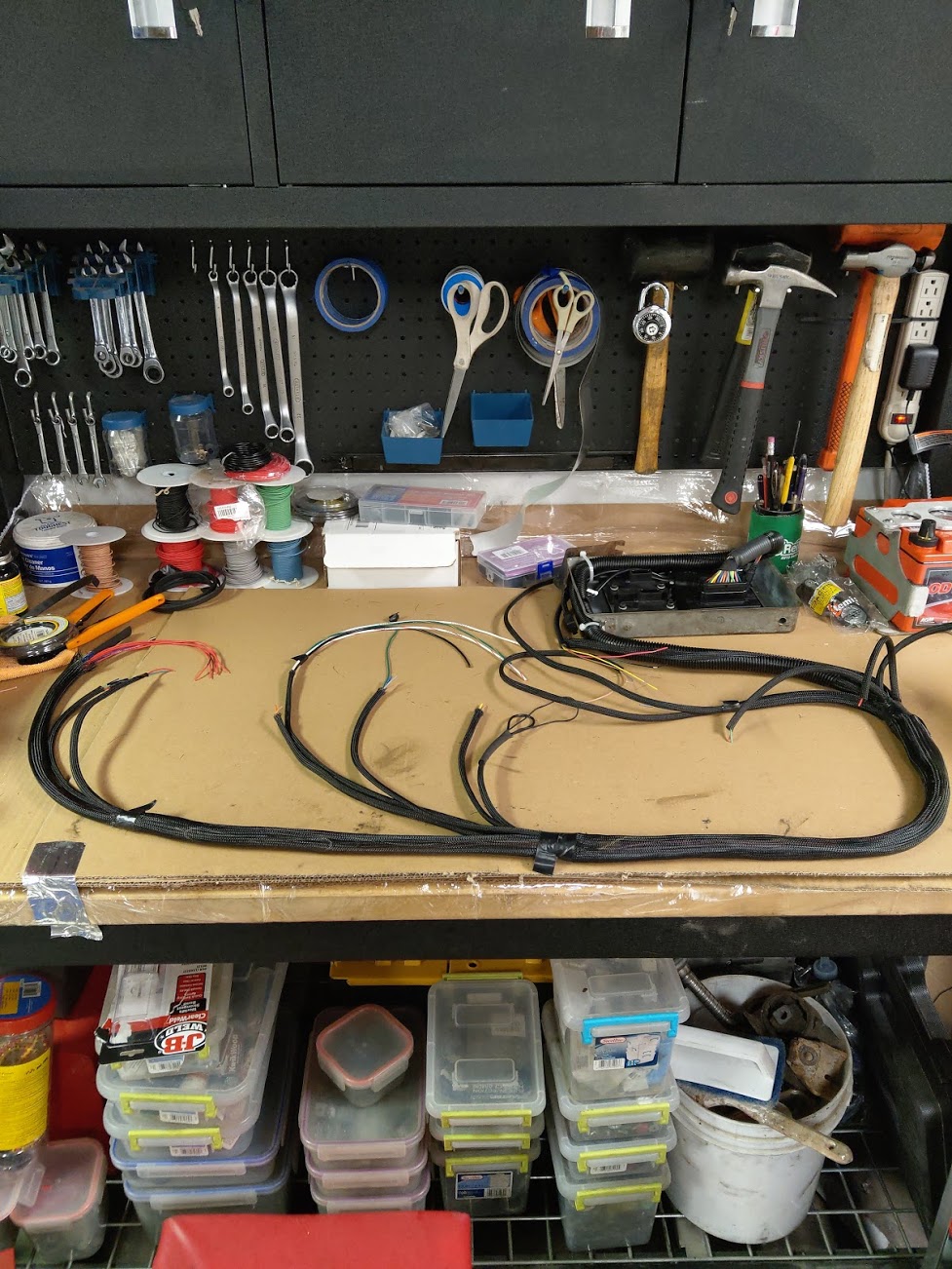

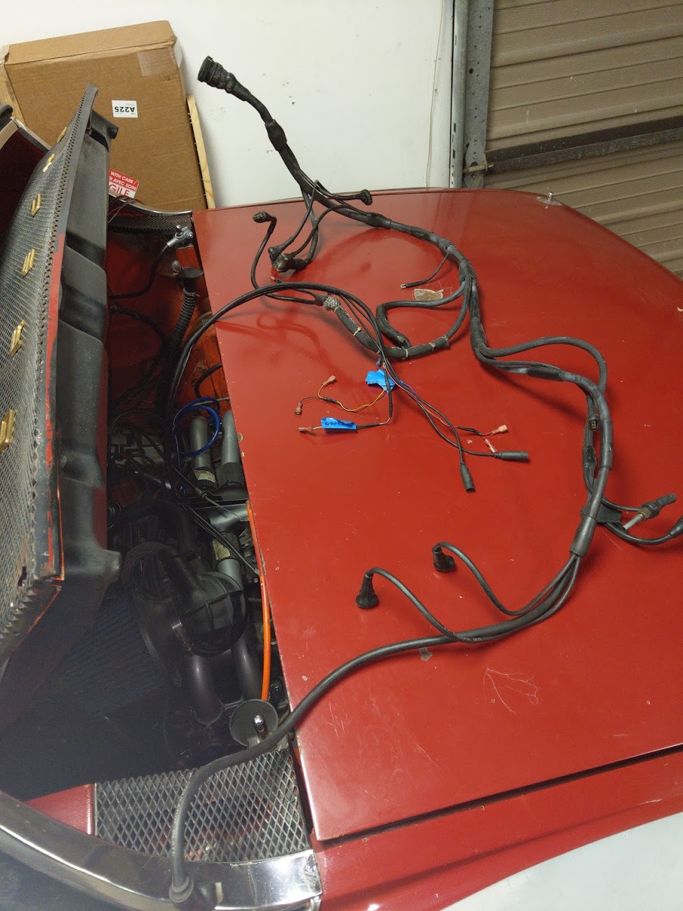

and now the part that makes me sad... pulling the beautiful RES Systems D-jet harness. Almost 20 years later this thing still looks practically brand new. just a tank of a wiring harness with every connector and junction properly sealed to water proof it and every connector labeled.
If i don't wind up putting this in another car it will probably go up on my garage wall as art!

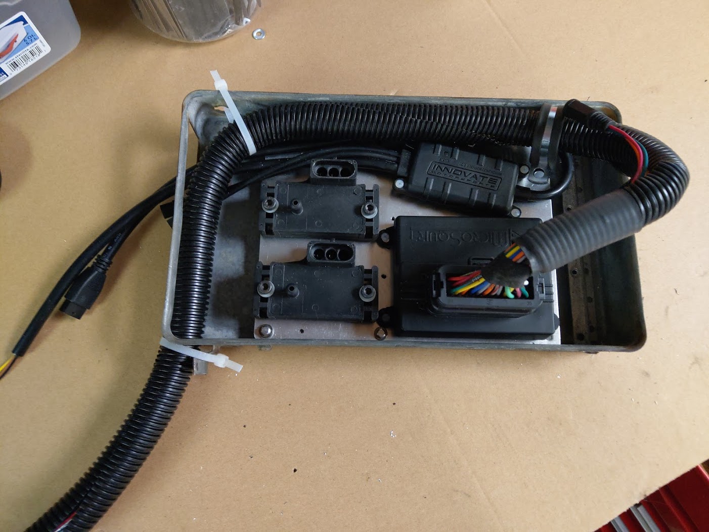

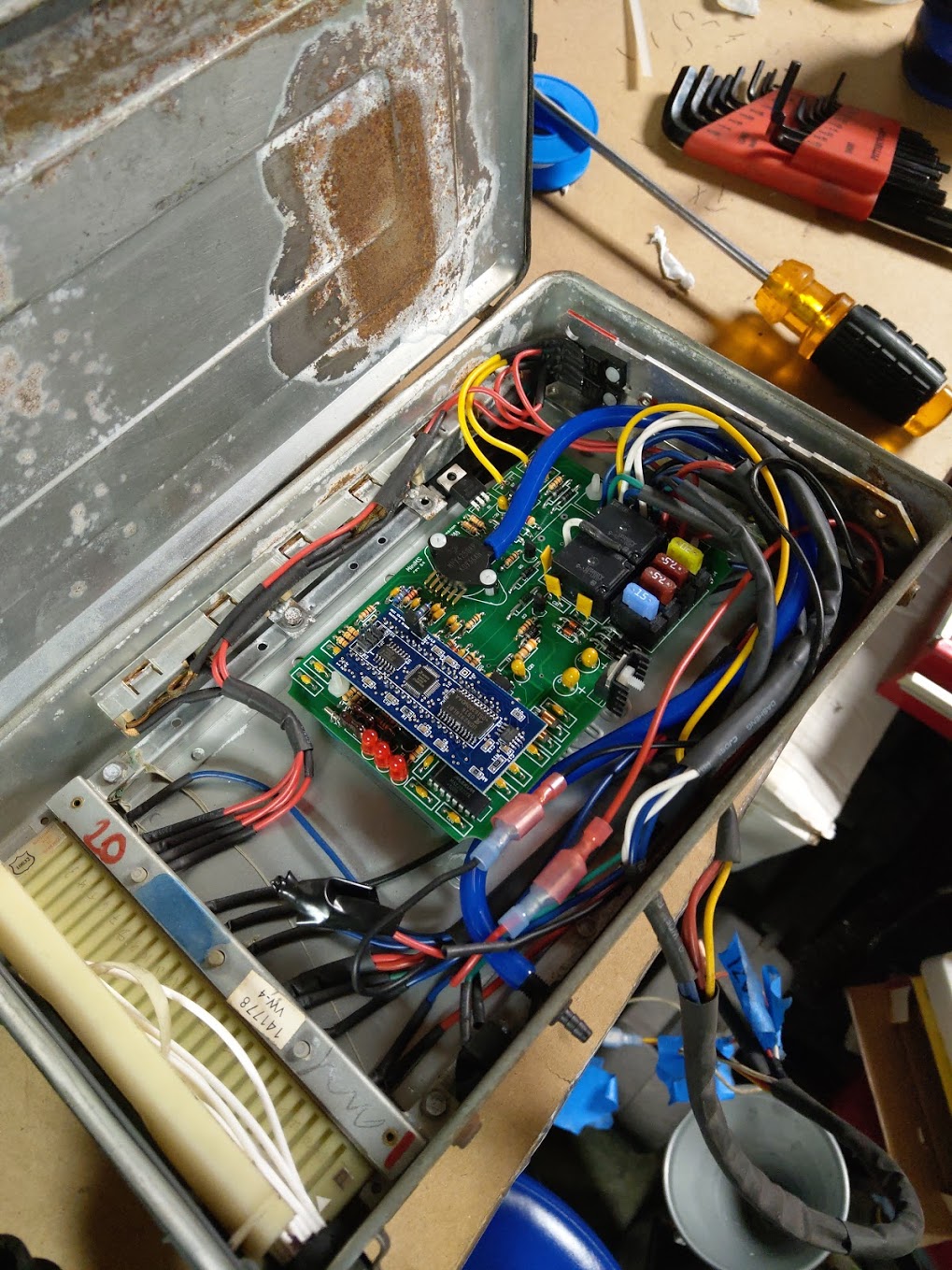

Posted by: JamesM Jan 20 2021, 02:48 AM

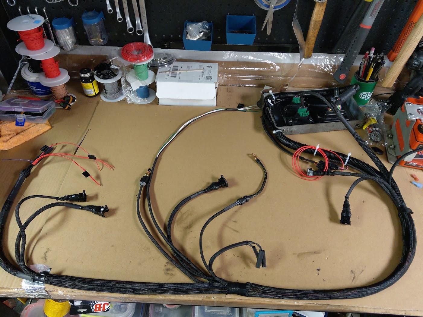

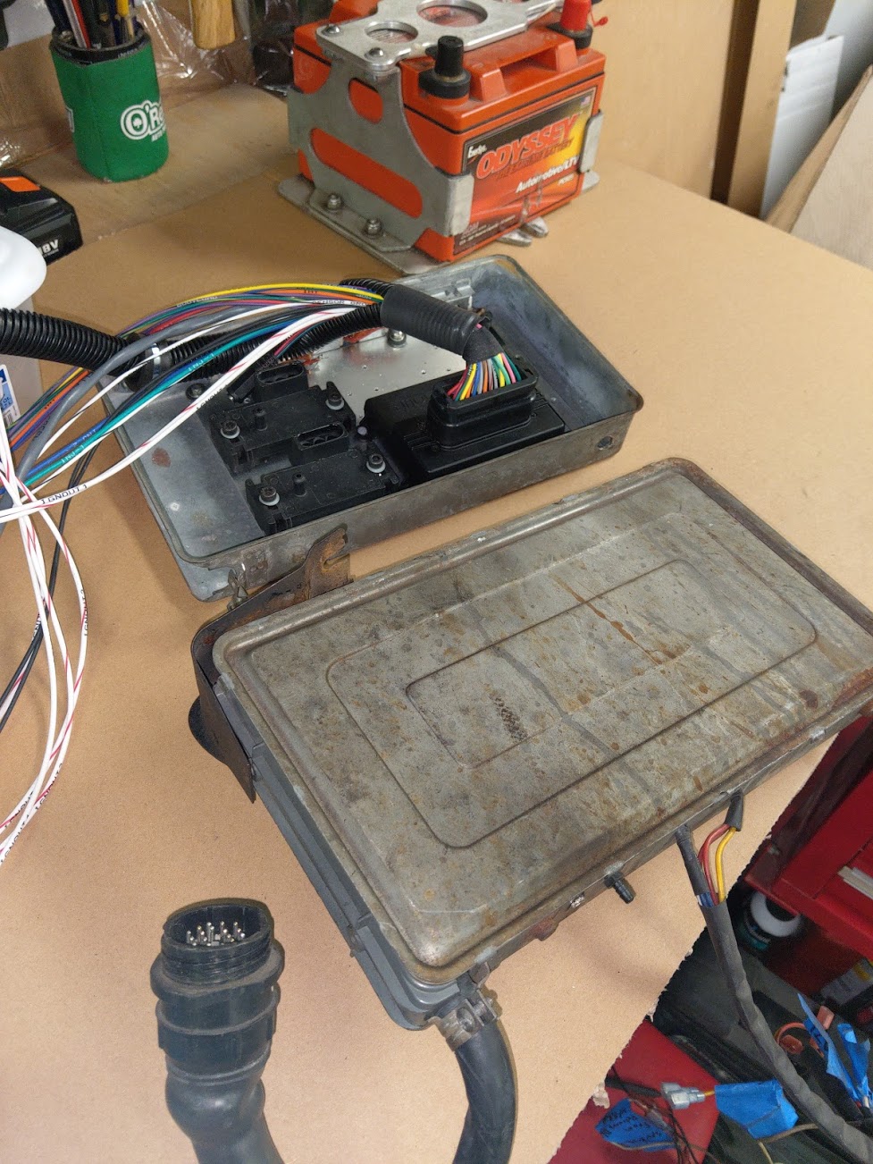

New ECU is just going to be an off the shelf Microsquirt. No more 12 hours of labor custom building circuit boards for me!
I had a gutted d-jet ECU case from another one of my previous MS builds, so i re-purposed that as a bracket for the ECU, both MAP sensors and the new (much smaller) LC2 wideband controller.
My old MS 2.2 custom board d-jet harness compatible ECU next to the new Microsquirt setup, not quite as trick looking but I may revisit that later.

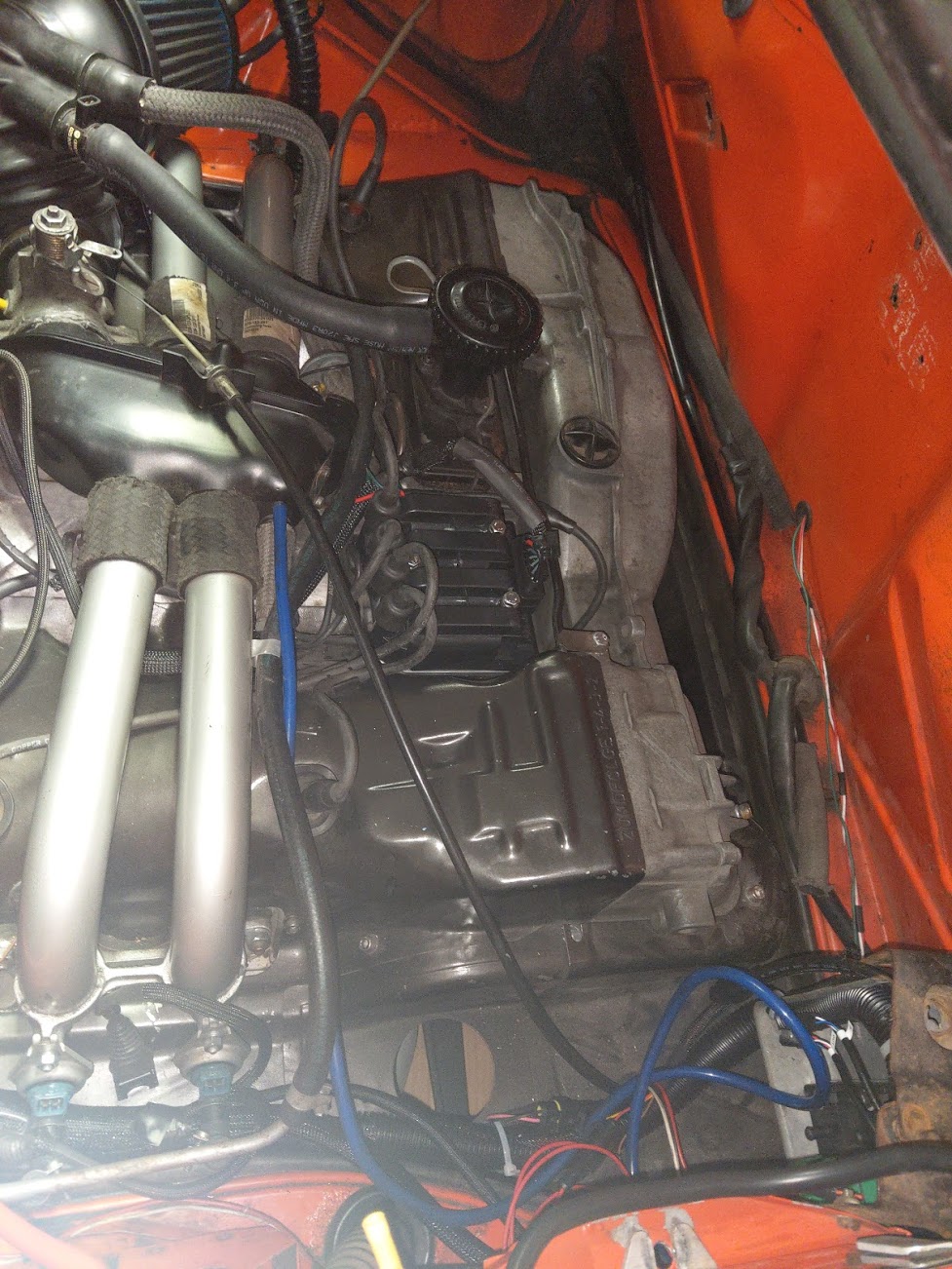

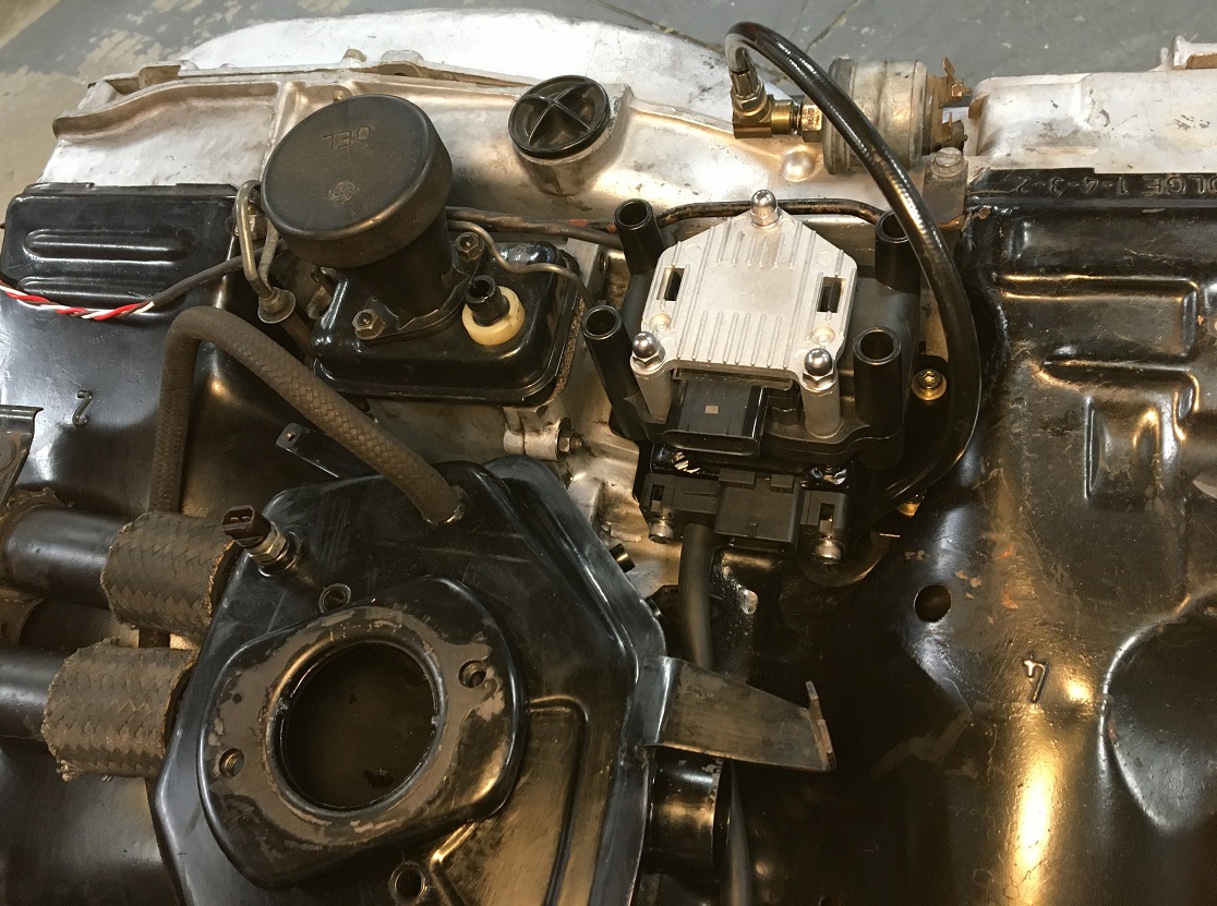

Posted by: JamesM Jan 20 2021, 03:50 AM

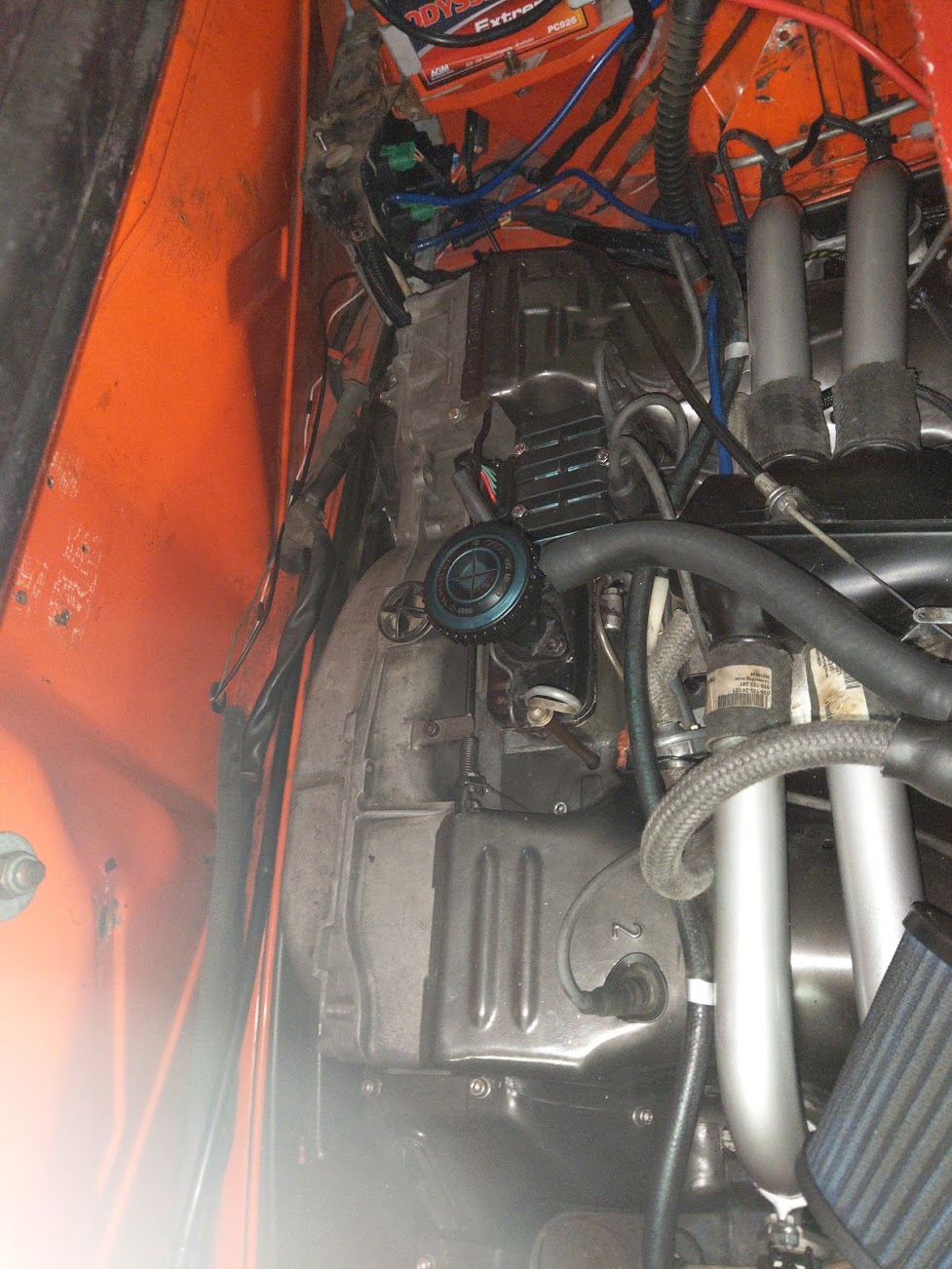

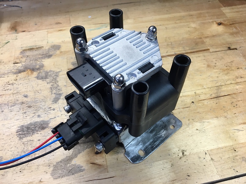

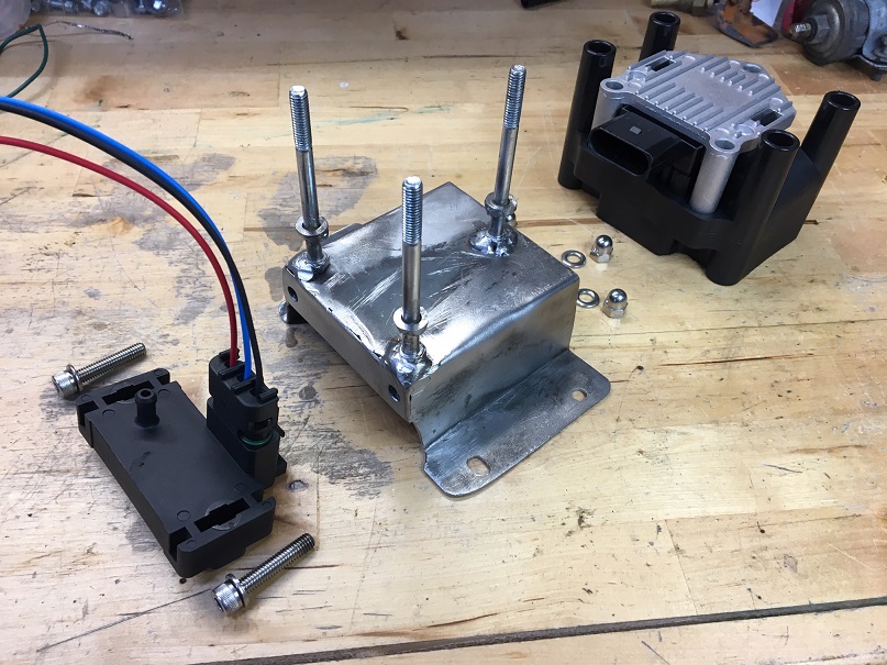

The coil pack is the biggest unknown/experiment of this current build as I was not able to find a lot of documentation on it or reports of people using it.
I have previously used VW 2 channel logic level wasted spark coils on build i have assisted people with and good results however wasted spark coils have a short coming in that 2 of the plugs fire with reverse polarity resulting in increased and uneven spark plug wear. As i am going for maximum precision and reliability here (and i don't enjoy regular plug changes on Type 4s) Newer cars run dual platinum plugs to offset this wear, but i wanted a solution where i can run the stock copper plugs. I figured i would experiment with a different potential solution.
This experiment comes by way of another VAG coil pack, only this one is a 4 channel (CPP) logic level pack. First issue there though is that without additional harness modifications the Microsquirt only controls 2 coil outputs however being a logic level coil in theory I can tie the input pins together in pairs and batch fire them, essentially firing the same as a wasted spark but with all plugs using the proper polarity. Only concerns I have are is the logic built into this coil going to allow me to fire off 2 coils in the pack simultaneously without issue, and as this motor spins to 7k RPM and ill be firing the coils at essentially twice the rate they would in a factory application, can they take it or is there protection built into the logic circuitry that wont allow this???
TBD
It sure does look cool though!

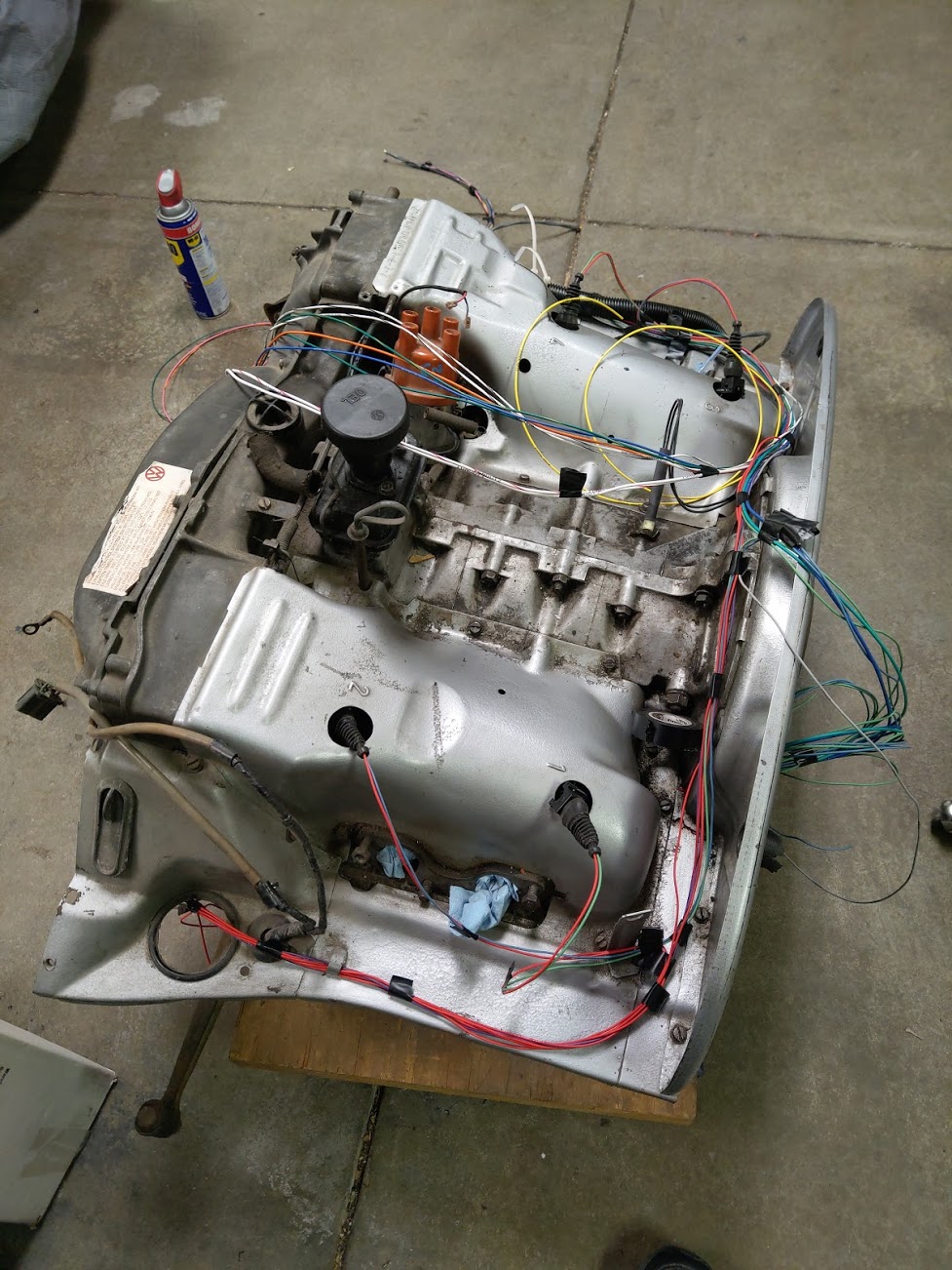

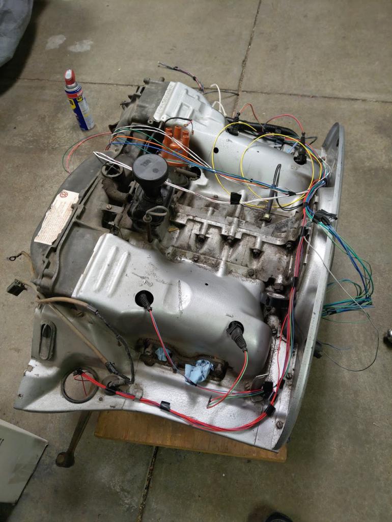

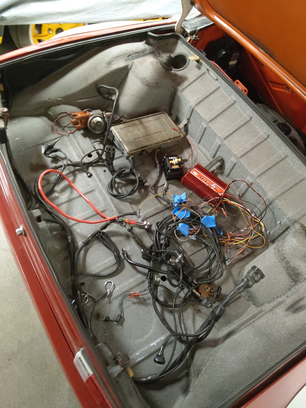

Posted by: JamesM Jan 20 2021, 03:53 AM
The entirety of everything that came off the car in this endeavor
glad to be rid of the mess

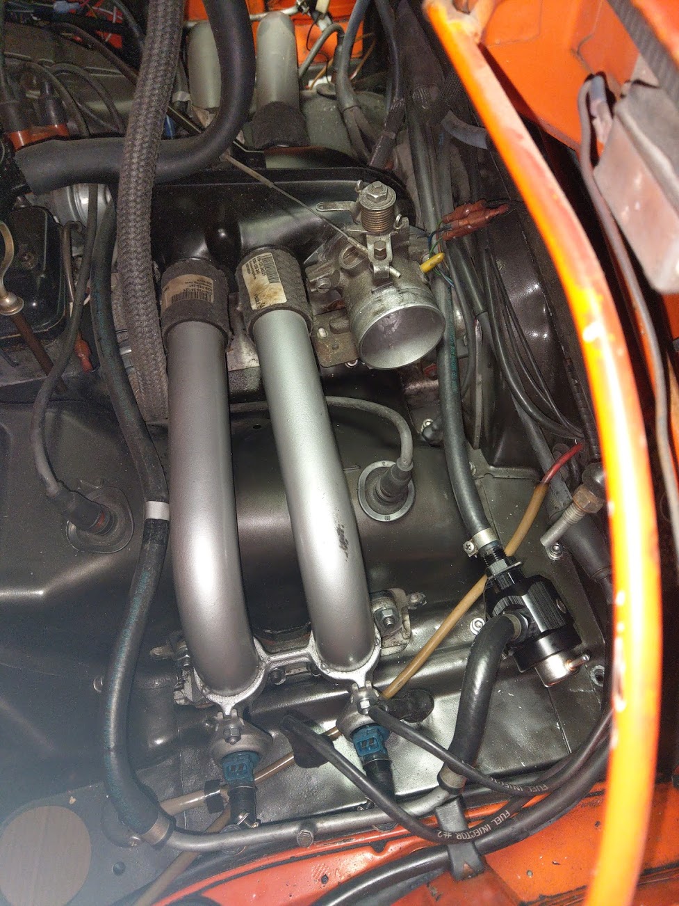

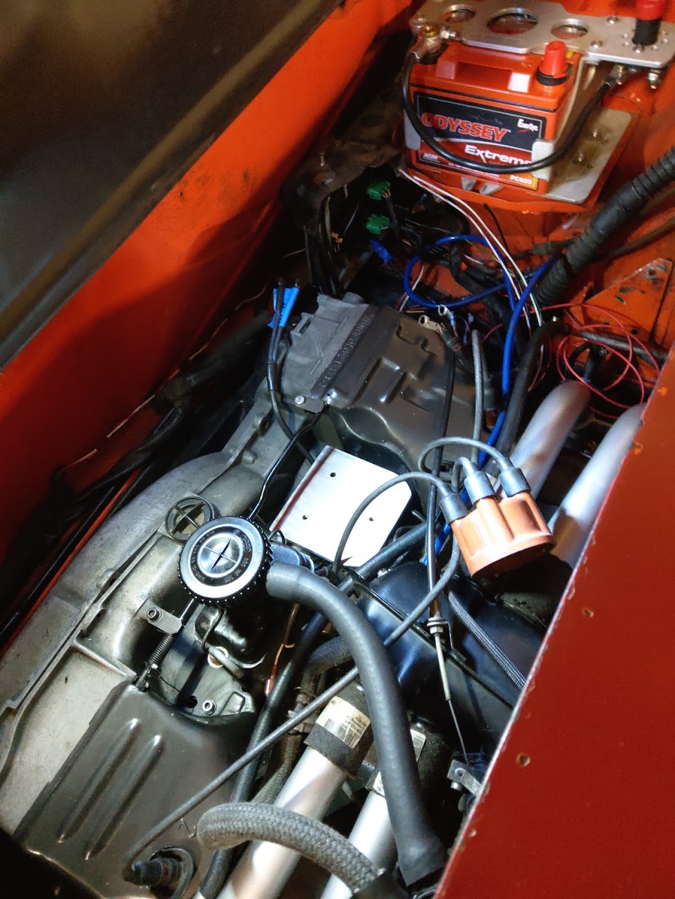

Posted by: JamesM Jan 20 2021, 04:01 AM

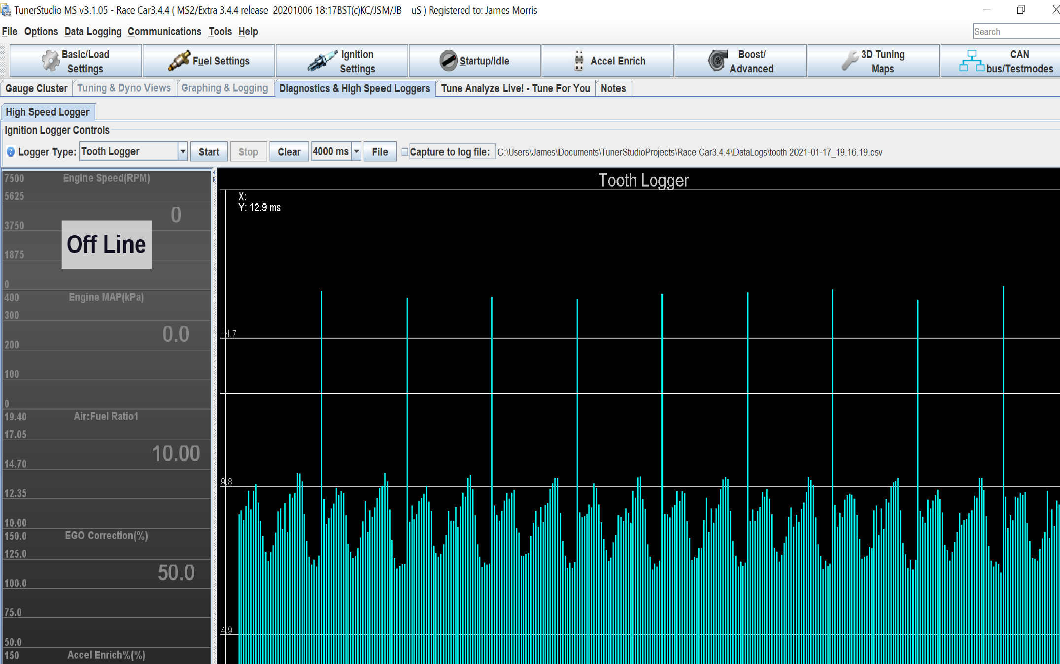

Pre flight checks on the new 36-1 crank trigger looking good!
This should help a lot.
Static tests from Tuner studio confirmed injectors are firing properly and
I can indeed batch fire the coil pack as hoped.

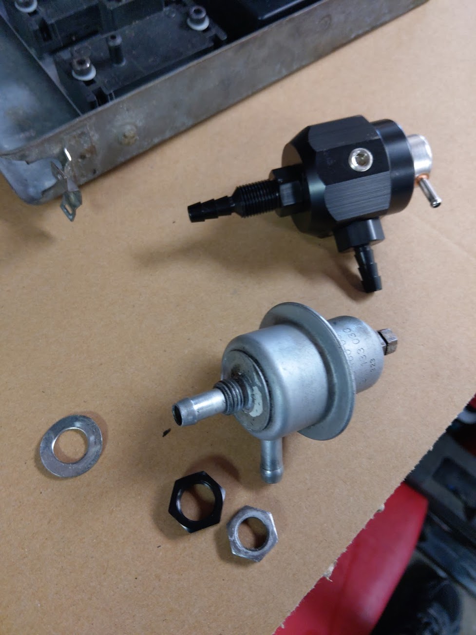

Only issue during pre-flight was a fuel leak at the new regulator during the fuel pump relay and pressure test. This was at the plugs where you can install pressure sensors. Had to take some extra measures to seal them up, but all is well now.
Always nervous as hell to fire a new MS build, but happy to report she fired up on the first attempt.
Now to wait for warmer weather so I can get a proper tune on her.

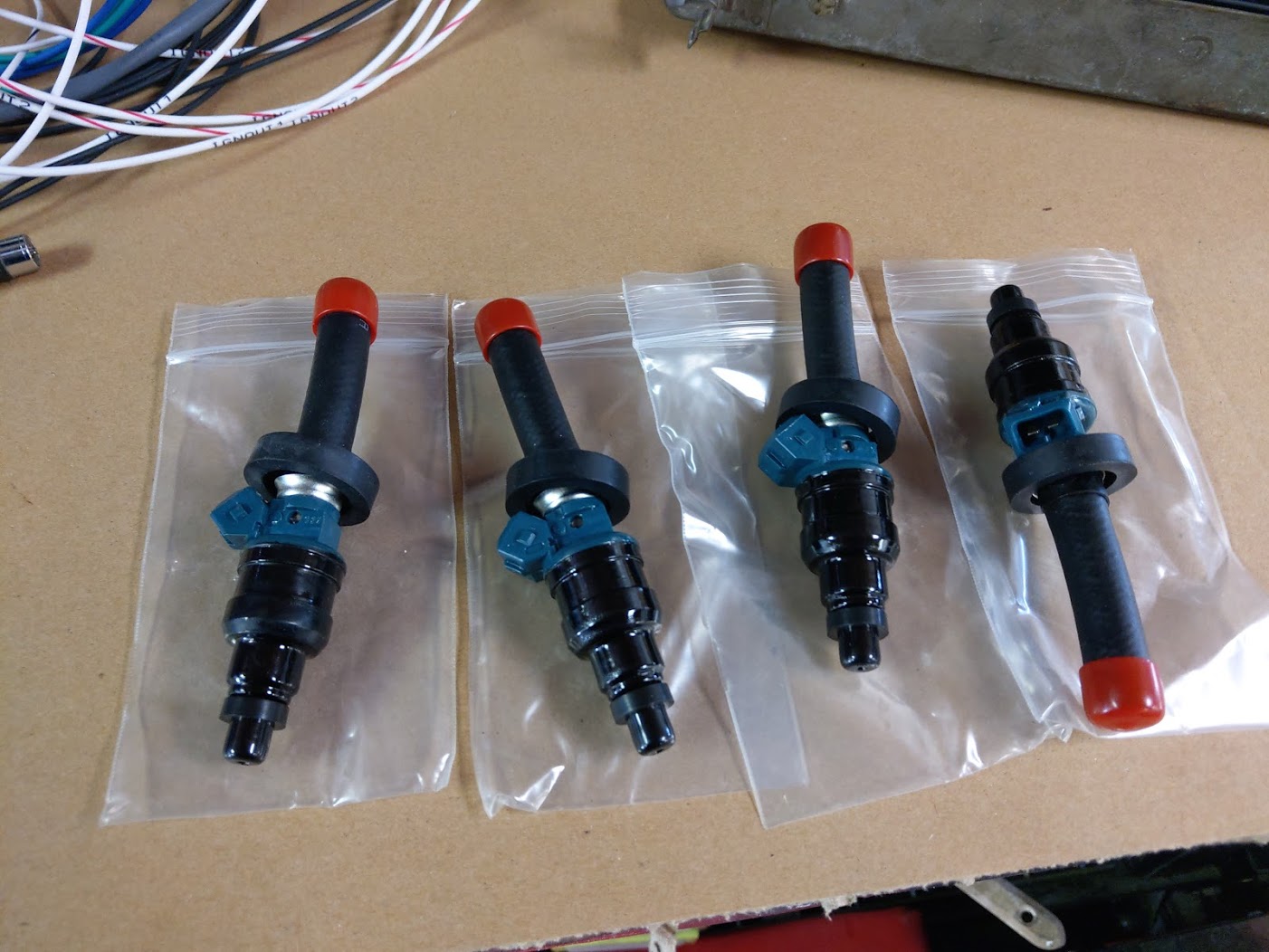

Posted by: BeatNavy Jan 20 2021, 05:02 AM
James, that's excellent. Thanks for posting this. I've got a small rat's nest in my setup as well, and I'm looking to clean it up with better wiring connections and routing. But I'm in the same sort of boat -- there's a tension between wanting to test something and improve it versus cleaning it all up and declaring it done and final!
One question: what model injectors are you using?
Again, looks great and thanks. Hopefully you do get some warm weather soon

I use the VAG IGN-4 ignitor/coil and it work great. However, my initial installation was on a steel plate I fabbed that sat across the disty retention stud and two engine tin screws. As the weather got hotter this Spring I started getting a lot of ignition cut-outs...short answer was the IGN4 was overheating, sitting on that plate mounted directly to the engine block.
Short term I moved it to sitting on top of the cooling fan, and I've yet to come up with an elegant replacement solution. I like yours and suggest that may keep the coil far enough away from the engine heat to allow air to circulate around it.
I've got an old 009 hanging about, might try fabbing something.

Greg, what about a phenolic block spacer, kinda like what was used under the runners at the heads...

QUOTE(BeatNavy @ Jan 20 2021, 04:02 AM)
It is hard to tear something out again when its working just fine. Little easier for me in this case in that the shortcomings of the d-jet harness were just becoming way to apparent. Once i get a tune on the new setup ill have to post a comparison of datalogs from the old and new systems as they are a night and day difference.

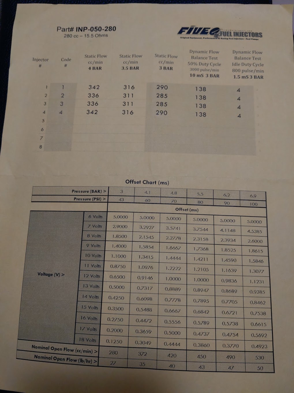

As for the injectors, they are an off the shelf part from FiveO Motorsports so no need to go sourcing anything used from a wrecking yard.
https://www.fiveomotorsport.com/a280-a380-high-impedance-hose-type-fuel-injector/
Lots of advantages over stock d-jet injectors, New(not 50 year old NLA parts) High impedance, Ev1 connectors, standard 3 bar pressure (try finding a good 2 bar d-jet pressure regulator these days) more reasonable flow rate (d-jet 2.0 injectors are pretty oversized) and probably my favorite part is that they come with documented flow data and more importantly, the voltage offset data. I was actually surprised at how low the dead time on these was when running at 3 bar. Knowing the proper dead time and voltage correction is critical for keeping the mixture consistant under varying system voltages. If you have issues with your idle dropping due to changing mixture when you turn on your headlights this may be why. I was so excited to test this that turning on the headlights was one of the first things i did once i got the idle mixture mapped in. No more idle dip! In theory someone could deduce the proper value for the d-jet injectors through trial and error, i just was never excited enough about doing that work.
After working on so many MS systems for myself and others I have developed a preferred list of hardware that I recommend, and these are my pick for use with stock intake runners if you want to eliminate any compromises.
Available in higher flow rate to if needed, or you can up the pressure as 3bar is the minimum spec on these.

Heat is one concern I have in the back of my mind for sure with this coil setup but wont know what the end result will be until it warms up and I can get it out on the road. Like i said this coil pack setup is probably the most experimental part of this build so I cant yet speak to its reliability.
Assuming the coil you are running is the VAG 032 905 106B wasted spark coil? In the past I have had good results with when working with that pack however never tried it mounted where the stock distributor goes. The one issue I did observe though (and one of the reasons for trying something new) was some unusual/high rate plug wear. The plug had completely eroded the center electrode in less than a couple thousand miles. At the time I was not sure if it was due to a defective plug or the ignition system itself but after doing further reading it sounds like this is the nature of wasted spark coils due to the reverse polarity on half the plugs, band-aided by manufactures with the use of platinum plugs.
Curious if you re-checked your plug gaps after running the coil for a while now?
Also curious what your total dwell is when you are running? Wondering if excessive dwell may be contributing to excess heat in the coils? Wasn't able to find much specific information on either one of these packs around dwell requirements but information I was able to find on other VAG coils that was extracted from VW ECUs seems to indicate VW in general runs their coils with far less dwell than the suggestions I have seen on MS forums and manual.
Given this, I aimed on the lower end of the spectrum for the initial setup and am not seeing more than 2.8ms dwell when running after voltage corrections are applied and this value may even still be high based on the VW ECU tables I have seen where they are running roughly 1/2 of that. But again, no idea really as I have not been able to find any concrete documentation. Time/experimentation will tell. So far though the coil has been cool to the touch, granted this was only ran for about 20 minutes with no load with weather in the 30s. May be a different case when autocrossing when its 105 out.
One thing I considered doing when installing the pack in the first place was using spacers on the bolts between the coil and the mounting plate to allow air flow under the coil as i believe that is how some are mounted in the factory applications. Didn't have spacers on hand but i may go back and revisit that as well.
ill let you know how it turns out.

When I was troubleshooting the cut-out issue I ended up backing off the dwell settings from where Mario (DubShop) recommended. I'm currently running Standard Dwell, 2.2ms Nominal, 1.0ms spark duration. Runs/starts quite good; I'm figuring it would work fine with less.
I have not dinkled with the battery corrections; it's at 88%@16V, 102%@14.0, 128%@12.0, 168%@10.0V. I'm running a Lithium battery so field voltage tends to run high, around 14.2-14.5V running.
It runs warm to the touch after dirivng for some time, but not so hot that it will burn. But it is in the engine compartment so hard to gauge. It was wicked hot when it was mounted to the block; my infrared indicated 180* at one point. Can't really say if that was due to higher dwell or being mounted to the block, but the cut-outs stopped immediately after I moved it.
@http://www.914world.com/bbs2/index.php?showuser=12152 , I think it needs airflow, like James describes.

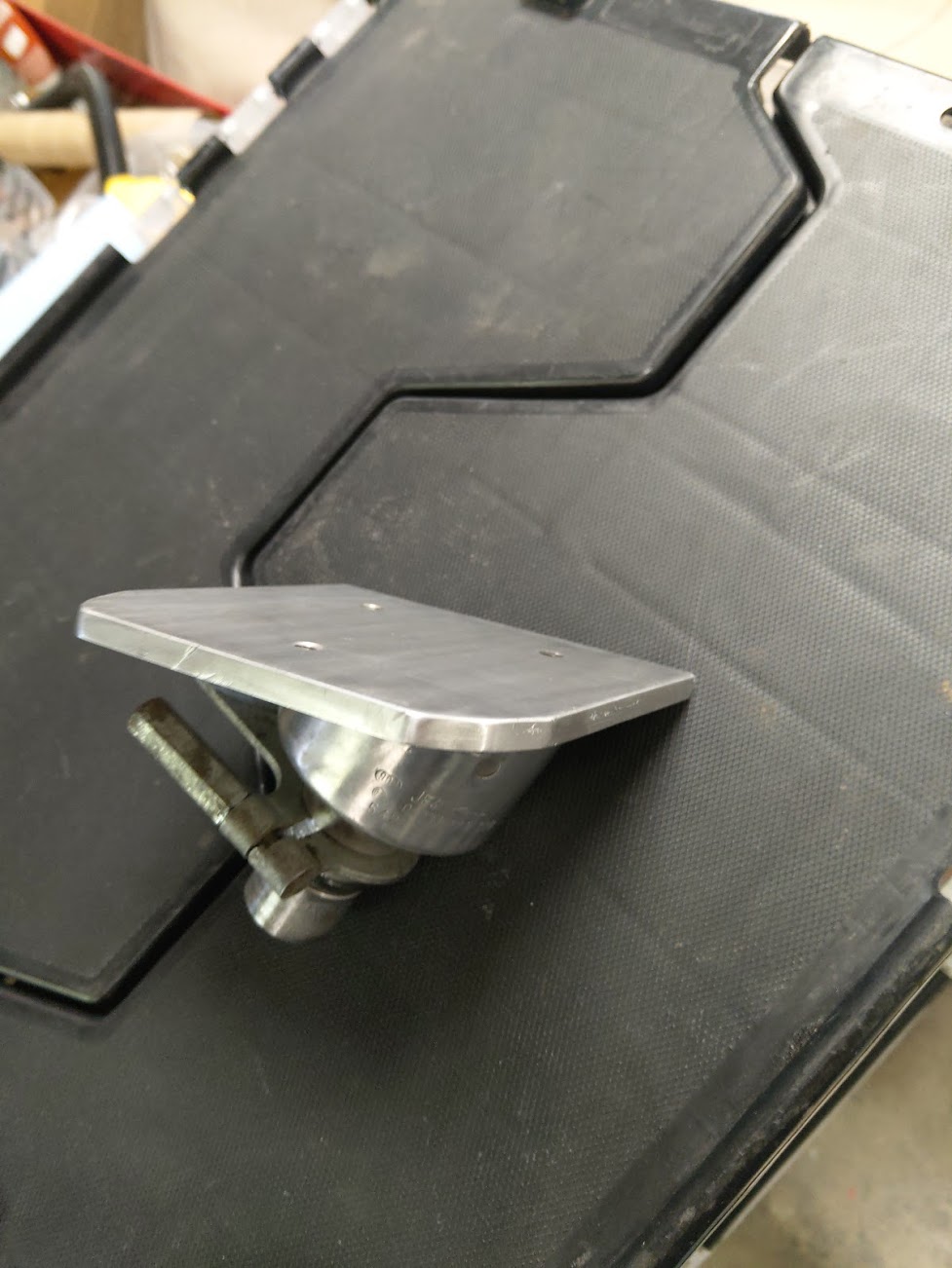

Here is my coil bracket I did out of ~16ga steel. It also supports the MPS and does mount on the tin and distributor stud. Raised, it incorporates three studs so it supports the coil like it was intended. The coil is off of the bracket base by a small gap, but after @http://www.914world.com/bbs2/index.php?showuser=15565 's experience, I fear it might overheat.
Also, since then, I went with @http://www.914world.com/bbs2/index.php?showuser=5834 recommendation and got another MPS for barometric pressure, so that will need a location too...
James, will there be any cover on your ECU or it is just a support structure? I have been debating as to where to put the ECU. Greg cleverly installed his underneath the relay box, I was thinking maybe inside the cabin, away from the heat. The stock location is appealing though.

QUOTE(Montreal914 @ Jan 20 2021, 02:18 PM)
Definitely following this thread closely
2nd map sensor is for sure recommended if you have some extreme elevation changes, my weekend drive has me going up about mile in altitude and the absense of live correction was noticeable at the top. Without it the MS still does barometric correction however the correction is based on a set altitude where you start the car rather than a constant correction based on your current altitude.
From what I have read though, due to vibration and heat you dont want the MAP sensors mounted on the engine itself. I had considered just putting a plate where the stock d-jet pressure sensor mounts on the passenger side of the engine compartment and mounting both sensors there but as I had room in the ECU case i just mounted them there to get them more out of the way. As for covering the ECU assembly, not at this time. I would have liked to do as i had previously and have everything buttoned up inside the stock ECU housing however there isnt enough depth in the housing to allow the Microsquirt to fit unmodified, so for now its just a bracket. Had a couple ideas but still noodling on it. Its not bugging me to much yet though as it is still massively better than the rats nest that came out.

To get this thread back on an more interesting note...
Cracked open the insides of the MS to D-jet Franken-ECU that I have been running on the car for the last 10 or so years to take a picture for everyone, was a lot prettier before the additional hacks i made to it. Thinking ill probably wind up doing a little clean up and re-purposing this.
I actually have a 2nd board I had built back then intended to improve upon a couple things i didn't like about this one but never wound up installing it in a case
If anyone wants specifics on how to accomplish this I can go into it, but I wouldn't recommend most, or really anyone, take this route.

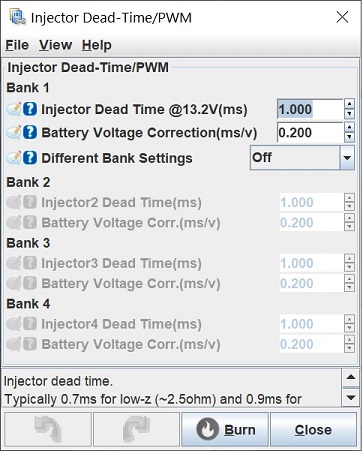

Posted by: Frank S Jan 21 2021, 05:58 AM
James,
I did not work with Microsquirt so far and am curious how you set the voltage correction for the injector dead time as it is not linear. Does Microsquirt have a none linear correction table like MS3, or how do you deal with the problem?
Thanks and best Regards,
Frank
Posted by: BeatNavy Jan 21 2021, 07:10 AM
QUOTE(Frank S @ Jan 21 2021, 07:58 AM)
James,
Frank
Hi Frank,
I don't think it has a non-linear voltage correction for dead-time. It does for dwell, but for dead time settings I think you get one shot as per picture below:

Posted by: Frank S Jan 21 2021, 08:10 AM
QUOTE(BeatNavy @ Jan 21 2021, 02:10 PM)
James,
Frank
Hi Frank,
Thanks for clarification Rob, it's identical with the options/settings I have available with MS2
