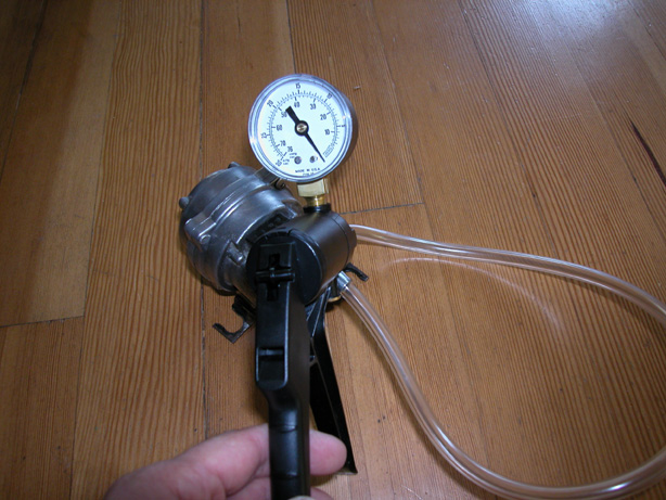

Ok, here is pic of a simple vacuum pump testing a MPS for vacuum. This one wouldn't hold a vacuum at all!!
Pump it up to 15hg on the gauge and leave it for 5 minutes to see how it holds. (Make sure the hose connections are nice and snug)
If it holds a vacuum the diaphram is good! If not, well its going bad or toast.
Geoff

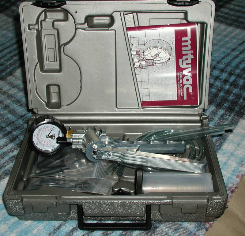

I picked this one up at a Shucks Auto Supply for $50
Ask for a "mity-vac". They'll probably know it as a way to bleed brakes. Works OK for that--better for flushing the system IMHO--and includes a nice hand vacuum pump.
--DD

$60 bucks at the local tool supply store. This one is very nice. They screwed me on some other tool prices...so I guess it all works out.
You bought the fancy one. My Mighty-Vac has a plastic body & didn't come w/ a case. I think it may have been $35 at the FLAPS.
Just bought the plastic one at Auto Zone for $28.00
