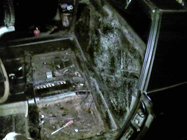

So far I've removed 90% of the tar from the interior. Things look better then I thought they would in some areas, and worse in others.
Excuse the bad quality pics, they're taken with my cell phone.

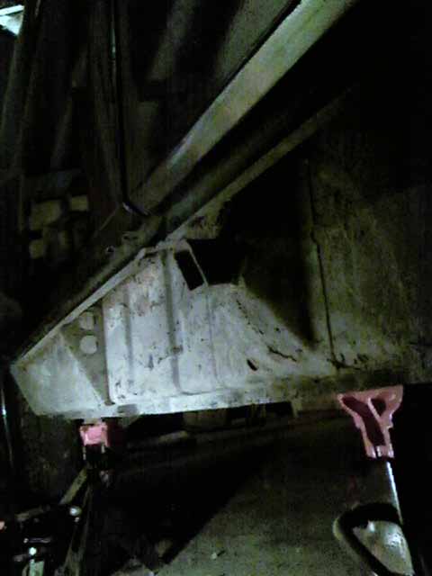

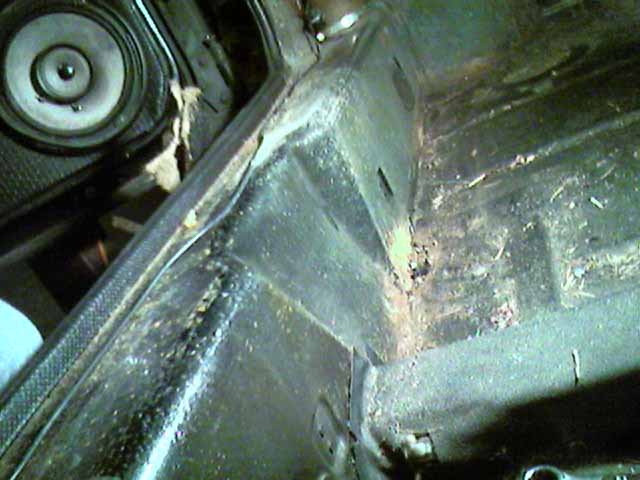

The firewall behind the seats has no rust on it and the interior longs look great, also no real rust or corrosion to speak of in the typical area behind the passenger seat where the battery leaks through to...

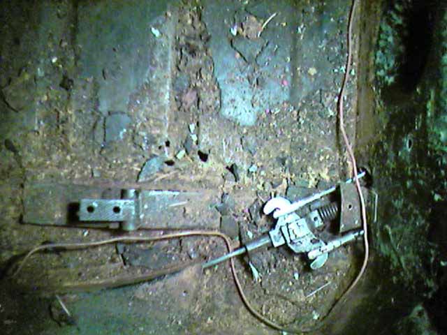

However, small rust holes that need to be cut out behind the drivers seat...

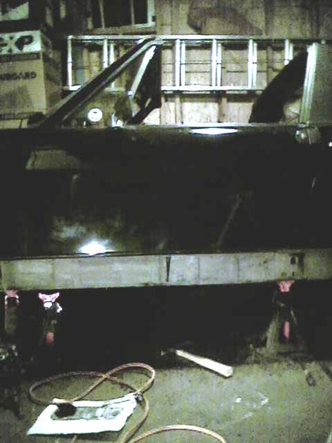

I haven't removed the rocker panels yet (I need to get more floor jacks first), so not sure yet what's under there, but the inner longs look good...
Looks good! Did you attack them with a big screwdriver, just to be sure. Looking forward to more pictures of progress.

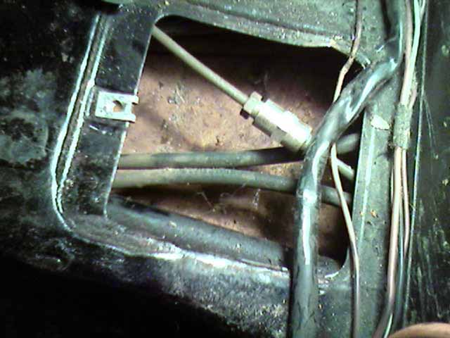

4) Is it hard to remove and then re-install all of the cabling that goes through the tunnel? (There is rust in it, so I need to try and treat the inside of it- ideas on HOW to do this would be greatly appreciated. Do they make POR 15 in a spray?

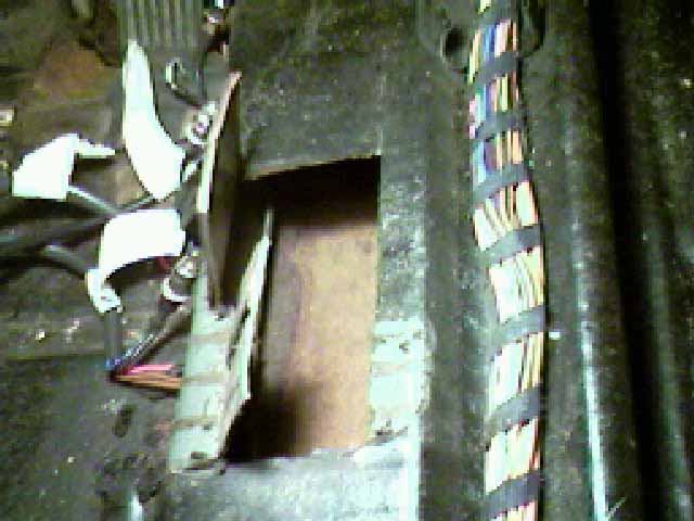

Pictures of the rusty tunnel (only appears to be surface rust though):
Do all 914s have holes cut into the center channel up by the pedal cluster??

4. The cables all run through tubes in the center tunnel. They are not removable.
The hole next to the pedal cluster was because the clutch cable tube is welded there and often breaks away. Someone cut open the tunnel to fix it (they didn't need to be this drastic to fix that problem, FYI).

The cables are in tubes, vacume out any loose rust, take a big wire wheel or like a pipe cleaner and run it up and down by hand getting the loose stuff off, vacume some more, use an air blower as well, then spray that stuff on there...

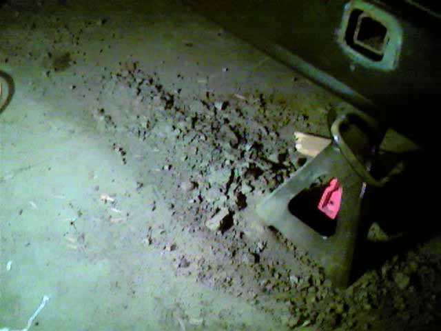

More pics, plus finally got the driver's side rocker panel off.
Happy to say that it looks fairly good.
Broke the heads off of the underside rocker panel screws off in the process though.

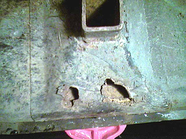

Rust near jack point... Do I bother welding in new piece, or just cut it out and leave the holes? I was thinking about cutting off the jack tubes anyway.
Small rust hole...(this is after attacking it with a screwdriver...)
Other then the couple of holes I've pointed out in the pictures, they look pretty good. You can see however that there's a consistent line of rust along the top seam that runs the length of the rocker panel.
I will be grinding that down, but worry if this was a weld bead or something that will need to be re-welded? Does it hold 'things together' at all? It runs the entire length of the long.
Well at least I can repot the plants in the house with all of the dirt that came out when removing the rocker panel cover...
amazing similarities with your pics and mine LOL... I'll put more of mine up tonight. I also busted off all but 2 rocker screws. Had to use vice grips and snapped em off.
