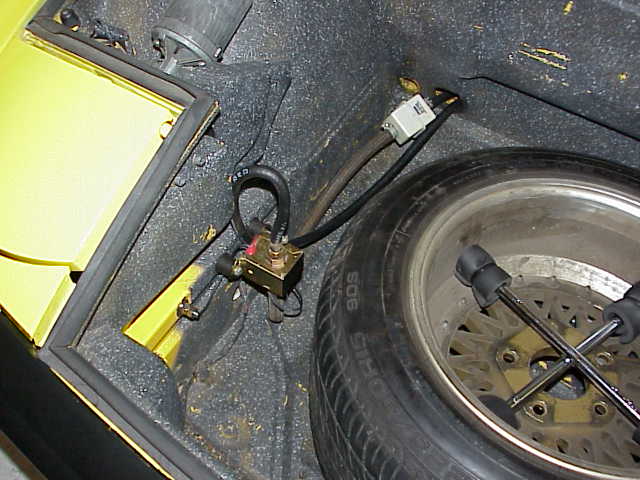

What started out to be a quick move the fuel filter to a better position in the access hole, this is a 75. I split one of the fuel lines that goes to the fuel tank. Lucky me, full tank. So off to the store and a couple of 5 gal cans and hose. After a mouth full of gas and filling both gas cans and various other containers, the tank was empty.
Out it came and I figured lets get this stuff to a better access area. I looked at some old photos of Porsche 914 GT race cars and VOILA. They are mounted right front trunk location.
I purchased ten feet of fuel line, this car is carbed so FI hose was not needed. New hose clamps, filters and a search for a 90 degree hose fitting to go oin the FACET fuel pump, so I don't have the big loop in the hose that you see in the pic. Put everythin in place bolted and screwed and it works great.
Know off to look for that 90 degree fitting. Good luck, it works for me.
CCLINFUELPUMPRELOCATIONVILLE
