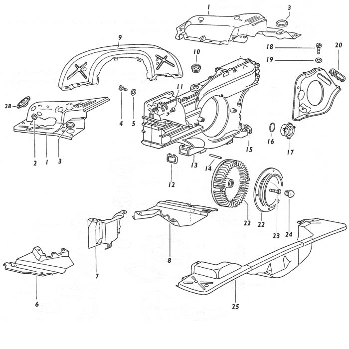

Yes. Parts #3 and #4 on the following page:
http://www.pelicanparts.com/914/parts/engine/engine_compartment_sheet_metal_large.htm
--DD
Warm air guides #6 & #8:
