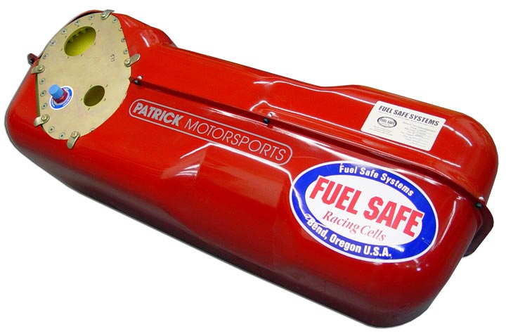

Fuel Safe makes a cell that fits the stock location... bring a wheelbarrle full of $$$ though.

Back in the 70's Teeners were referred as the poor mans Porsche. Today it's $500.00+ for the windshield/targa top gasket... poor mans Porsche my ass. Patrick Motorsports has the best solution I've ever seen, it's also $1975.00.

I'll take it over to the tacoma dump, probably in some 5 gallon buckets so they can just trash 'em with the gas. And as for the $2000 fuel cell, I only paid $1050 for the teener, so that's out of the question!
