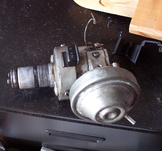

I did a test dizzy removal on the 2.0 wreck and it came out like the pic. Is this what I want? I had to move the vacum can to the side to do so. If it comes out like this, does that mean I don't have to re time the car?

You will need to re-set the timing. You'll get pretty close if you turn the distributor until the idle RPM is the same as it was before you started.
You might be able to work around the vacuum dashpot, but chances are pretty good that it'll be easier to remove the mounting screws for it so you can get it out of the way.
Use the Bosch distributor lube on the cam for the trigger points. One tube is a lifetime supply for about six 914 owners, so see if someone in your area already has a tube of it.
--DD
So it is ok to pull it like that? I was very afraid that I had screwed up when the drive shaft did not come out. That is a relief!

Take the dizzy out. Inspect the gasket also. It is really easy to put the dizzy in 180 degrees off, so pay attention
Like every one said that is what it should look like. I hate to point out the obvious so if you already know this, sorry. There should be a thick O- ring in the groove on the shaft, and a spring that goes between the dist. and the dist drive shaft (the part that staid in the motor).

Out of curiousity, what happens if you don't remove the clamp with the dizzy? Is it bad to pull it through the clamp? Will it wreck something? Wondering cause I just did it on the weekend. Oops!
It won't automatically wreck anything, but your chances of scraping up the O-ring on the distributor shaft are much higher.
--DD
The O ring is just rubber, right? So, if I just check it and make sure that it's all good, it should be ok? How much oild would squirt out if there is some minor scratching? I'll inspect closer tonight and figure out what to do. Oops.
