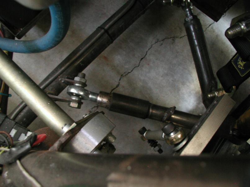

But here it is when I picked it up at the chassis shop.

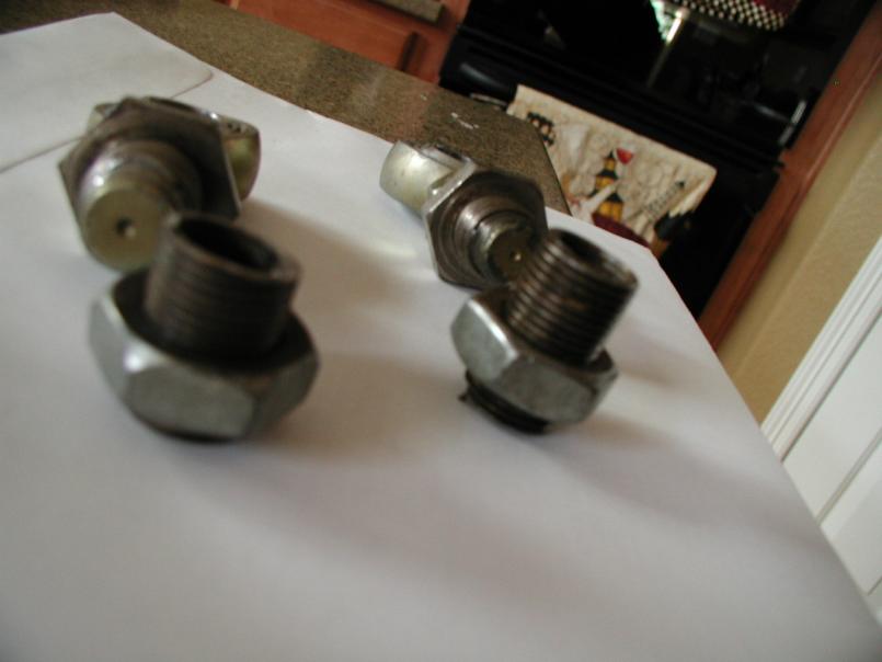

so fired up I took an hour off work, ran home and took some pics of the parts I never bought. Pix are kinda big but I left them so everyone can get a good idea of how thin their custom piece was the held the front strut in place
AJ told me over the phone after he was working with them he wasn't sure about them but I blew him off and said "they say they do this all the time" or something similar. Well...
![Attached Image](http://www.914world.com/bbs2/uploads/post-5463-1226618406_thumb.jpg)
Posted by: byndbad914 Nov 13 2008, 05:26 PM
don't have to be an engineer to know you shouldn't thread the outside 3/4" RH and the inside 5/8" LH!!! I did the math back when it broke and IIRC there was literally only .030"-.050" thick sections with high stress concentrations from cut threads holding the whole lower arm together!
Just because you can use a machine makes you a machinist, not an engineer, nor for that matter prove any sort of common sense. I can't believe I didn't catch this when I adjusted the suspension the first time... I sorta recall thinking looks kinda spindly but again, "they do this kind of stuff all the time" in the same sentence they refer to this as a custom piece.
Look how thin!!!! Keep in mind, the rod end has 5/8" diam threads!!!!!! for comparison. I literally shit myself when I saw the failure and saw how thin.

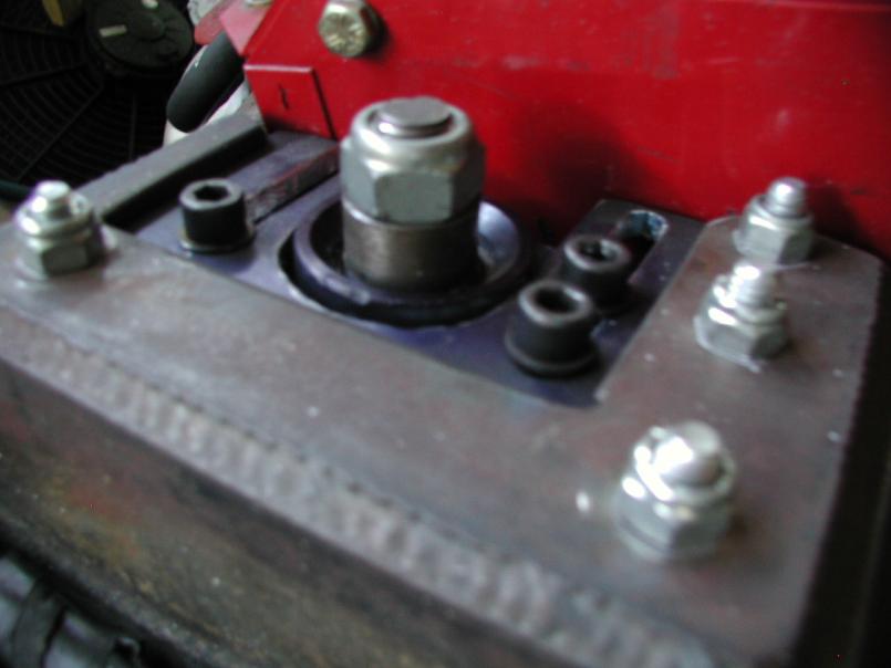

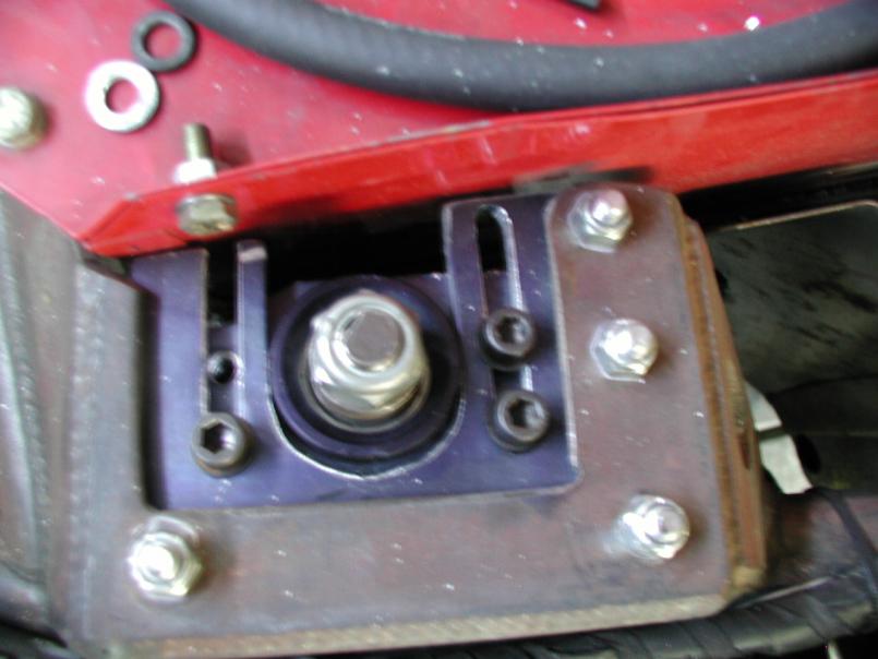

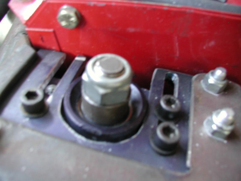

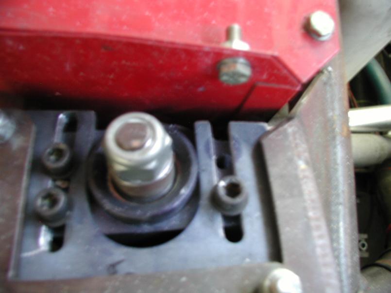

now for their shitty upper mounts - AJ and I finally gave up dicking with them, and basically made the best of a bad situation, hacked them to tuck near the cell to ensure I could get enough camber range, and I was left to rely almost completely on the lower arms for camber and completely for caster. Notice how one bolt is missing but also notice how boogered and hammered the threads are - that is where they forced the fourth bolt in before shipping to me (sorta grainy cuz my digital cam has a hard time focusing that close but you will get the point)
Posted by: byndbad914 Nov 13 2008, 06:13 PM

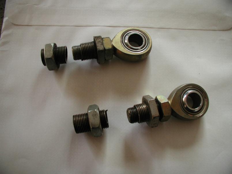

bit better at showing how the threads had dug in when they assembled it - you also can see the bare alum where we had been trying to grind clearance into the part so it would adjust but just wasn't gonna happen without complete remachine of the part - called you on this shit as well BTW. You were never around once you had my money and sent the parts.
Posted by: byndbad914 Nov 13 2008, 06:15 PM
notice how well the tolerances are held on thread placement - the fourth hole is clearly shifted over relative to the slot
Posted by: byndbad914 Nov 13 2008, 06:16 PM
the passenger side, again bolt doesn't line up. This one came unassembled in box with the bolts laying with it
if one won't go together, leave it to me to assemble the other, right!

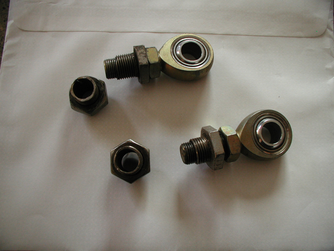

here is the arm after I cut it in half, ordered two 5/8" thru/3/4" thread HD heim joints at $45 each, lengthened the arm to match what it should be without the adjusting sleeve. Not an single issue since, so my "backyard" engineering seems to be working much fucking better than your "professhionaul" job jackass (I spelled that just for someone of your caliber)
Posted by: byndbad914 Nov 13 2008, 06:23 PM
On the way back to work I realized I forgot to snap shots of your two ball joint "pins" that the lower arm attaches to. That was the real reason I bought your kit - I didn't have the time to draw up a pin and have machined locally as the lathe at the old hot rod shop I worked at in college couldn't hold tolerance below 0.005" and the cost of all that made your stuff seem like a slam dunk.
But I will get pics, two pins, identical parts, machined I am assuming back to back and even THOSE aren't identical and I could barely get the nut down on one side to lock the cotter key in place. I will be sure to post that excellent machine work here as well later.

edit - oh yeah, and imagine the fun I had the day it broke! The left one let go juuussst as I entered T5 (turning to the left) at fortunately only about 30-40mph and wadded the susp up in the car and I had to drive it off track. Then while I spent almost 2 hours shutting the track down with 3 corner workers and two jacks getting it on the trailer, and then the other one broke off taking the car off the trailer. Having this happen 2 yrs later I should have flown to their shop and returned them thru the front windows. I spent almost as much making these work as if I had done them with AJ from scratch. It is my lesson learned - take notes guys!

So how it would work, sorta hard to describe but I will post this pic again as a start

wow, that is thin. if you calc the diff OD to ID considering the thread minor it's even less than 1/8. damn near paper thin. I am glad your OK.

Oh yeah, Josh, almost forgot, the upper mounts, we hacked to fit but they are well supported by the steel "box" AJ built - they ain't goin' nowhere

Posted by: byndbad914 Nov 14 2008, 02:31 PM
Interesting to see that after over 24hrs since his initial out of the blue slam on me he hasn't returned with a response
Do you think he got the message?!

Given the fact those parts were going to fail, I too agree I am more or less glad it happened when it did as had it been after that first shakedown lap and I was starting to put power down and heat in the tires, WSIR is a fast track period and it could have been worse. The whole Bud balcony area is the slowest part, but still rather fast compared to nearly every other track! I drove the track in 3rd out there and 4th in the 2 long stretches and the other tracks and the one here in CO in 2nd,3rd in stretches so there isn't really anywhere you are driving slow there.
Which is why I love that track ![laugh.gif](style_emoticons/default/laugh.gif)
Sorry about your tale with your job - but IMHO it was a good thing as working for someone that reacts like that and blames you for their mistake is never going to be a good job in the end.
I too am an engineer and why I sorta kicked myself over not catching this. Key was I had a LOT going on and became complacent and assumed the parts were fine instead of taking the time to really check them out, take the time to force a refund or exchange for better, etc. I just didn't have time as I was literally building a car and preparing for a move to a new job/state at the same time there end of 06 and it was a mad scramble - the haste makes waste kind of scramble.
History repeats.... haste makes waste has been a saying for lifetimes and hold true today. It just really, really sucks that everyone really has to take the time to trust no one... that is a sad statement but how I have to treat everything I purchase. That's reality, and it's foolish/childish to think there is some sort of Utopia offered but I do fall victim to that ideal periodically.

Looking at that part, I would call the police and report a murder attempt.

I know this is a old thread but the internal bolt threads would work ok as long as the heim was inside the bolt far enough that it was all covered by the threaded area of the a arm tube. So that there was no hollow area unsupported on the thin part. When it is adjusted out too far and then the hollow part is exposed it is not strong enough. I don't know if the heim is long enough to make this adjustment viable but it could be successful if the a arm tube was longer to go over the heim threads at least the length of the heim threads diameter fully.
Posted by: byndbad914 Jan 17 2009, 12:58 AM
actually even if you had threaded the sleeve into the arm, then the heim into the sleeve, and both were fully supported, you could still have a failure. The suspension will put the heim joint in tension, pulling on the threads, which puts threads in shear.
Having that sleeve in there would create a weak shear interface and tho' the heim threads and the arm threads wouldn't fail, that sleeve could shear out just like stripping threads out of a nut. Unlike a heli-coil (if that is how you are thinking of this) which has inner and outer threads on the same winding (they use custom taps), this had two different threads, very close in diameter, with two different pitches inside and out, creating a very thin shear interface periodically.
