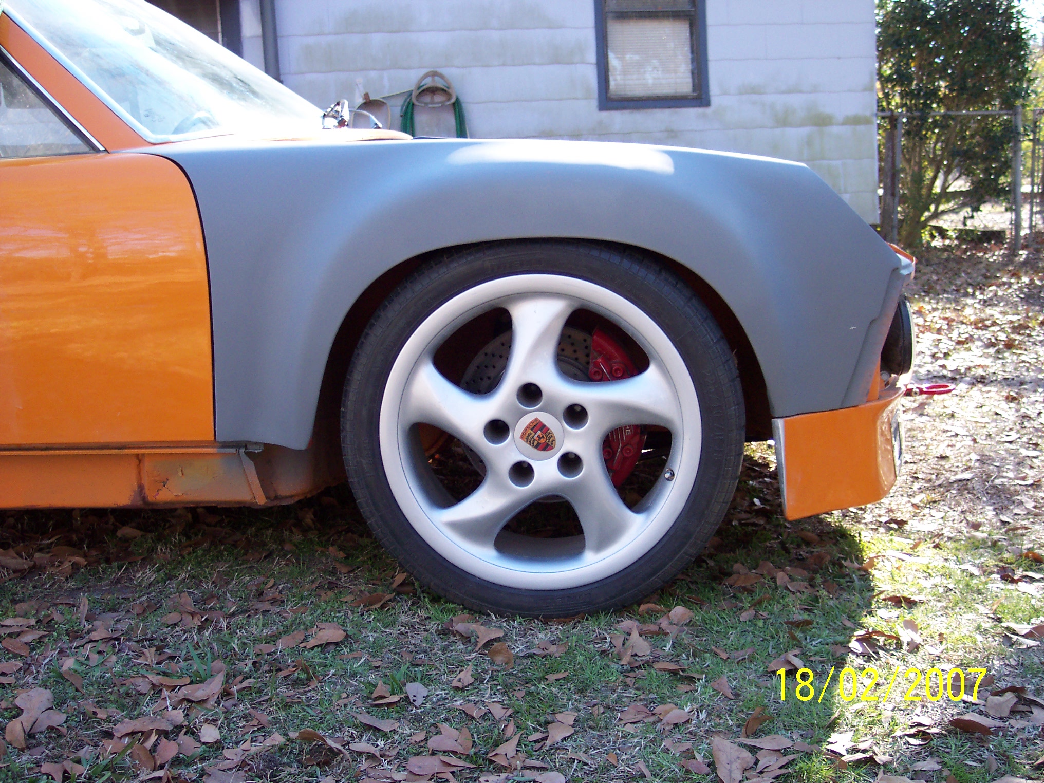

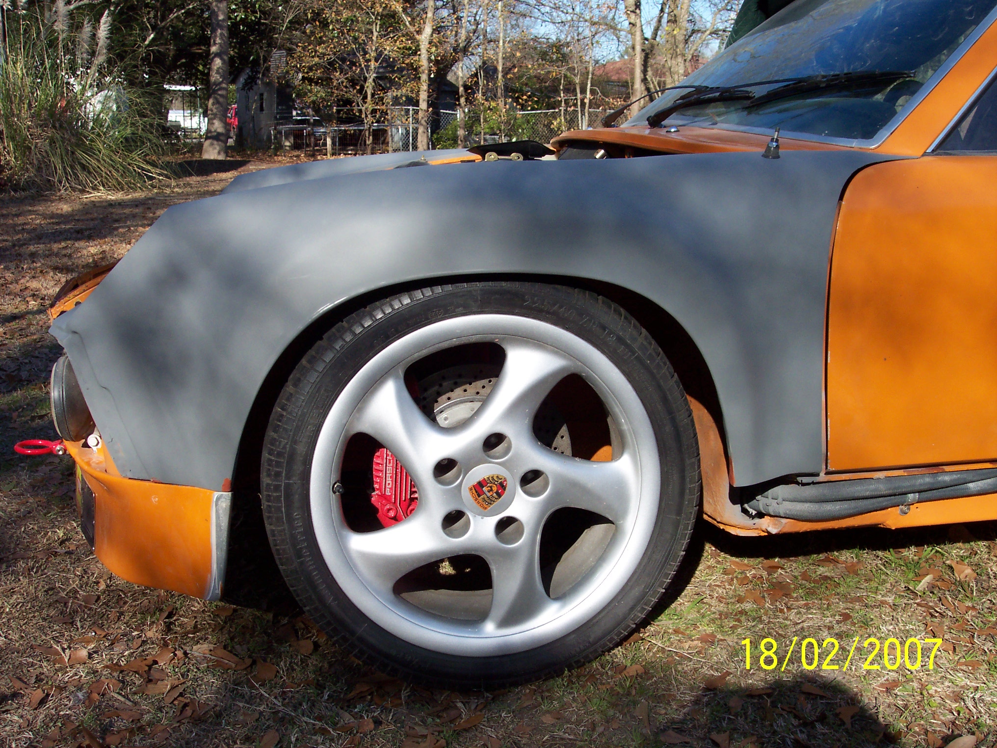

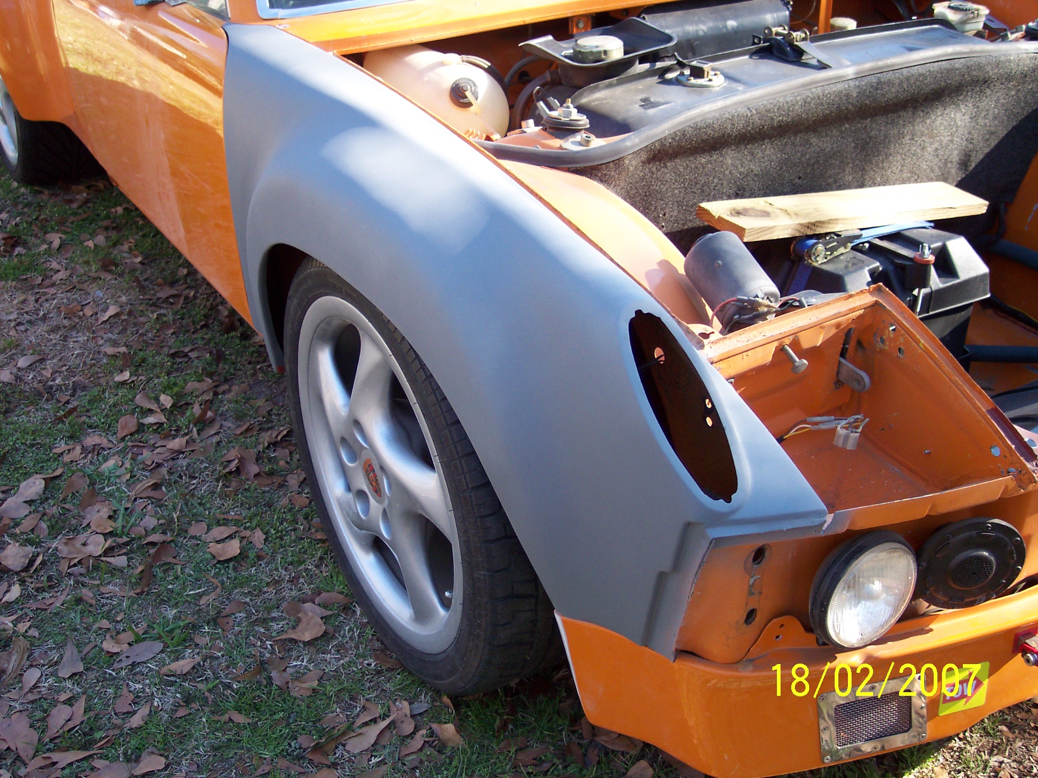

Front flares are now completely fitted,and primed. I've rolled the fender lips,cause the front tires rubbed when turned. For anyone wondering,my front setup is 930 brakes,930 hubs,78 930 front wheel spacers,and the 18X8 front wheels. the front and rear flare ends need a serious amount of fab-work to get them to match the rockers and spoiler.I would suggest that anyone putting on flares have the spoiler and rockers in place to make everything line up before any paint is laid. Ron Attached thumbnail(s) ![]() ![]() ![]() ![]()
