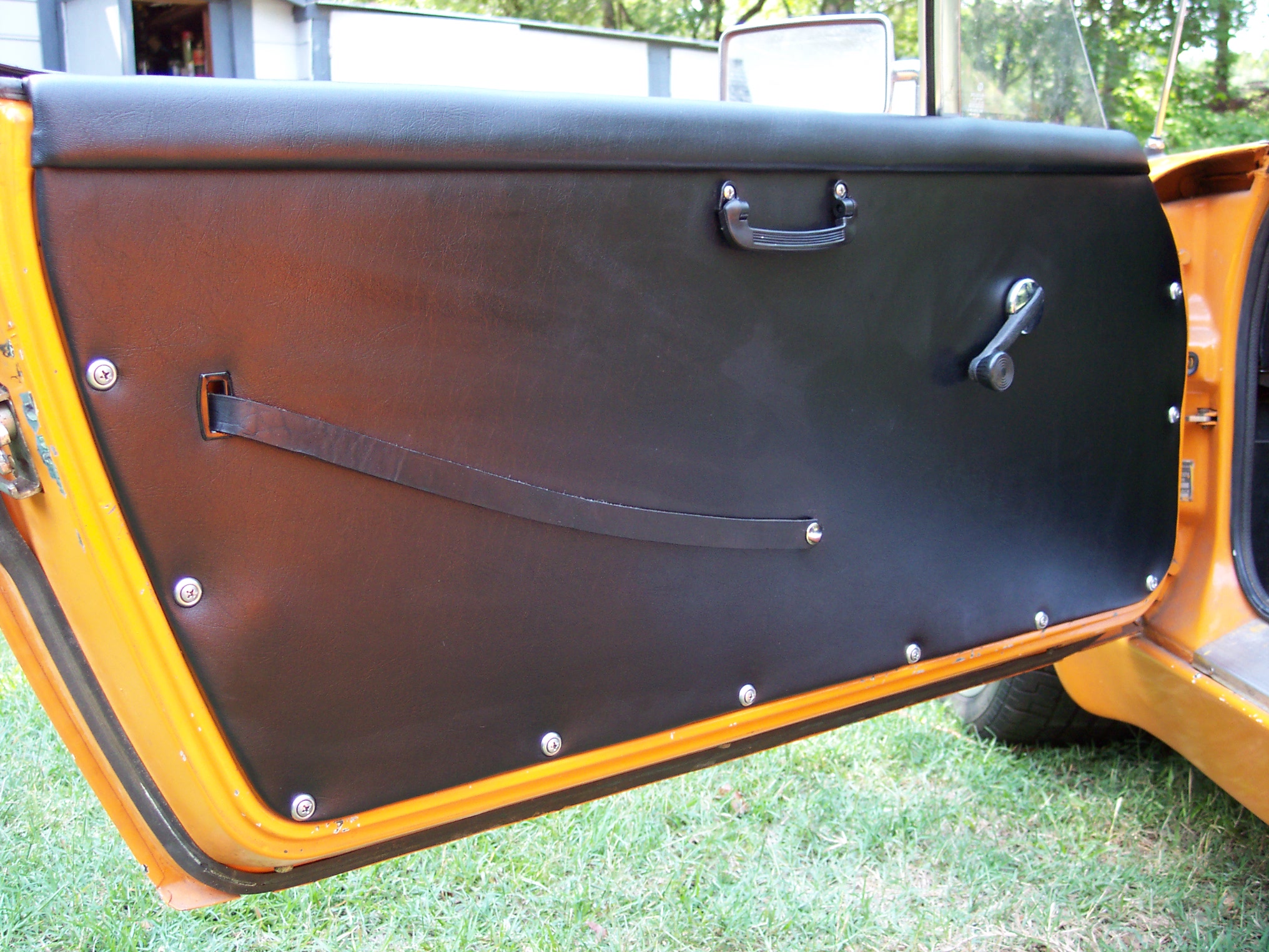

I've been wanting to have a set of Gt style door panels on my teener for some time now.I thought that doing them now would make things easier if I ever get around to putting a cage in the car. I basically just copied what I have from AJ Serrano's site,seeing as he has really detailed pics on everything. I collected the necessary parts.I got the door pulls from Fiatparts.com.The German leatherette material from Auto' Int'l. I had a local leather guy make the strap.Lastlt I copied the bezel for the strap hole in the door from AJ's site.I lasered it out,then made a forming die to shape it.. I tried to recover the boards myself,seeing as how Aaron made it look so easy. Yeah well,the tuck & roll at the top kicked my a@* so bad I just carried it to a local upholsterer to finish. Hope you enjoy. Ron Attached thumbnail(s) ![]() ![]() ![]() ![]() ![]() ![]() Entries on Monday 5th June 2006

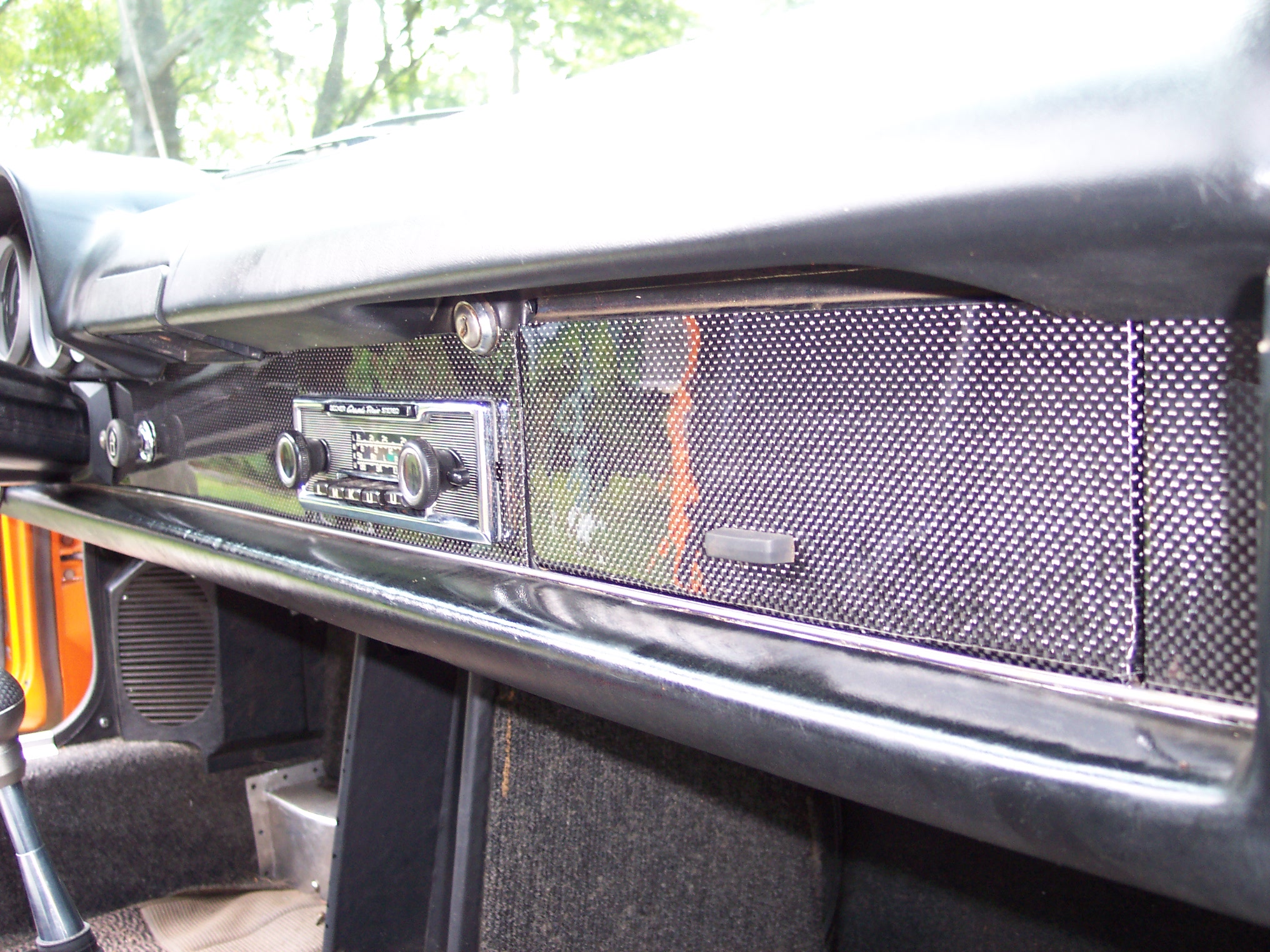

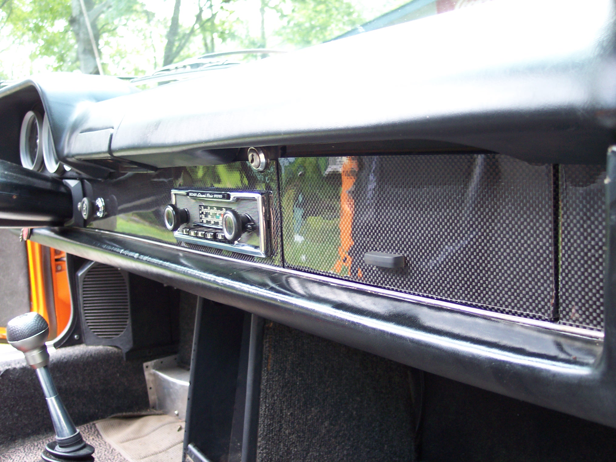

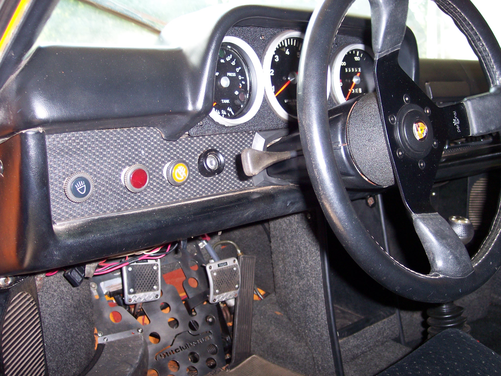

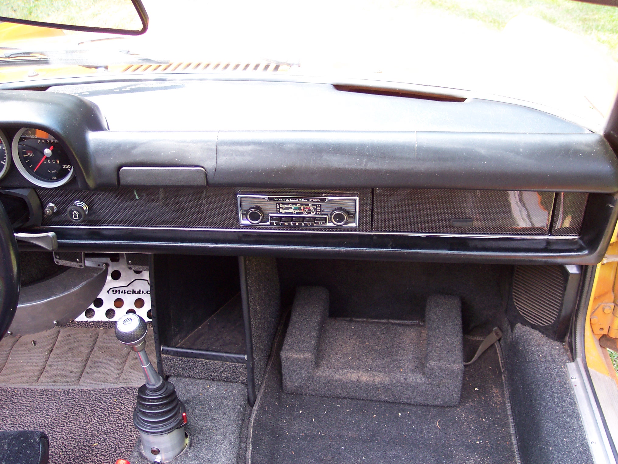

This past weekend,I got some carbon fiber sheeting in the mail that I ordered to add to the teener's dash to try and spruce it up a little. I got the stuff from a place called Dragonplate,total cost was about $120.00. It is just a veneer,already has the adhesive on the back. Basically it was cut,fit and peel and stick.The stuff was thin enough to cut with a pair of scissors.For the area around the glove box,I used a heat gun to form it and stick it down.Not much to it. Ron Attached thumbnail(s) ![]() ![]() ![]() ![]() Entries on Friday 26th May 2006

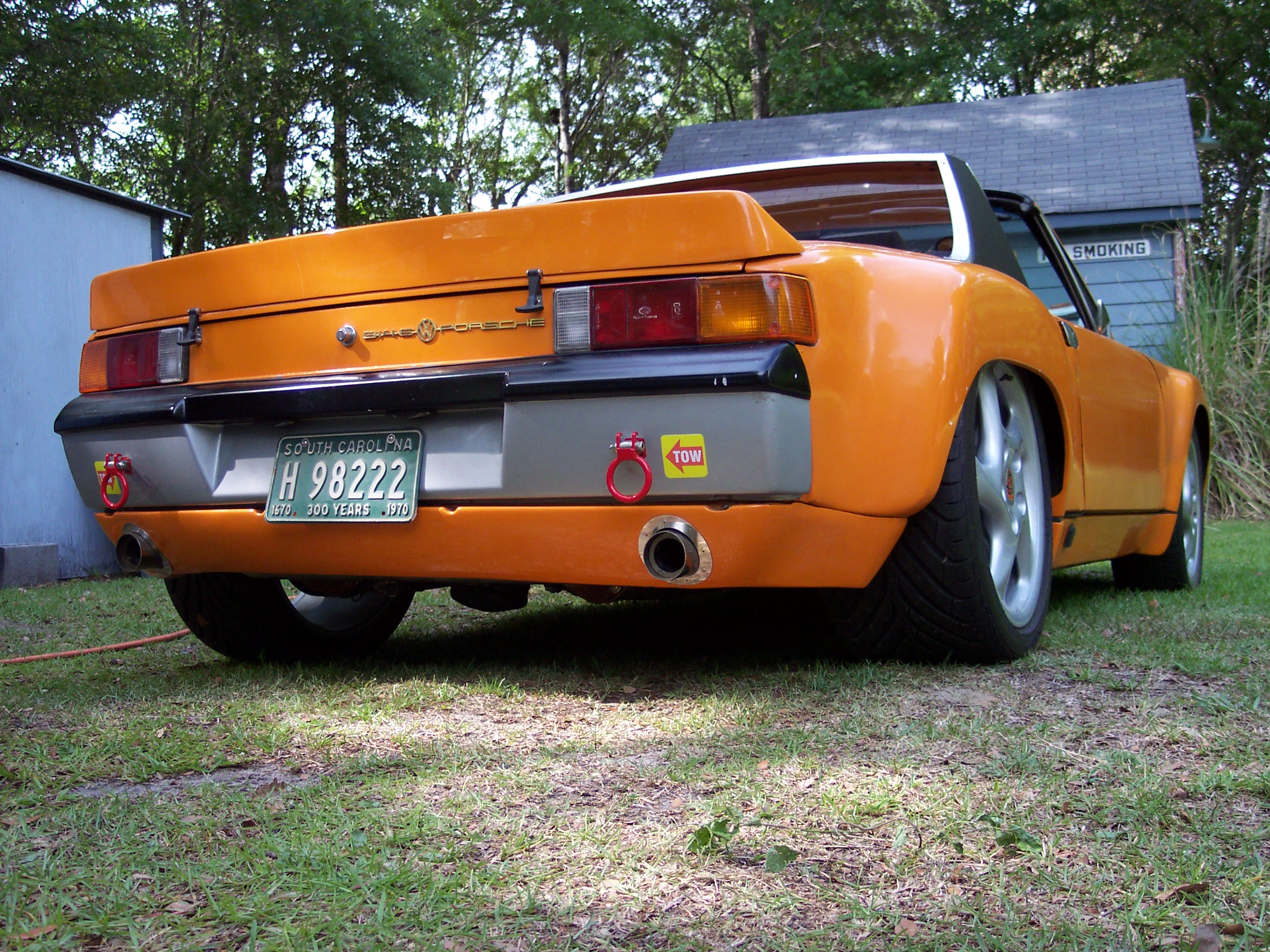

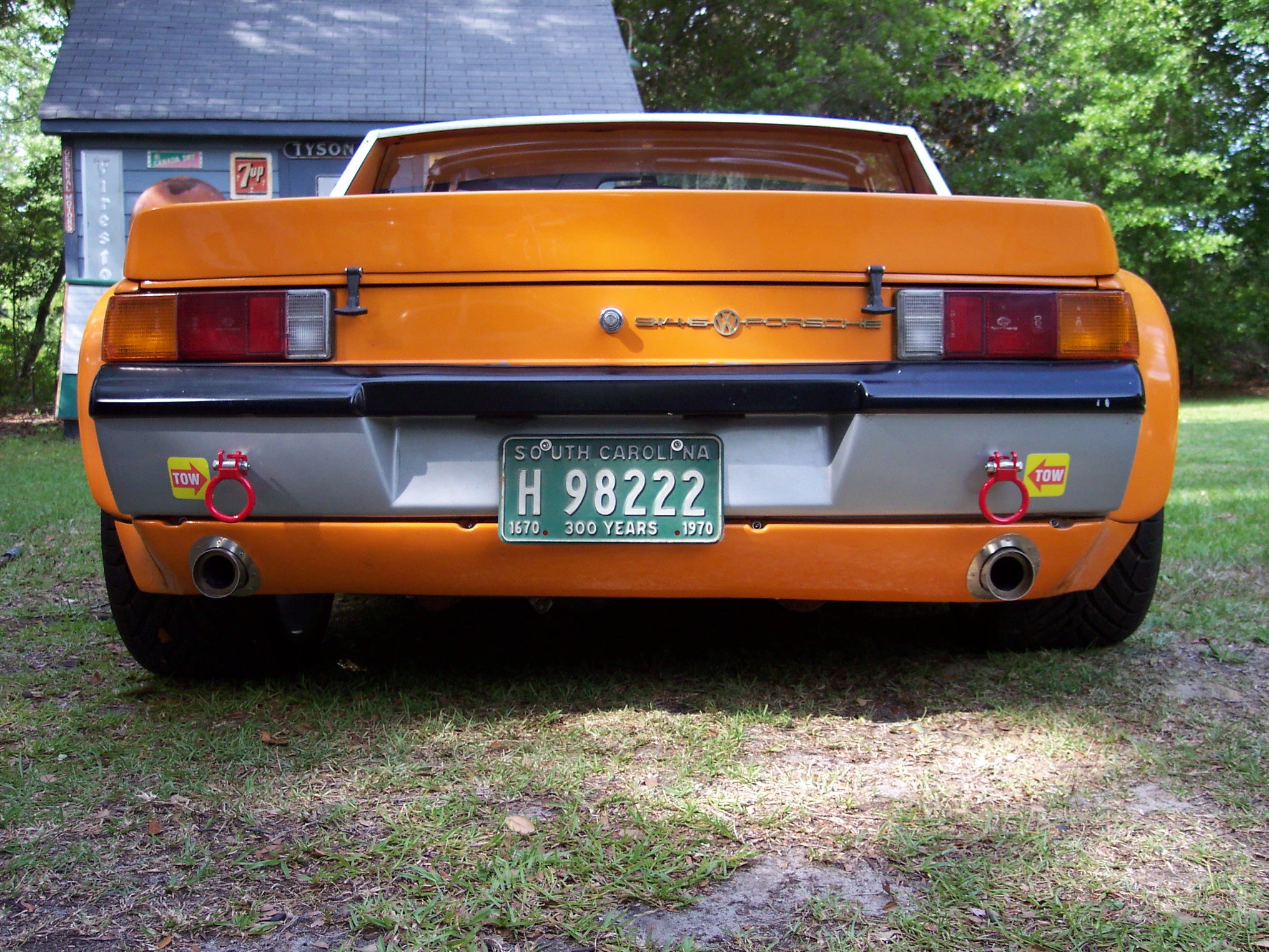

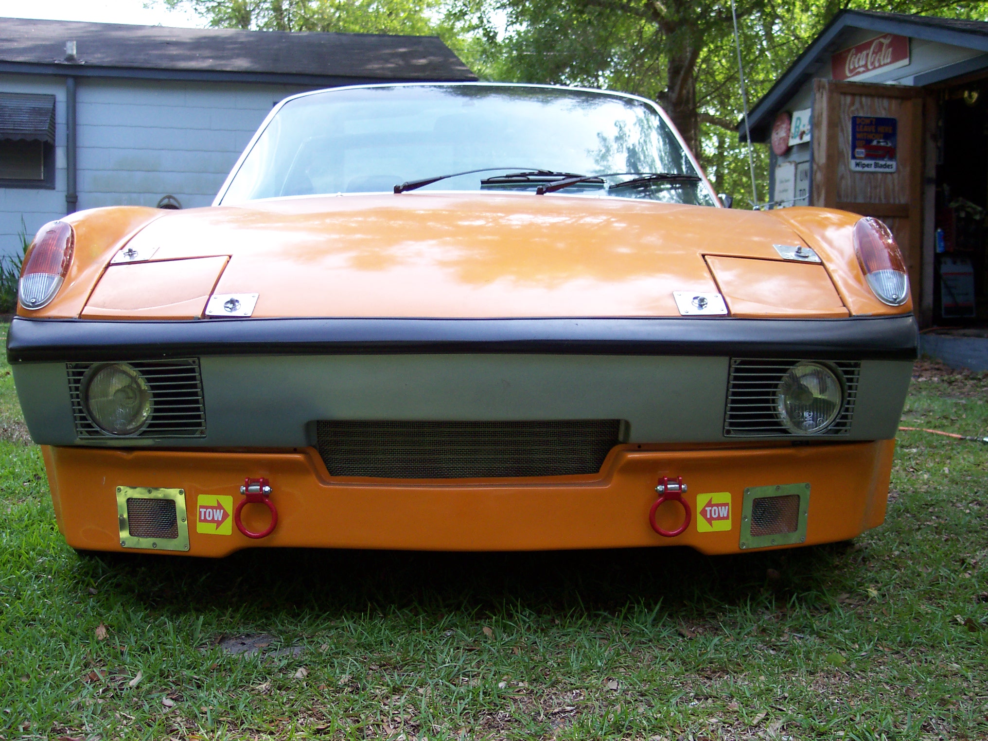

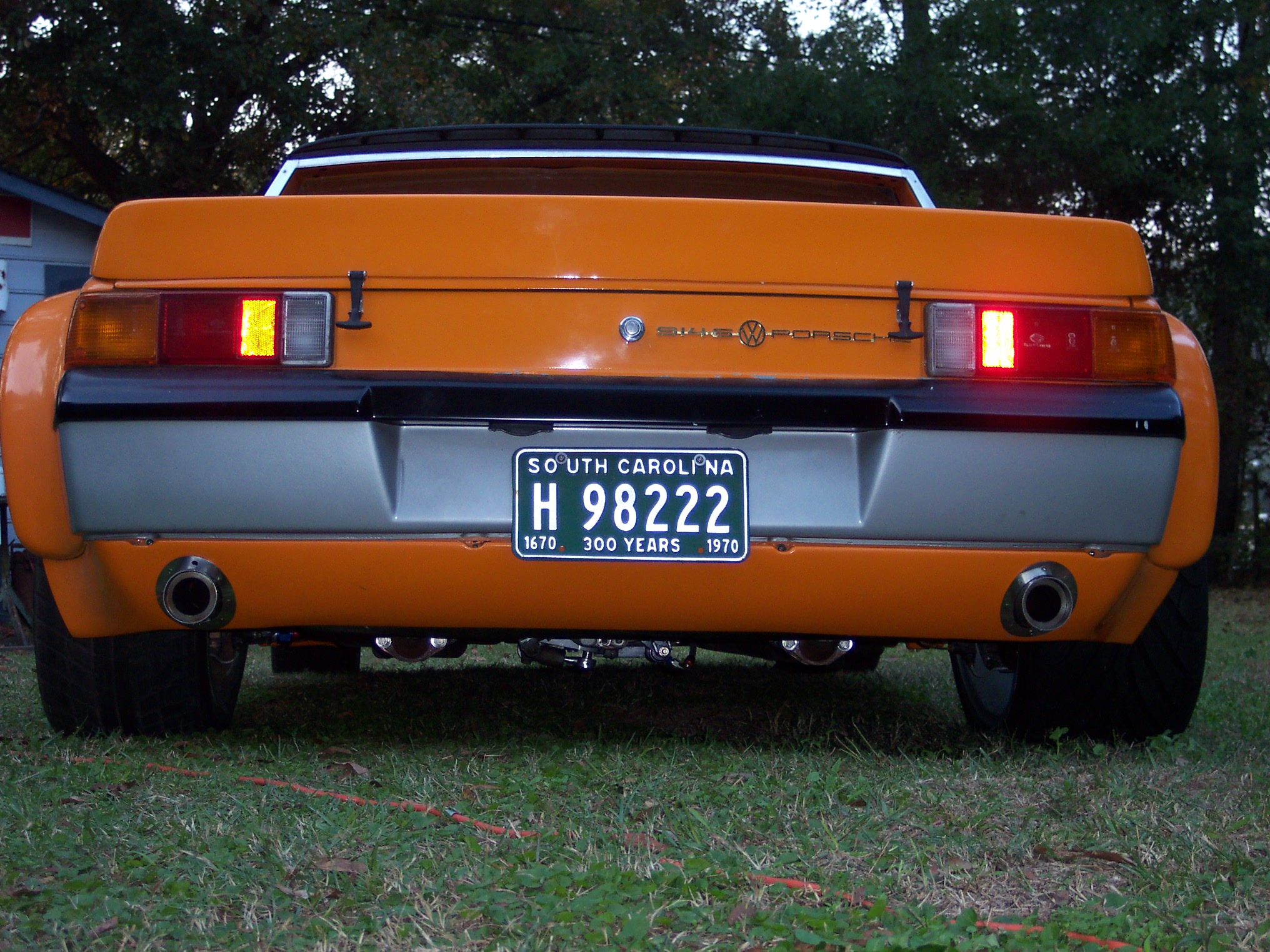

I have currently added some towhooks,front and rear to the car. I wanted a folding hook design.i seached the internet for some off the shelf pieces,and I did find some.Most were in the 150-200.00 range per piece.That works out to 6-800.00 for tow hooks,doing all 4 corners. ![]() ![]() So,since I work in a fab shop,I designed my own on cad and whipped up a set. All the support sub-structure is hidden. ![]() ![]() I did a lift test on all 4 corners with an engine hoist,and everthing lifted fine w/o any flex. Please don't get the idea that the hooks are mounted to the front valance.(it's fiberglass) Or the rear bumper.(It's fiberglass also) Ron Attached thumbnail(s) ![]() ![]() ![]() ![]() Entries on Wednesday 1st February 2006

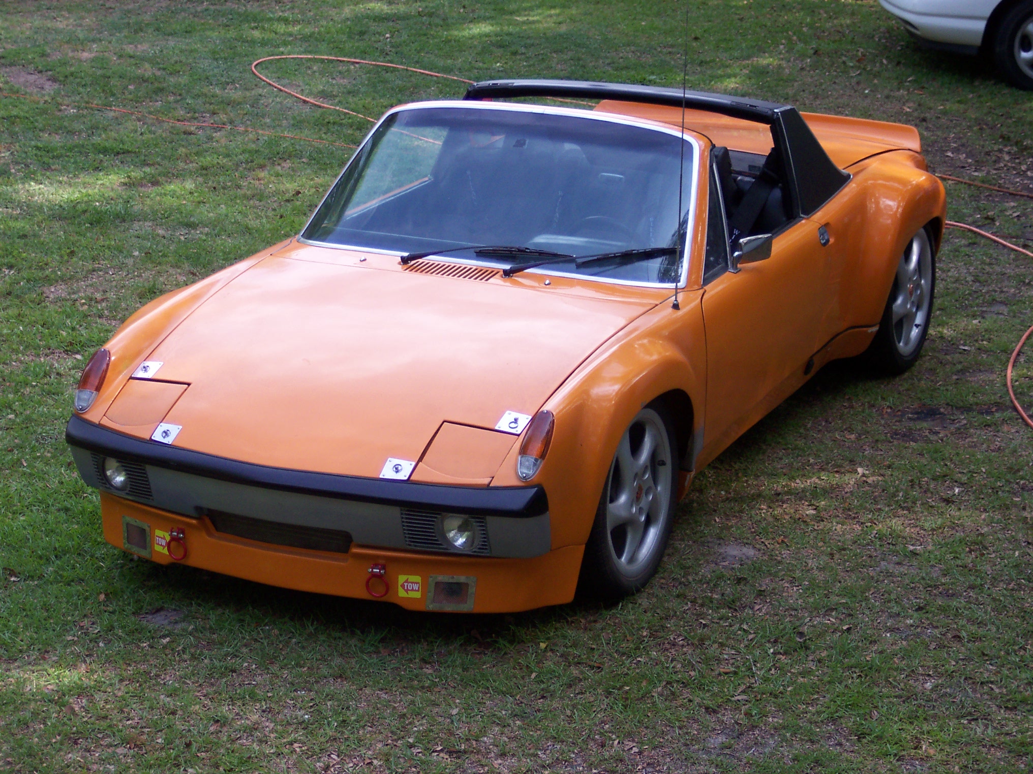

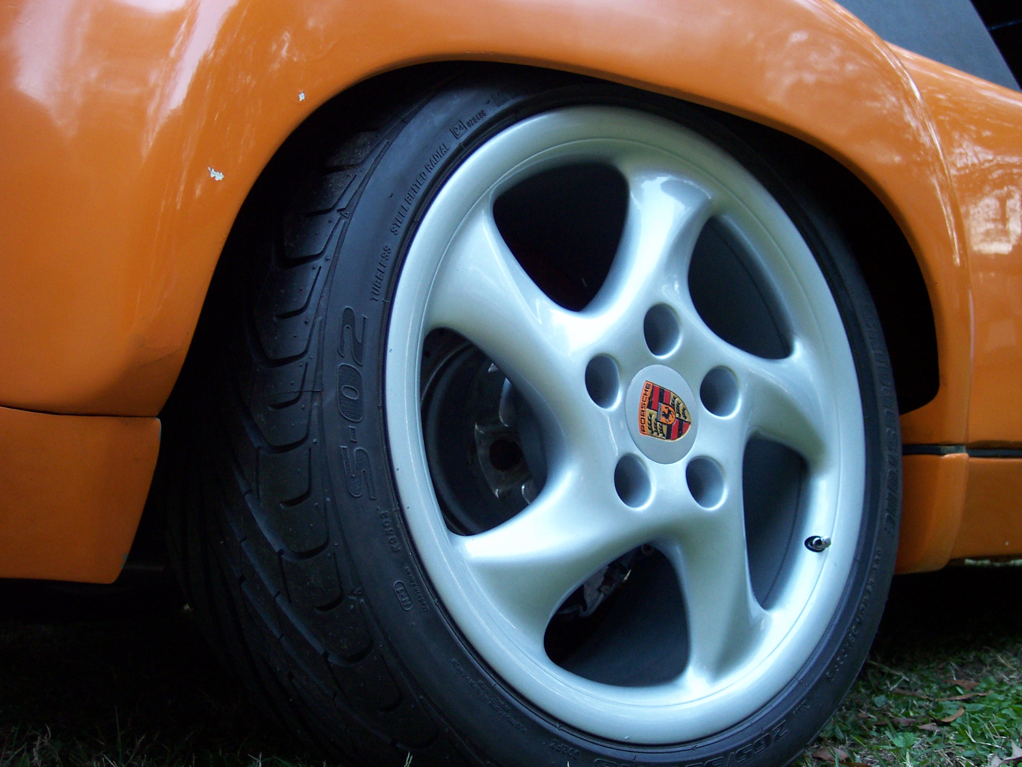

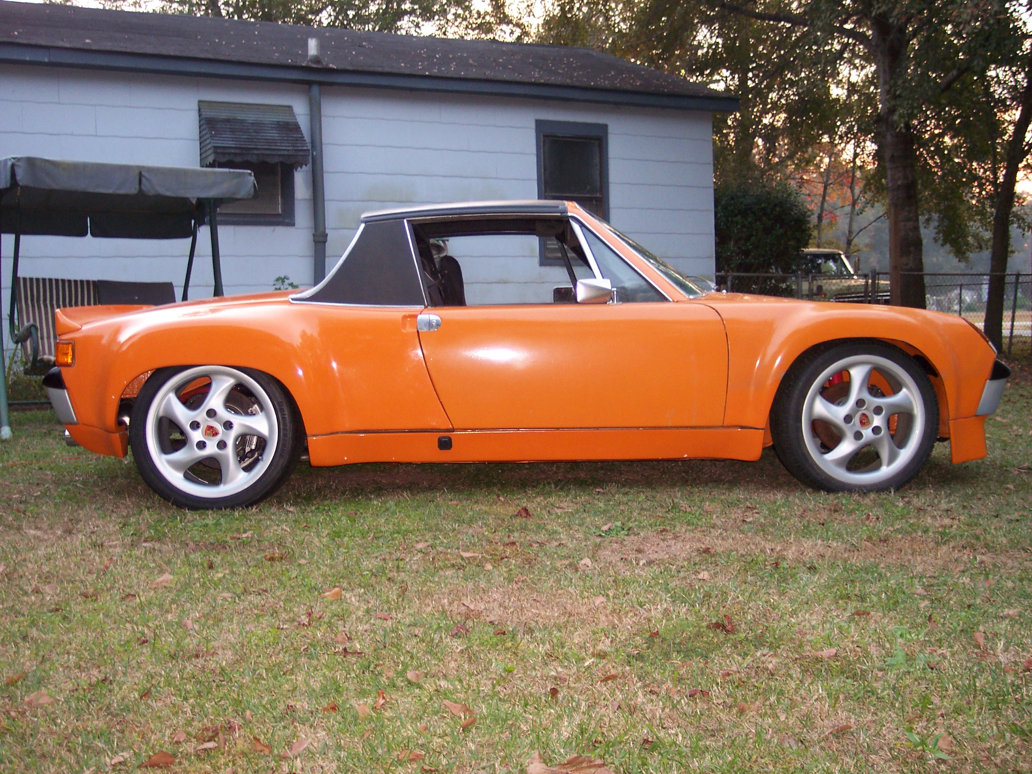

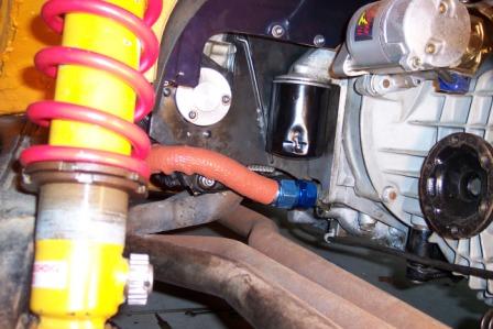

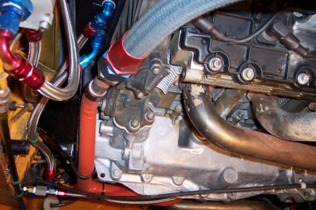

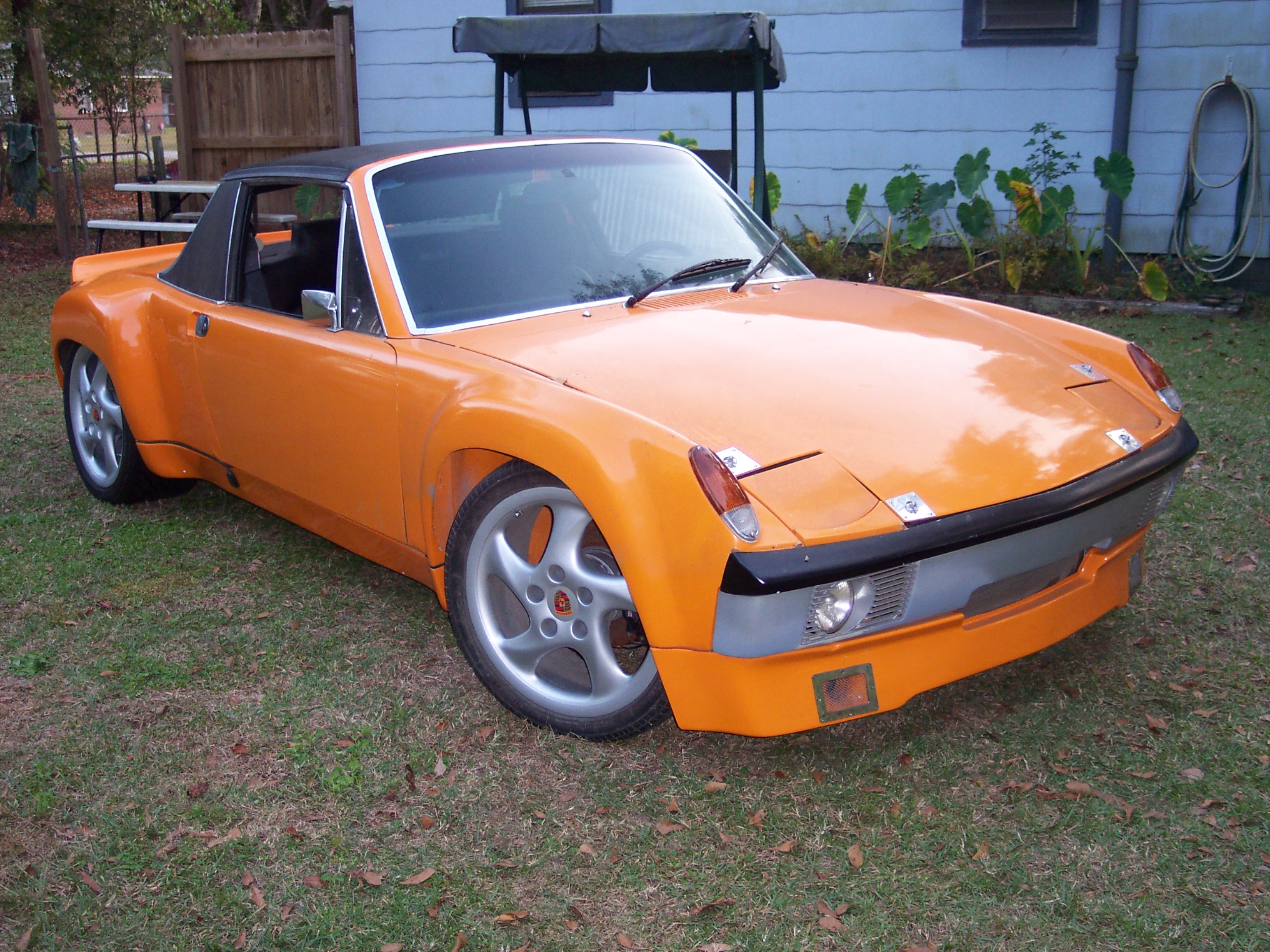

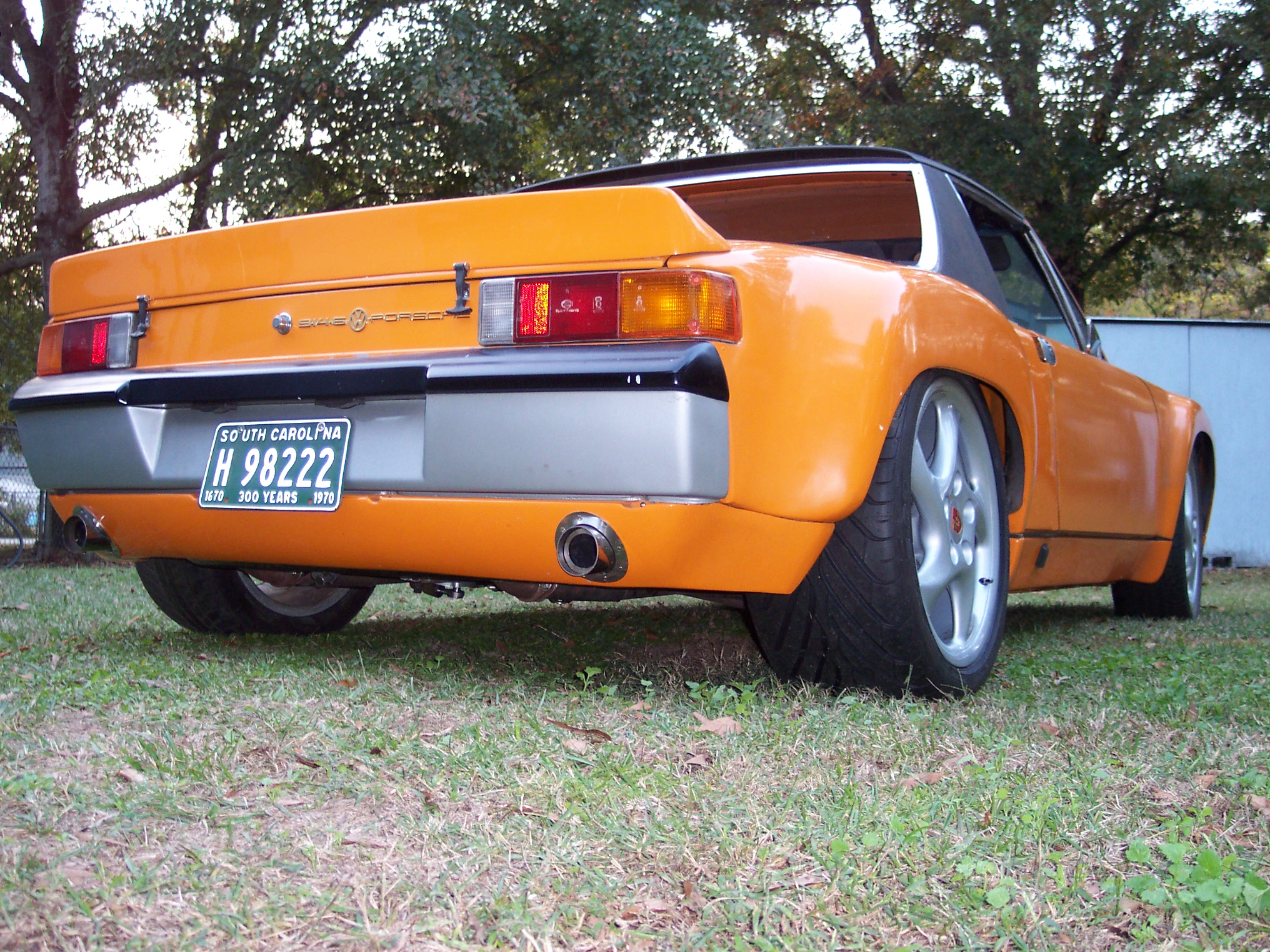

latest pics have the car finally mobile ![]() ![]() ![]() ![]() ![]() ![]() ![]() ![]() Car still needs a matched set of rear rims,Koni shocks rebuilt,and the speedo sent off for a refurb.Don't want no blue lights in the mirror. On the road time may be postponed cause now I want a roll cage and better seats.Ah the project keeps changing.But at leaast it's moving forward. mods so far. Getty gt balsa lids fr & rear 11" glass rear flares 18X10 Rears,18x8 fronts glass rockers. glass bumpers fr & rear lexan rear window Gt type engine lid 993 engine,bone stock w/1-3/4" MSDS headers Mustang Gt recirc fuel pump w/a MSD front pusher pump. Dansk 2in/2out exhaust All -16 oil cooler plumbing to a Mazda cooler.Ducted & fanned,All Aeroquip Startlite -16 hoses. 915 trans.vellios conversion w/7:31 r&p,guard gt lsd @ 80%,spray bar,oil cooler w/electric recirc pump All hydraulic clutch 964 mastercylinder,Wilwwod Slave cyl. 930 turbo rear brakes Rear yellow Koni's,1973 vintage dbl adjustable Koni Yellow fronts,944 turbo front brakes. cockpit installed brake biased valve. James West new style shifter w/917 style knob Titanium pedal board Vintage Personal steering wheel Becker Gran Prix AM/FM LW/SW 5band radio Ron Attached thumbnail(s) ![]() ![]() ![]() ![]() ![]() ![]() ![]() Entries on Monday 8th August 2005

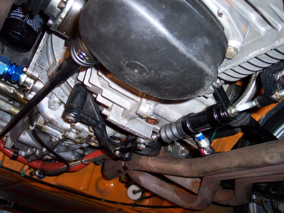

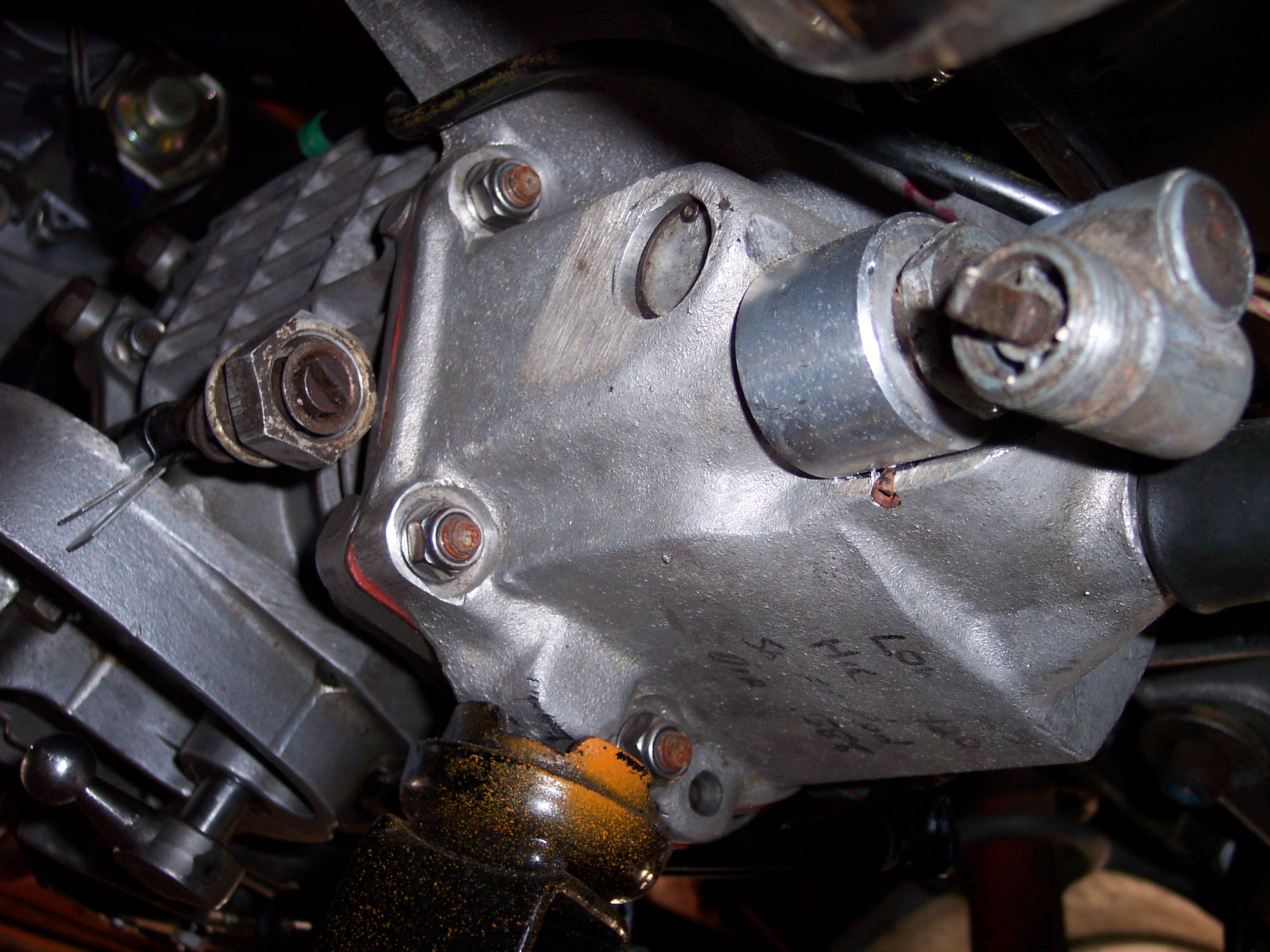

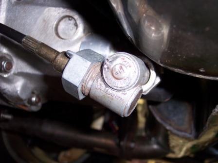

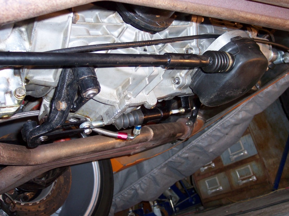

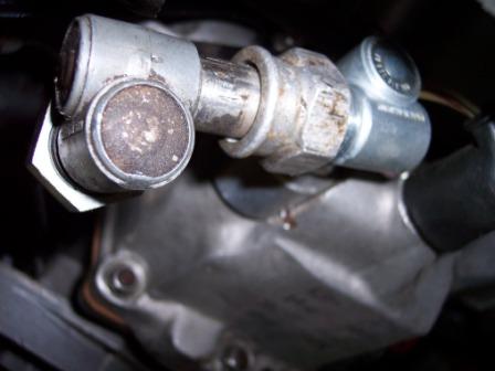

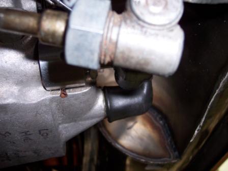

I took a couple pics over the weekend,of the speedo attachment on my 915 trans.
my trans,is a Vellios converted 915box. As all know,it doesn't come with the machining done for the speedo. I did the machine work,to have a mechanical speedo.The trans has a 7.31 R&P, as it already had the speedo gear on the pinion shaft end. After all was done,I had to have an aprox.8" longer speedo cable,witch I got from N.Hollywood Speedo for about $45.00. They also sold me a new right angle drive,and I joined them back to back. I screwed it in,screwed in the cable,and I was done.Speedo works. Ron Attached thumbnail(s) ![]() ![]() ![]() ![]() Entries on Tuesday 2nd August 2005

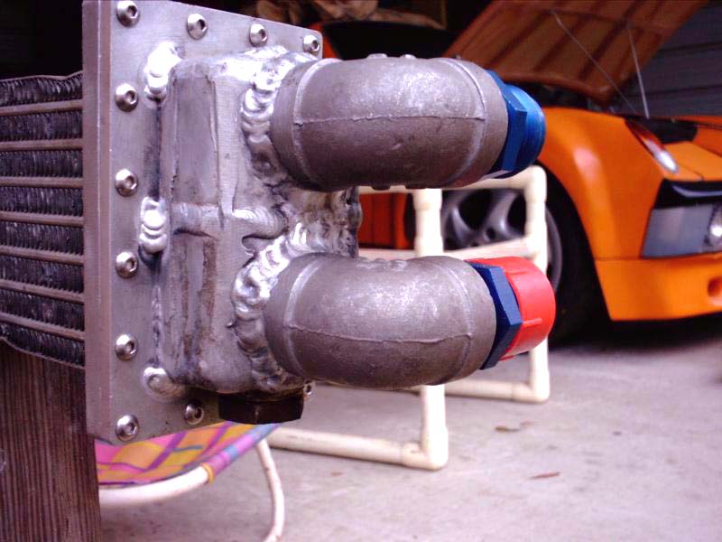

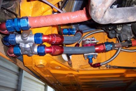

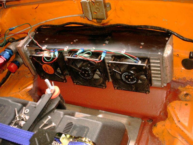

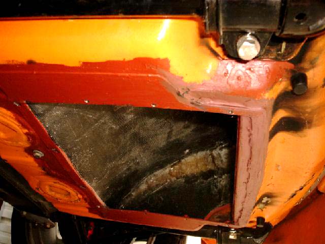

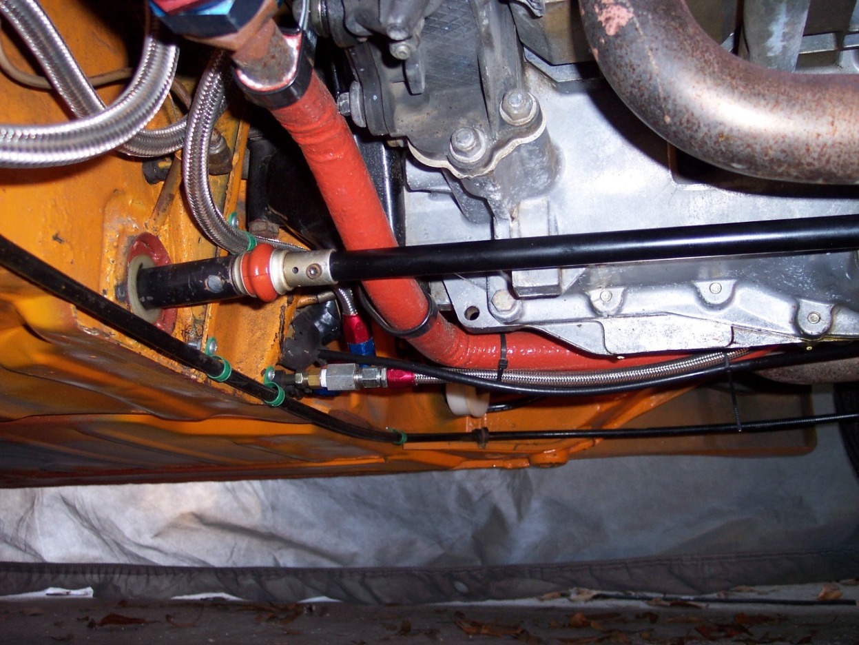

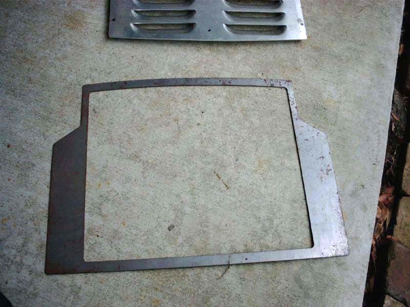

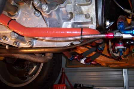

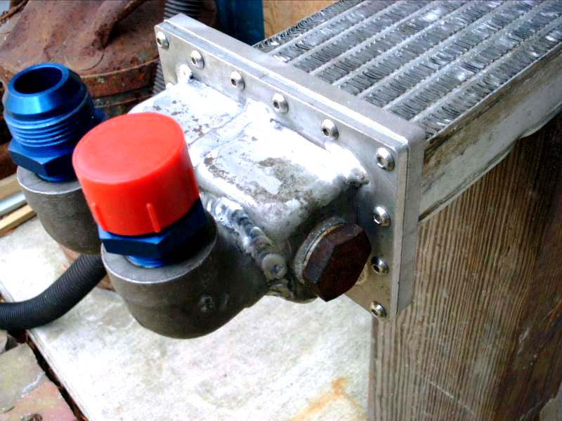

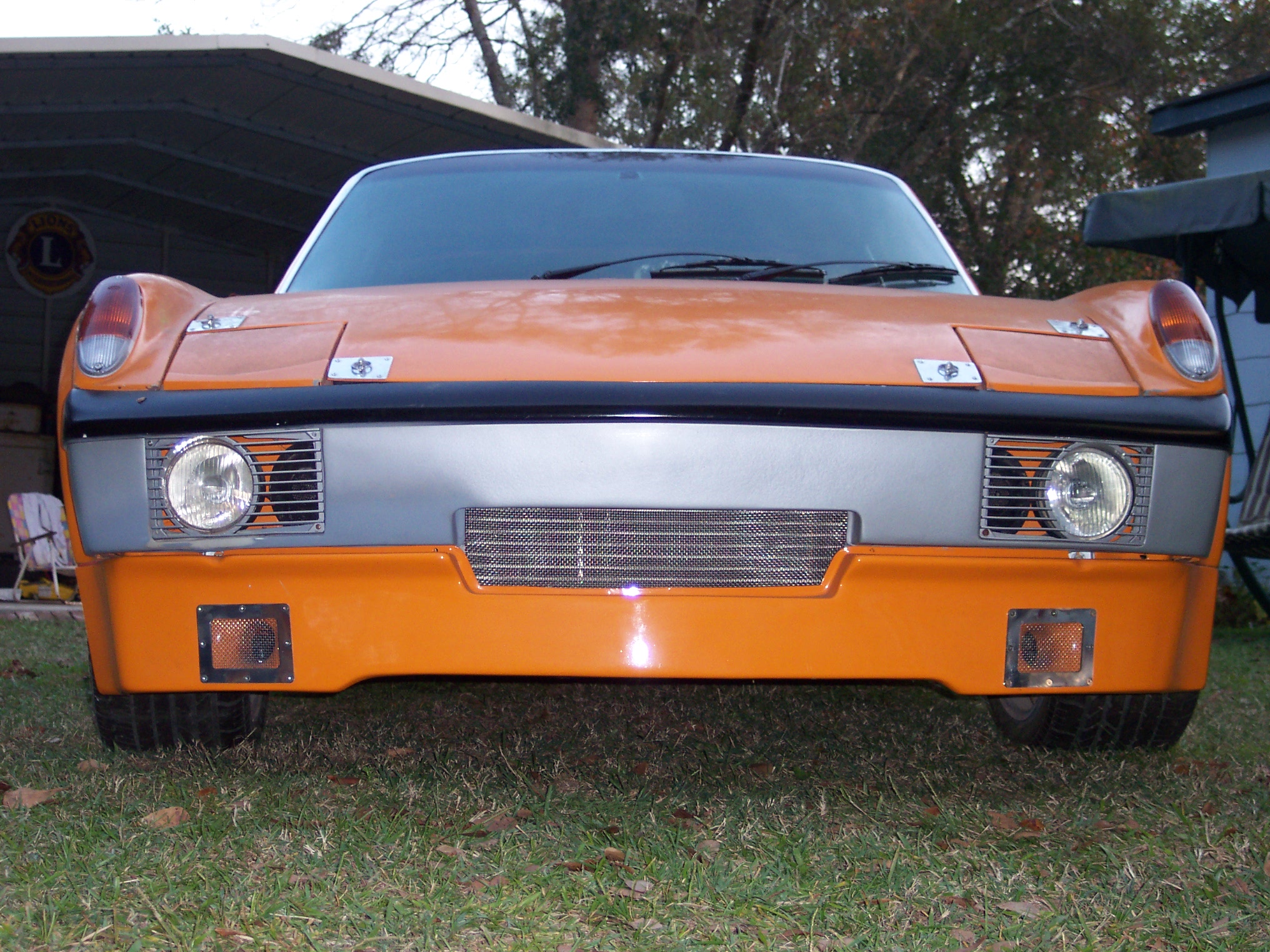

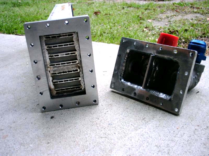

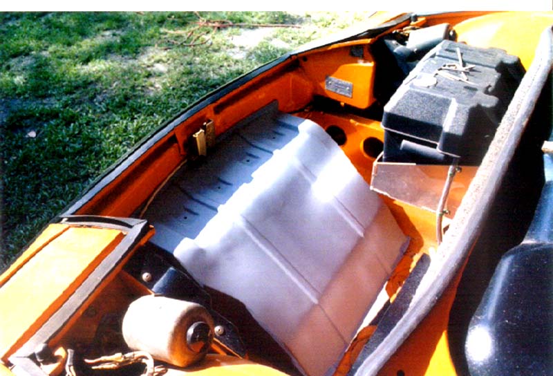

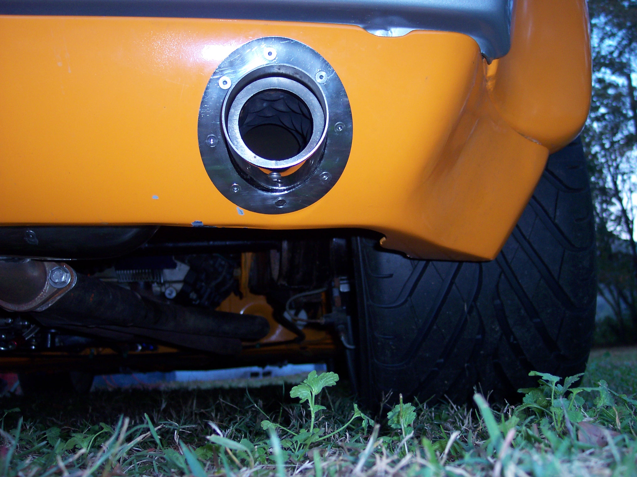

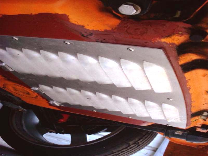

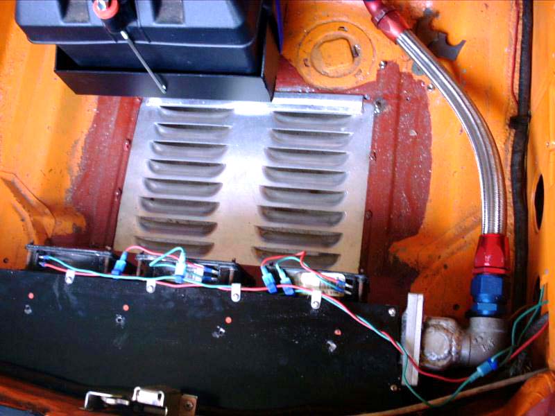

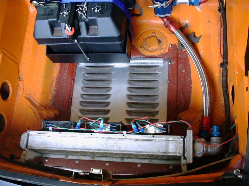

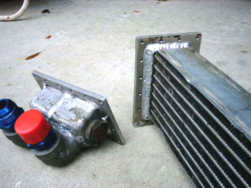

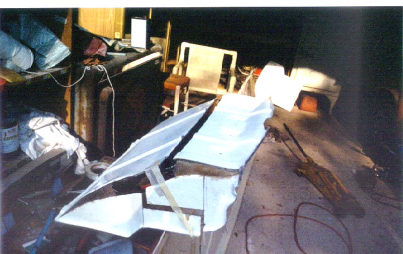

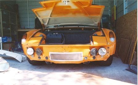

My car is running a 3.6l/915 trans combo so an oil cooler was a must. I got a Mazda unit off an early rx7,and modified it by removing the end-cap. I then designed and tig-welded on a set of flanges,so as to make the end tank removable for inspection and cleaning if necessary.The elbow fittings house -16 adaptors,and all oil lines used are -16 size. The o.c. is mounted in the chassis in such a way that it can be removed in about 10 mins.total. It is rubber mounted on a small crossmember underneath it.The crossmember was then shrouded with a pc of 18ga. steel that was welded in to form the lower portion of the exit ducting for the airflow. The front was cut for an opening,and I fab'd my own screen guard.Fiberglass bumper and spoiler were then cut and re-glassed so everything lined up ok. I used 3 100cfm fans for day it'll be needed for heavy traffic,they exhaust under the car,thru a louvered aluminum pan I designed.The oil cooler shroud had to be heavily cut,and sectioned to get it to fit right,but it looks,and works ok The system is pretty much leak free,and It now requires about 12 quarts of Mobil 1 to be full on the stick. Just to note,these pics were taken back on 2003.A lotta changes since then. Ron Attached thumbnail(s) ![]() ![]() ![]() ![]() ![]() ![]() ![]() ![]() ![]() ![]() ![]() ![]() ![]() ![]() ![]() ![]()

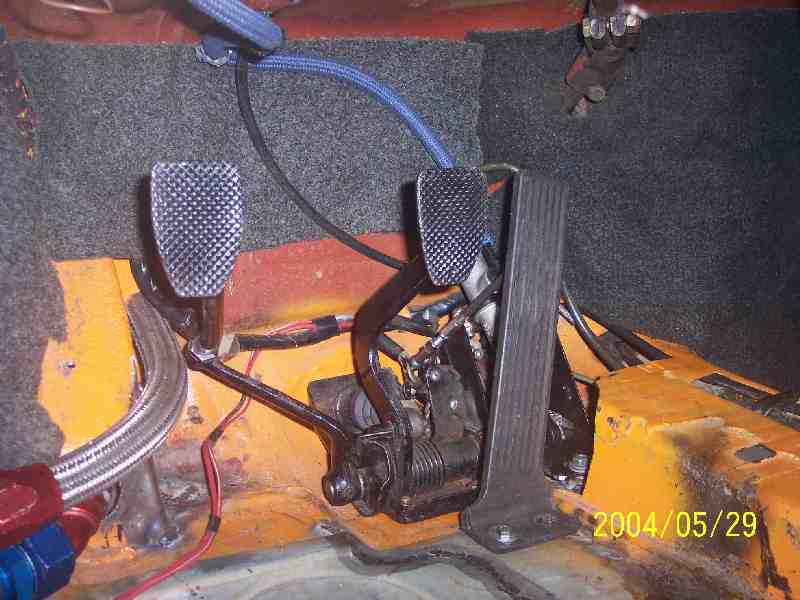

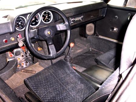

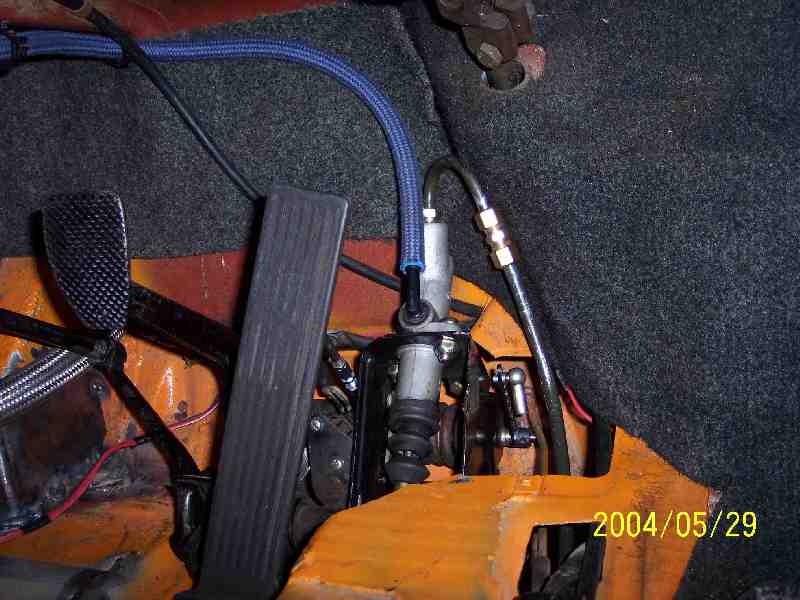

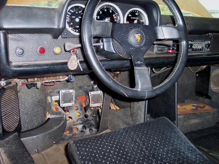

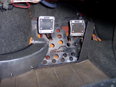

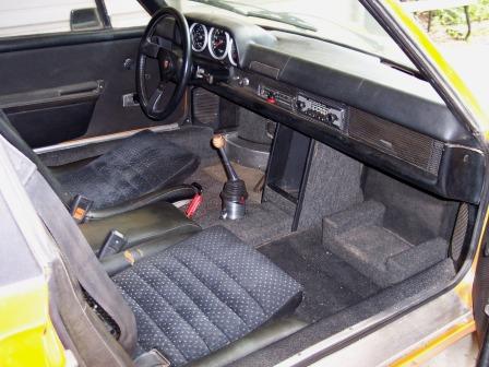

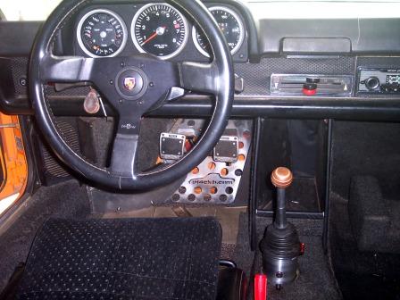

Car has a standard black cloth w/houndstooth patern seats.JWest eng. shifter. Becker Gran Prix stereo Personal steering wheel,I found it in a junkyard on a '77 280z.It was free. ![]() Full hydraulic clutch,adapted from a 964 unit. Made the pedal board from my own design,incorporating the club silhouette,laser cut from 16GA. titanium. My oil lines enter the cabin near the left foot area,so I fab'd a little cover to hide them. ![]() Triple combo gauge. Red lever,is the rear brake proportioning valve. everything else is run of the mill. Attached thumbnail(s) ![]() ![]() ![]() ![]() ![]() Entries on Wednesday 20th July 2005
