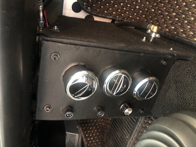

Southern Rods Condenser, mini evaporator https://www.southernrods.com/out-of-stock-m...--a-c-only.html and Patrick Motor Sports Oil Cooler and shroud. Electric Compressor is a Benling DM18A7. The carpeted trunk board goes over the shroud and condenser. I also drilled holes in the front spoiler to direct air over the condensor. So far it blows cold and then the amps go over 100 amps and blows the breaker. 914toy is running the same evaporator horizontal under the dash and his works fine. He also has 3 condensers. One in front and one installed with fans in each rear fender. Hopefully I will have time this summer to get mine working.

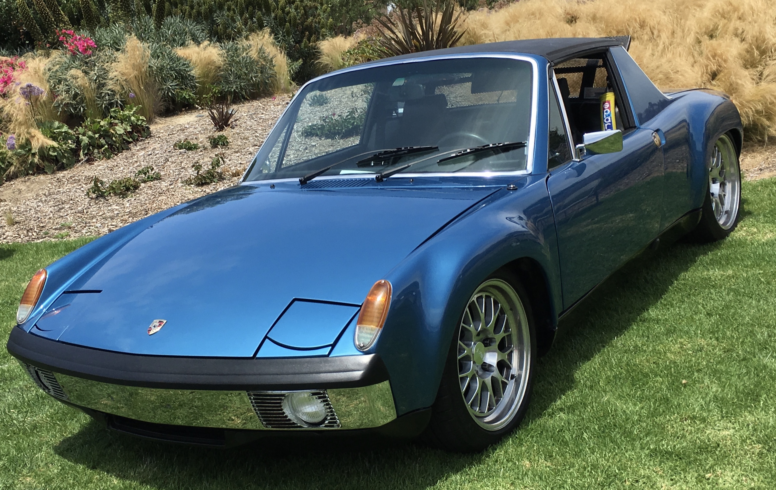

Purchased stock 1975 silver 2.0 four in Oakland in 1986, with immediate plans to convert to a six with MSDS quick six bar, headers and muffler. Was on the road by January 1987 with a 2.7 motor, stock trans, New PMO 40IDA3C Webers, MSDS headers, motor mount and muffler. Not too many 75 big bumper narrow body 914 six conversions at the time. I surprised a lot of 911's and 928's with this car. By 2000 the 2.7 started pulling head studs and at the time it was cheaper to buy a used 3.2 than to overhaul the 2.7. Current Build: Body: In 2019 I did a Color Change from Diamond Silver Metallic, to two stage Alaska Blue Metallic by Imperial Auto Body in Huntington Beach AA GT Replica Steel Flairs were installed by Beach Boys Racing in Venice Beach Engman Long stiffening kit 914 Rubber - Rubber Suspension: Front: Wheels: Fikse FM10 8x17 5-130mm (19mm) 225x45x17 Pilot sport tires 911 A Arms with Aluminum cross member with 18.8mm torsion bars Boxster Brakes 22mm Tarett Sway Bar Koni shocks Rear: Wheels: Fikse FM10 9x17 5-130mm (6mm) 245x40x17 Pilot Sport Tires Boxster rear brakes with 911 parking brake 200 lb 2.5" Rebel Racing coil overs with Eibach springs Boxed trailing arms and GT Stiffening kit Koni Shocks Drive Train: Rich Johnson Motor mount installed by Otto's in Venice Beach 1995 993 3.6 motor with RS Cams and Steve Wong chip. All conversion parts from Patrick Motorsports 1986 915 Transmission with Martin Bott 916 kit and Patrick Motorsports shift linkage and clutch parts. MSDS 1 3/4” headers and M&K 2 in 2 out muffler. Stock 914-6 Oil Tank and PMS front oil cooler and shroud.
