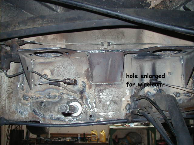

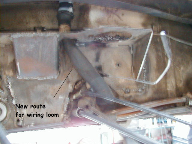

2.) Aftermarker sheet metal fits like shit in places. If you're using a 2.4 CIS motor like I am, the accelerator hole is is the wrong place. The hole for the wiring to the starter is round and the square rubber insulator from the '73.5 just won't fit.
