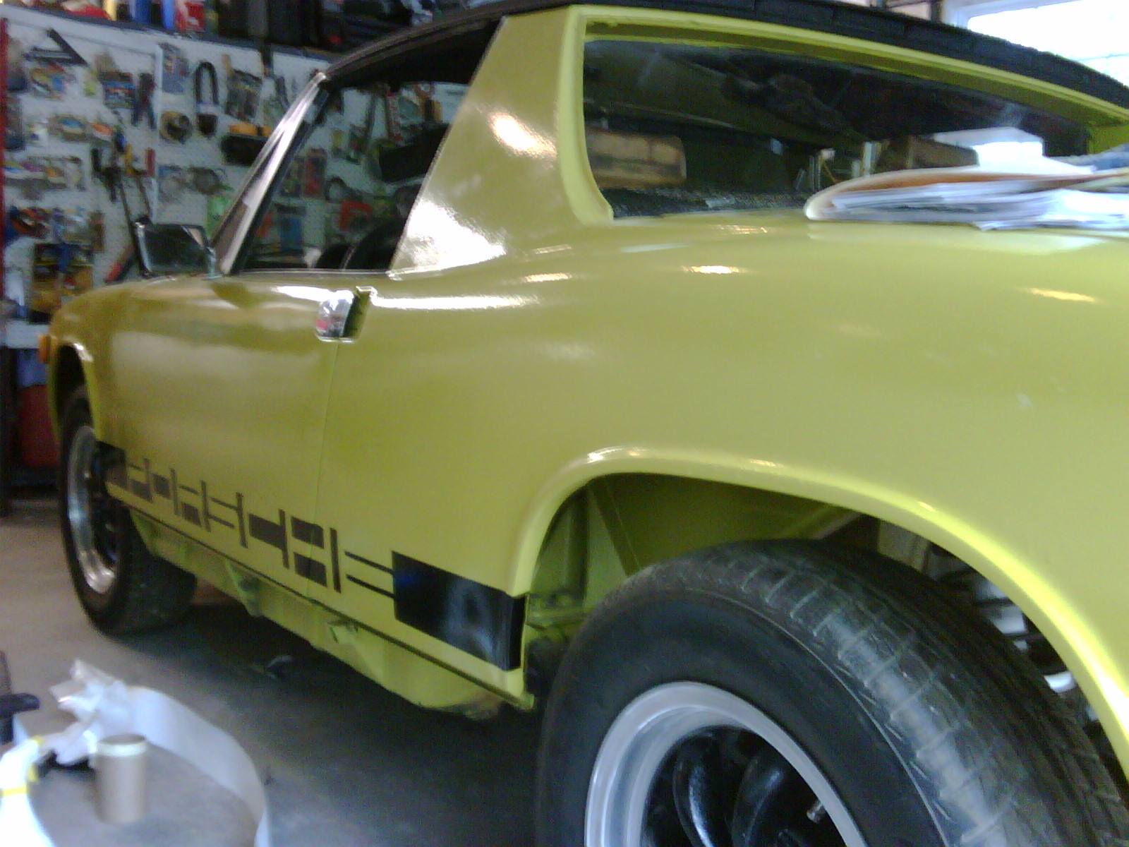

entry May 10 2010, 12:55 PM
I installed the "PORSCHE" vinyl graphics this weekend. Looks pretty good! I needed some visual satisfaction.

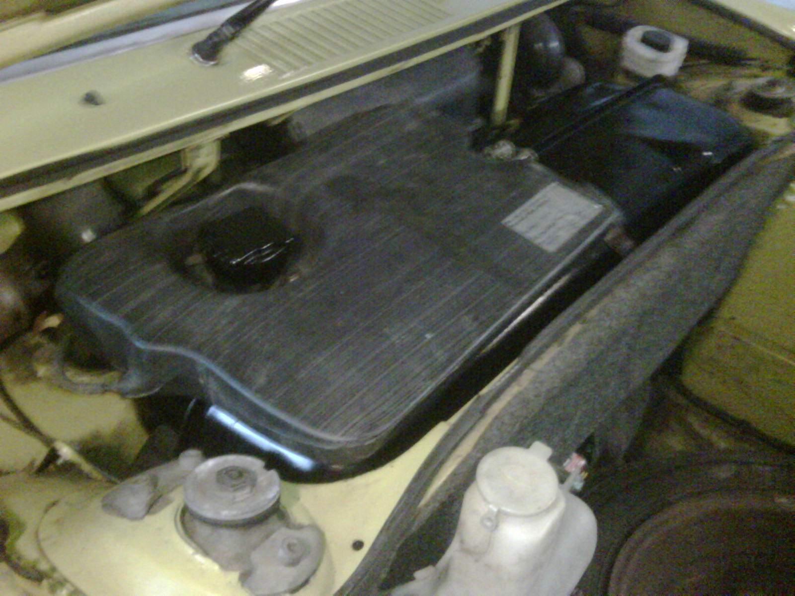

entry Apr 19 2010, 06:14 AM
I finally aquired all the items ti install the gas tank. I bought all the gaskets for the sending unit and evaporator tank with the correct brass bolts and washers from AA. I had a hard time finding a gas cap but got it and put the new gasket in it as well. I capped of one of the holes in the bottom of the tank since my car is carburated.

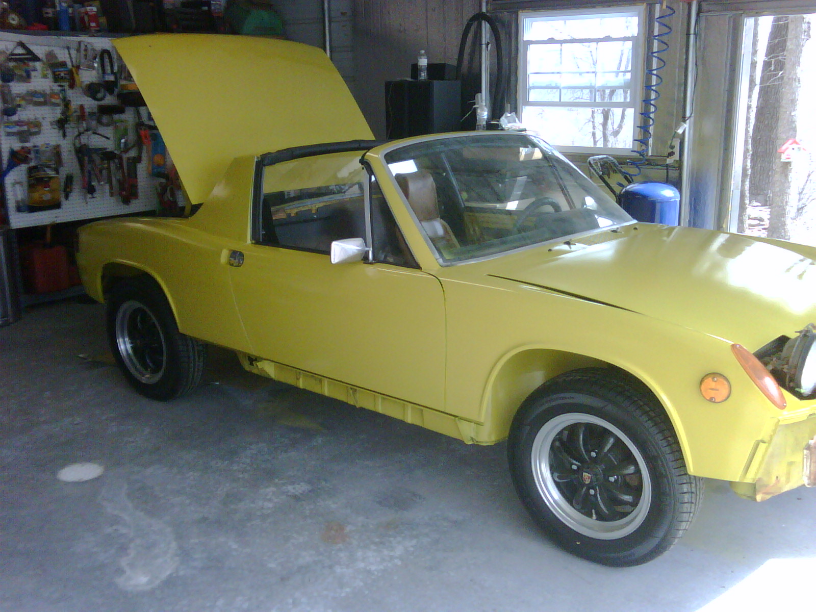

entry Apr 5 2010, 08:44 AM
Finally got to put on the new (used and refinished) wheels and new tires. Starting to look good.

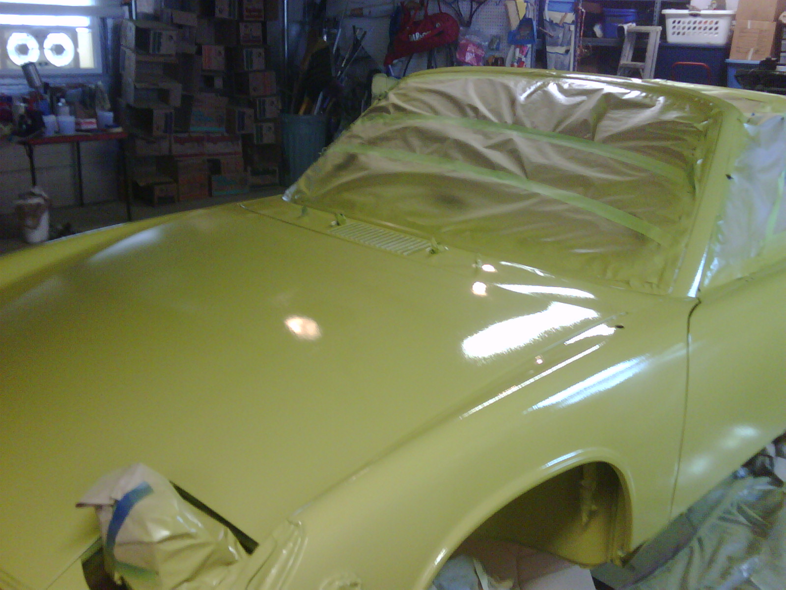

entry Apr 5 2010, 08:39 AM
Got all the "Berber Yellow" paint work fininshed. I will need to shoot all the black items next. The lower rocker panels, engine bay lid ect. I still need to order a few more parts and it should be road worthy soon! Paint turned outpretty good if I say so myself! One coat of sealer yellow, three coats of base and three coats of clear.

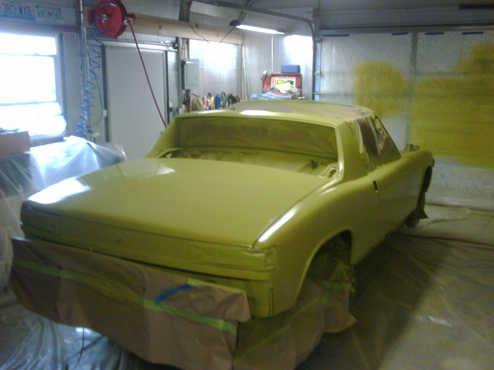

entry Mar 30 2010, 01:37 PM
I am taking off two days this week plus we are closed on Good Friday. I hope to get the body painted in its original one year only color Berber Yellow! I have been prepping the body now for a few weeks on weekend and some nights. Everything is taped and prepped off. All nicks and dings have been filled and sanded and sanded and sanded.... I have enough paint supplies for one coat of bright yellow sealer, three coats of base and two coats of clear. I will attach pics of my work after the weekend. Wish me luck! I am a beginner and this will be shot in my make shift paint booth...the garage.

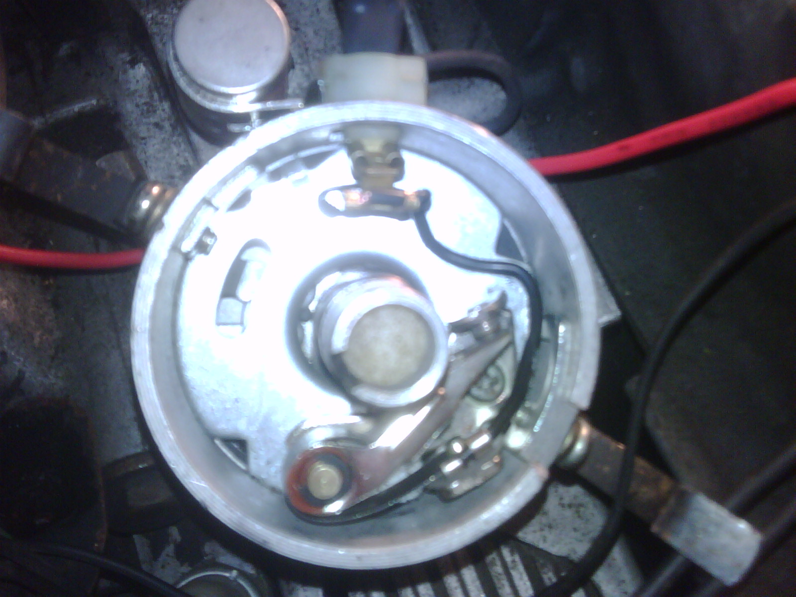

entry Mar 25 2010, 08:21 AM
Okay...I finally found out what was REALLY going on. Why it wouldnt re start. The ignition did need replaced but not the main reason.
The prevoius owner had installed a Chevy one wire alt. I was getting a full 12V to the points at all times and it had melted the insulator on the points cam/rod/bar" thingy"?". I was told that it is supposed to get only 9.3V with the key in the run position and 12V only when you engage the starter. Notice in the picture the orange stuff melted. Gap and everything was set correctly, it just had leaned over enough to ground out without the insulation on that little bar. Solution: I could have intsalled a new set of points and a "univerasal ballest resistor" on the wire going to the dist to reduce the voltage to the correct amount (9.3). Instaed I went ahead and upgraded to a 12V Pertronix electronic ignition that will handle the full 12V's all the time. Runs better than ever now!
