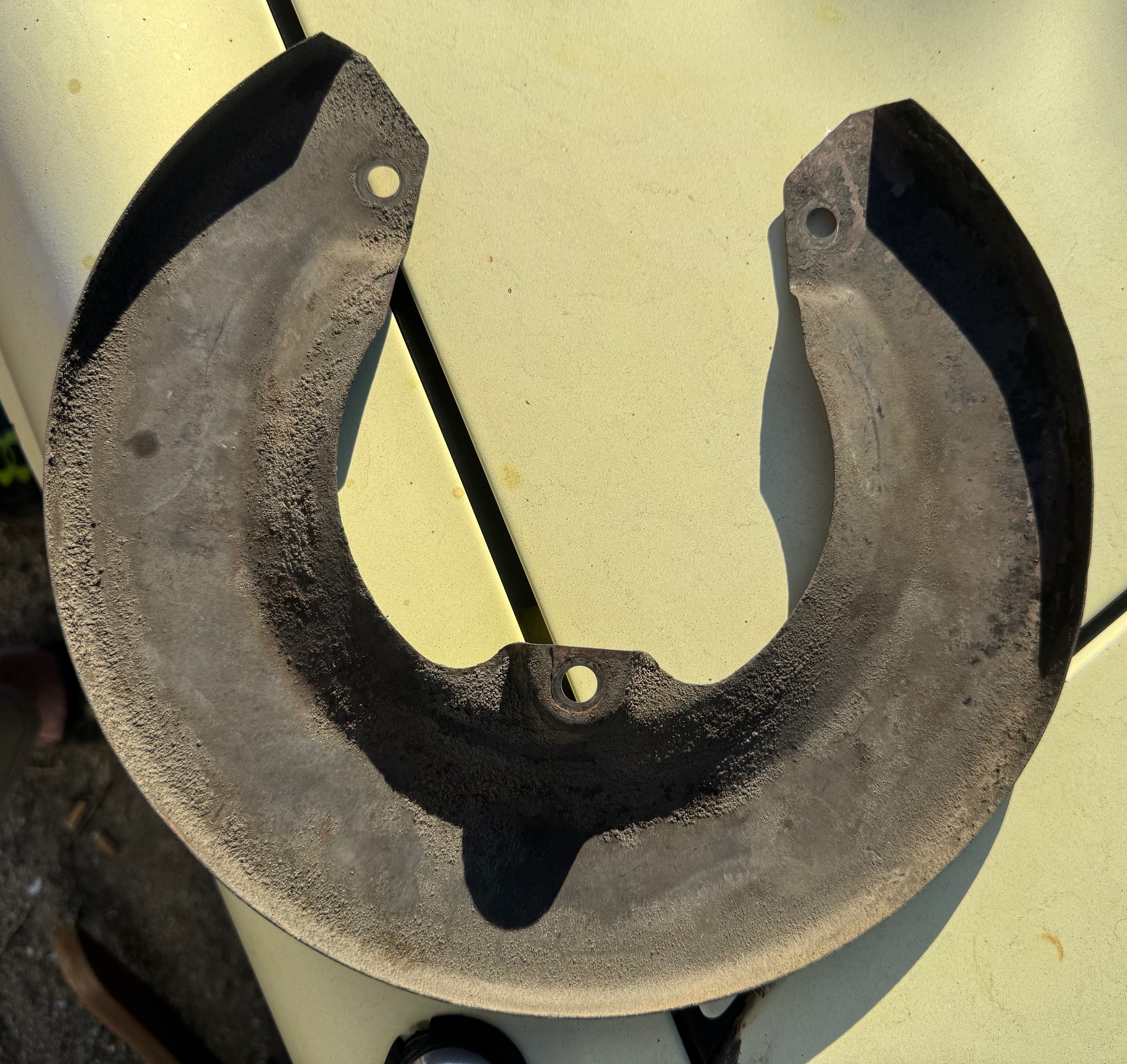

Shivers
post Nov 14 2025, 01:06 PM
Posts: 3,176
Joined: 19-October 20
From: La Quinta, CA
Member No.: 24,781
This cover is off my 1972 4 cyl. I put it side by side with the cover from above. Different
Attached ImageAttached Image
