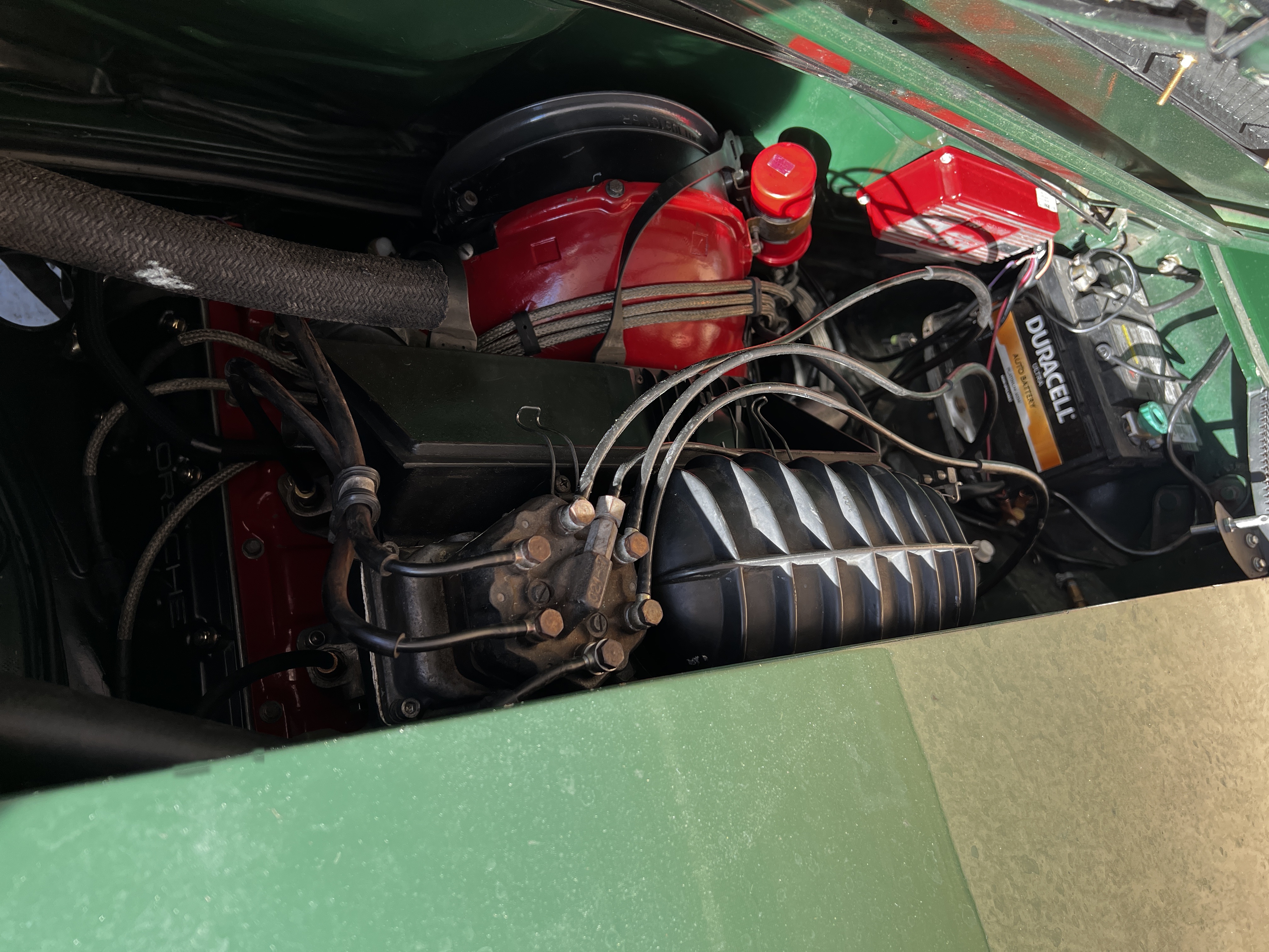

They do fit, Airbox and all. THe mount you are using may prevent that. I used the Naro style mount. I have since converted to triple webers but it fit.
The builder before me that had it on CIS did notch a very small area for the fuel distributor fuel line to clear. It was minor.
There is another member here with a white car (can't remember his darn name, in the San Diego, CA area that has one that is extremely well done). CIS airbox and all.
