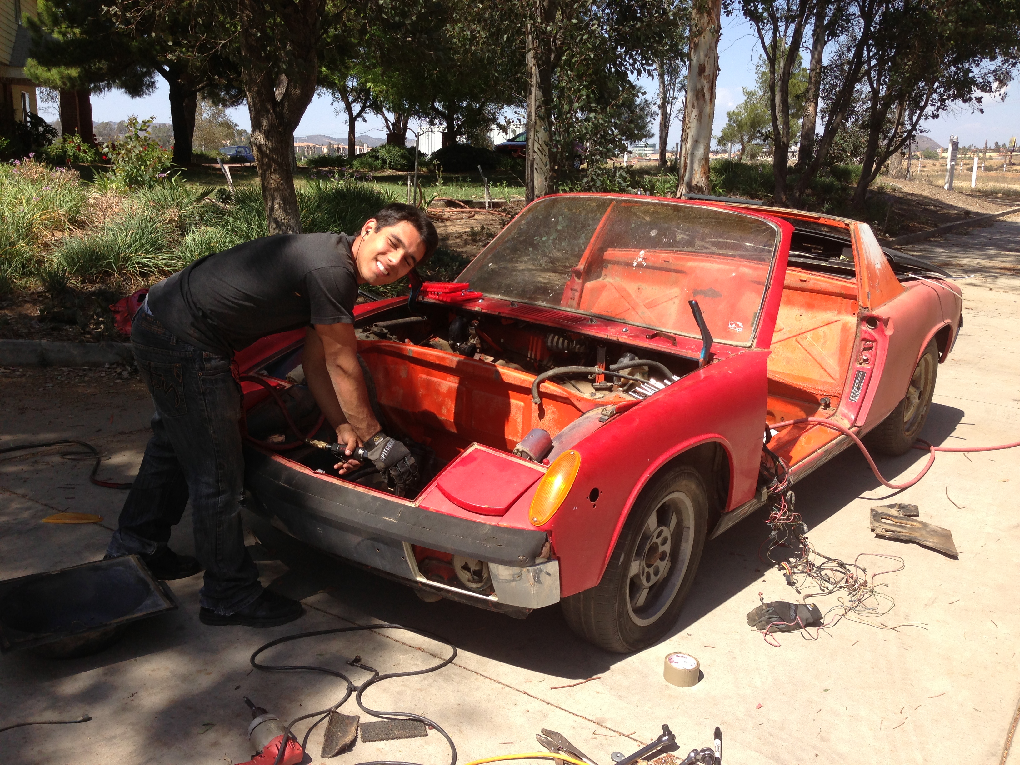

I have most of the car stripped. Making a rotisserie. As soon as rotisserie is completed I plan on media blasting. Looked into media blasting with pressure washer and crushed glass. Looks like that is the way I will be going. I'll post pictures as soon as I complete the rotisserie.

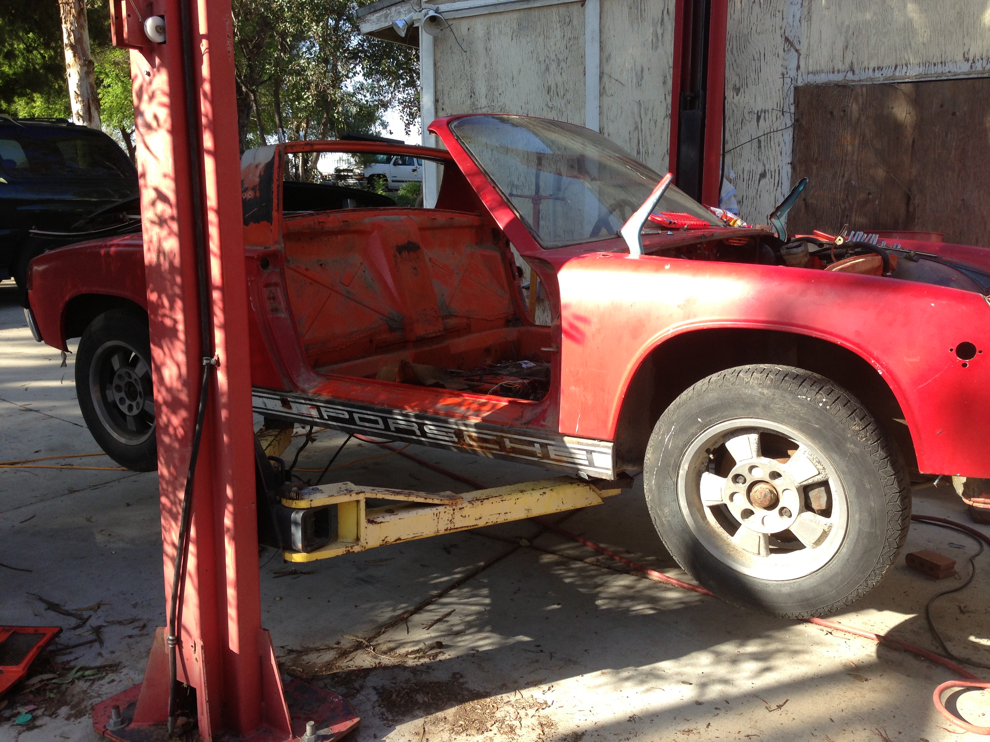

Well here are some more pictures of the progress. We have removed everything inch of wire, grommet, tubing, cable. All we need now is the suspension. Building rotiserrie before i take suspension off. My trusty helper is my son. We are enjoying this project immensely.

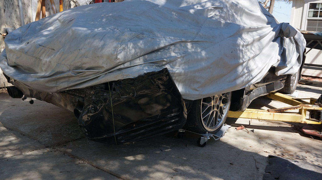

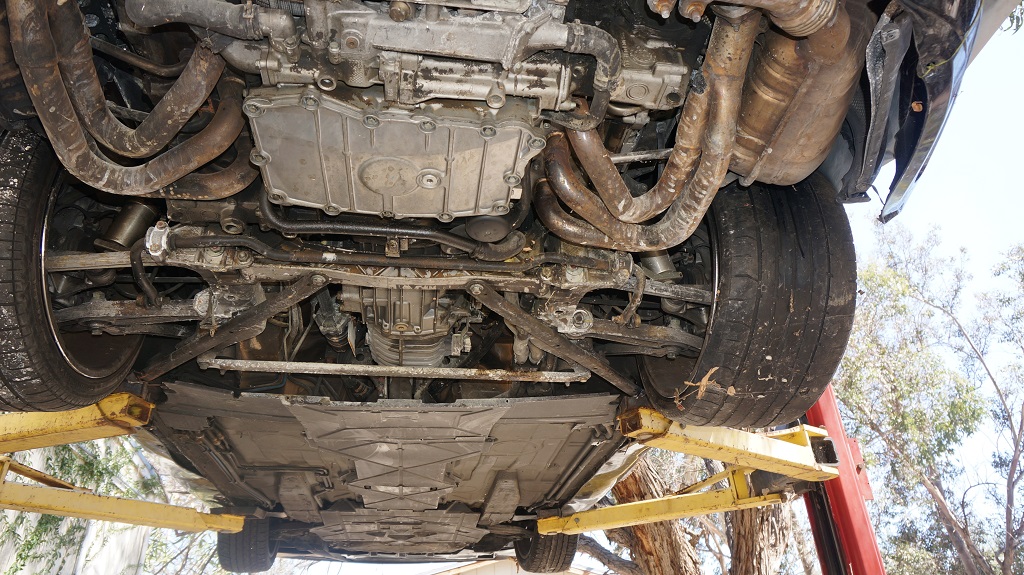

Well it has been a while but I have been collecting "stuff" so that I can start and not have to stop too often. I purchased a 2000 996 C4 that was involved in a fire. I am able to use the full suspension, Brembo big reds, jic coil overs, radiators, ac condensors, power steering, power brakes, transmission, axles, pedal assembly. I am purchasing steel flares this week and then I will be able to start work. I will be posting pictures of the German piece of coal donor.
It is going to be a 916 like you haven't seen yet. Top is coming off, steel speedster humps, lowered floor, lowered glass and raked back. Steel cage/frame. I'm wanting to modify the 996 aftermarket front bumper to work with the 914 front an 916 front flares. I'm also removing the front square pop up lights. The real surprise is what I have planned for the rear fender and quarter panel. More to come.

Whats your plan on using the transaxle in mid engine conversion. I don't think you can rotate the 996 transaxle to run in a inverted posistion. Is the ring gear reverseable like in the 930 boxes.
Curbandgutter
Aug 5 2014, 11:50 AM
QUOTE(BIGKAT_83 @ Aug 5 2014, 07:01 AM)
QUOTE(Curbandgutter @ Aug 4 2014, 03:13 PM)
You can invert the 996 gearbox. Verified with GBOX. Only thing is that I think that I will need to add taller ring and pinion. If I use a 325/30 19 tire with stock rear it will cruise 70 MPH at 2550 rpm. If I use the 3:1 rear end, then it will cruise 70 MPH at 2200 rpm. I'm getting a quote to do the taller rear and LSD. Let's see what it ends up at.

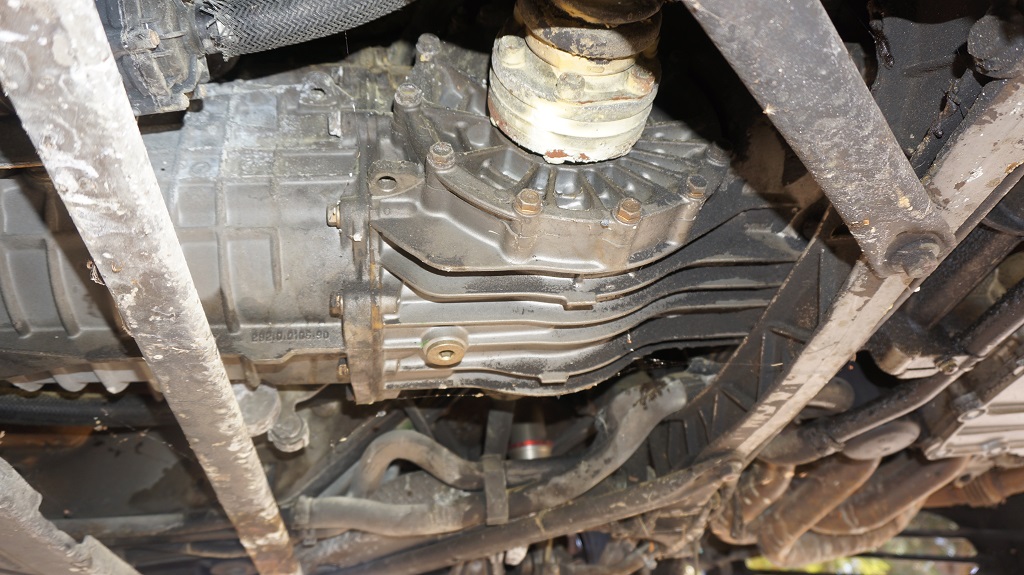

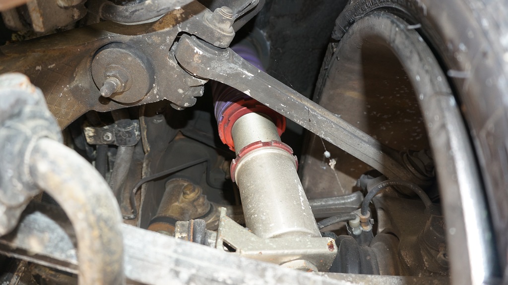

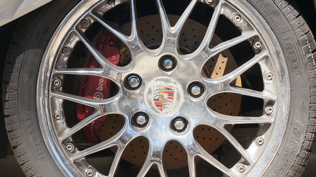

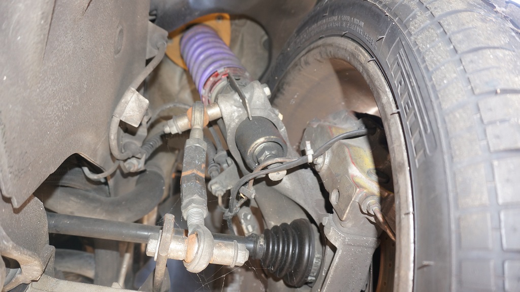

Well since I have to wait until my sand blast kit shows up, I'm taking the front and rear suspension off the 996 to mock up on the 914. Looks like the front will be easy. The rear will require a tube frame. That's OK though since I am planning to tube the rear. I'm planning to pressure wash the suspension this weekend and mock it up on the rotisserie with the car upside down.
87m491
Jun 17 2016, 09:52 AM
Wow, a ton of adjustment (and adjusters!) on those coil overs.
