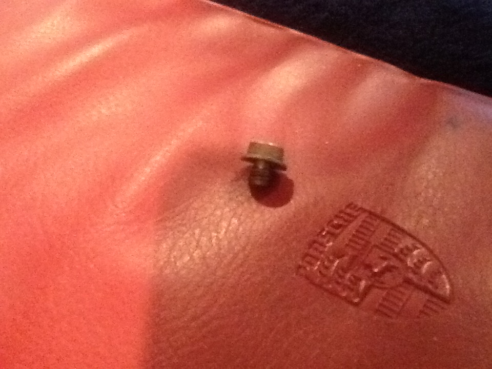

Beach914
Like this. Hard to keep from losing.....
jeffdon
QUOTE(Beach914 @ May 19 2017, 07:43 PM) *
Ah...its M4 x 6, 0.70 pitch. Got one from EASY in Emeryville. They like to fall from your fingers and get wedged under the dizzy hold down.
