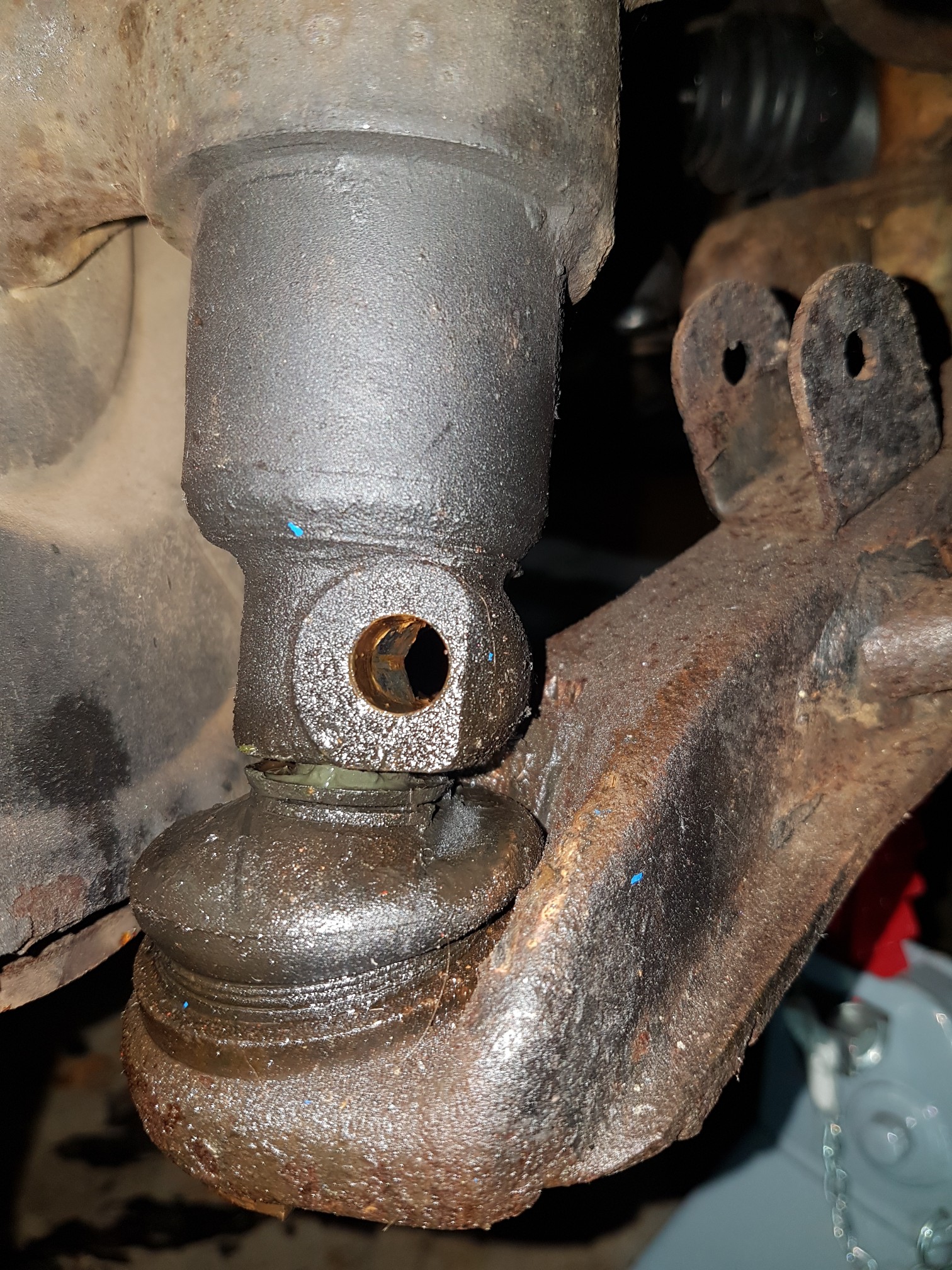

I wanted to ask for some tips or advice on this to avoid any damage!
I am trying to change my ball joints (73) which have rotted (rubber is cracked) Decided to buy the tool for the ball joint nut (Sir tool 4 pronged).
1. First off I've removed the cinch bolt from the base of the shock absorber but the ball joint pin seems firmly attached inside the base of the shock absorber/strut.
Can I heat that area to try and loosen it or does that risk damage to the shock/strut?
2. Is a pickle fork safe to use here, I'm concerned about damaging the control arm (not concerned about the ball jt as its going in the bin)
3. Is an impact driver best to remove the old balljoint nut (using the 4 pronged socket) or can you use a breaker bar? Same question for torquing up the new one. Wondered if people have used a thick walled ext bar on their breaker bar for more leverage?
4. Finally I've started this with the top hat and brake caliper still attached. Should I have removed these first?
The 4 prong tool is for install ONLY not removal.
For removal you need penetrating oil and the largest pipe wrench HD sells.
Trying to use the 4 prong tool for removal will only result in a broken tool. Don't even THINK of trying to put an air impact wrench on it.
Again. Take your #3 idea and throw it away. Use a big ass pipe wrench.

Thanks Zach and Mark for your advice. I bought the $70 tool from pelican. I probably need to buy an Impact wrench as I don't have one and will need it to tighten up the new nut.
Is it okay to heat the base of the strut? No risk of damage to the strut end. I had an initial go with a pickle fork but the top of the old ball jt seems to be stuck in there. I don't want to damage the bottom of the strut or the control arm. Is liquid heat a spray on product? I've been soaking it with WD40 for some days!
Nick
WD40 is water displacement, not penetrating oil. Liquid heat is tongue in cheek for a torch. Buy a mapp gas torch at your local home center. $50 and you will wonder how you ever lived without it. It's fine to get the strut hot. It will damage the paint but since heat will expand what's holding a part in place, it helps break the corrosive bond and is actually a more gentle way to separate parts than brute force. Once you get the part hot for 2 minutes, let cool a bit, spray penetrating oil to lube the area that needs to slide or get unstuck and then remove. If it doesn't come loose, repeat and don't be shy about the heat.
I've always found the pickle forks that are usually available have too shallow an angle to really wedge off the balljoint. There's a balljoing separator that sells cheap and your local flaps, autozone, etc might lend it out.
