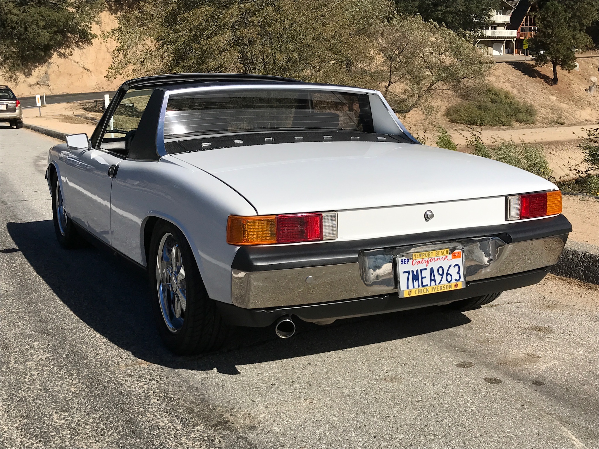

Coondog
Nov 14 2017, 05:40 AM
Here’s what it would look like and it’s super quit. I considered duels but wanted the sleeper look.

mmascari
Nov 14 2017, 04:43 PM
QUOTE(Coondog @ Nov 14 2017, 03:40 AM)
Click to view attachmentI like the stock look better. My car is not flared so without the rear valence it looks odd.
