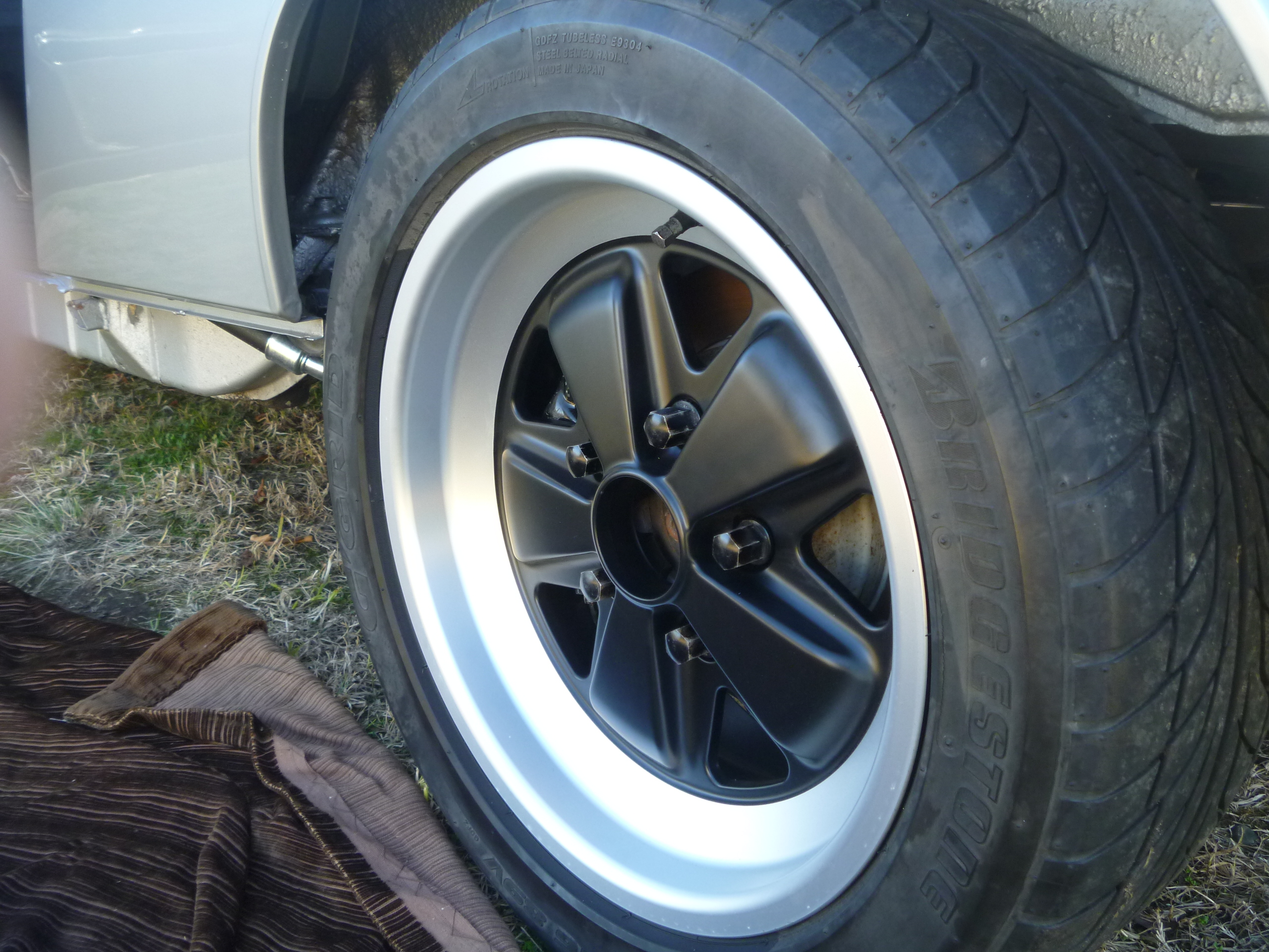

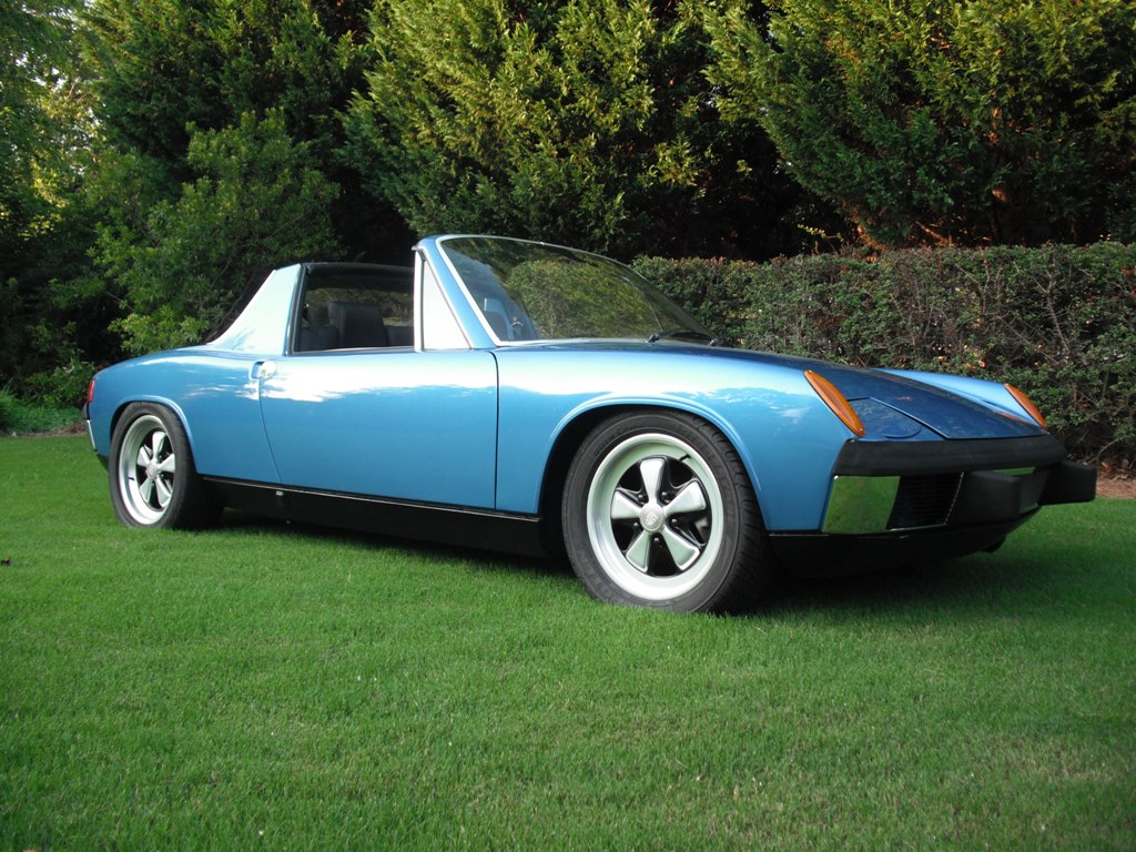

I would like to go back to 15x6 from my 16x7 because I really like the look more,I bought Maxilites and found them to be good quality I paid less than 1K for the set (4) ,they are a slightly different casting than the genuine Fuchs but its hard to notice.
Click to view attachmentOne pleasant surprise was the weight of the Maxilite wheel...not a lot heavier than the Fuchs.

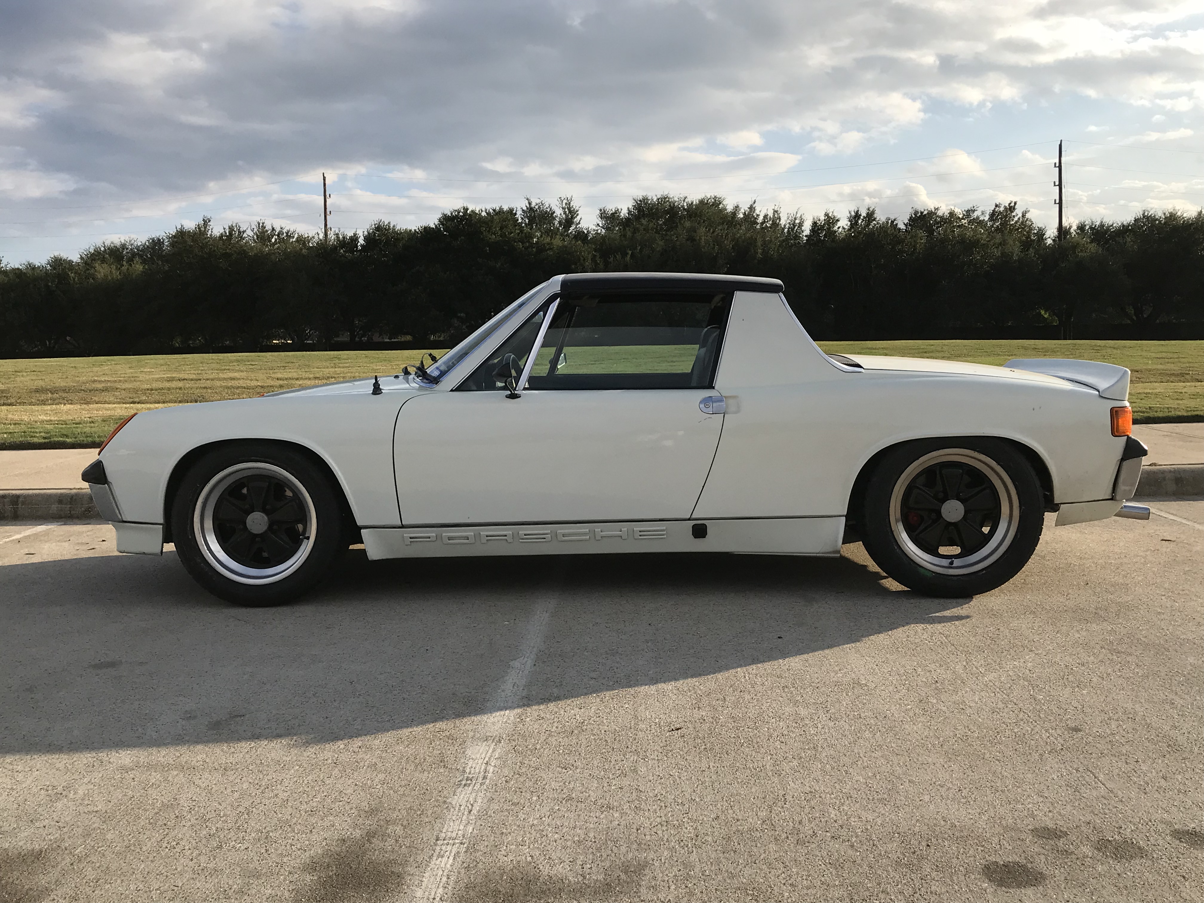

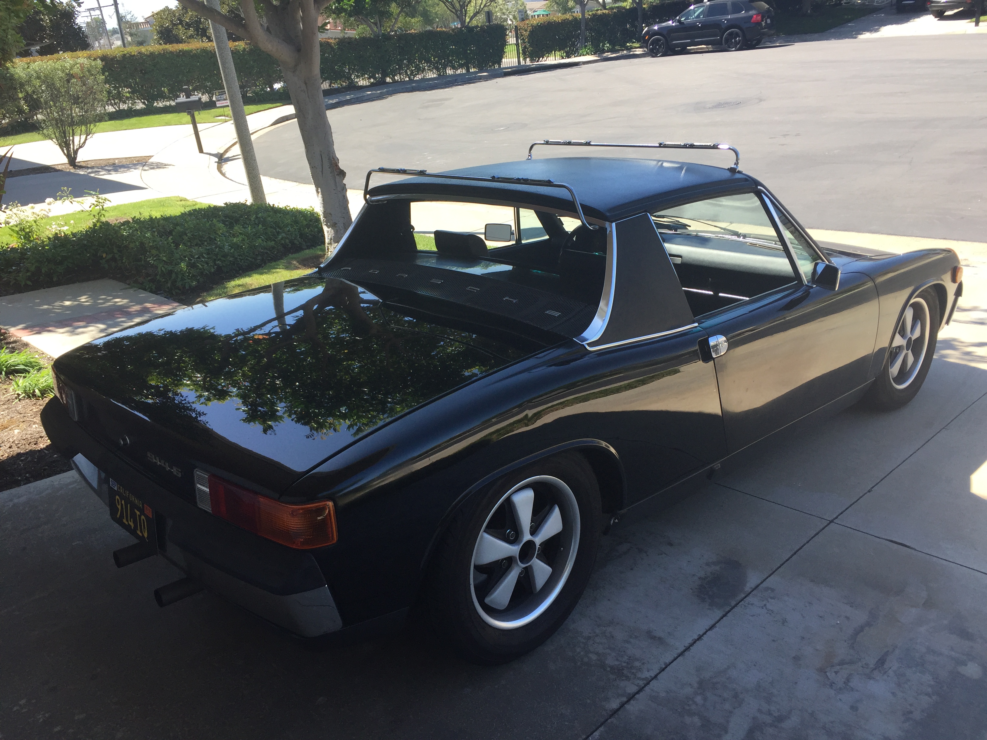

Click to view attachment These are real deep sixes in RSR finish running 205/60 x 15 Yokohamas. Real Fuchs wheels are super light, very strong, and getting expensive. I prefer the look of 15s on our cars, but that is just personal preference. They look great IMHO, but some of the replicas on the market today are hard to distinguish from the real thing.
Dec 16 2017, 07:48 PM
If you want to prove to yourself that 7’s won’t fit, you’re welcomed to borrow one from me to try on your car. I wouldn’t do it though because your paint is pristine so even a little “gotcha” would suck. 6x15 - 205x60x15 fills up the wheel well and is actually a lot of tire for a stock 4. Get a high performance tire. Most of us drive our cars so little that the tires will age out long before they wear out.

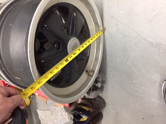

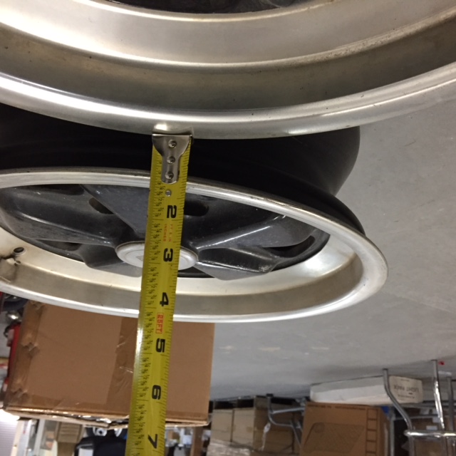

This car has 16 x 7 (951 prefix part number) in the rear
burton73
Dec 25 2017, 09:19 PM
951SN- 7 x 15 are the very same as a 911SN -7 x 15.
I have both in my shop and have taken measurements and they are the very same. Now 8 inch 951 in 15 look like 7 from the front side but are 8 inches wide.
I have pictures in my phone and have posted them here before

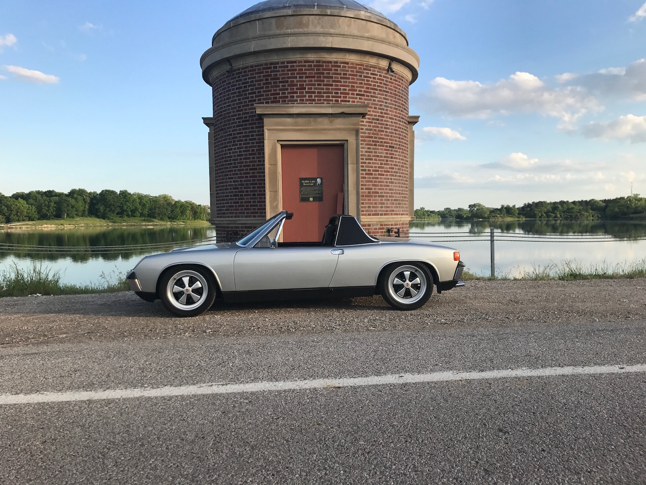

These are Fuchs on 6 & 7's - my original car build. It was too much in the rear with the 225's - took allot of massaging. It ultimately fit but barely...contrary to the appearances, they did not rub. Also, I should have left this car this way - it was badass! Live and learn!
