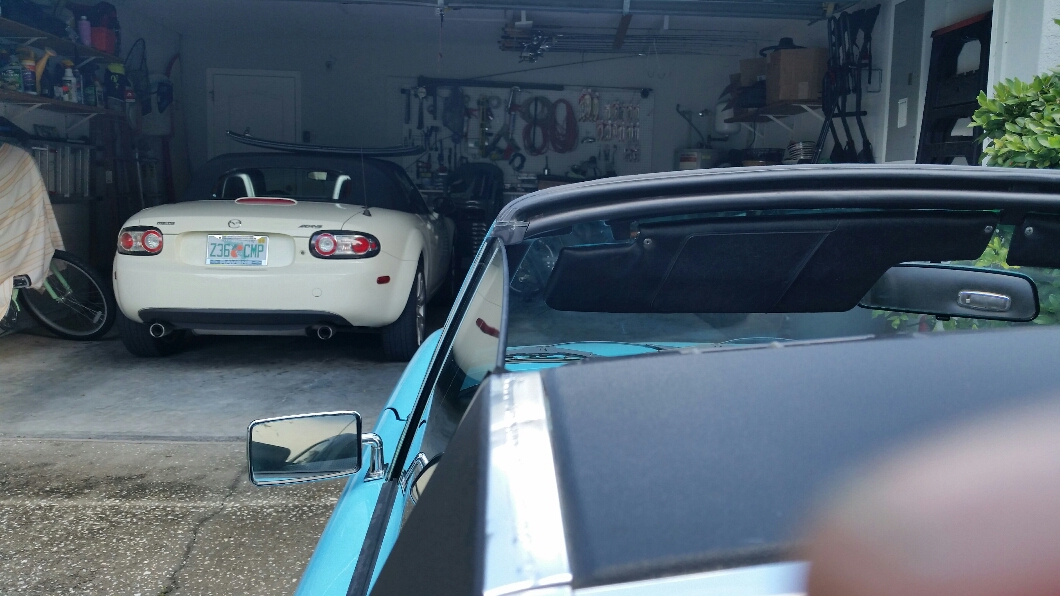

sholman5
Jun 2 2018, 12:09 PM
I have a 73. Manufacture date 10/72. Early top. Seal channel curves to the inside as well as the window.
Click to view attachment Click to view attachment
theer
Jun 2 2018, 01:49 PM
Aha! That picture of the top of the window is perfect. The arc of the glass (higher in the middle), at an angle to the plane of the top rails = a slight bow in at the center.
Never really noticed the arc of the glass before.

jcd914
Jun 2 2018, 02:44 PM
QUOTE(theer @ Jun 2 2018, 12:49 PM)
I looked at 3 tops today and they all had the slight curve in from the edge of the top.
Now it makes sense.
