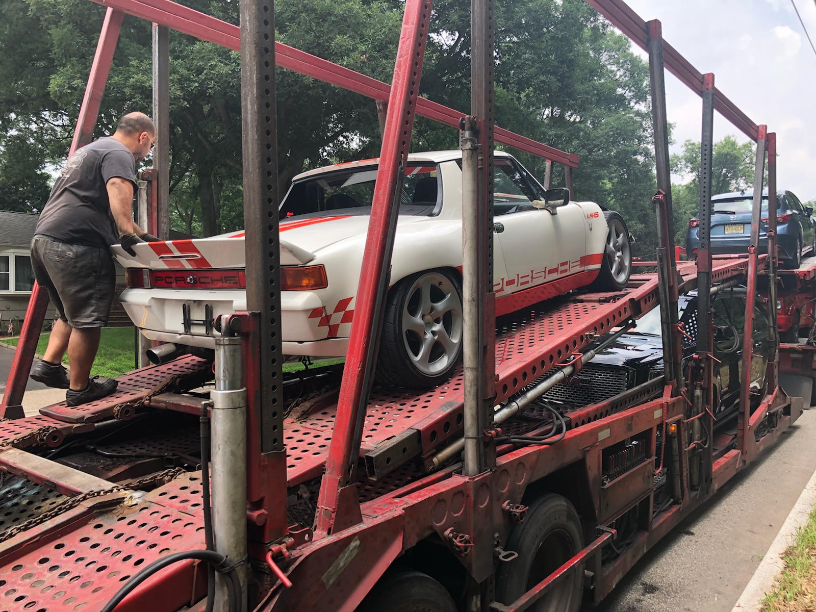

Many of you know that the car was on the east coast and I live on the west coast. It was picked up yesterday but the transportation company. Paul was a great help accommodateing the driver and reassuring that it would tranport just fine. I wish this company had tracking but at least this way I won't be watching it's every move as I wait the 7-10 days going coast to coast.
If you see a white 914 on a red auto transport truck. Please let me know!

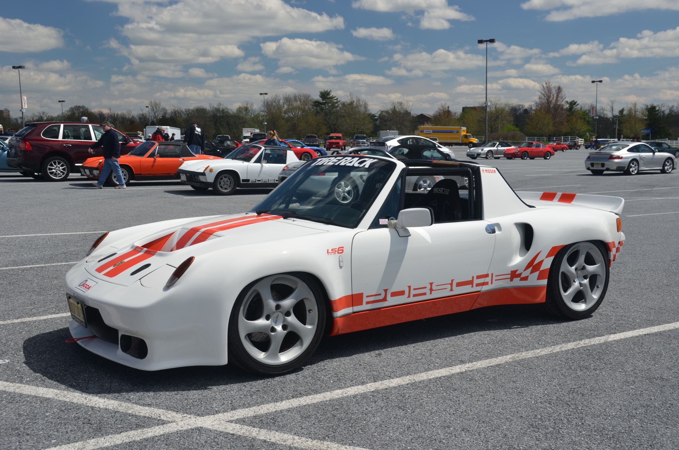

One more picture of what it looked like in it's prime then we'll get to the current situation.

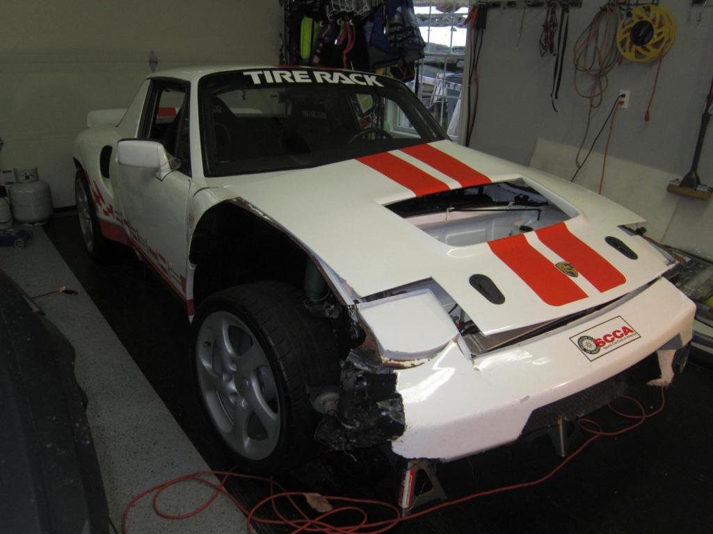

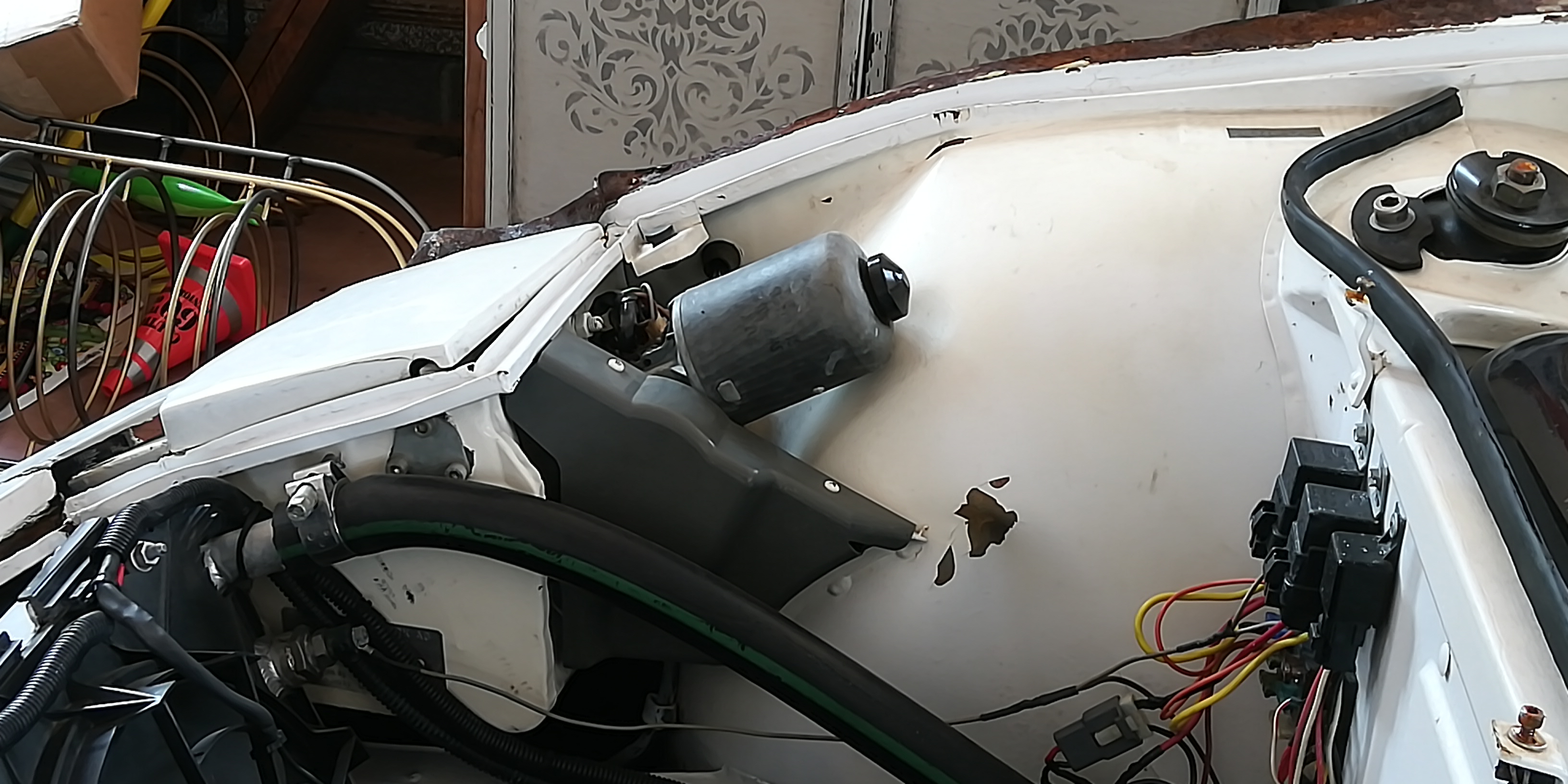

Here's a teaser of the current condition. Yes Paul is ok. Probably a bit heartbroken I know I was when I did similar work to my BMW.
The 914 sustained front end damage. But fortunately the really important stuff is fine. Even the radiator looks ok.

dan10101
piratenanner.gif piratenanner.gif piratenanner.gif piratenanner.gif piratenanner.gif
It's HERE!!
longest 13 days of my life...

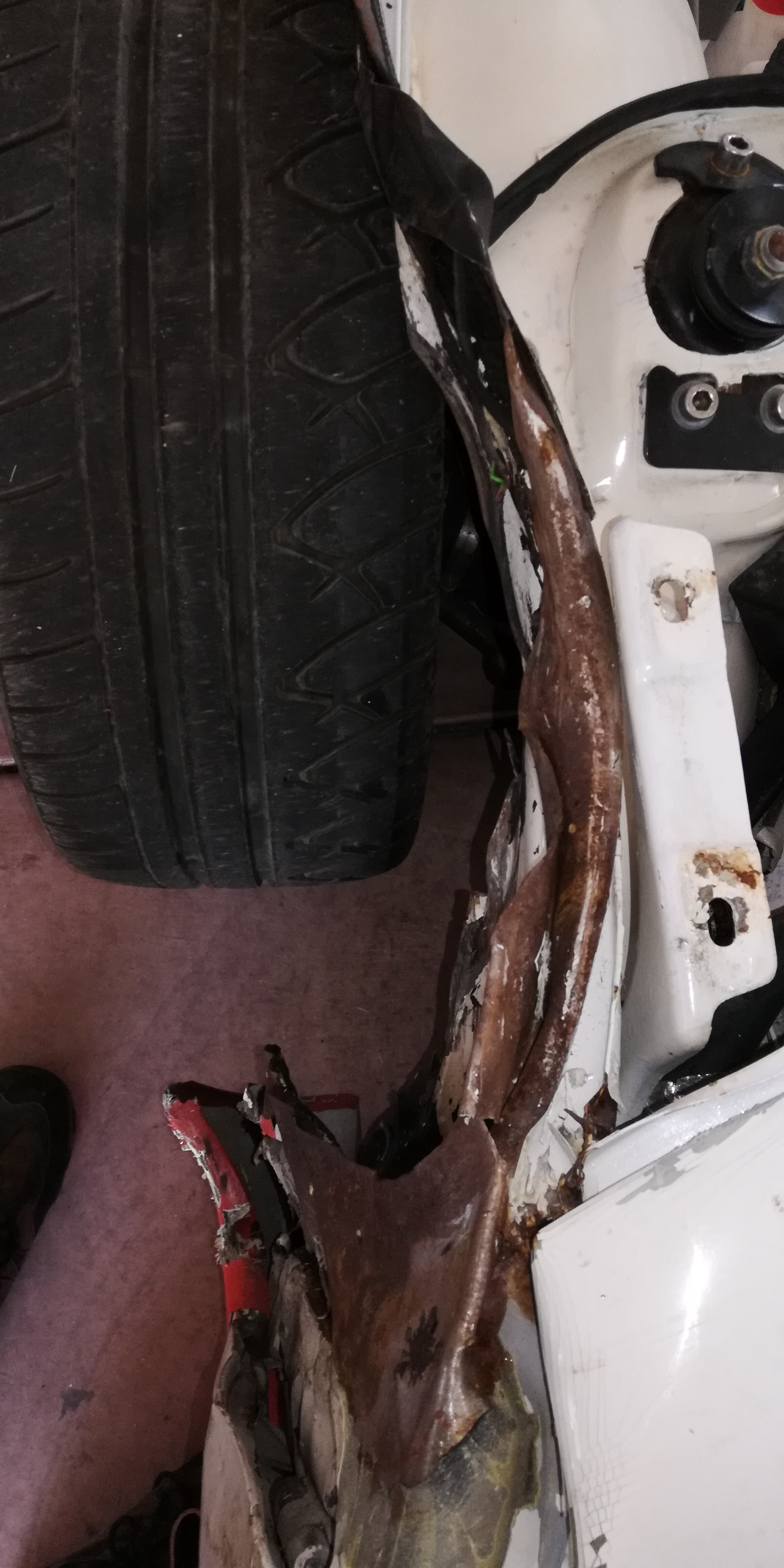

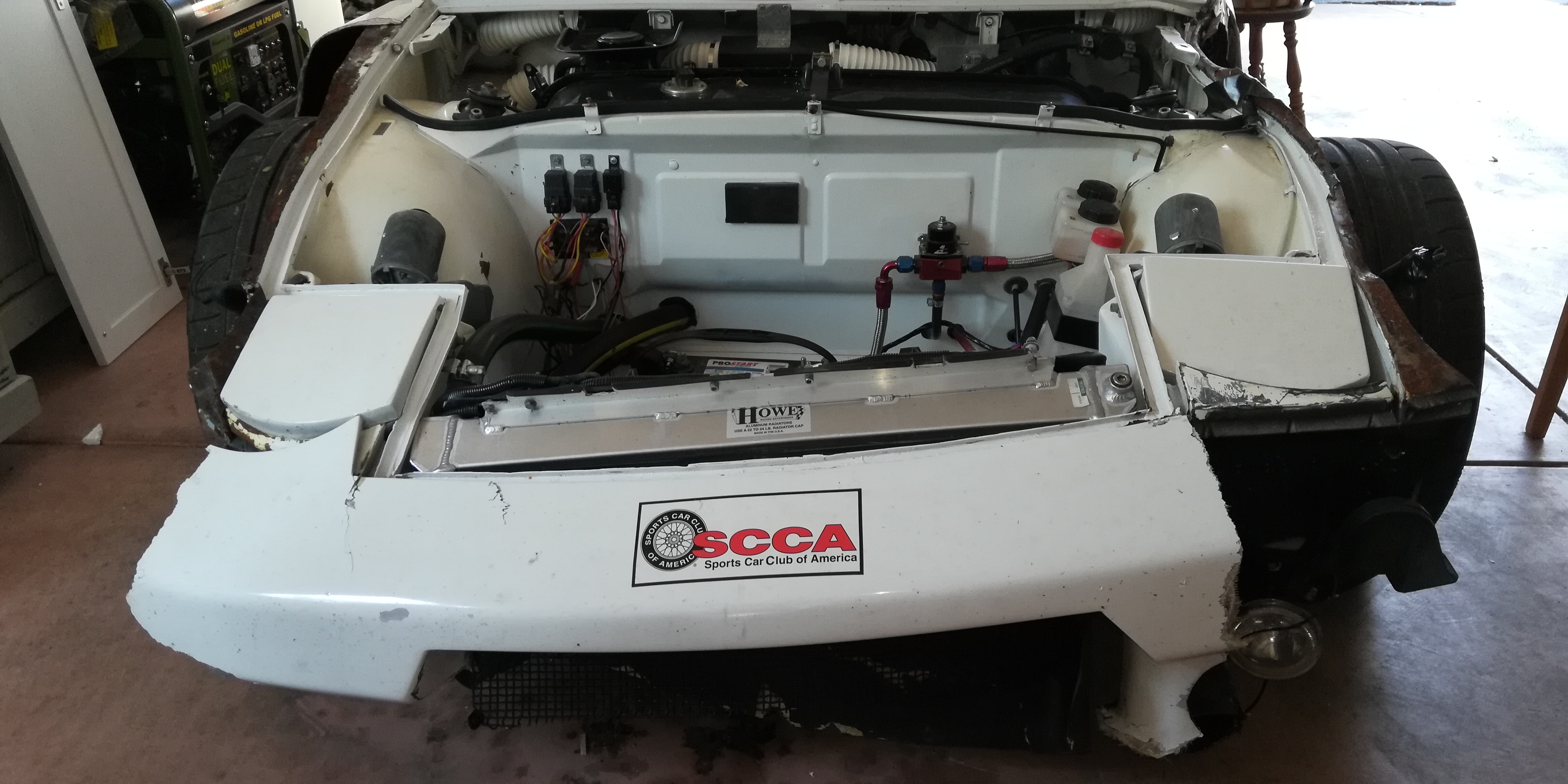

Well, I removed the torqued fiberglass front trunk lid and turned up the torsion bar on the drivers side which was completely backed off and suddenly it's not looking too bad. I think at this point it's actually driveable. Ok, maybe not very far... Yes, I'll need some sheet metal around the drivers A pillar that took a nice solid tree, and maybe some around the passenger headlight that got pushed down by another tree.
Big beefy brake calipers and rotors. Sway bar looks great, LCA are probably bent, but not much else underneath except for sheetmetal. I need to get it up on the rack to know for sure.

Good candidate for getting a portapower.
Do you have a stud gun? I have your slide hammer here.
Do you have some heavy duty trees you can pull around or maybe build some pyramid structures out of heavy duty steel and bolt to the ground for anchor points for pulling the chassis out?
Pieces you 100% need:
Front hood (Fiberglass)
Front end (Sheridan, Do you have this on order?)
930 control arms (Or possibly 914 control arms with 914 torsion bars? http://914world.com/bbs2/lofiversion/index.php?t162853.html )
Driver side A pillar section.
Drivers side headlight bucket

I would not use the lift. It was designed with the stresses setup to support a car up in the air. Putting side loads on it changes the direction of the stress, possibly weakening it for holding a car up. Personally, I wouldn't get under a car on a lift that had been used like that.
I have pulled cars out using trees before. When my nephew got hit in his Datsun 510 years ago, I pulled it out by strapping it between 2 very large Oak trees and using a come along to pull the B-pillar out. That and 2 new doors got it back on the road.
