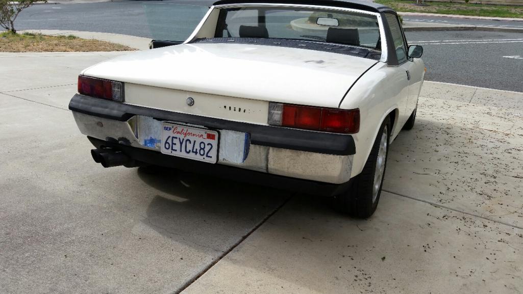

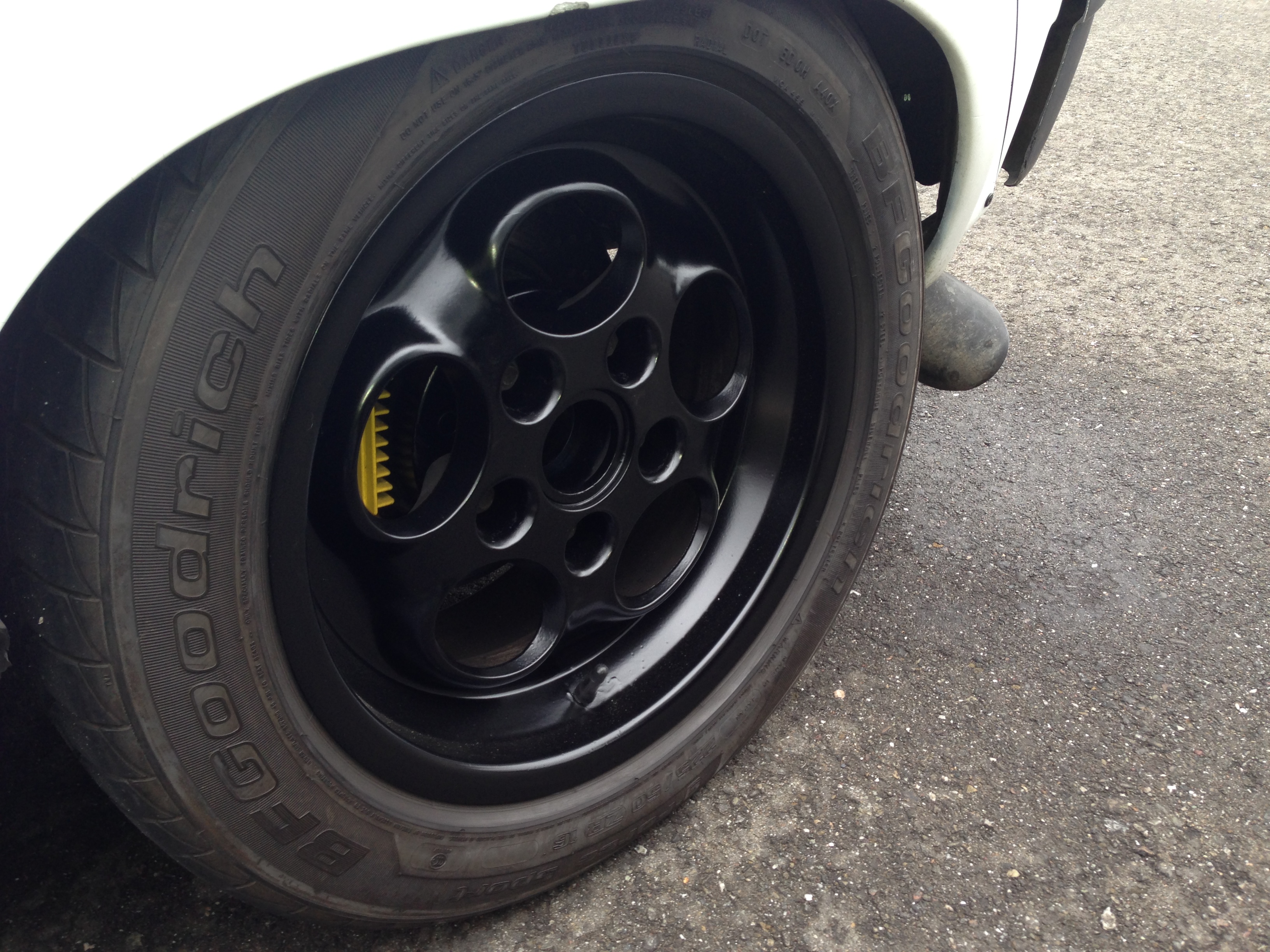

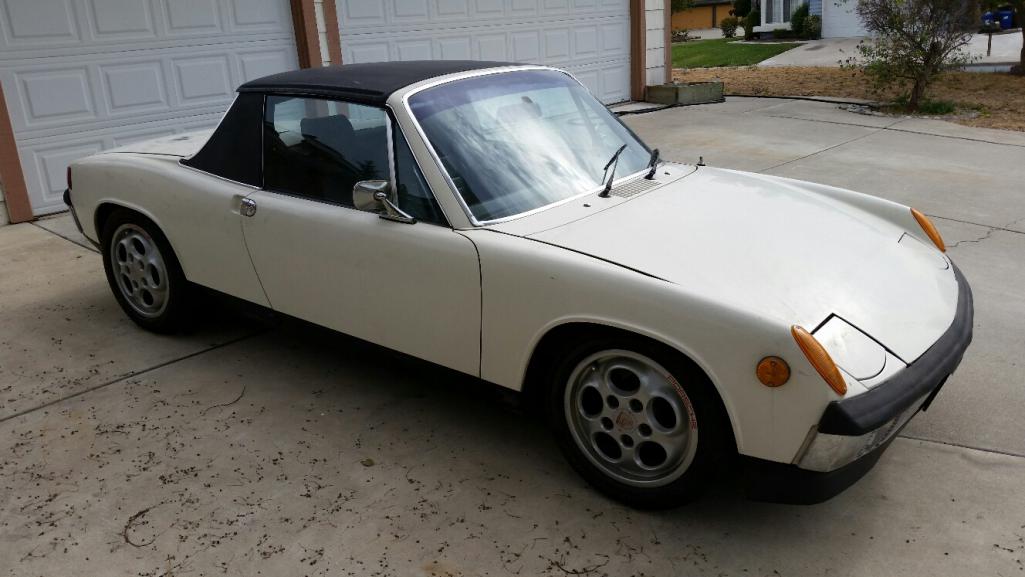

effutuo101
Here is a picture for you. James has newer pictures.

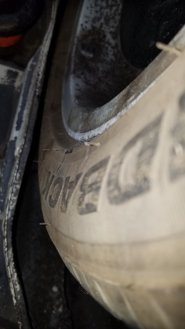

Mueller
Inside clearance....this is car sitting at normal ride height.
