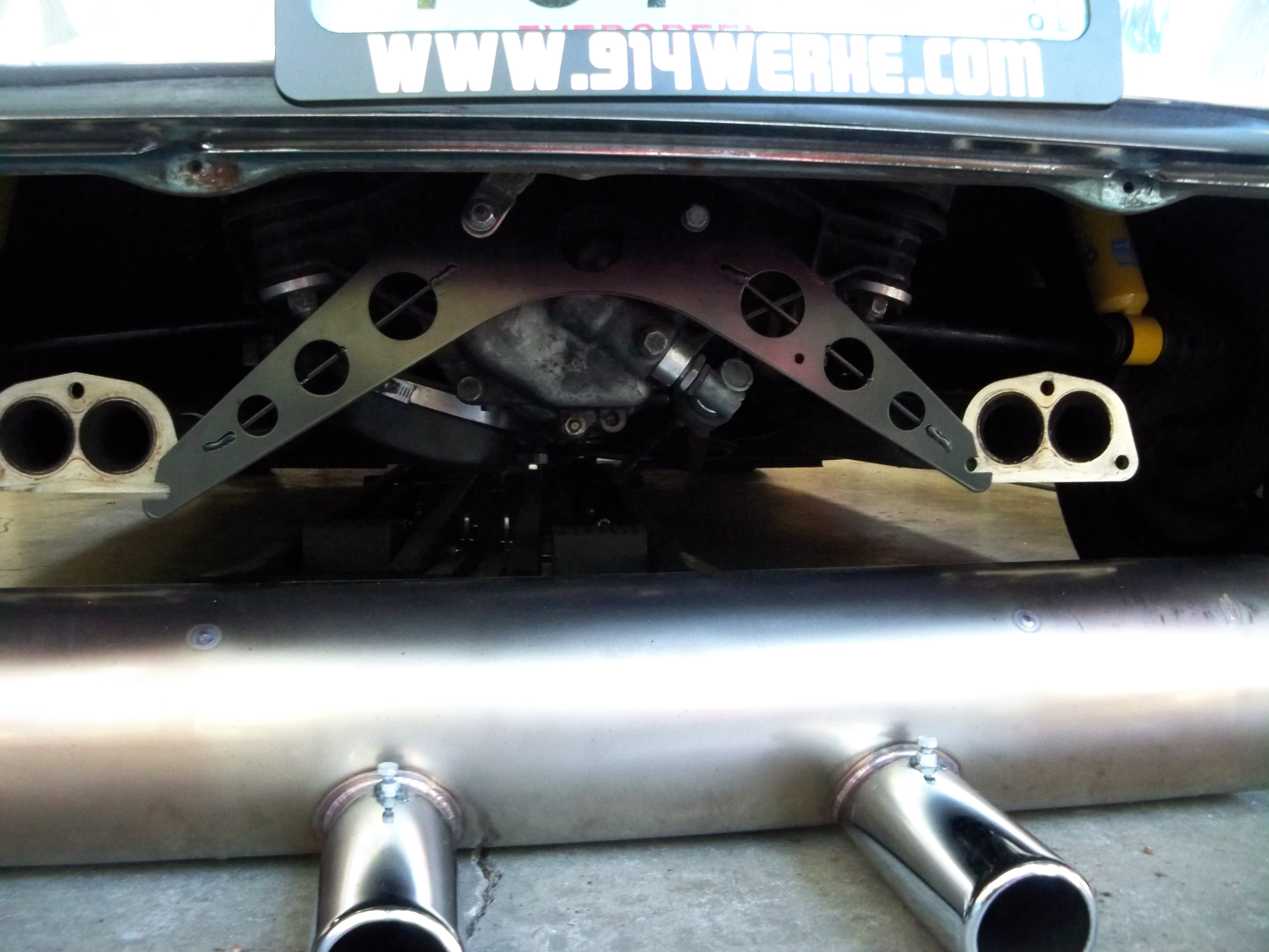

I've reproduced a favorite.
2.0L muffler hanger for the /4 & /6
The original was a bit flimsy & was prone to cracking so I increased the gauge steel used
Available on my web store
HERE That welded reinforcement across the cut-outs will force all thermal expansion movement into the area right by the tranny bolt mounts, where it will fatigue. OEM mounts were designed to permit flexing along the entire length
