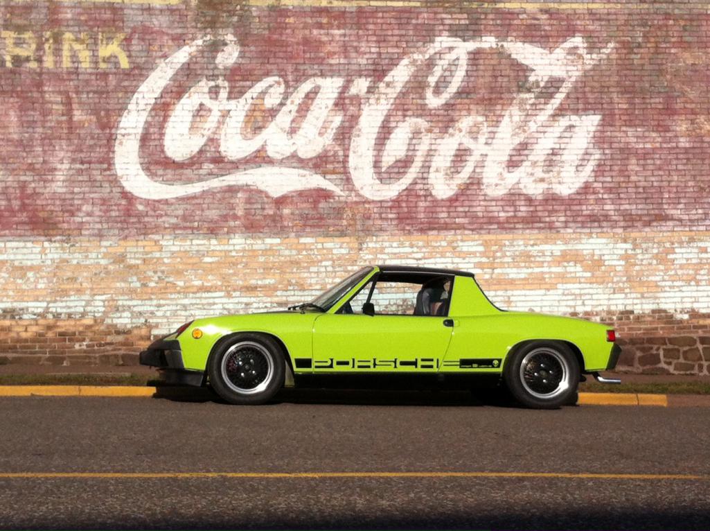

Pics of 7 by 17 inch wheels? On a car?
sixnotfour
sfrenck
Guess wheels in the sixnotfour pic are these HPD Rader Wheels ??
QUOTE(sixnotfour @ May 16 2019, 11:35 PM) *
dr914@autoatlanta.com
don't think so they look awfully tight, and could be five inch. The riviera wheels were always made for vw beetles that had the fender sticking out from the body of course. They always fit a 914 tightly towards the outside and one could never wear the widest tire, but of course at the time they were all shod with 165x15s which fit just fine

What are the odds the fenders have been rolled on that orange car? Better than 50/50?
yes these were the ones I was writing about, guy spent a lot of time developing these wheels for the 914 good job!

QUOTE(sixnotfour @ May 16 2019, 10:35 PM) *
Wow! Usually not a fan of 17" at all on a 914, from a visual stand point but that don't look half bad...what do they weigh?
You car looks great as a whole in that picture !! first.gif well done.

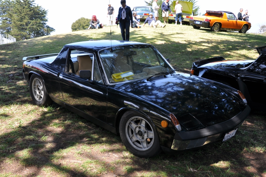

QUOTE(billh1963 @ May 17 2019, 07:56 AM) *
The ATS wheels are growing on me....
ATS Classics are my favorite 4-lug wheels ... I think I have two more sets here ... one set destined for the '71 914, and maybe I'll toss the other set on the Ghia idea.gif
