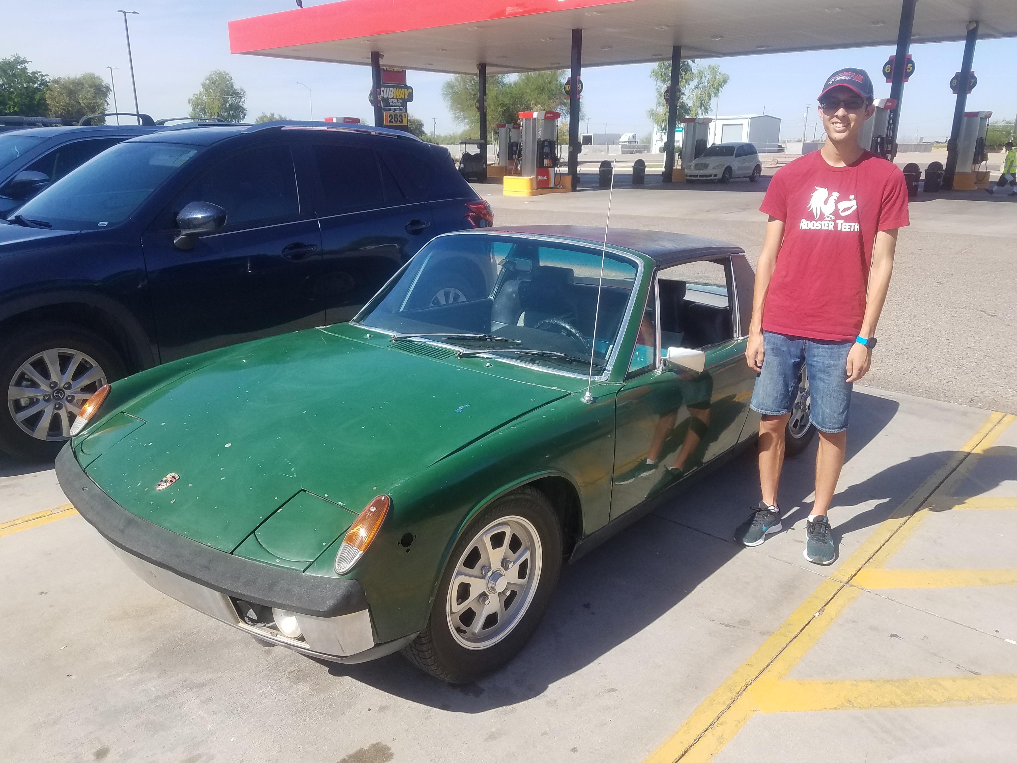

Picked up the new nine-fort-green. Drove to Tucson early this morning, picked it up and drove it back to Phoenix. It got a bit warm in the cockpit with the top off around 11:00 am Phoenix time.

Home sweet home.
AZBanks
Aug 17 2019, 04:19 PM
It is a good 40 footer. The person who painted it was blind and painted it with a garden hose from 40 feet.
I took a buffing wheel to is to remove the worst of the oxidation. It looks better in some places and revealed more problems in others.
Something spilled on the rear deck lid at some point and stained/etched into the paint.
Oh well, it is a daily driver for now.
