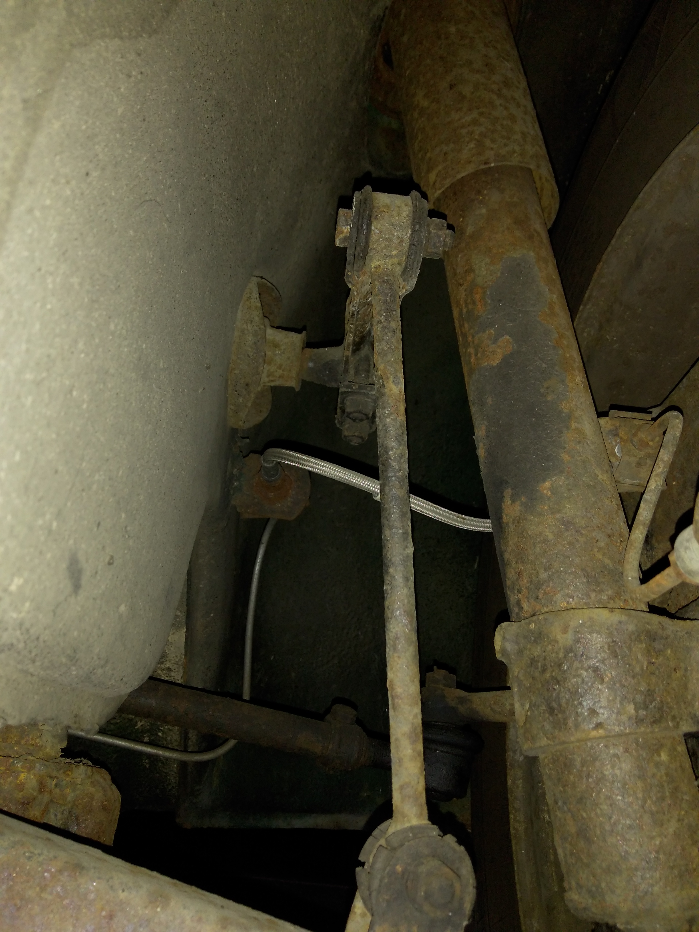

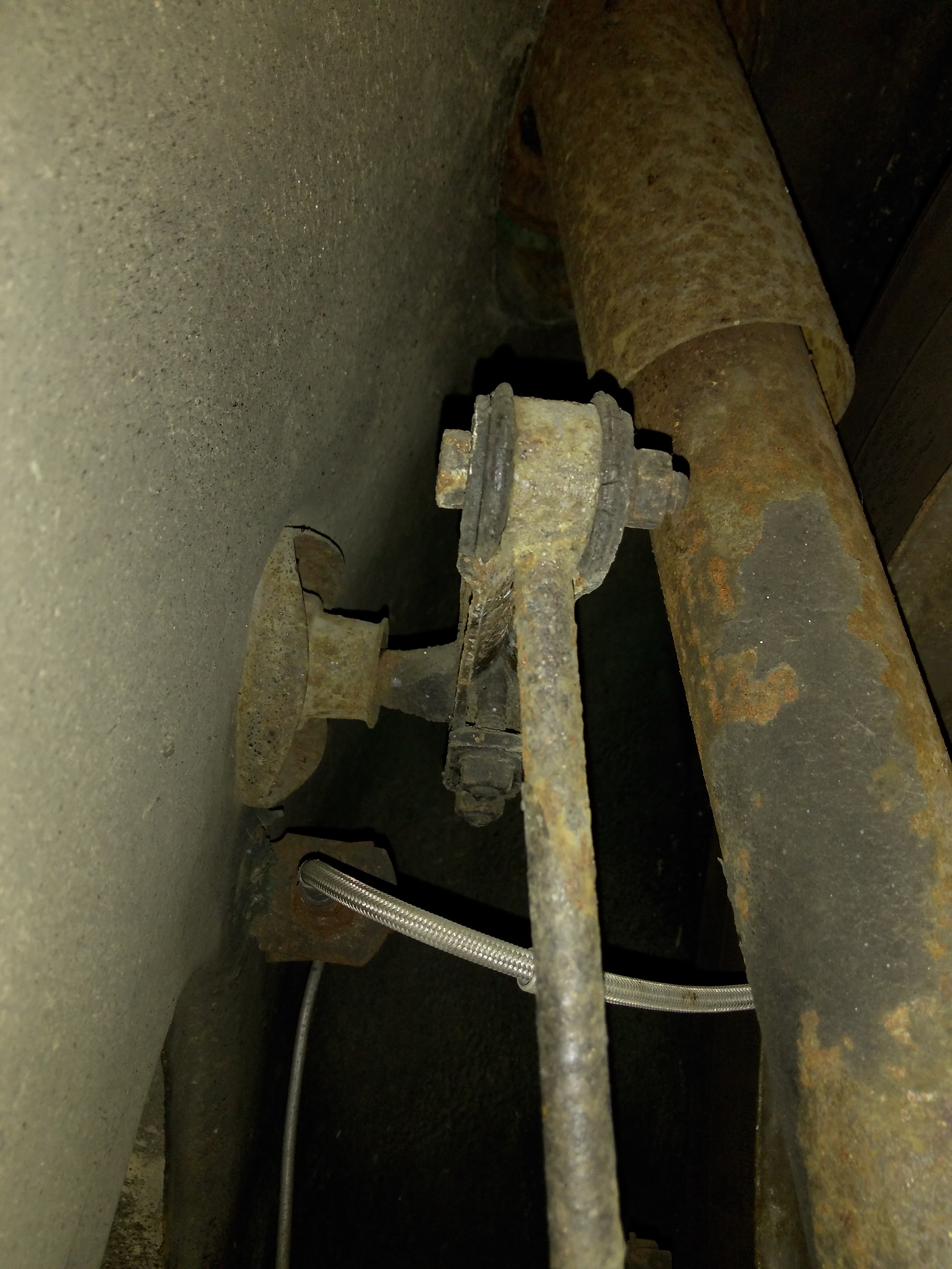

QUOTE(mtndawg @ Nov 5 2019, 06:11 PM)
Pics needed
If you were asking me, here you go. I can pull the tire and get better ones this weekend if needed. I know I didn't add it and I've had the car since 1977. There was nothing done to the car that I could tell when I bought it except the muffler had been replaced with the dual muffler Monza style. (and the rear valence discarded....)
Click to view attachment Click to view attachment
ClayPerrine
Nov 8 2019, 07:18 AM
QUOTE(fixer34 @ Nov 7 2019, 07:28 PM)
Pics needed
Click to view attachment Click to view attachmentProbably installed by a previous owner, like our six. I disconnected it because the hole on the left side is torn out. It will be restored to no sway bar when the body work is done.
