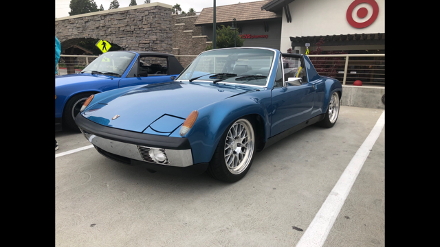

Driveline wise, the stock 3.2 with all of its Motronics cannot be beat. I would drive mine anywhere. Your metric though, might be a little unrealistic. After 500 miles in my 5 Series X Drive BMW I would feel beaten up from sitting. I’m sure a stock 3.6 aircooled would be just as reliable.
For true daily driver status, heat exchangers are a plus. I put seat heaters in and it doesn’t quite measure.
I have zero rubber in my suspension, but the ride is pretty darn good with the Elephant Bushings.
I would never daily drive it, but I could...
And she looks so darn good!

cali914
QUOTE(Steve @ Dec 3 2019, 06:10 AM) *
QUOTE(horizontally-opposed @ Dec 2 2019, 01:53 PM) *
Civilized 914 3.2? I like your thinking—it's different, and cool.
My recipe would be:
1975 914 1.8 or 2.0 w/big bumpers and all the updates
3.2 w/Motronic
915/916 gearbox
Keep 914-4 sound-deadening
Consider double-pane rear window
Ben's heater boxes + quiet muffler
Mild suspension with Koni reds
PMB or 986 brakes
16x6-inch Fuchs w/205/55R16 Michelin Pilot Sport All-Season 3 tires
Air-conditioning (electric? as used by Emory Motorsports)
Rear oil cooler or custom loop coolers to both front fenders
Stock seats with grippy cloth
Power windows that use the stock window winders as "switches"
930/Carrera-style carpeting of some sort
This is pretty much my build minus the electric stuff, double rear window and big bumpers. Bens heat exchangers give awesome heat for cold mornings and the quiet muffler makes conversations easy in the cabin and make the drive more relaxing. My Martin Bott 916 1986 transmission gearing matches my 3.2 euro 3.2 motor and makes driving much more relaxing. 1st gear is actually useable and you shift less often. The steve Wong chip really opens up the 3.2 motor and makes the motor more smoother. Next on my list is electric AC. I have all the parts, but no time to install it.
The combination of the color and your rims makes your car look really sexy.
