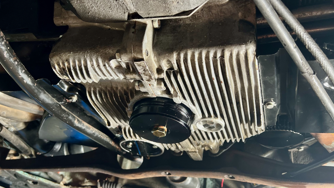

Here is a solution for oil starvation when driving your 914/4 in the manner it was designed!!
Highly recommended for ANY 914, street or tracked.
Simple install.

Its a common concern but in reality the sump once installed is no lower than the engine mount bar. If you are dragging the sump on anything, there is something else going on ~
Its purpose it to MAINTAIN oil pressure.
The 914 was designed to be capable of navigating curvy roads at high rates of speed and (with the right tires) + G-force's.
The result of which is to cause the oil in the bottom of the engine to slosh away from the pickup. By extending the PU into a small oil reservoir at the lowest point of the engine, that should never occur.

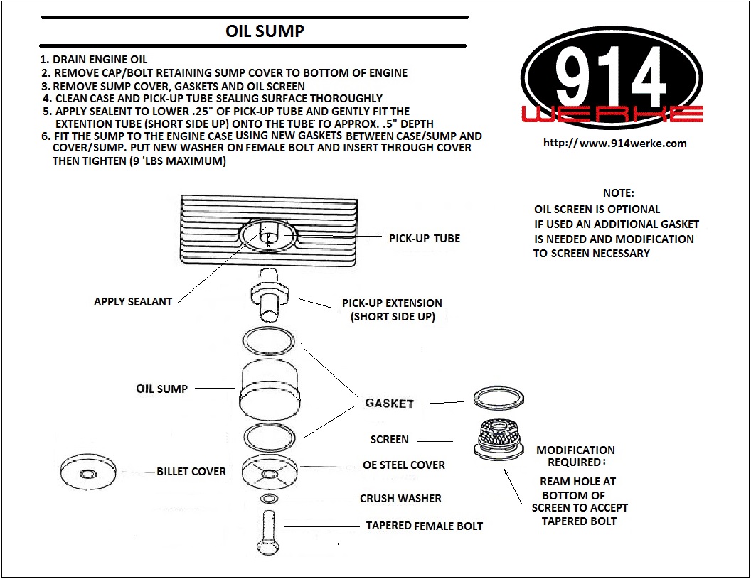

No extra gaskets or special prep is necessary unless you plan on running it with the screen. smile.gif

You will receive a copy with the order but I also have it posted on the downloads section

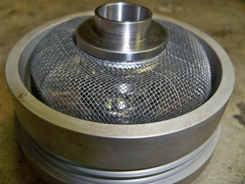

@914werke Getting ready to install but had a couple questions:
1. Is there any added benefit to running the screen with the extend sump?
2. If the screen is used can I use an RTV to connect or should it be tack welded or soldered instead?
914werke
Given that the screen will only stop rather large pieces of debris, the reality is at that point you recognize its catching stuff,
My belief is the screen is a hold over from the T1 design w/o a spin on filter.
So no its not necessary.
But.. if you want you use it, its not that hard.
1st - you need a third sealing ring to sandwich the screen flange between the sump mating surface & the cover.
2nd - you need to ream the hole in the thin alum. on the bottom of the screen that is only as large as the M6(?) sump stud, to a hole that will fit the female securing stud .. snugly. Go slow & work up to your fit. If you just hit it with a drill bit you may not like the results BTDT.
Last - I also used a file & opened up the slots on the base to allow a bit more flow, no real evidence that it is necessary it just made me feel better.

Thanks. What "sealant" should be used, as noted in your printed instructions, to connect the extender collar?
FlacaProductions
Permatex Motoseal 1 or Honda/Yamabond - same stuff, I believe.
Remember - the oil sump plate is 9 ft/lbs which is 108 inch/lbs...not a pound more.

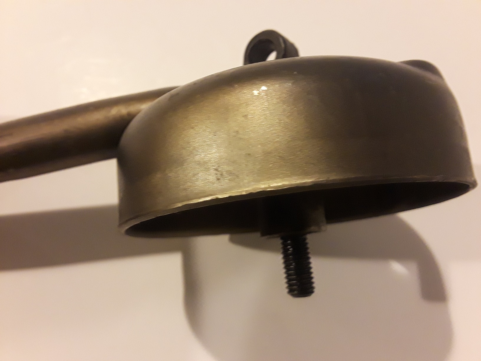

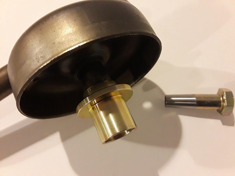

So a few folks have asked for more detailed instructions than the one page install sheet provided. biggrin.gif
Rather than create the next War & Peace I figure a few photo's cant hurt happy11.gif
Below is the actual sump removed from the case (not necessary for installation)
This way you will more clearly see the Pick-up tube, which is extended with a piece in the kit.
The issue is that that tube is a stamped part that can need a bit of love to allow the fit of the extension.
Ive found that the application of some slight filing or sanding at the bottom mil or two of that tube will allow the tight fit necessary.

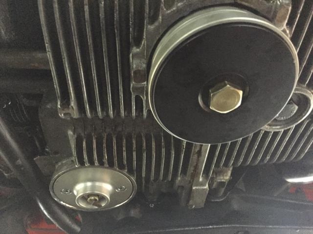

It's a nice piece, Rich - finally got mine on. Not a drop. Click to view attachment
914werke
