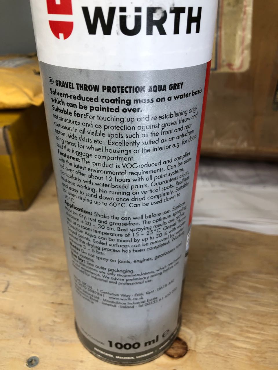

Here is the stuff you want. I have a few cans left over from my build if you are interested. PM me and let me know.

QUOTE(Cairo94507 @ Jan 4 2020, 09:40 AM) *
That is great for undercoating but I think OP was looking for actual seam sealer to be used after weld repairs.

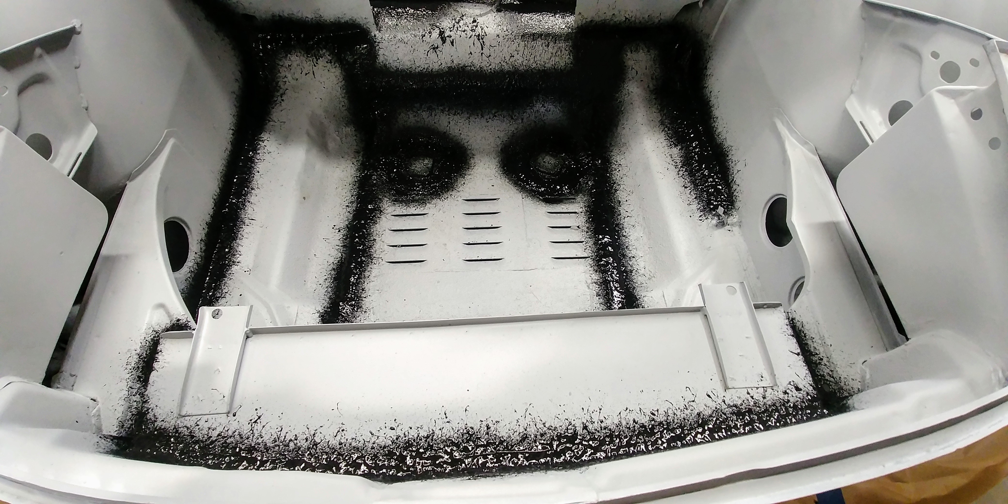

For seam sealer I used bed liner in a shutz gun to get this.. I used Monstaliner , upol/ raptor, and herculiner.. Monstaliners are by far the best product hands down.. Click to view attachment
