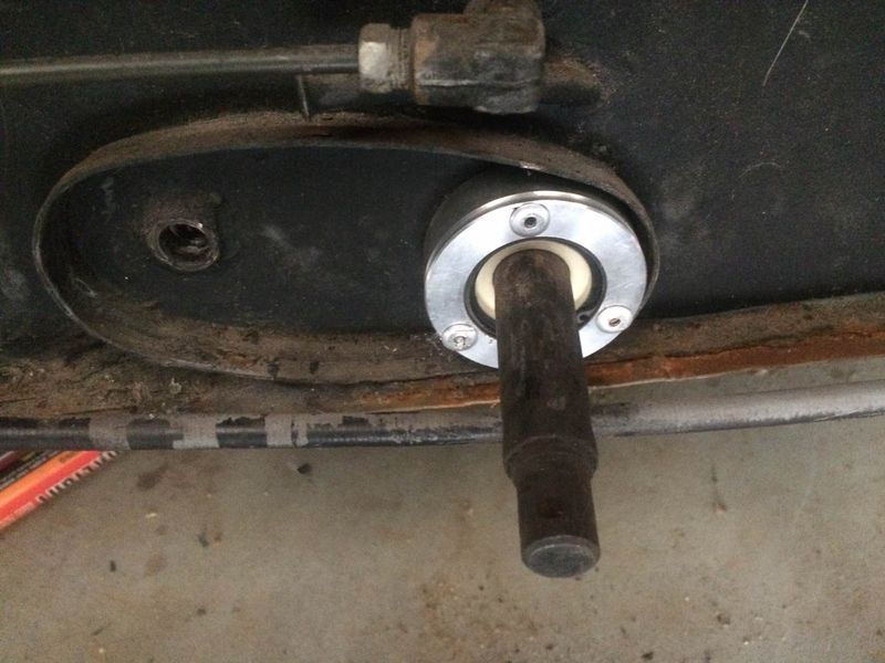

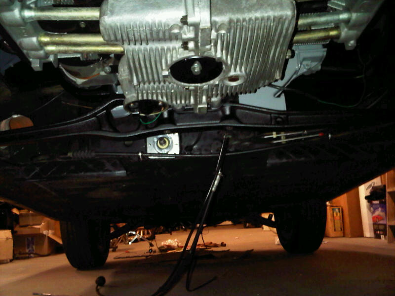

Dr. Phil, since you will be replacing the coupler bushing, you might want to replace or add the improved firewall bushing like this.
edited:
@DrPhil914 this one I installed for a friend and member here also.

Who makes this one?
Rob
DRPHIL914
Is that one Chris Foley’s or Rixx914parts?
GregAmy
Tangerine Racing (Chris Foley). Installs in minutes.
http://www.tangerineracing.com/transmission.htm

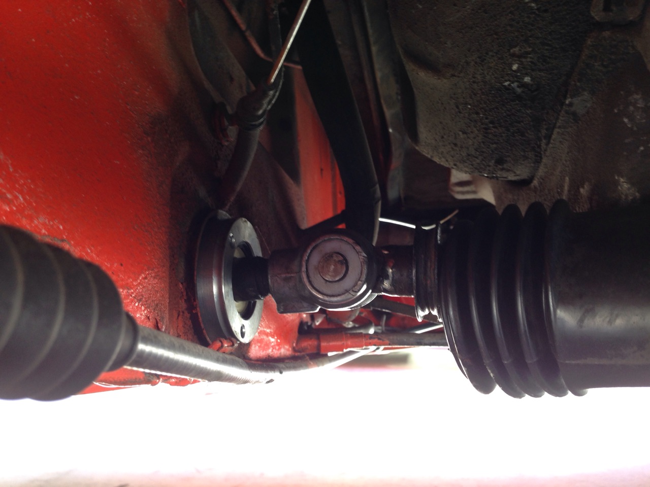

If you really want a nice shifter, get his whole kit, which replaces that goofy plastic thing with a full U-joint. I have it on the race car and it's choice.
http://www.tangerineracing.com/shiftlinkage.htm
euro911
I installed one of Chris' spherical bushings on my '75 (the 'BB') and it really improved the shifting (along with bronze coupler bushings and a bronze shift console bushing).
Due to special circumstances, I had to modify the bushing's housing a tad to inset it into the firewall, as I was unable to engage all gears, and didn't want to go through the process to move the motor and trans rearward.
YMMV ... in normal instances, you should be able to bolt (or rivet) it to your firewall without modifications ... especially on a late model's firewall.

I would use a steering shaft U-joint, and figure out the spline on the shift rod. Tangerine's kit makes a huge difference.
I don't even want to know what I have invested in the ability to shift gears with out feeling like I am rowing a boat.

QUOTE(914forme @ Jan 11 2020, 02:57 PM) *
The original JWest kit used two U-joints. With a Rennshifter, it feels like a bolt action rifle.

Jwest used a splined stub that once welded onto the shift rod, fits into the steering u joint. It does require a bit of cutting and welding.
