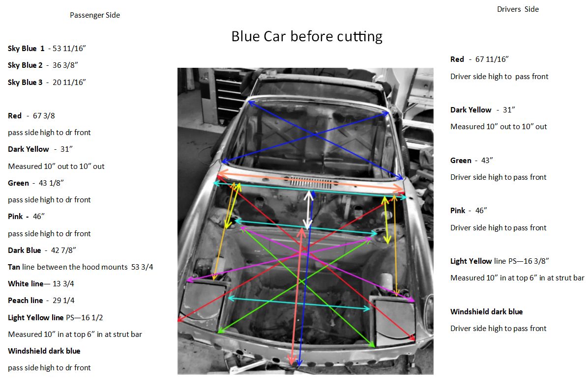

Here's a measurements teaser. You'll see I went overboard, this is just the top side.
