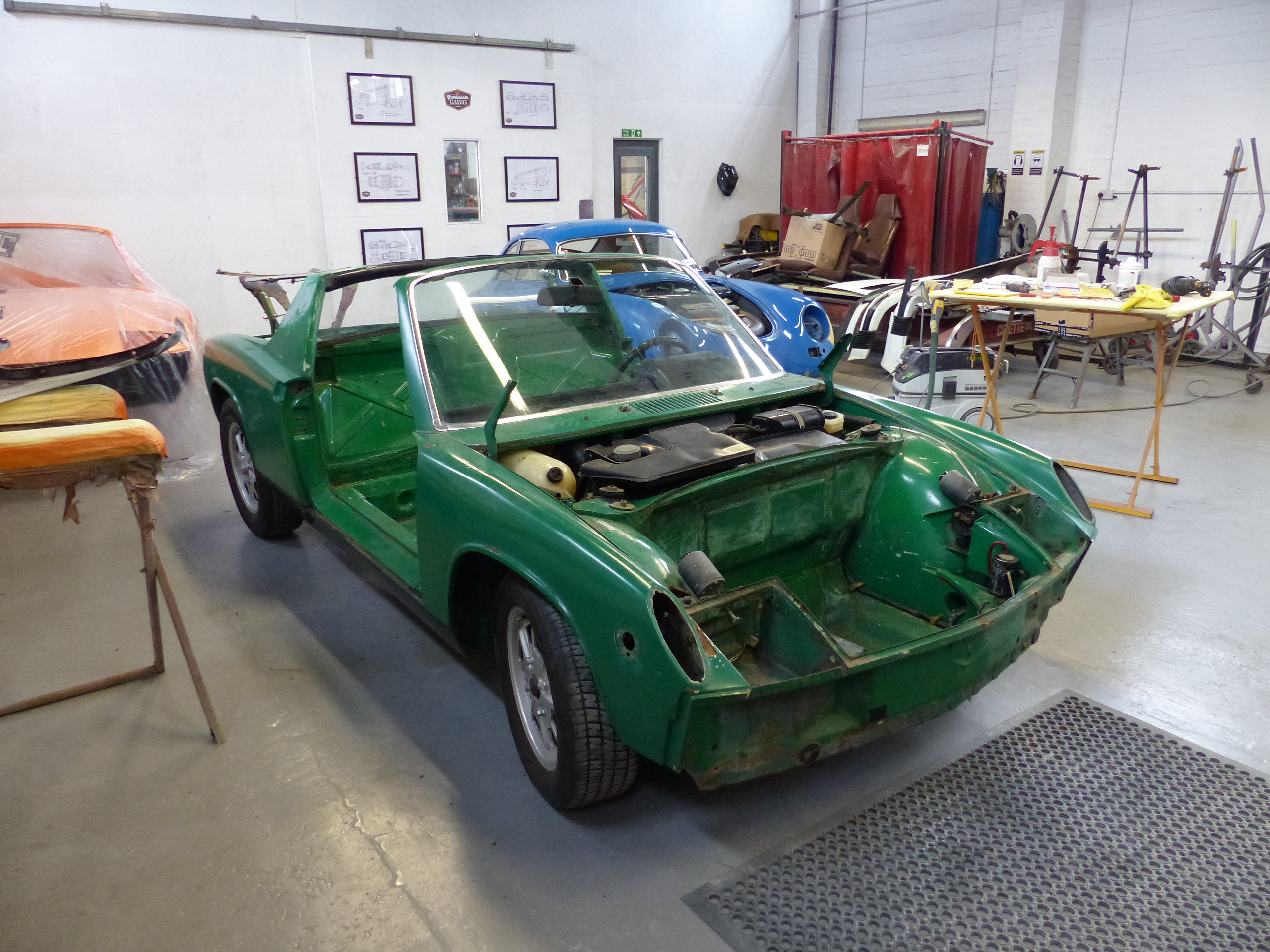

I'm currently a final year university student, and for my dissertation I chose to model my project on the "Critical Evaluation of the Performance of a Porsche 914 Engine, proposing improvements based on more modern materials and technology."
And lucky for me, it's been done parallel to the actual vehicle restoration!
My Dad purchased the 1974 914 2.0L from California in auction, (he won't tell me for how much because I'm sure my Mum would go mental...LOL).
So the idea of my dissertation is to run simulations for the original engine specs, looking at vehicle performance, emissions and fuel economy, and seeing, based on the improvements I want to make, how much of a difference there is, and finally creating a series of engine maps including race, eco and sport maps.
There is no doubt that all three of my objectives will have increased dramatically compared to the original specs, especially since modern technology has had a large focus on reducing all engine pollutants for the sake of global warming.
I'm currently looking at switching to a distributorless system, whilst keeping it all in the original distributor package, and installing an adjustable crank sensor which I need for the mapping.
I'd appreciate any advice going forward!

What EFI ECU do you plan to use ?
The T4 isn't the most green friendly engine due to it being aircooled, you always should be running at 3000 rpm for the cooling fan. Plus it's based on 80-90 year old technology.
For pollution control there's high flow cats (catalytic converters) that weren't available when the car was built, but you'd then need a welding course and design an exhaust system.
This would definitely tie into the EFI system.
Another 914 issue for anyone with headers is heat.
For less than 200 quid you can get an efficient diesel heater kit on ebay, the big question is how to mount it and get it into the cabin with the least mods to the body? There's a thread here on a historic 914/8 that gives clue to how Porsche did it 50 years ago.
