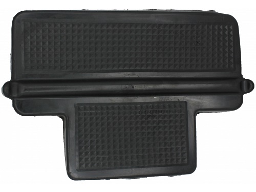

UROpartsman
This is the first-generation Battery Cover, which was attached with a large black square-profile rubber band (p/n 010 409 549B, still available last we checked). The covers helped prevent rain or wash water from getting inside the open-cell batteries (overfilling resulted in battery acid running into the the hell hole), and are quite desirable for proper restorations of pre-75 cars.

yes a black rubber bank, round in profile. Believe it or not a factory original part
http://www.autoatlanta.com/Porsche-914-Bat...010409549B.html

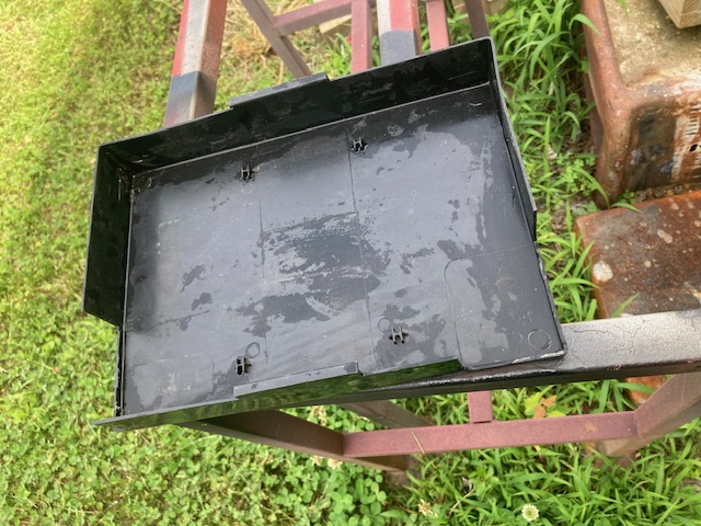

1 211 915 411 c This cover came with my 74 1.8. I don't know if it is original or from something else
Click to view attachmentClick to view attachment

I have one of these, it snaps on. simple. AFAIK it came from George
JeffBowlsby
Thats the factory HO recall campaign battery cover. Snaps on, no rubber band needed like the early version.

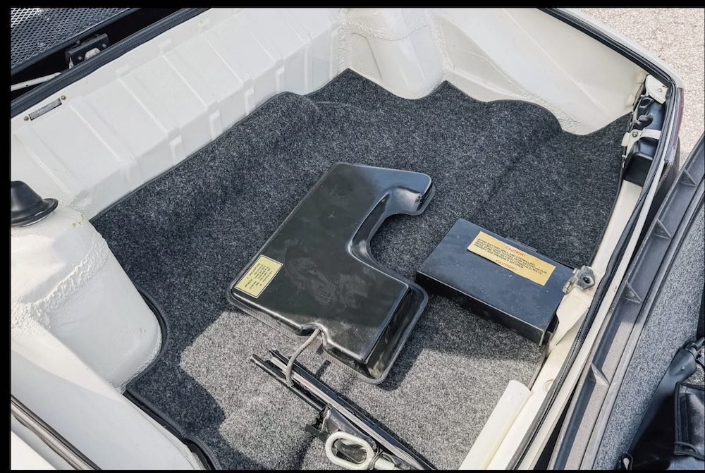

@Artfrombama
@JeffBowlsby would know.
here is also one from a very original 1.8 sold recently on BAT.
lying around in trunk of car in the photos.
same as yours and has the recall sticker on it as well.
my reading of the part number you quote is
211 in it means its a type 2 part i believe. originally was meant for a bus (kombi).
the 411 numbers at end are used right through 70s and 80s for various battery covers in various model VWs.
im guessing the original battery cover part listed in PET (the smaller one) was superceded with the bus one and the bus one probably got developed a little later than during 914 production run.
its a real deal thats for sure.

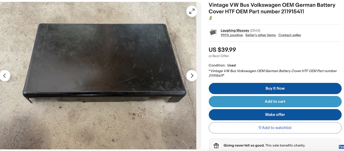

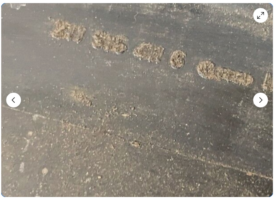

wonkipop
here you go @Artfrombama and @JeffBowlsby
Porsche/Audi were handing out VW bus battery covers in that later recall.
looks like this one is either a C same as they handed out for 914s or its a G variant.
a bit later. photo not quite legible.

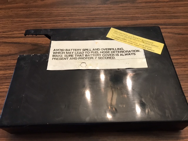

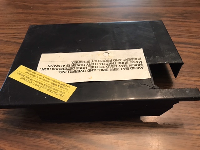

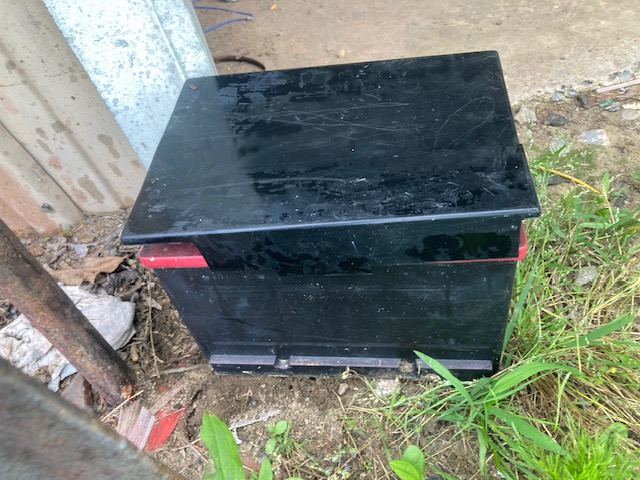

StarBear
Here’s mine. Original recall cover. A bit hacked to fit ground terminal.
Took me a few days to find it in my stash.
