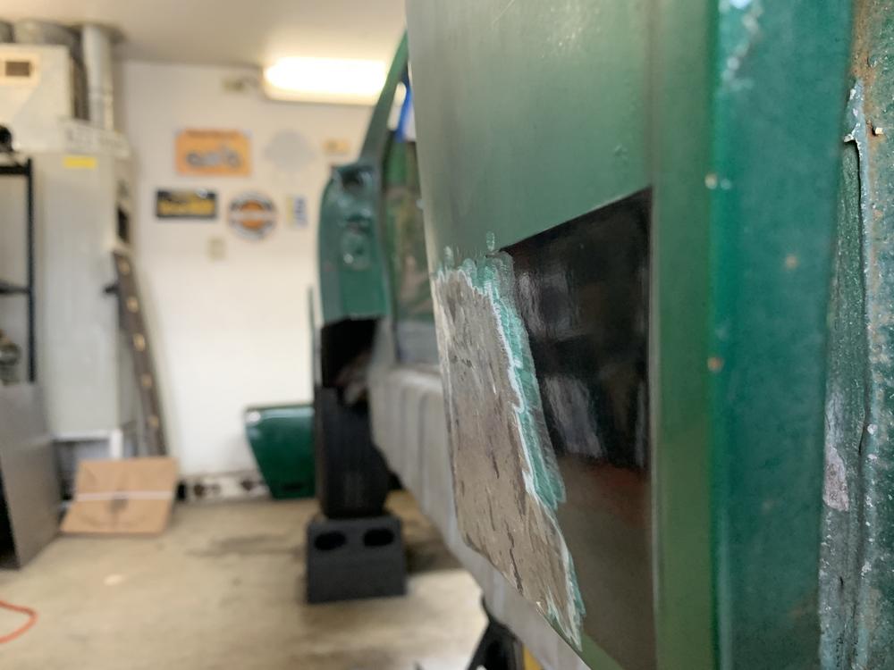

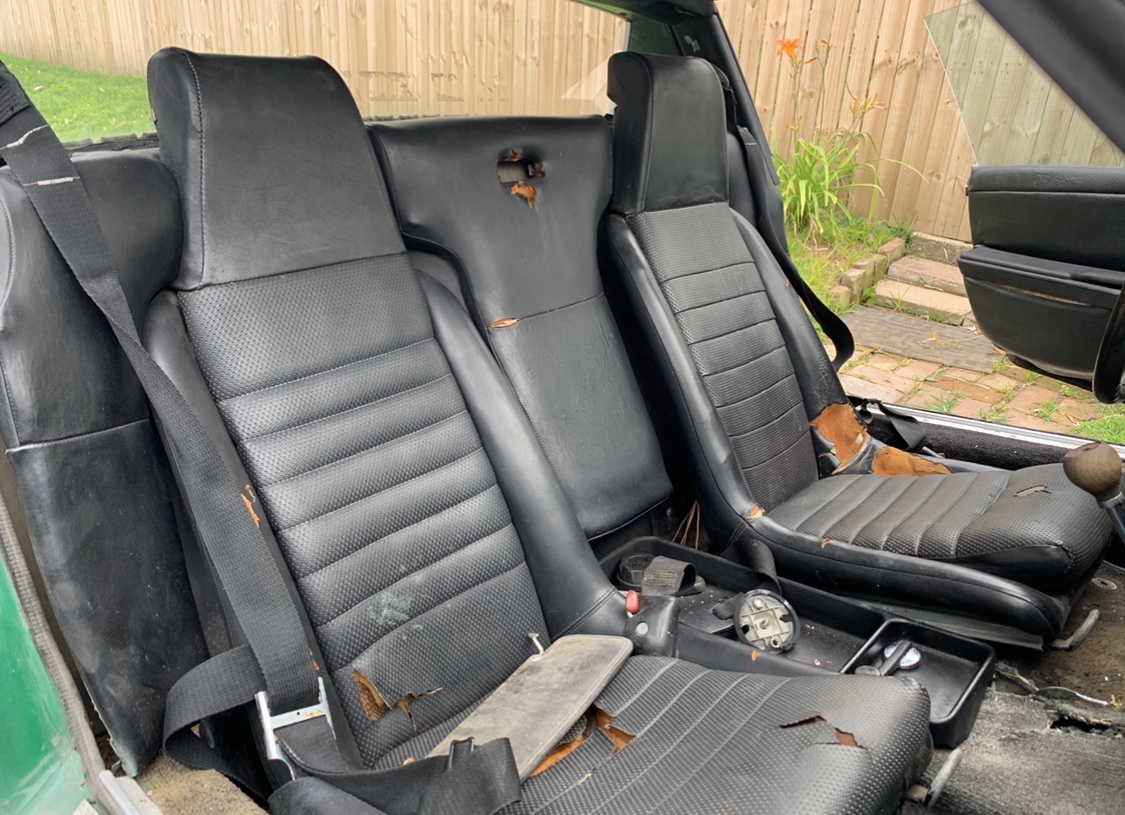

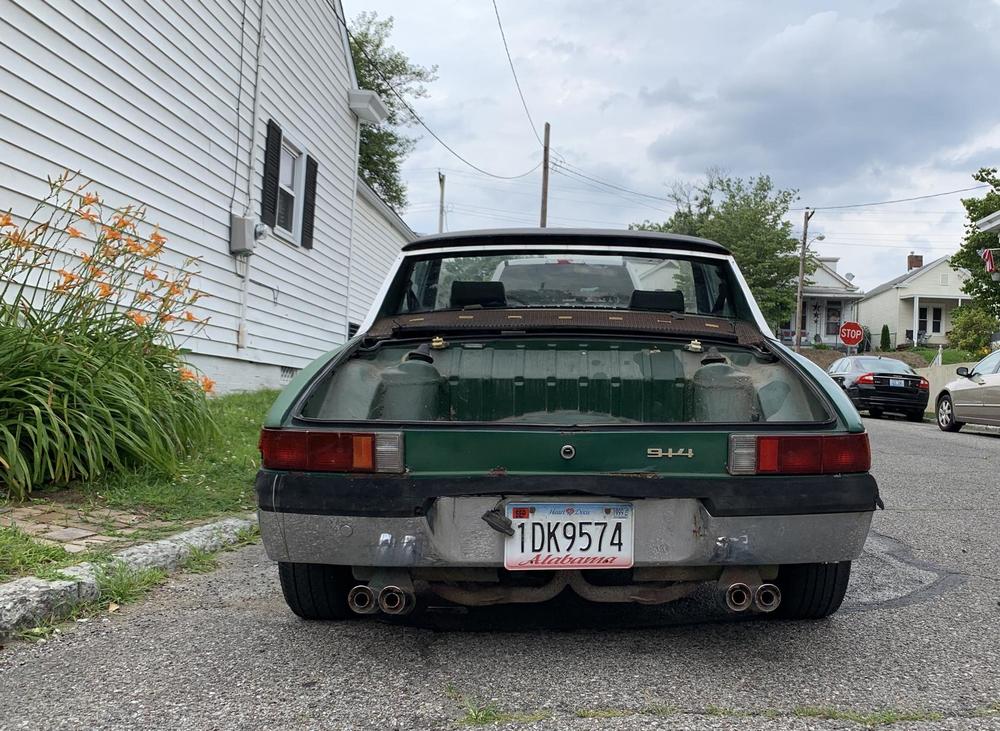

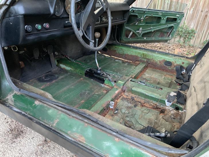

The car as I found it:
IPB Image
IPB Image
IPB Image
IPB Image

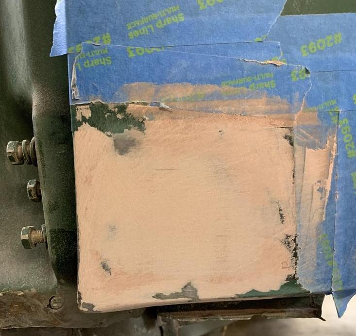

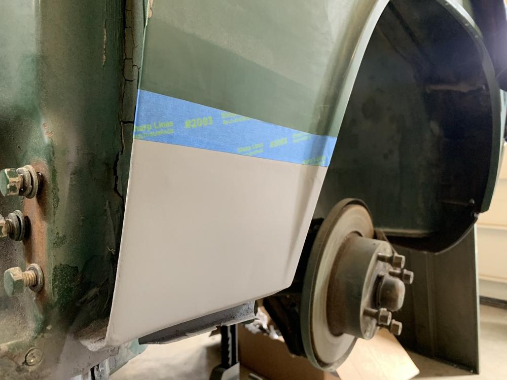

Quick Buff:
IPB Image
IPB Image
IPB Image
IPB Image
IPB Image

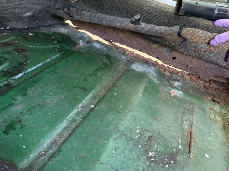

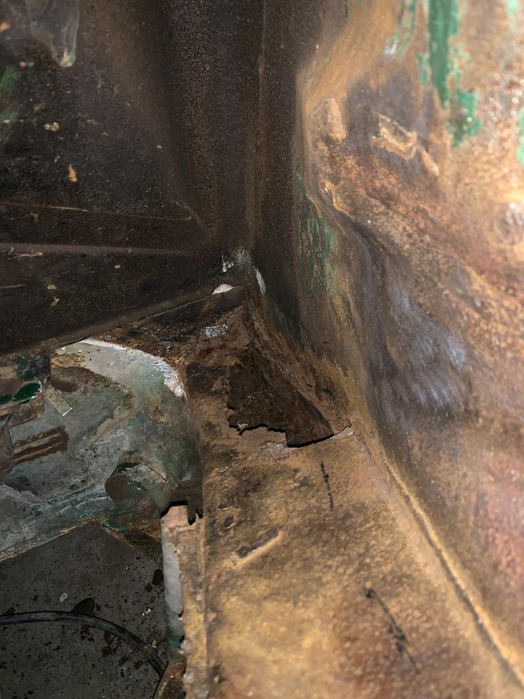

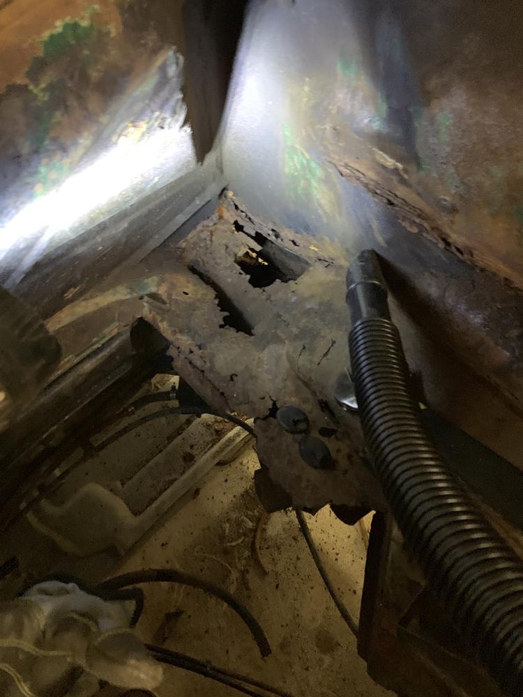

jaredmcginness

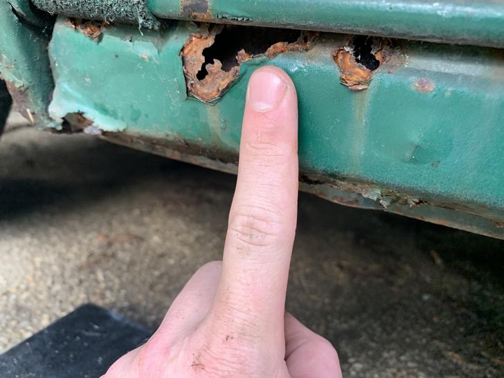

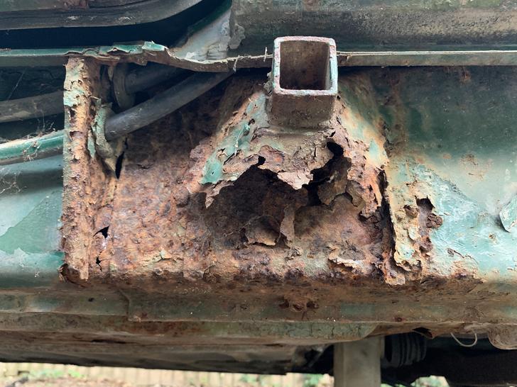

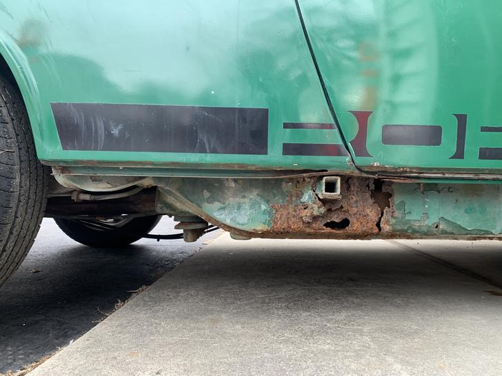

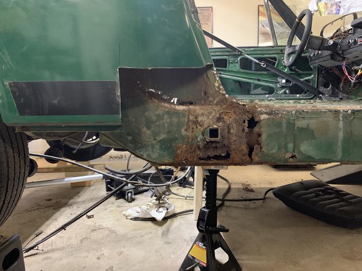

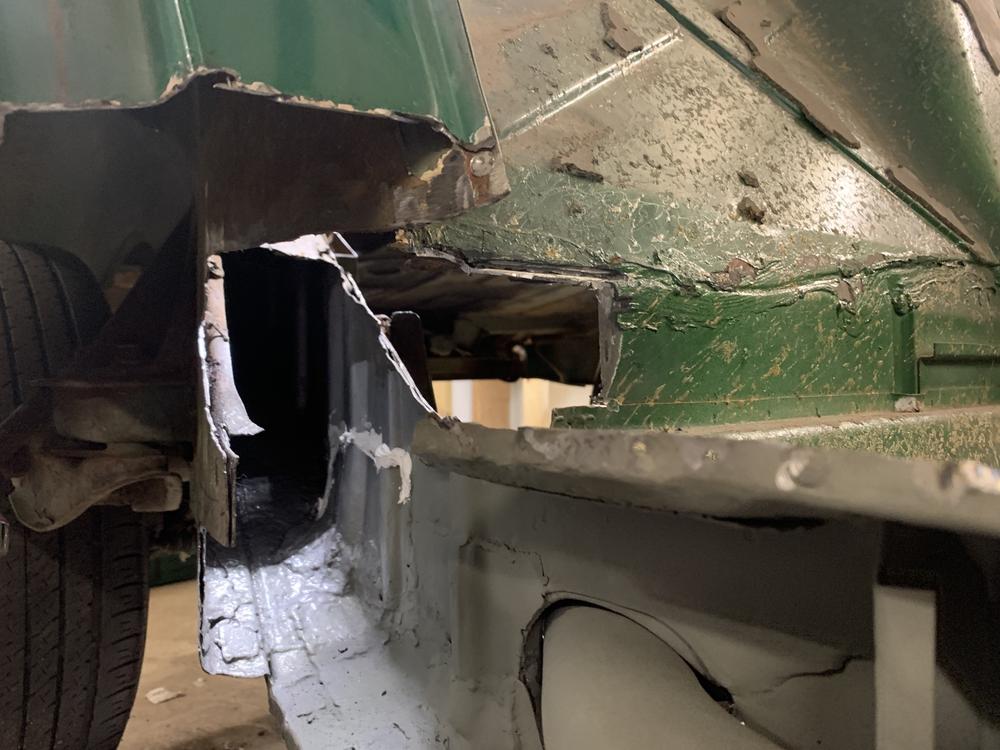

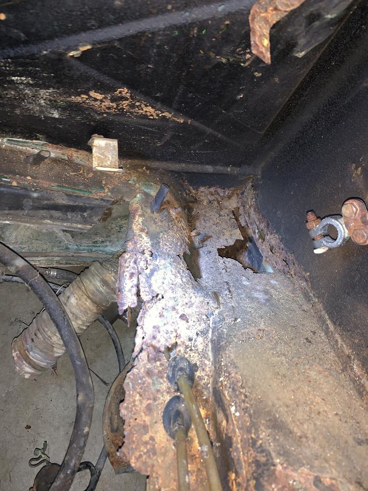

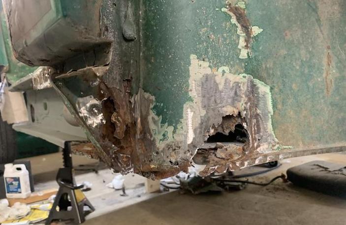

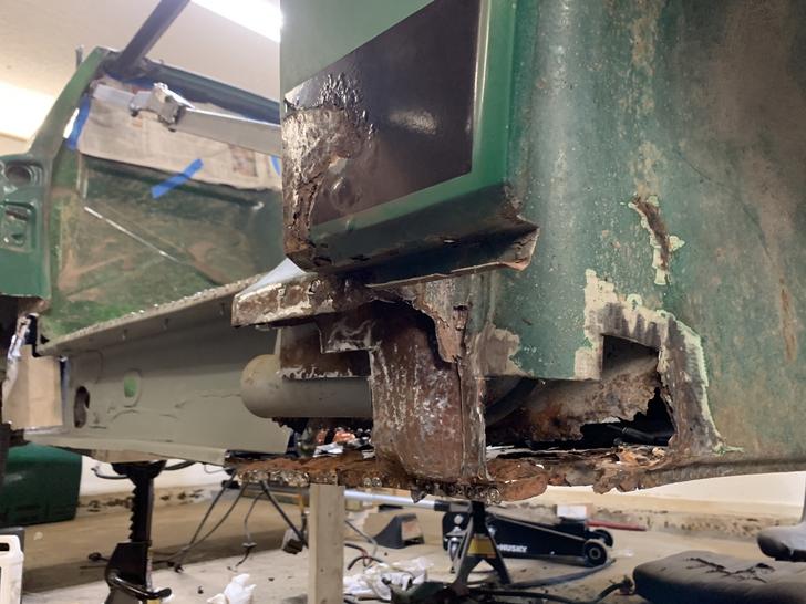

As requested, as for the ugly...
IPB Image
IPB Image
IPB Image
IPB Image
IPB Image
IPB Image

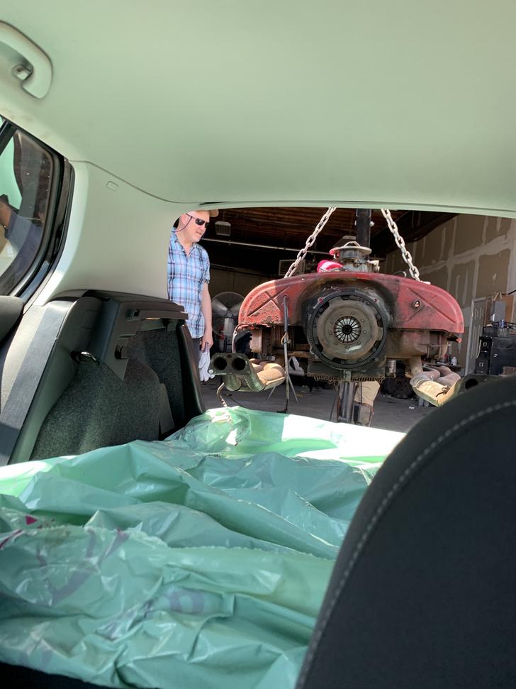

My dad and I picked up a running 1.7 for next to nothing. Will get me on the road faster..
IPB Image
Pulled the old motor:

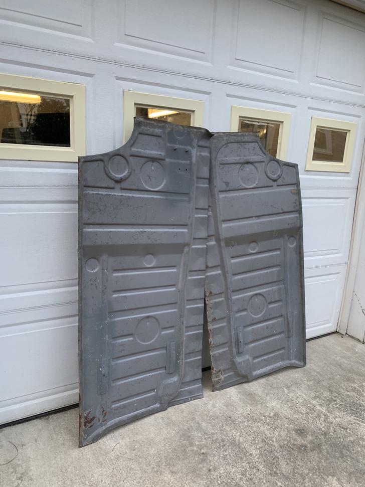

Got a steal on some new floors - $200 for the pair original parts:
IPB Image
IPB Image

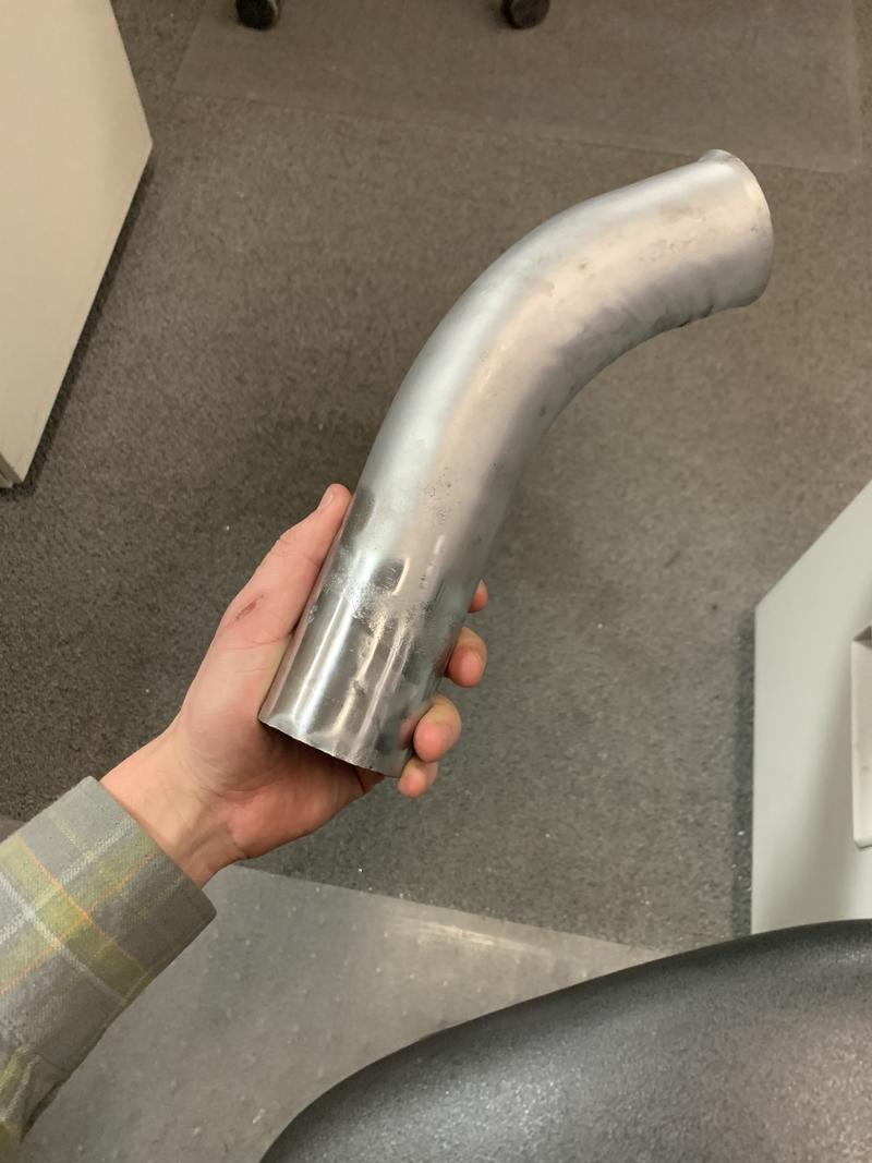

Sandblasted the J pipe:
IPB Image
IPB Image
IPB Image

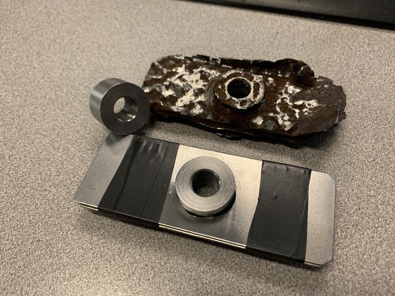

Made some seatbelt bungs on the lathe at work:
IPB Image

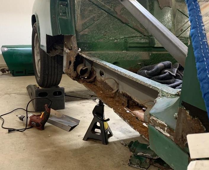

Got the inner long in good order. I used silver POR15 in the inner wheel house:
IPB Image
IPB Image
IPB Image

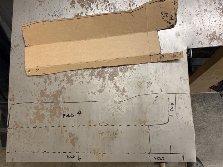

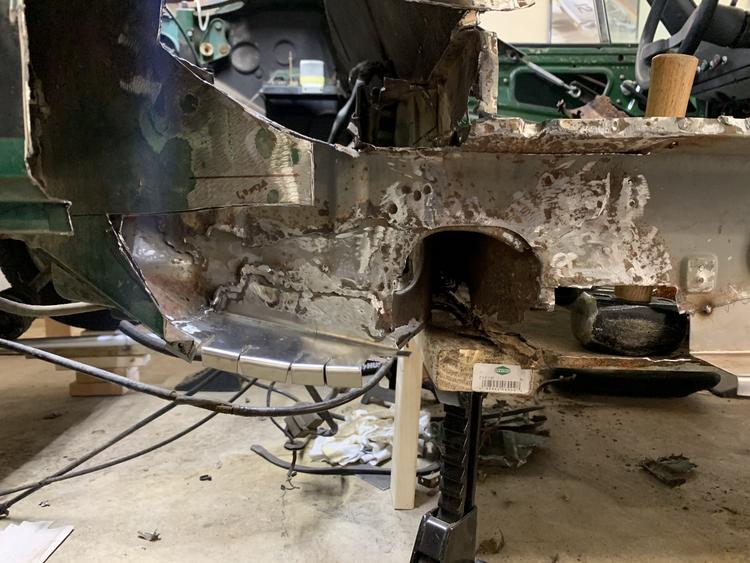

jaredmcginness

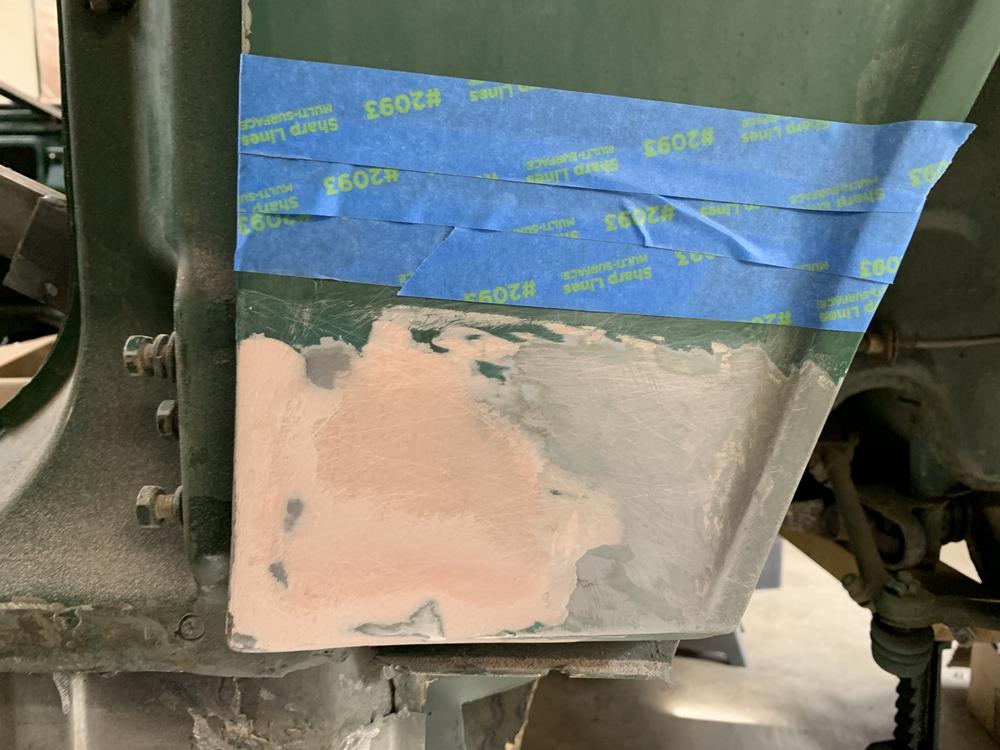

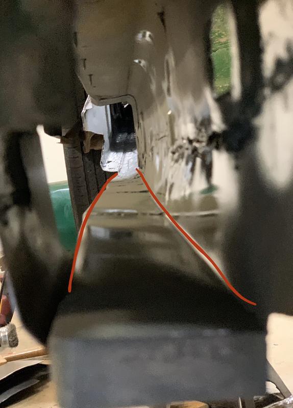

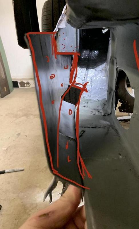

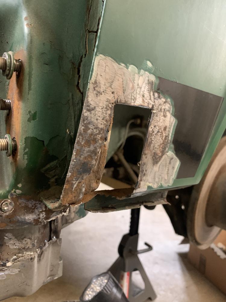

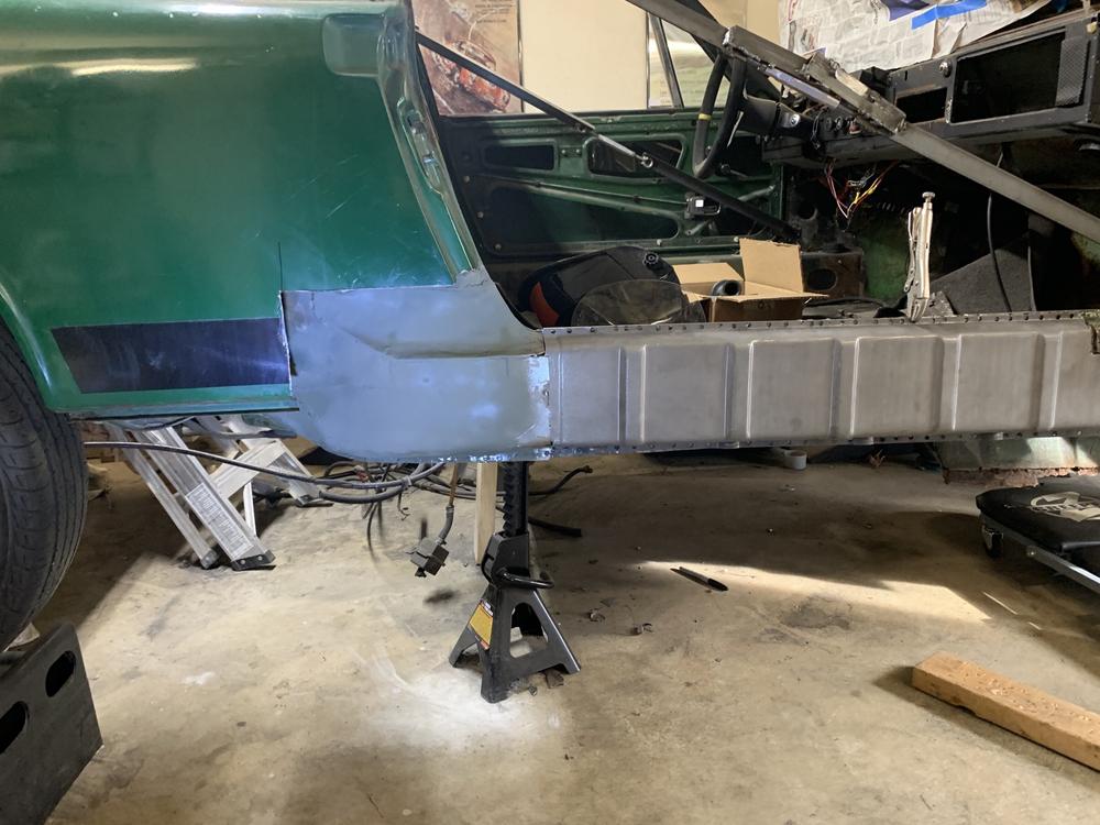

Hey guys,

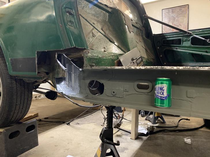

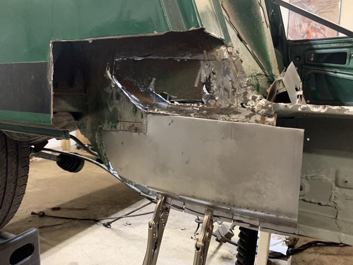

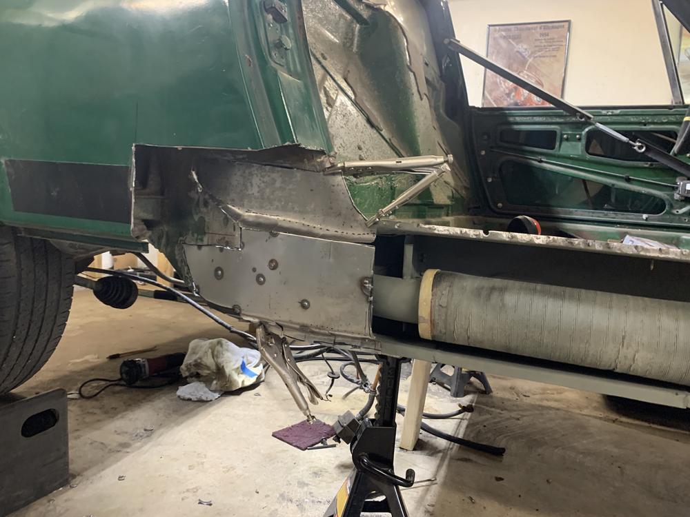

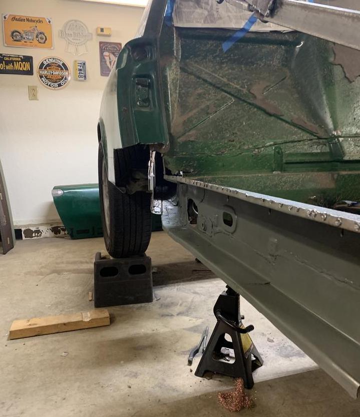

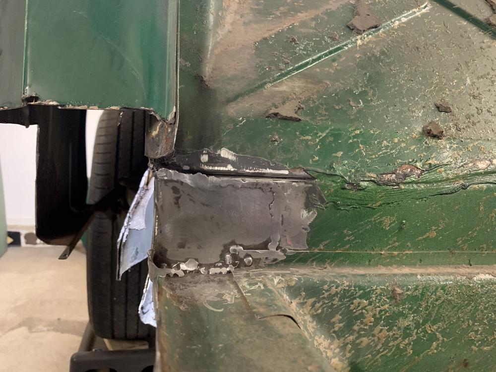

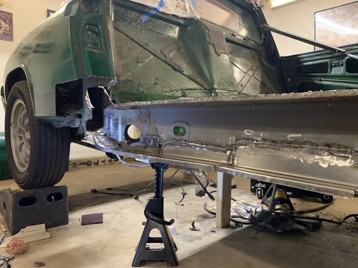

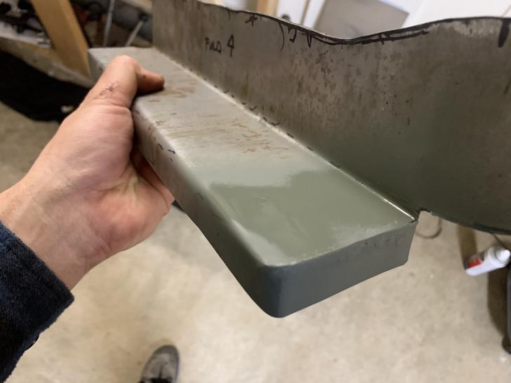

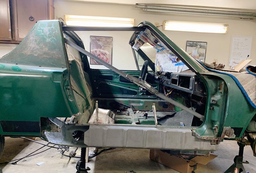

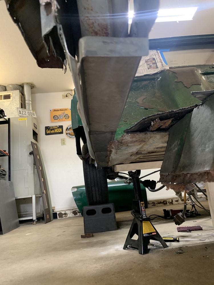

Another little update. Trying to tackle the front section of the long, before the door. Tricky little spot. Soft area in the wheel well. I ground this away to reveal a nice 3" hole.
IPB Image
IPB Image

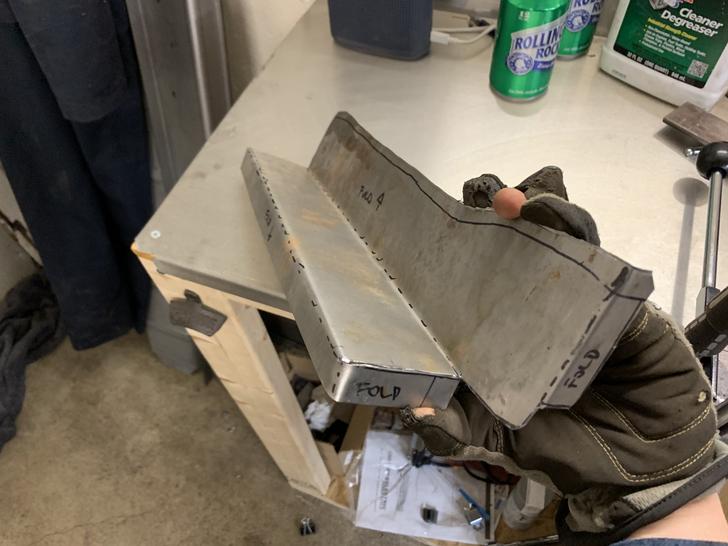

Making a template with a Coors Banquet box. Good for more than a cool buzz.
IPB Image
Cut and bent
IPB Image
Welded and smoothed with a shot of primer.
IPB Image
Reasonable fit, will need some tweaking and 20 more minutes of grinding welds.
IPB Image
Looking down the long. I think I can do a little better than that, so I will make some adjustments to get it a little closer along these red sketches...
I wish I had the AMADA brakes I use at work to bend these parts.
IPB Image

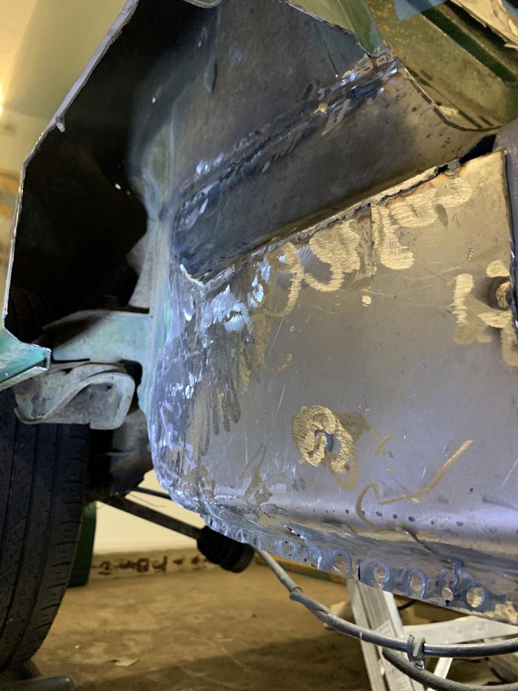

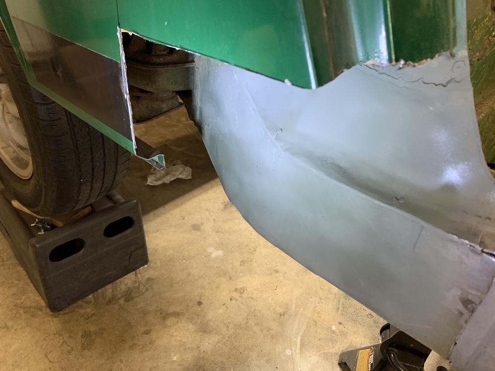

jaredmcginness

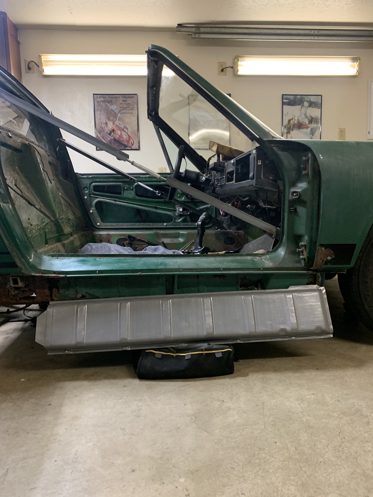

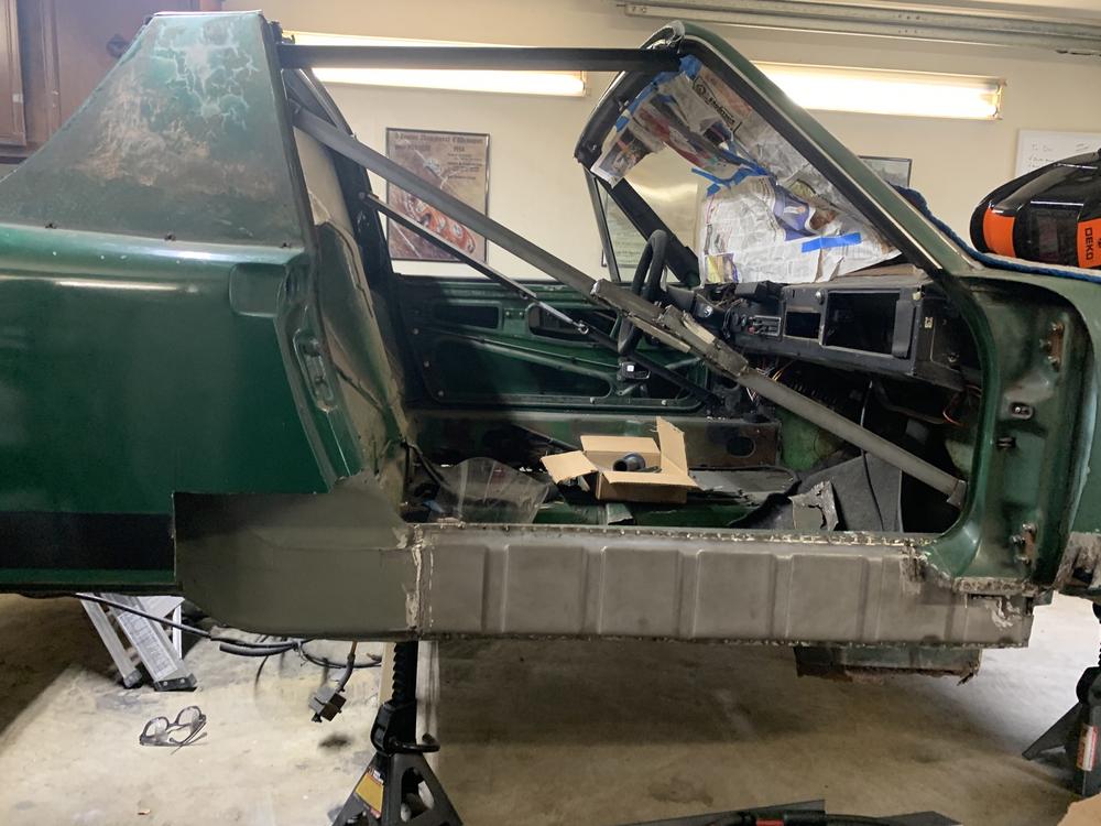

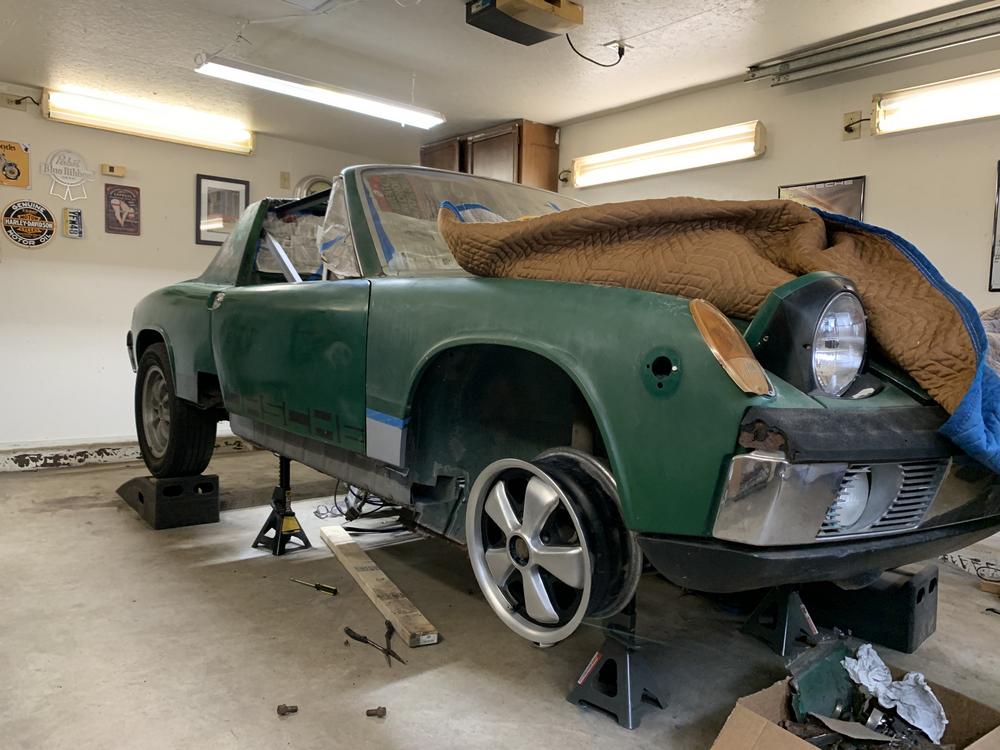

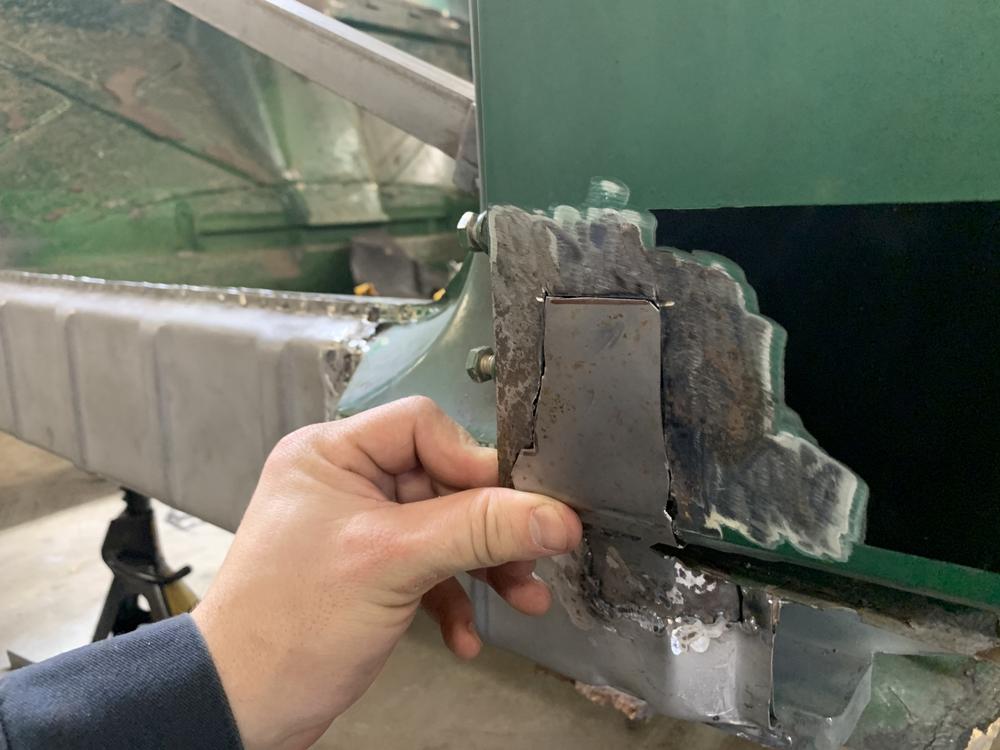

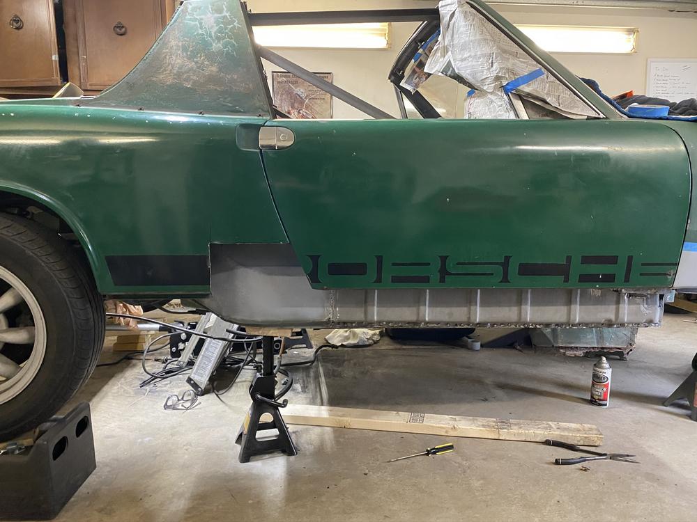

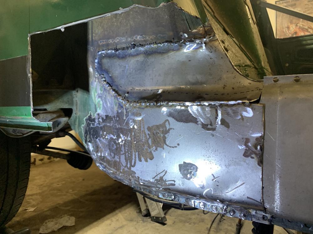

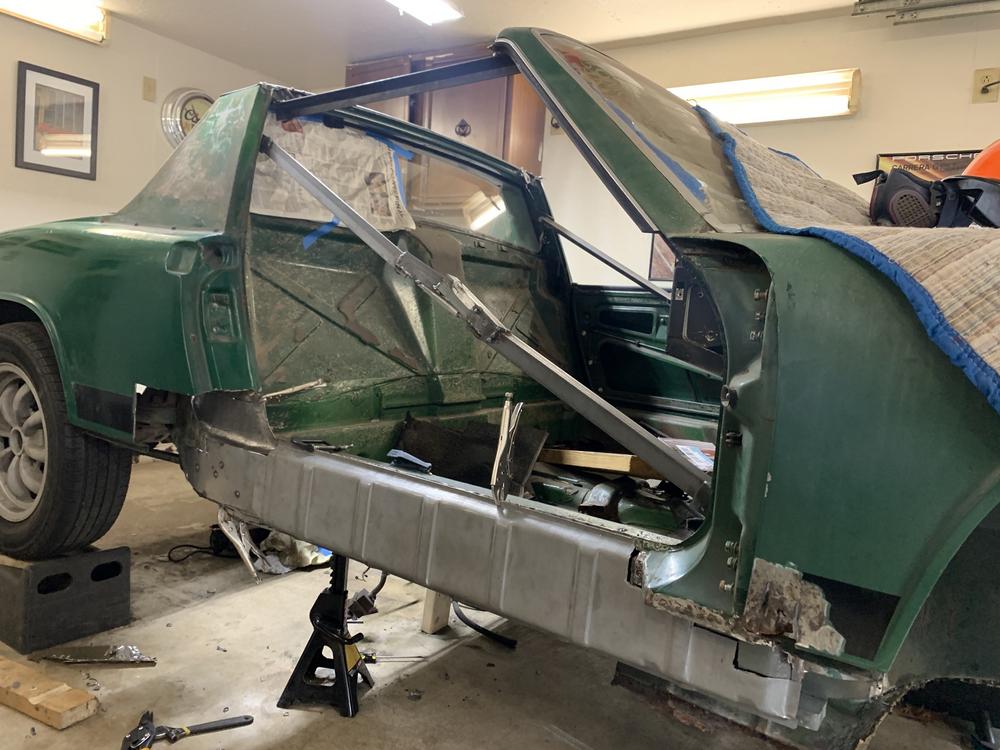

Quickie test fit of the outer clamshell. I wanted to check how far off I am with the lower part of my fabbed long... Close! but more tweaking.
This is a motivating sight!
IPB Image

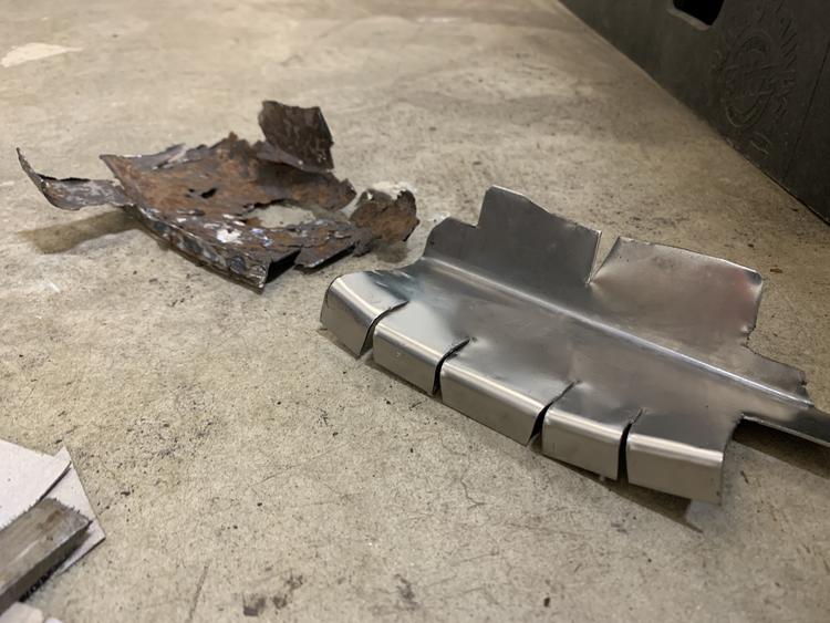

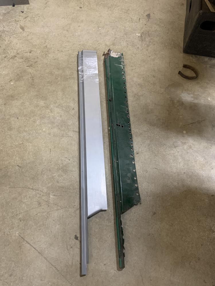

Recreating this rear piece. I used my rusty cut out as a template.
This will be dual layer 16g nice and beefy.
IPB Image
I will not be recreating the jack pyramid area. I have purchased Brad's 914LTD stiffening kit - which deletes the factory pyramid. (not my photo, but this kit:)
IPB Image
I know it might be unnecessary for - not a racecar - but with the rust this car has... it cant hurt to stiffen the car up and keep it solid.
I am blind and missed a chunk on the bottom. Its ok to make things twice sometimes to get it right.
IPB Image

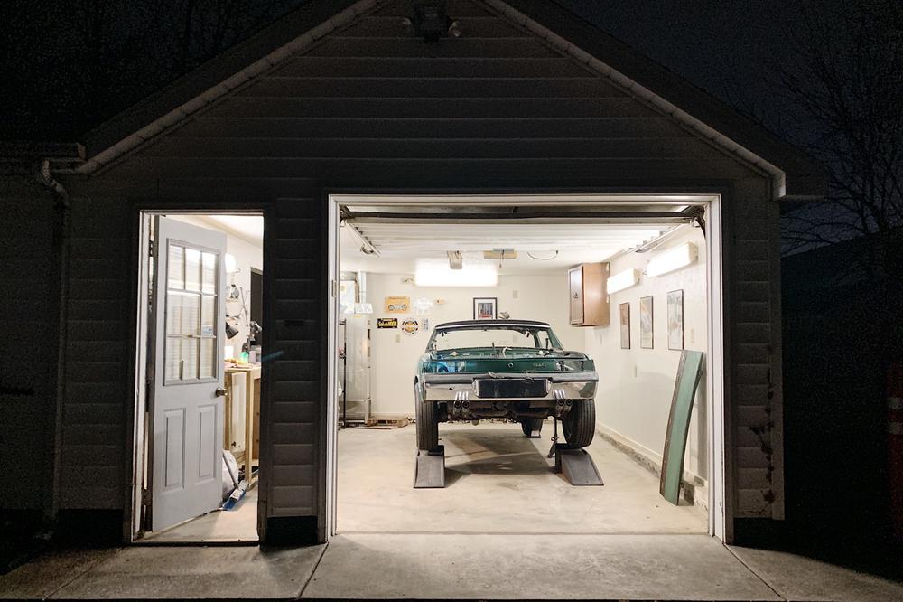

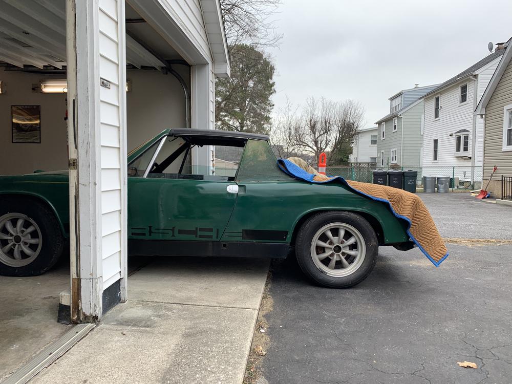

Just a nice photo before I pulled the car in:
IPB Image

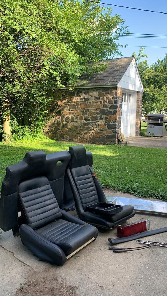

Got some new interior bits from a nice guy about an hour away for a great price:
IPB Image

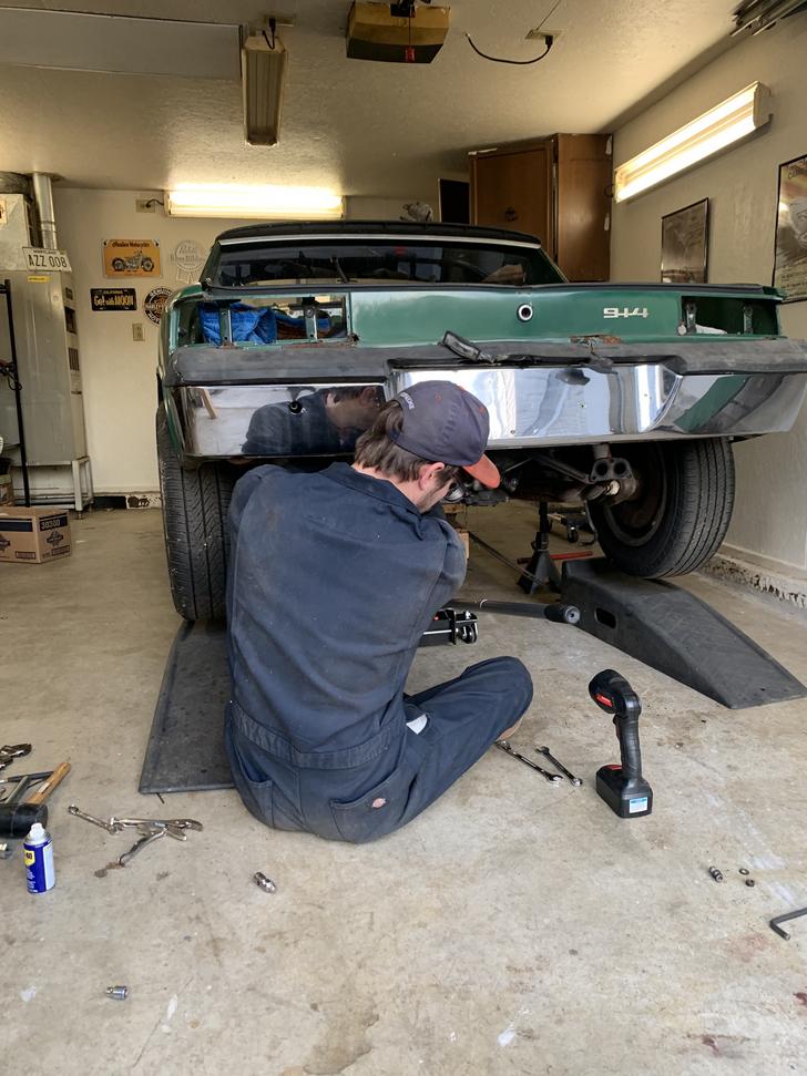

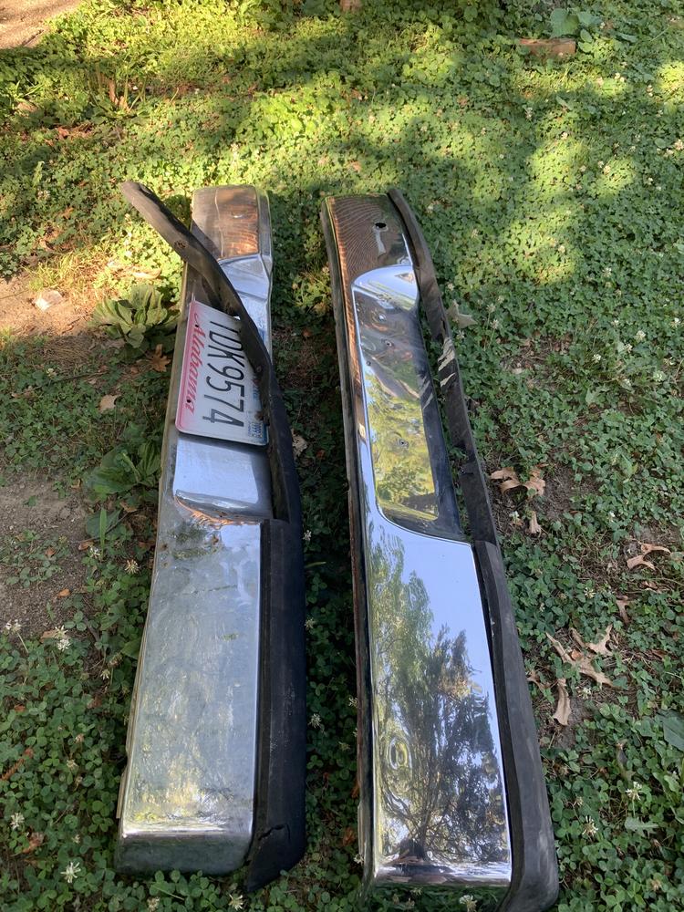

Also a new left tail light, and a much needed rear bumper I found on craigslist in PA for $100:
IPB Image

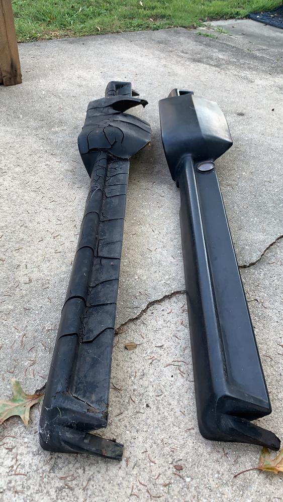

My factory bumper was taco'd and dimpled:
IPB Image

Shot of my work space. Not much but fits a 914.
IPB Image

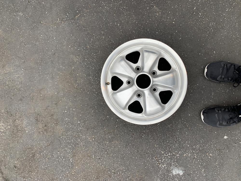

jaredmcginness

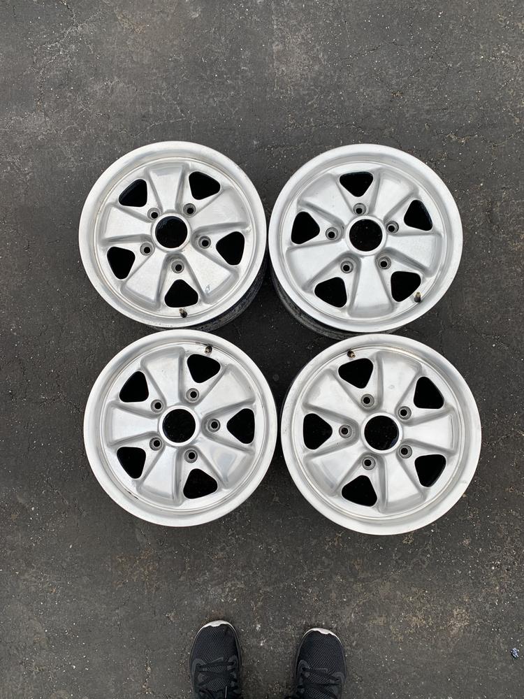

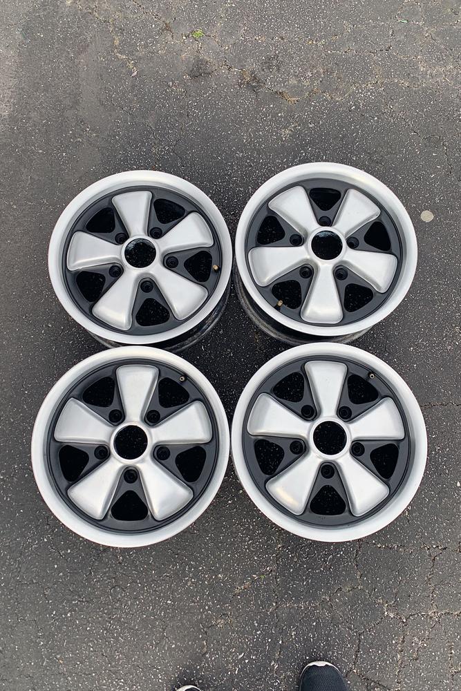

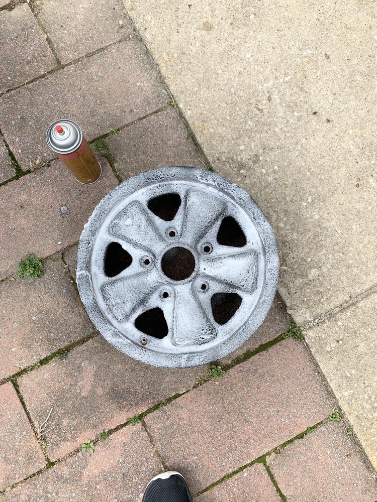

Not related to fixing the car... but part of the bigger picture.
Sometimes you need to buy yourself somethin nice!

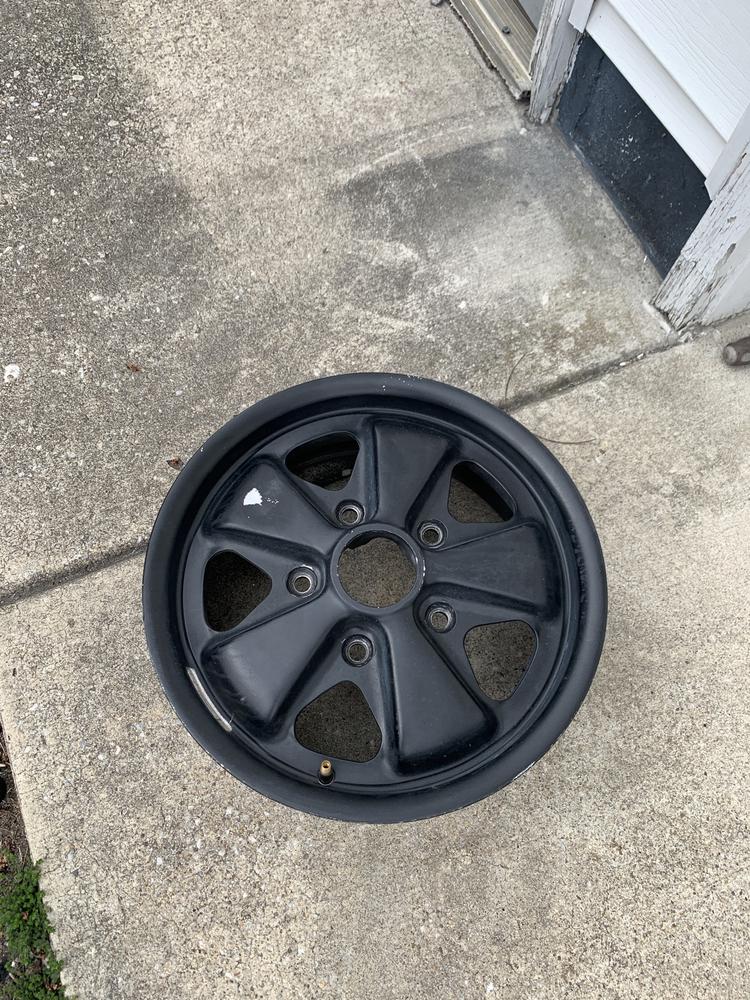

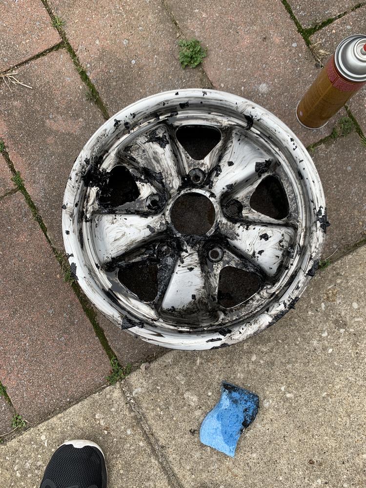

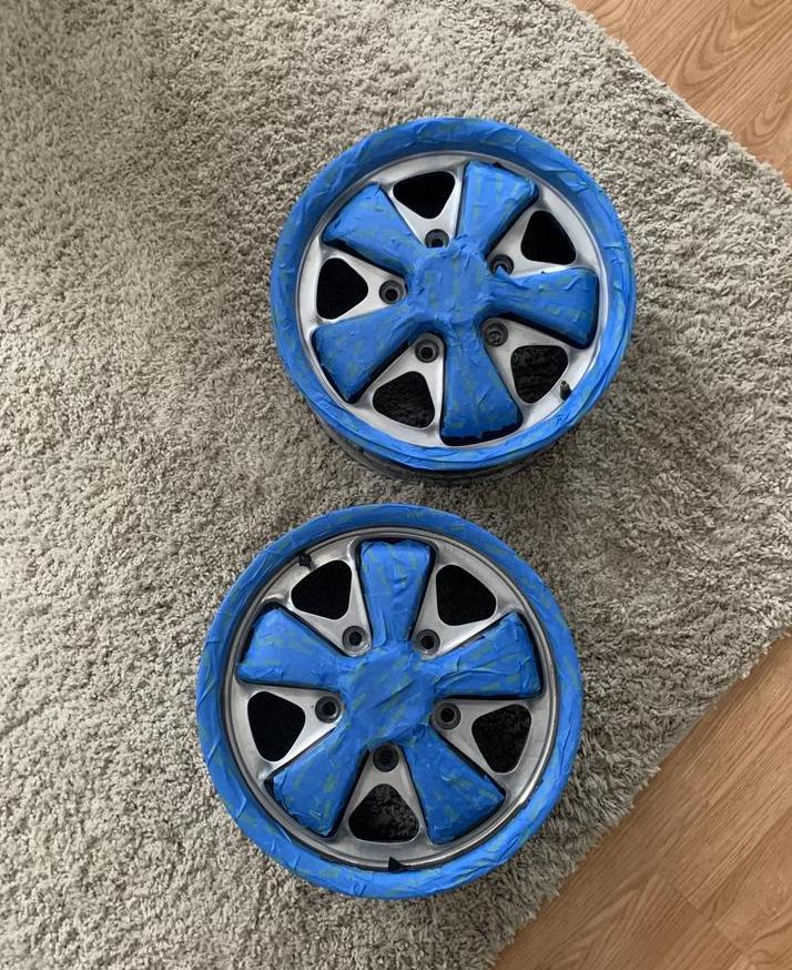

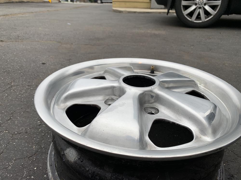

Picked up a set of 14" Fuchs for a great deal, due to the ugly finish. Two '69 dates and two '70 dates. Lets see if I can clean em up.
IPB Image

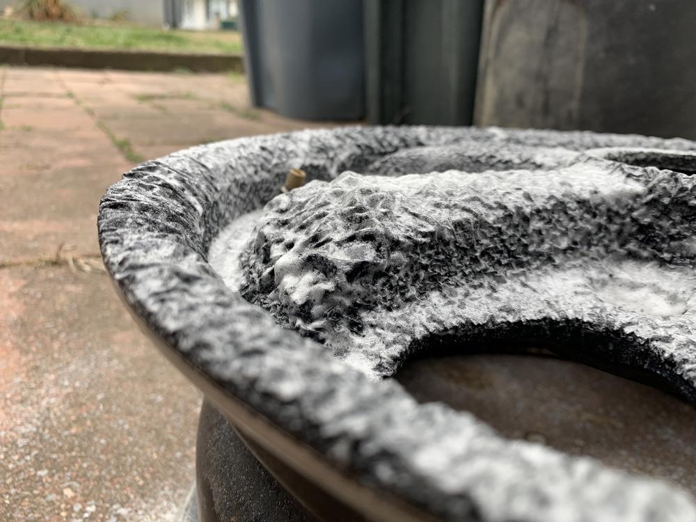

Sprayed some Jascos. 15 minutes of sitting.
IPB Image
IPB Image
IPB Image
Damn!
IPB Image
I would say that the spray bomb job preserved this original finish. Good drivers quality. Really feel like I lucked out here. I'll do the other 3 this evening.... then back to welding!
IPB Image

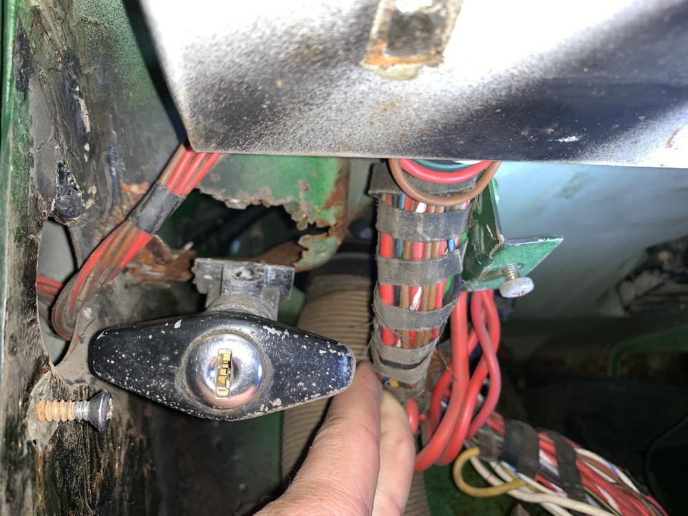

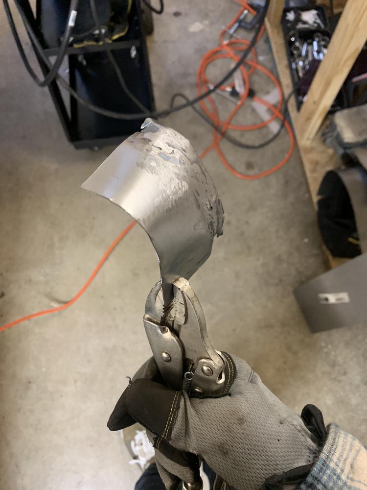

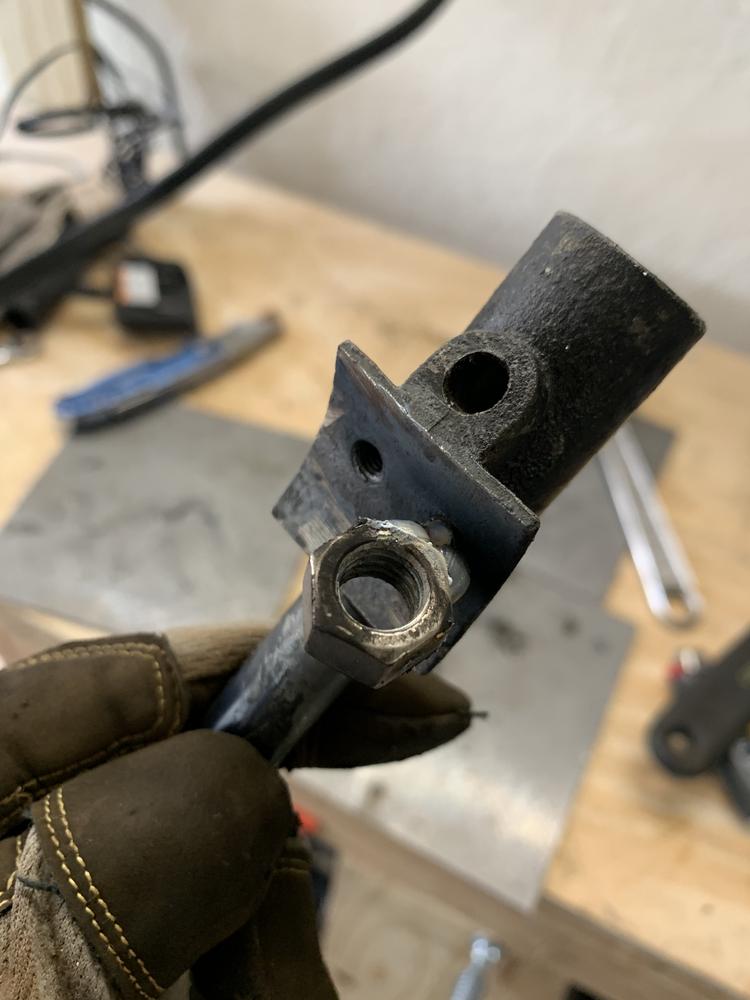

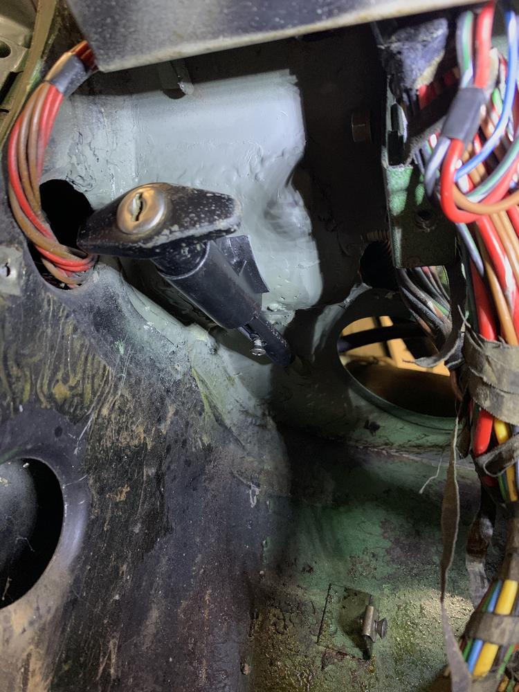

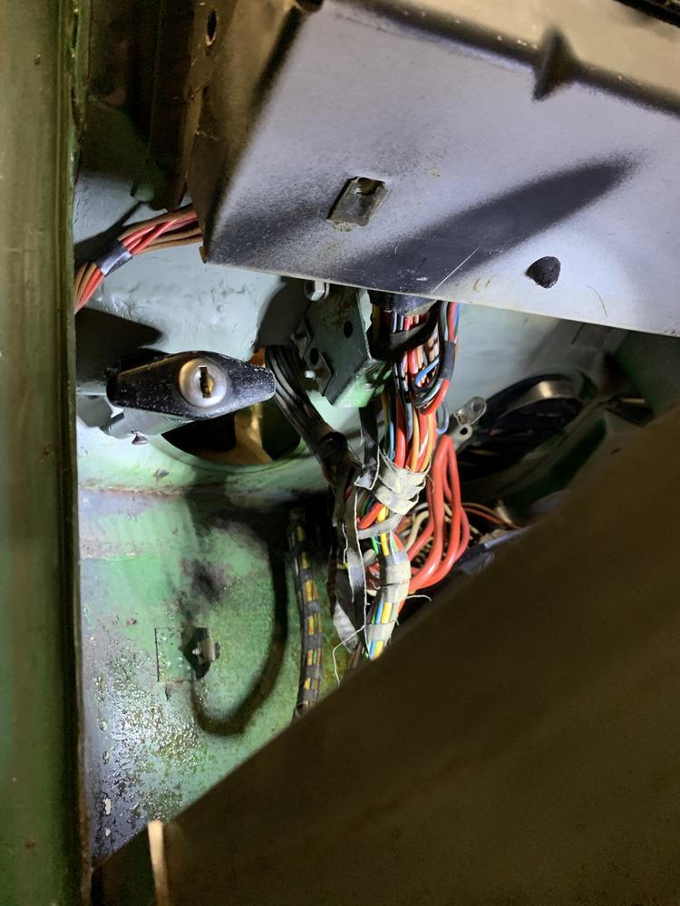

Something else I completed.
The frunk handle was not very functional, as you'd imagine with a hole like this.
IPB Image

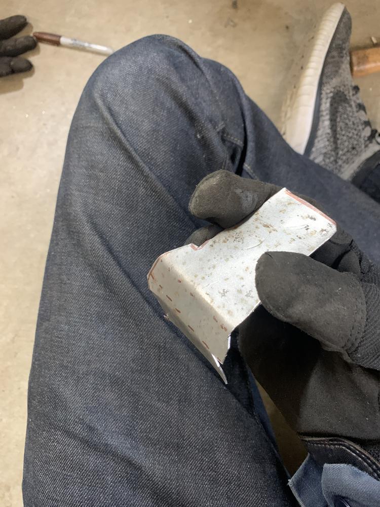

I hammer formed this out of 22g. Weird place to weld, especially from the inside.
IPB Image

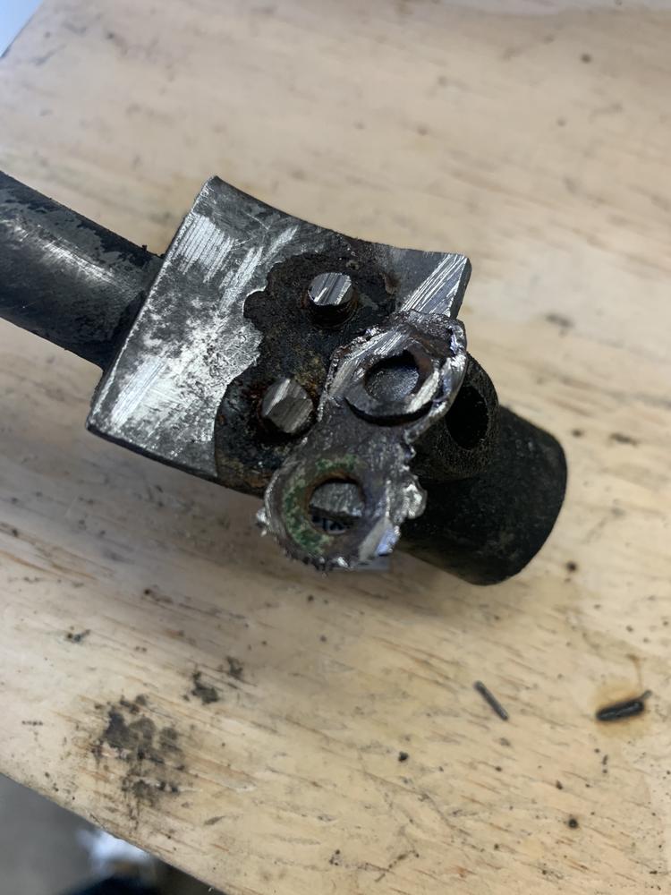

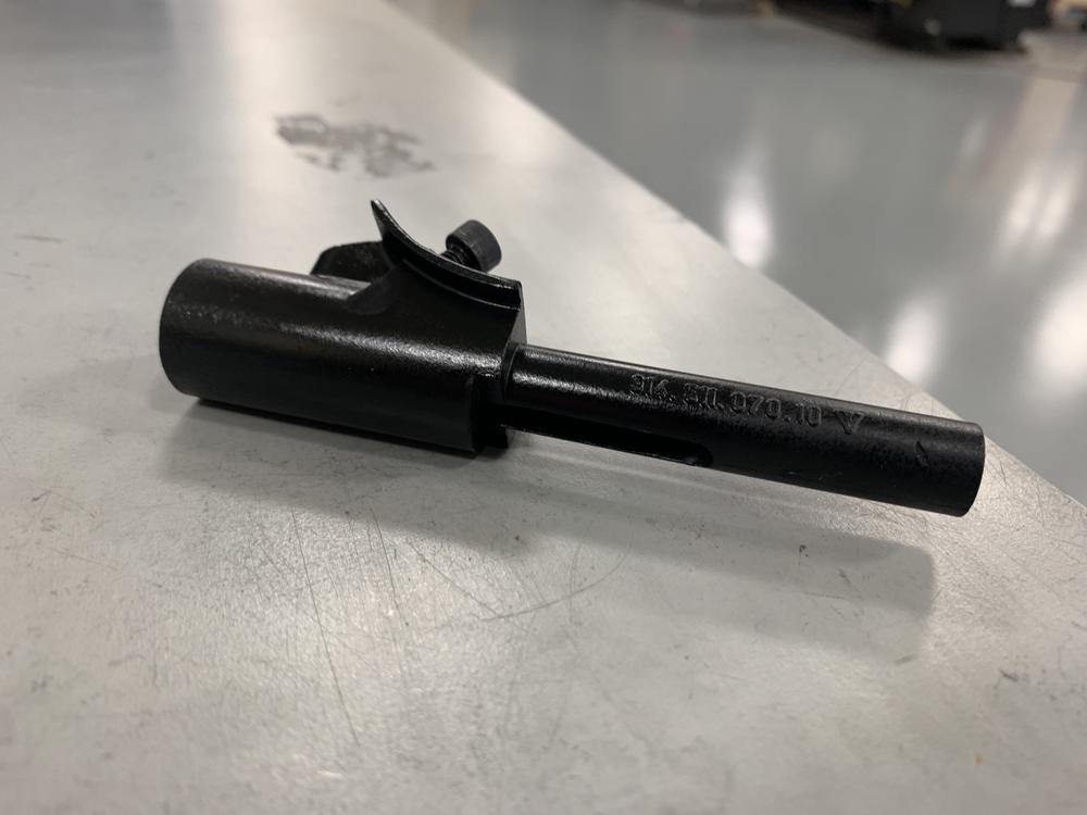

The sheath (?) for the pull handle had stubs of the bolts rusted to it. stromberg.gif
IPB Image
Ground off. Got one bolt stub out with vicegrips. The other was stuck, so I welded a nut to it and she turned right out.
IPB Image
Sand blasted, chased the threads and painted at work. Added new hardware.
Need to do the same for the handle
IPB Image
IPB Image
I'm happy with the result, everything works now. Could be prettier, but its very hidden and will (hopefully) be covered in paint someday.
IPB Image

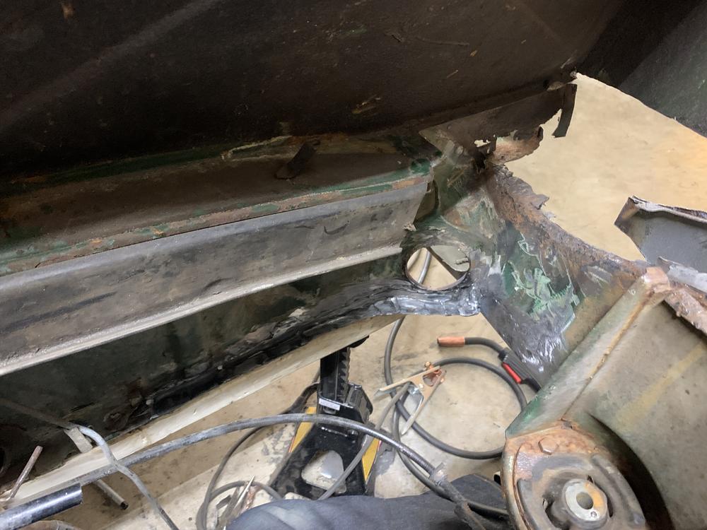

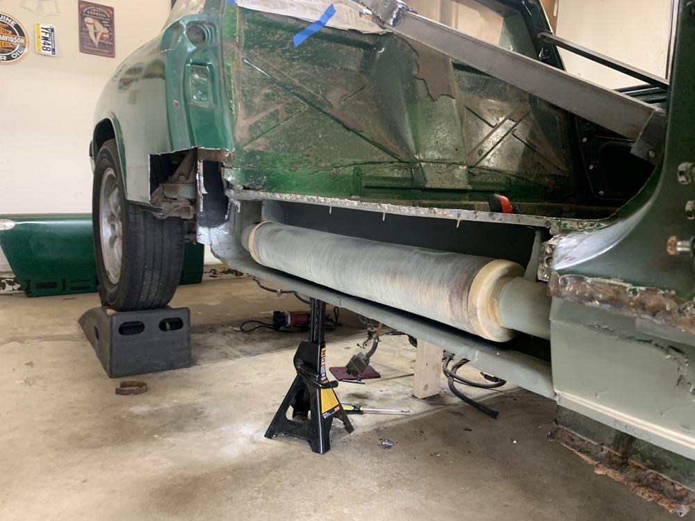

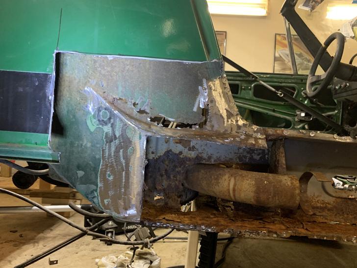

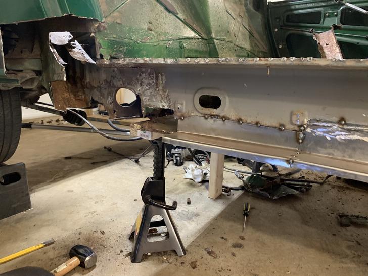

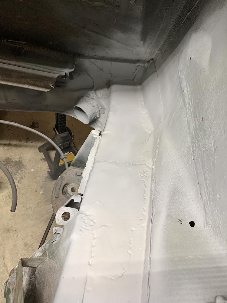

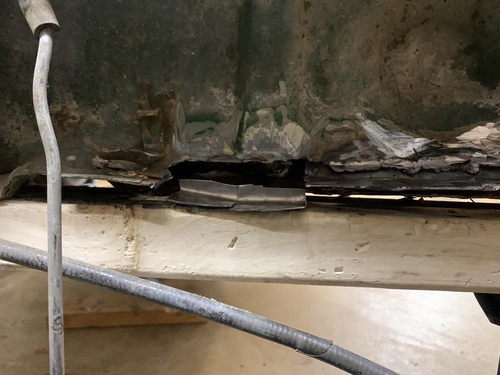

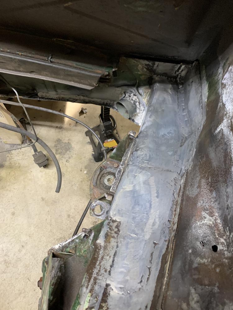

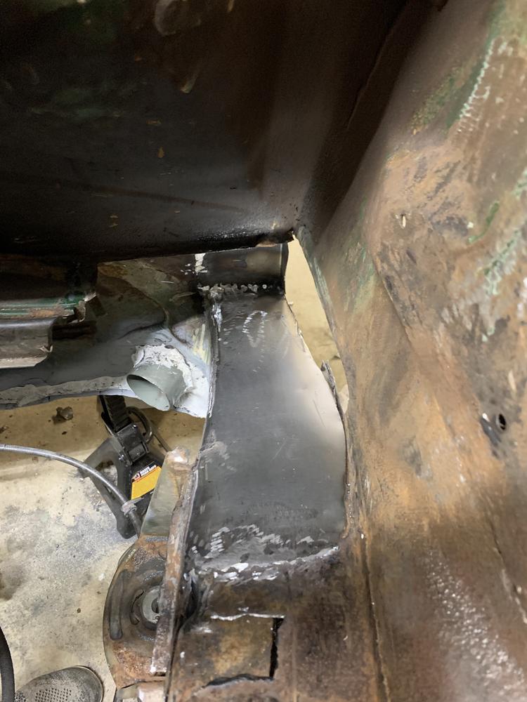

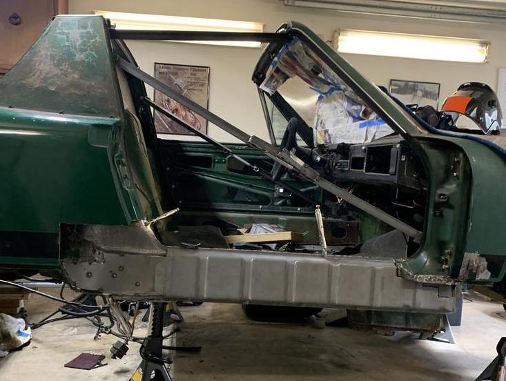

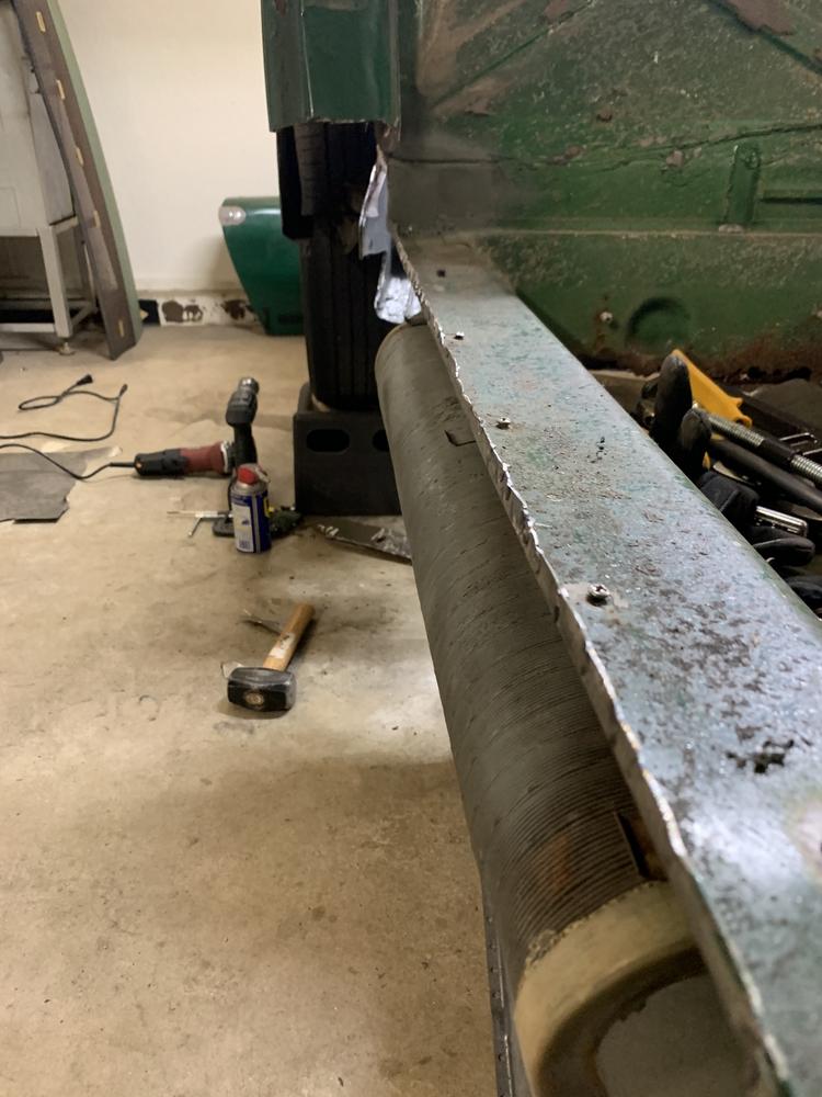

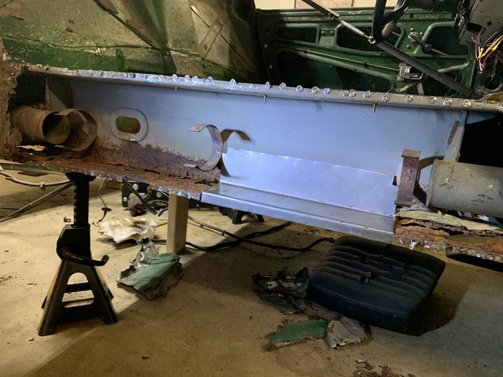

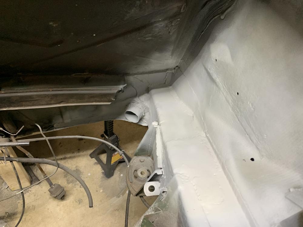

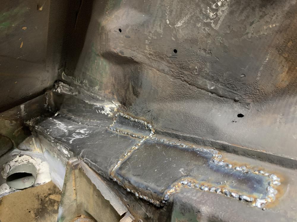

A little work today. Finishing up the floor seam in the engine bay. Chipped away at eh crusty sealer and ground until I saw fresh metal.
IPB Image
Barf.
IPB Image

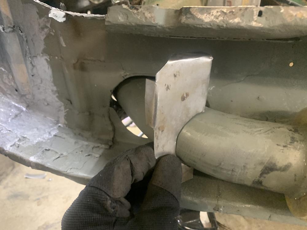

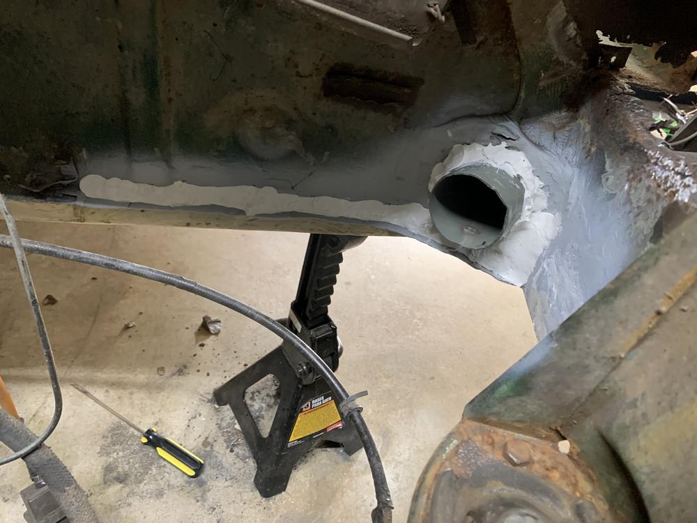

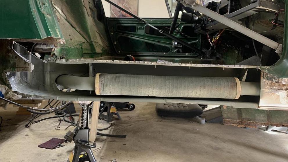

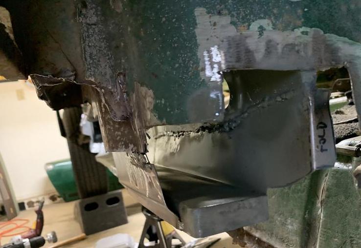

After filling the flange tabs with some weld, grinding to some extent, tacking in the J pipe, top and bottom, and a shot of filler primer. Seam seal the gaps. A little less sealer than the factory used.
IPB Image
Fabbed up a quick and dirty pipe tab. Mine was toasted. Not too concerned with making this pretty - just needs to be strong. We'll never see it again. Right?
... Right?
IPB Image
NICE to see a whole fresh inner long! Plenty of room to mount a floor:
IPB Image
Test fit of the tube. I cleaned it out the best I could and sprayed some primer on the outside - to make it look a little cleaner. I need to take it out and rivet or weld the C clamps in place. Ran outta gas!
IPB Image

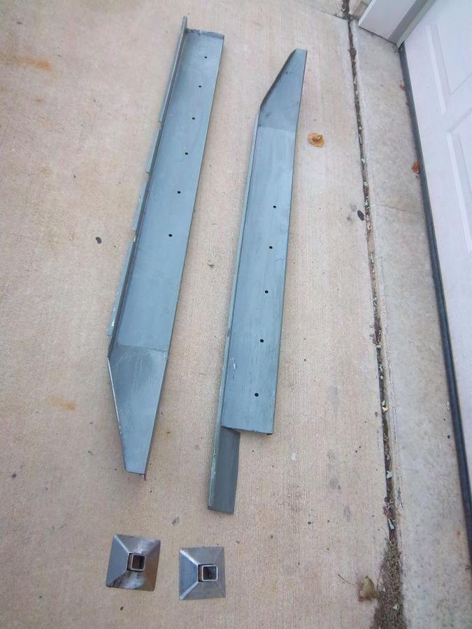

IPB Image
Next on the list is the hell hole patches, then the sections at the rear of this long, clamshell, etc.
Awaiting a Sill and Jack triangle from Auto Atlanta.

IPB Image
IPB Image
IPB Image
IPB Image
IPB Image
This seems to be a rather odd place to find such extensive rust? Well done repair job! welder.gif
Actually very common. Dirt, debris, mouse nests, etc. collect in the metal recess above the pull and holds in the moisture that seeps into the cowl.
jaredmcginness
QUOTE(mepstein @ Mar 14 2020, 10:00 PM) *
I'm sure pulling on the trunk handle adds just the right amount of pressure to pull the rusty steel right through as well.
I love the lights too! I added one hanging LED light from Walmart ($20) right above the engine bay. Very helpful.
I didn't get a ton done today, but I formed the piece above the rear long. Weird shape, still needs some work.
IPB Image
Got a new Sill in from Auto Atlanta... Ordered Friday, arrived Sunday, cant beat it.
IPB Image
Cleaned up the rest of the Fuchs. I'll be doing the windows black, at some point. These are 14x5.5. Not a priority right now. But couldn't pass up the 2010 pricing on the set of 4.
IPB Image
More test fitting. All three of these pieces are just clamped on. The clamshell will be under the rear piece before welding.
IPB Image
IPB Image
That's all for today. Thanks for anyone taking the time to read, and the support everyone's offered for this build.
P.S. Saying "build" is funny because I used to feel like putting BBS wheels, carpet and a H&R Cupkit on a Mk1 Rabbit was a build... How things have changed.
horizontally-opposed
Nice work—great to see someone in their 20s working on one of these (said as someone who is still working on one 30 years later...after starting in his teens... unsure.gif ).
Those Fuchs were a great score—there's something about Fuchs without black backgrounds that works. They'd look great on your car, or you can generate additional project funds if you choose to resell that set as-is or properly repainted—as a 914-6 or 911E owner might want correct 14s. Meanwhile, 15x6s or 16x6s are where the good tires are at. What rear tire size are you on? They look beefy...

Cheers! Not a bad tip. I think I would like 15x7 better, plenty of good tire options there. Wasn't trying to spend $1500+ right now on them though stick.gif
The tires I have on these 15s are 195/65. Which is similar to what I'd run on the 14x5.5s I believe that is near stock size, but a hair shorter.

Here are a few updates from the past couple days. Firewall and the all mighty Hell Hole! I have been dreading this. You guys have conditioned me to hate it! Maybe it wont be so bad.... bs.gif
Upper firewall rust is cut out.
IPB Image
Needs some more grinding. Right side looks decent.
IPB Image
Cleaned and primed. Nice.
IPB Image
This piece will serve as the wall and base to weld the lower Hell Hole patches in place.
This is what I was working with.... Yikes. Lets cut some more away.
IPB Image
IPB Image
Engine shelf removed. What was left of it anyways.
IPB Image
"Lets form some new metal." - Probably Bob Ross
IPB Image
This is all 16 gauge. I bent the large shapes over my thigh, tack welded a few spots and hammer formed to get the fit better.
IPB Image
Grind for 1 hour. Prep with Metal Ready. This is how it looks after:
IPB Image
Self etch primer, and some filler primer on top. This is the result:
IPB Image
I got a little "trigger happy" and sprayed some primer over all the fresh metal, not thinking that I still need to weld (and purchase) the engine shelf.
Regardless.... There have been prettier repairs, but its a good deal better than no metal there at all!
There is still a hole and thin area that needs patched (lower right of the last photo)
Question: Would you guys recommend a skim layer of body filler to smooth the gaps out on the hell hole? I have never used the stuff before, but I'd like to finish with a nice repair.
Overall the hell hole wasn't the worst thing ever. Would not look forward to doing it again though. I have about 6 hours straight into the repair. What a pain in the butt it is getting in and out of there. 28 is too young for my knees to feel like this.
IPB Image
Thanks for reading!

Posted and forgot to add the work I accomplished today.
I fit these two panels today. I had to modify them a hair, but over all they fit nice.
I traced these shapes off of the pieces I cut out. Pretty cut and dry - or... weld.
In progress. Ignore the bacon welds.
IPB Image
A lot of the same sounds echoing from the garage this week... I'm glad I bought ear muffs.
IPB Image
Mimicked the spot welds on the bottom. Light coat of SE primer.
I will need to fill in another spot or two, and figure out the transition to the outer clamshell.
IPB Image
I have to say I am really proud of how this looks... If you scroll back to the first photos, there was not a lot of meat here!
Factory shape looks pretty close. As a reminder, I am not using the factory jack pyramid (I will be using Brads Meyer's stiffening kit) so this section was left flat.
Dual wall 16g, pain in the D to form.
IPB Image
DANG! Nice. Fits up pretty well with the outer clamshell. took a mallet hit or two.
I drilled these holes for the spot welds last night, made a few trims - But it sandwiches nicely in between the dual wall.
Lastly. The girl and I started taping off my Fuchs - for the semi gloss windows. Just like the car... time consuming but worth it for the outcome.
IPB Image
P.S. Here is my cat, Oatmeal, in case anyone needed to see this today.
IPB Image

Weekend update:
Part 1:
Decided to go at the hole on the Lower front PS fender. This will be my first time ever using body filler. I have nothing but time on my hands today. So I am ready to sand. Nice little spot to try this out.
Here's the play by play....Cut out:
IPB Image
Trace the shape of the piece you need. This time I used a Yuengling box for a template. The cardboard you use all depends on your beer preference that day. beer3.gif
IPB Image
Looks good to me.
IPB Image
Weld, grind, "smooth".
IPB Image
Body filler:
IPB Image
Then you realize you still have the negative stripe vinyl beneath that tape. Grind that off, rather unevenly. Apply another skim of body filler.
Sand for like 40 minutes.
IPB Image
Voila! I am pretty proud of this! Not horrible for a first time at "body work". Certainly time consuming...
I see a couple dings left. Honestly, I think that's an OK thing - or this fender might stand out like a sore thumb, as compared to the rest of the car. As of right now I am not going for a perfect resto. This will be as original paint as possible.
Gives me a bit of hope for down the road when I take it a step further, with a respray and such.
IPB Image
Part 2:
I spot welded the outer clamshell in place. This feels great and is so satisfying to see. Weld one, move a foot over, weld another, let cool, repeat.
IPB Image
Still have a bit of grinding and smoothing to do. A theme for this project...
Now for the big test. Does this door still fit?
BOOM!
IPB Image
Door gap looks pretty damn good and she closes like a German bank vault! Lots accomplished in the last few days, and a lot of stuff checked off the whitebaord list.

Sunday project. My girlfriend and I spent the morning finishing up taping off my fuchs wheels for restoration. Took a while!
IPB Image
Scuff, Prime 2 coats, Semi Gloss black 3 coats, Matte clear over top.
IPB Image
IPB Image
1 bolt holding it on for the photo (still 4 lug) Just had to see.
IPB Image
IPB Image
I am so happy about these.
They are going to look great on here one day. Not a bad tidy up for a $700 set of fuchs!
BeatNavy
Those Fuchs look great. What did you do to the petals? Just matte clear?
jaredmcginness
QUOTE(BeatNavy @ Mar 23 2020, 12:41 PM) *
Thanks, they are the raw finish - I believe its factory anodize. I just cleaned them up and cleared right over them. We'll see how it holds up?
