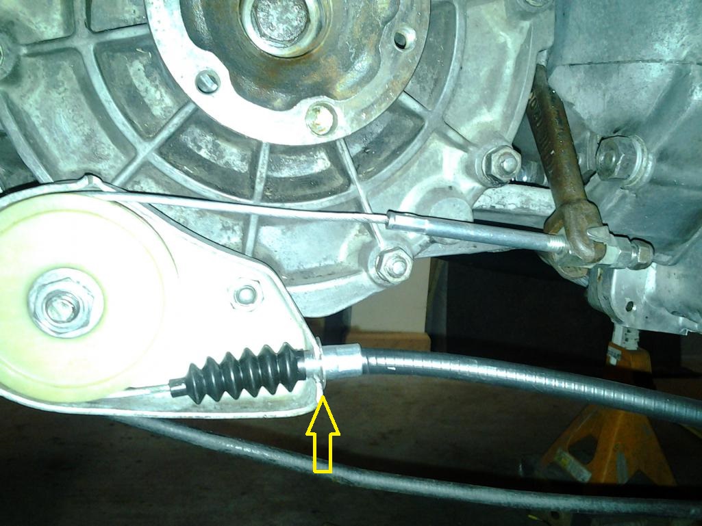

Short notice without digging.
914 World Shot.
Arrow points to the banjo stop plate. Mounts to cable tube. Then the leg gets bent
around the bearing bracket, then tip bent into hole on back side.
Hope it helps ...............
914werke

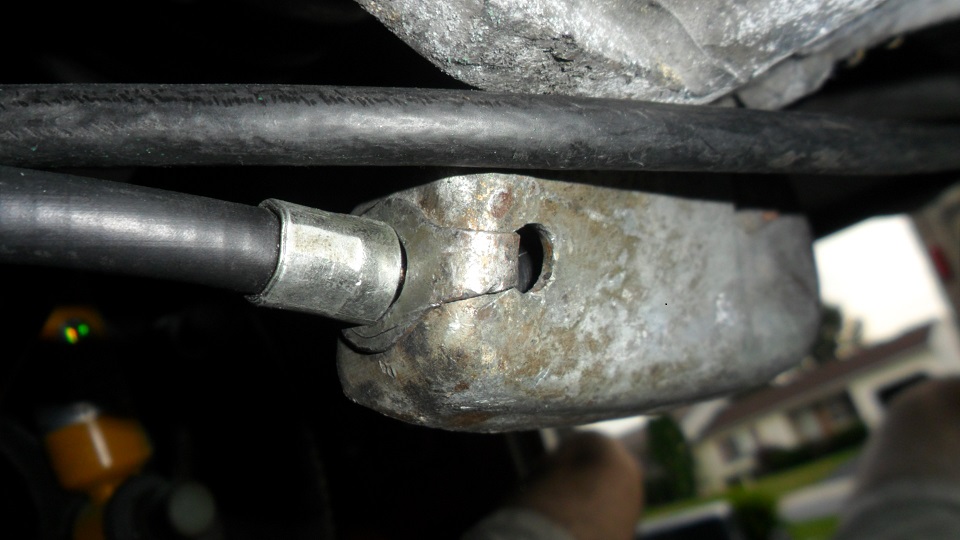

the back side of that is where the tail of the fastener curls around to then secure into the hole on the bracket

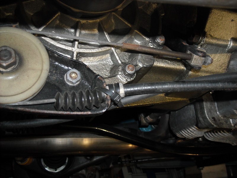

Or you could just do this....

from my photo archive:
