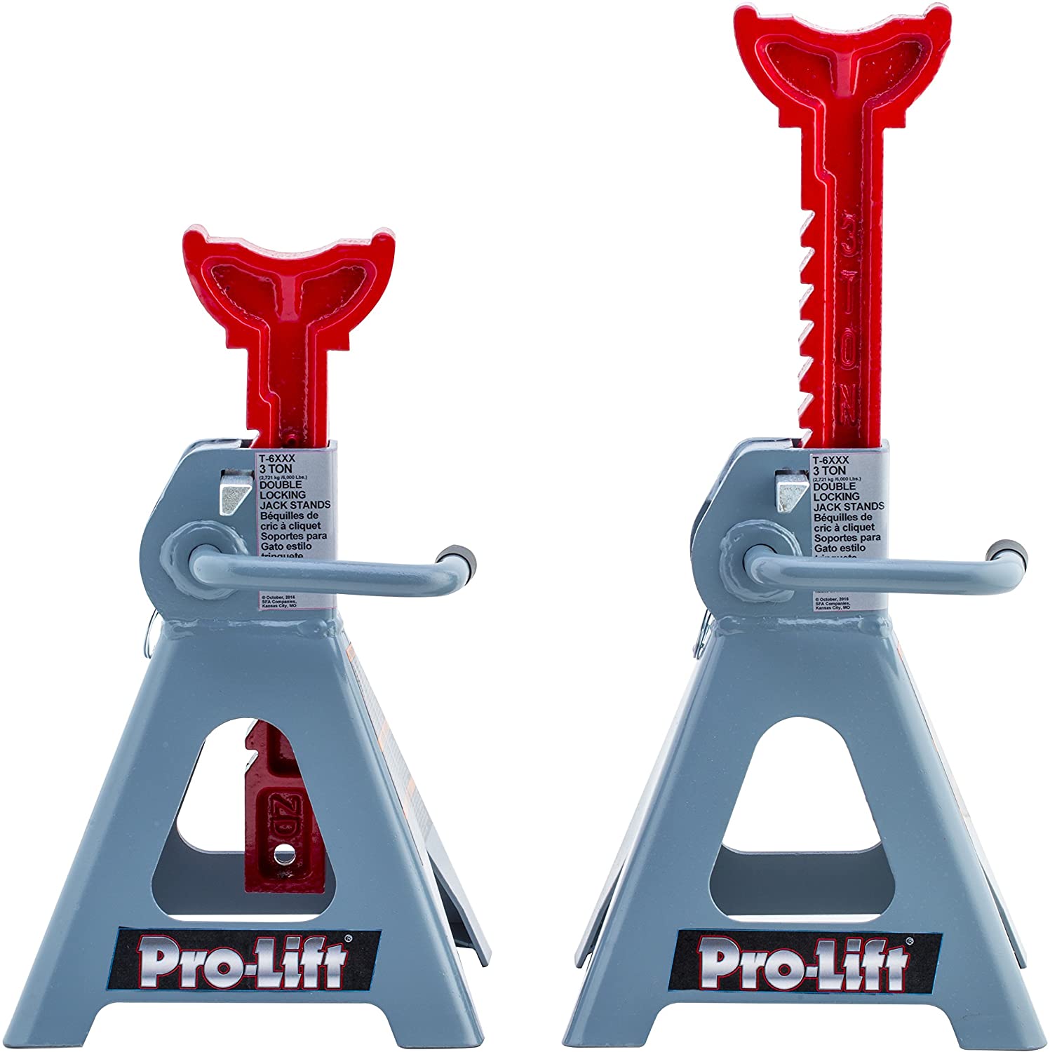

Looks like you can now get hybrid ratchet / pin stands for about the same price. I can only imagine the insurance claims that forced this redesign...

Maybe your right, but I had no problem finding mine at Pep boys, but that was 20 years ago.

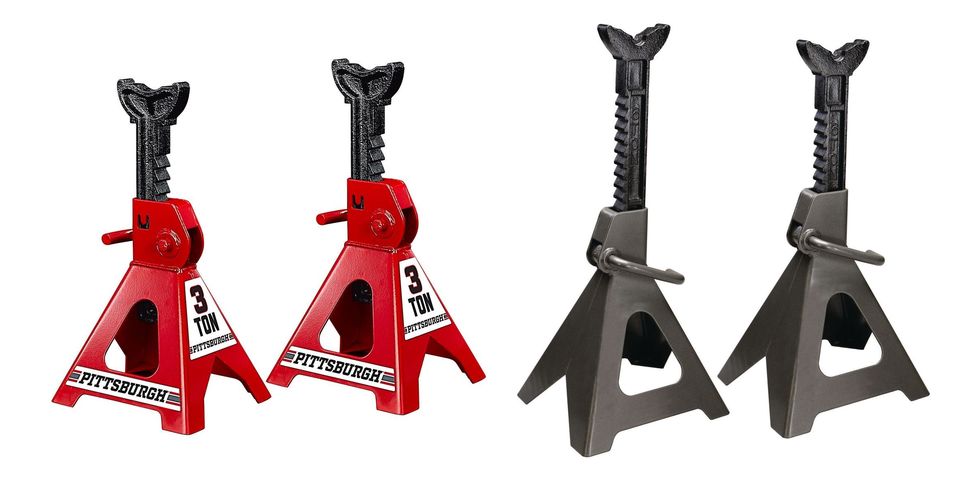

NEVER buy a jack stand that does NOT have a locking pin. It is that simple!

Find the nearest dumpster and throw them away. Preferably disassembled, in two stages, so no one can reassemble them.
Pin types are inexpensive on Amazon and elsewhere—very cheap insurance, and there's only one you. Said with love for ya…

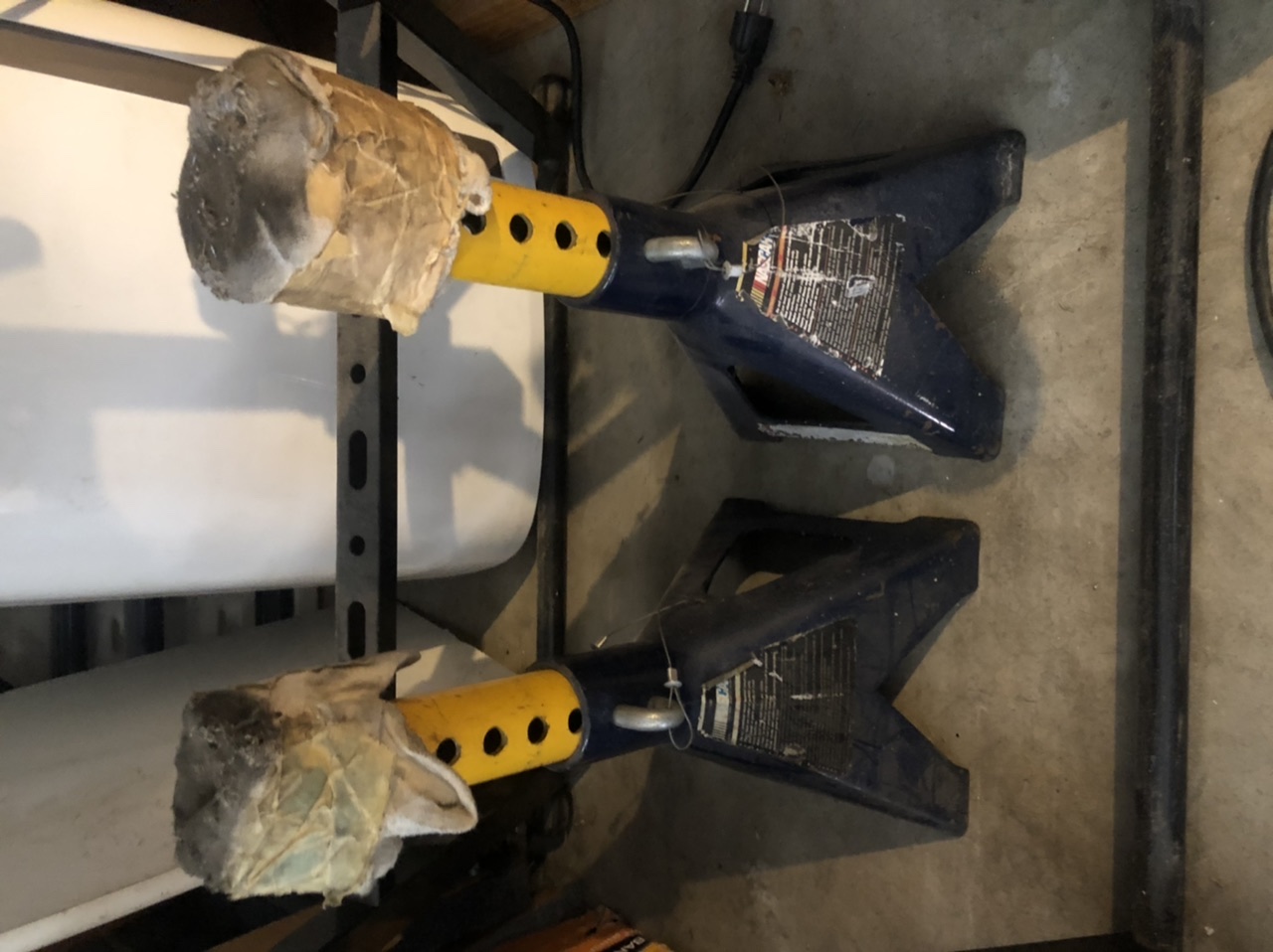

My standard operating procedure was to wire them shut, with baling or fence wire.
I inspected every set I purchased, and found the manufacturing tolerances poor, the cast serrations and toggle interface too easily tripped by the slightest movement of the toggle handle.
Frightening to think of what could happen in a failure.
