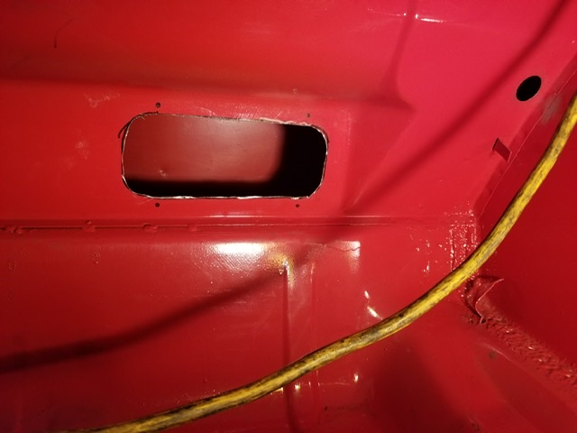

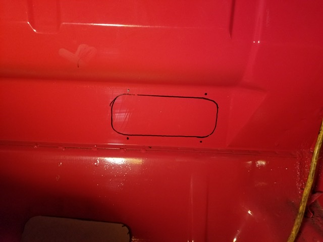

Move the pump (1973 2.0) from the stock location to the front? If so, cut an access hole like later years?
Can somebody please send a photo of the frunk rear wall, taken straight on, so I can get some dimensions for the hole?

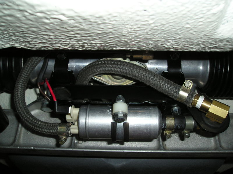

ndfrigi
several members have place it beside the steering column.
This is what I may be doing also.

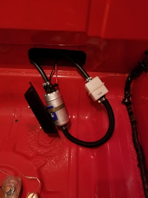

yellowporky
I did a lot of searching for photos too and this is what I concluded to be as correct as possible
Hope this helps

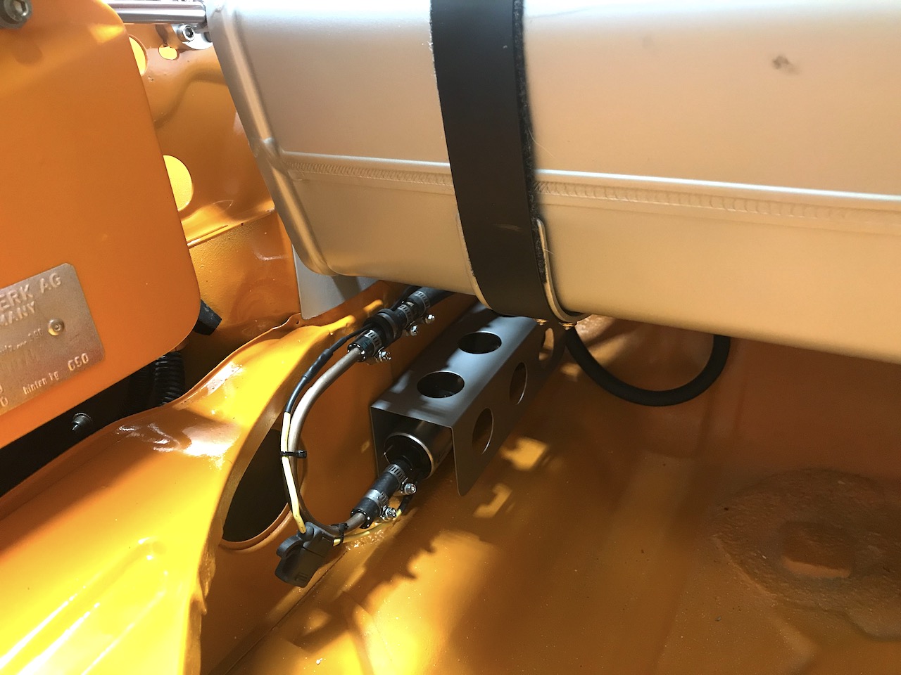

Tbrown4x4
I put a CB pump up front under the tank, with the filter mounted by the steering rack. DD like this for 3 years without problems. I do want to add the plate and hole to avoid pulling the tank if the pump fails. (You never know.)
I handled my pump wiring with a module from Revolution Electronics.
https://www.revolutionelectronics.com/Produ.../Fuel_Pump.html
I found it easier to wire the pump from the fuse panel, and I like the 3 second prime and the safety shut off. (No ign signal, no pump.)
If the module fails, you short the purple wires together and drive home.

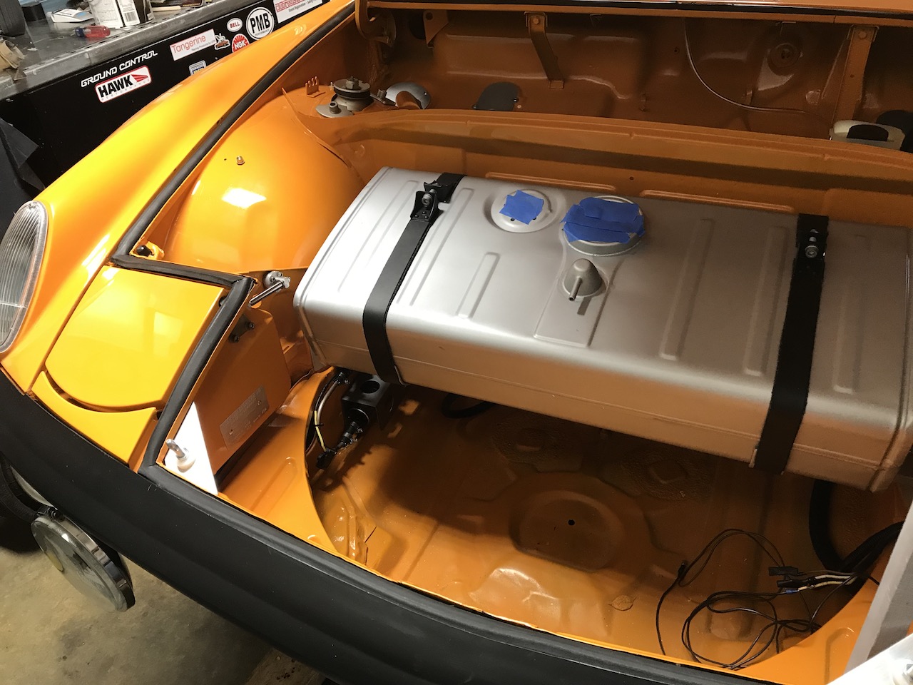

mlindner
Well, I moved my tank and pump, just FYI. MarkClick to view attachment Click to view attachmentClick to view attachment

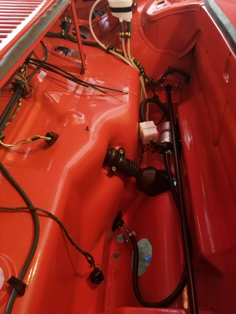

roblav1
I ran stainless lines, appropriately bent, through the boxed support structure into the tank compartment. Still need to wire it. Pump was recommended by PMO.
porschetub
QUOTE(ndfrigi @ May 22 2020, 03:26 PM) *
agree.gif best location,I'am not a fan of having a fuel pump inside the car but that's just me,the undertray panel keeps the pump out of the weather and offers protection from knocks.
